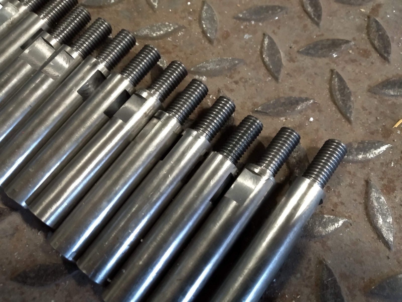

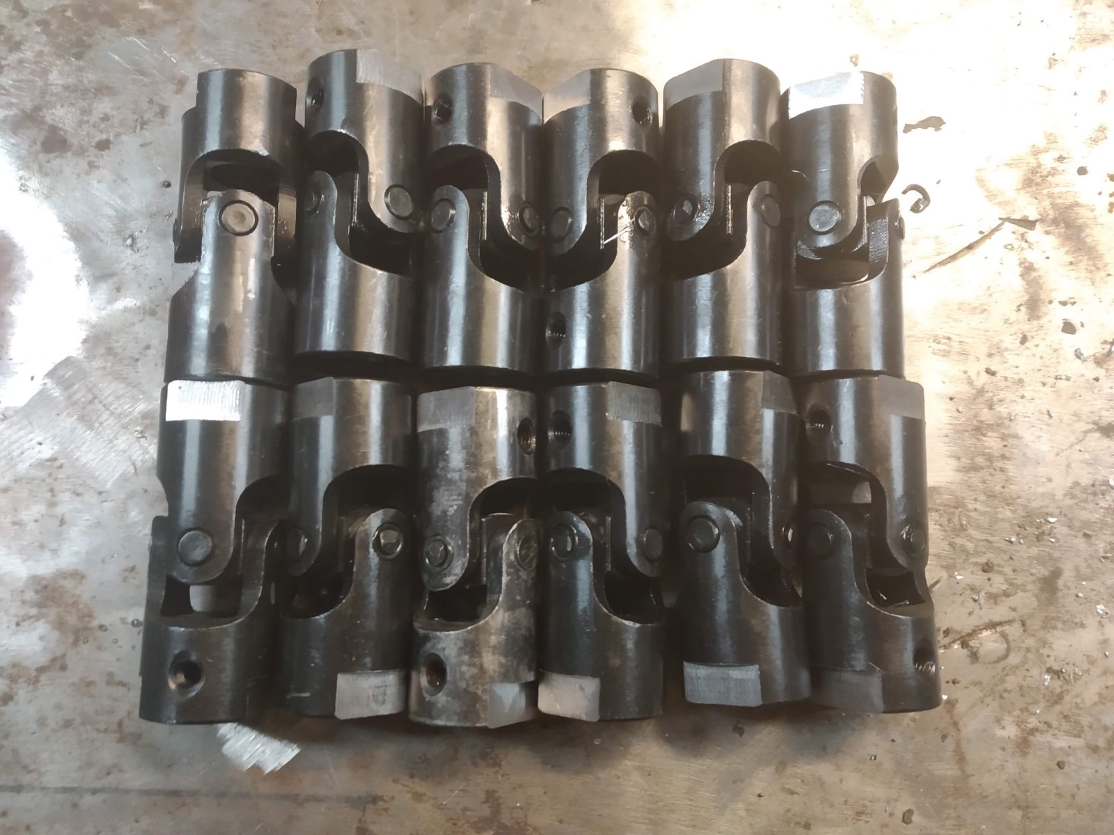

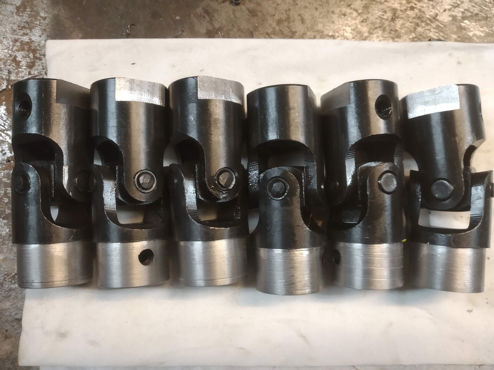

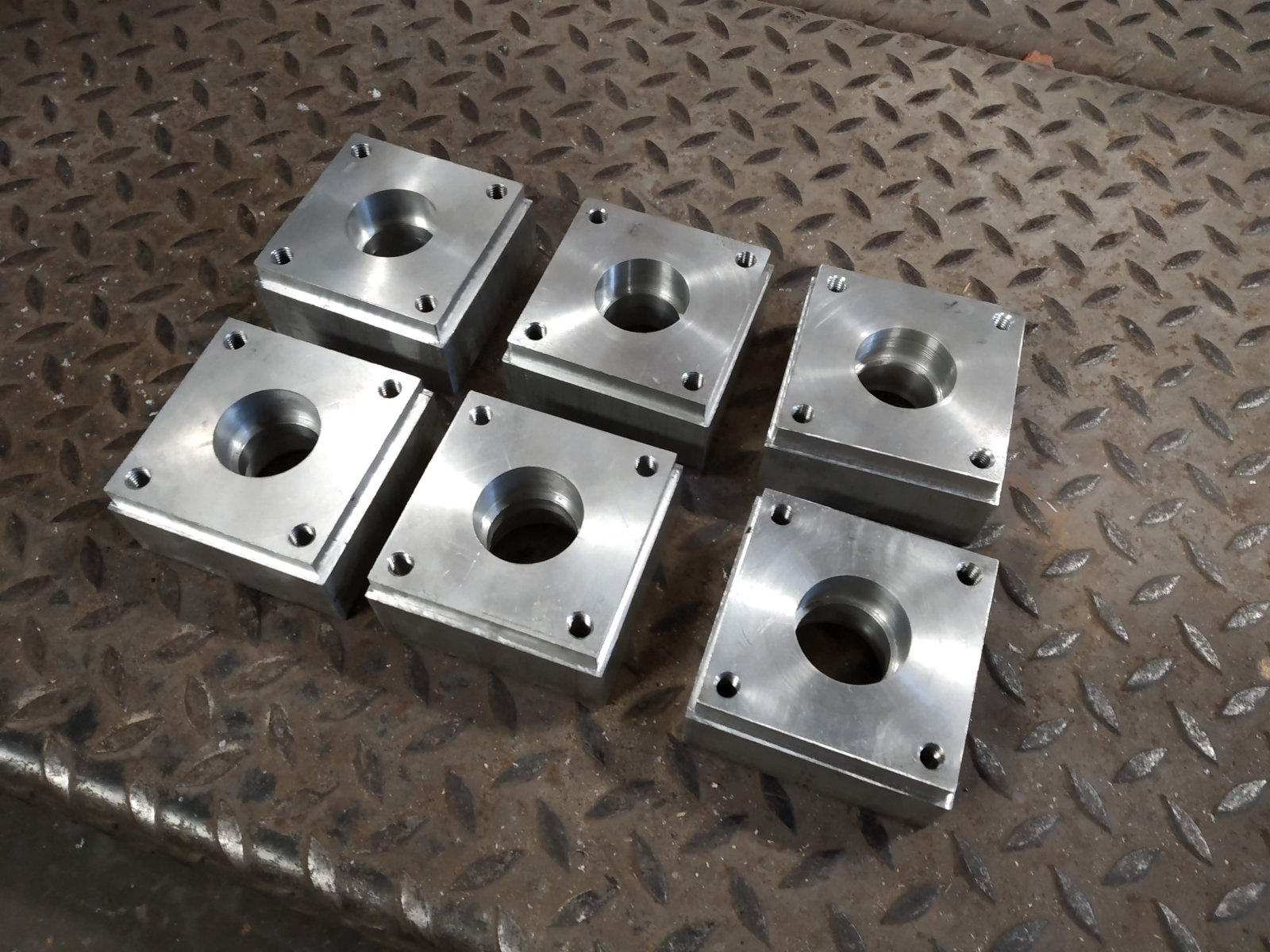

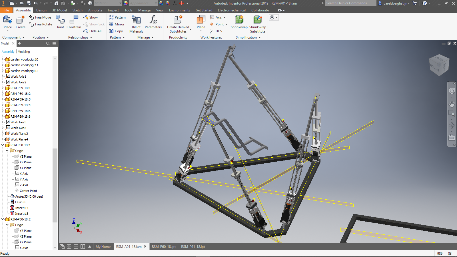

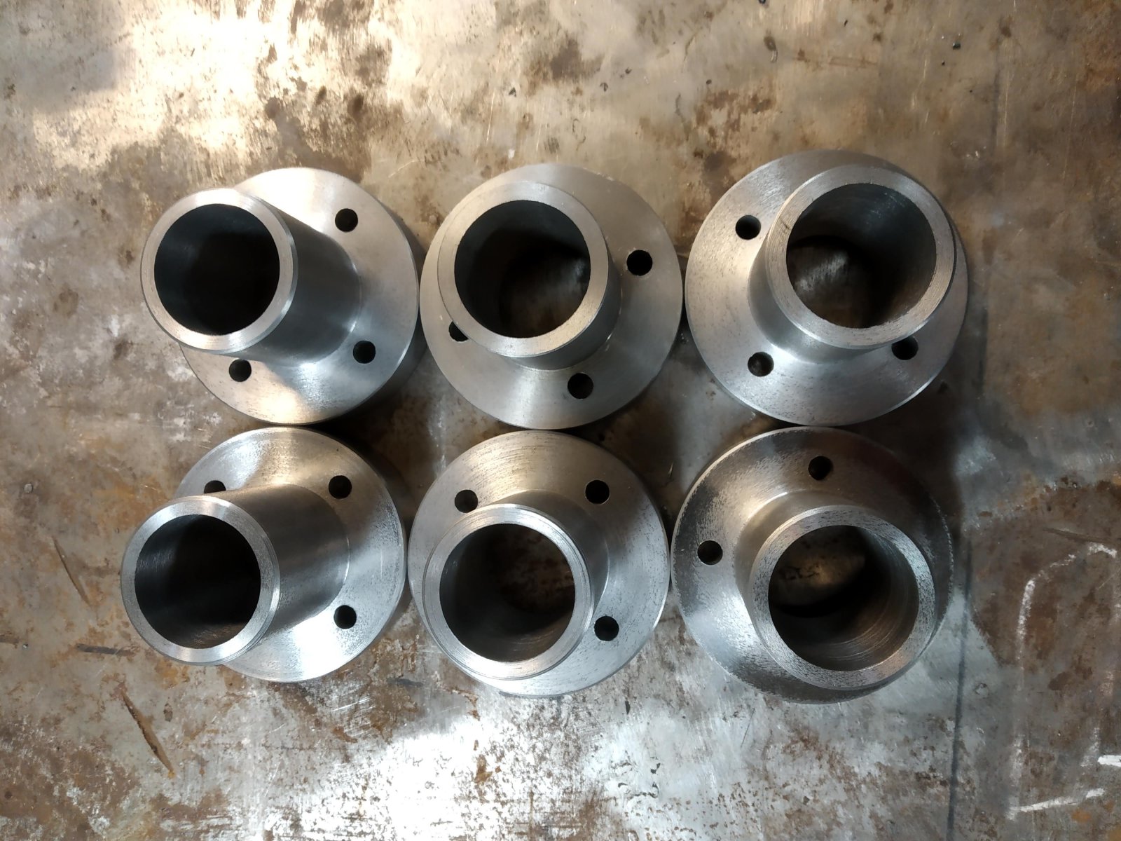

    Hello, I want to share with you my 6 dof project, I'm verry bussy building it. I'm building this as a graduation project.
    Here are some pictures:
    upload_2019-1-13_11-47-6.png IMG_20181125_115822.jpg IMG_20181125_115925.jpg IMG_20181125_120110.jpg IMG_20181125_120338.jpg IMG_20181127_181942.jpg IMG_20181125_120338.jpg IMG_20190103_165850.jpg IMG_20190105_120141.jpg IMG_20190105_231429.jpg
    If you have any questions please send me a message, if you have advice, send it to me ;-)

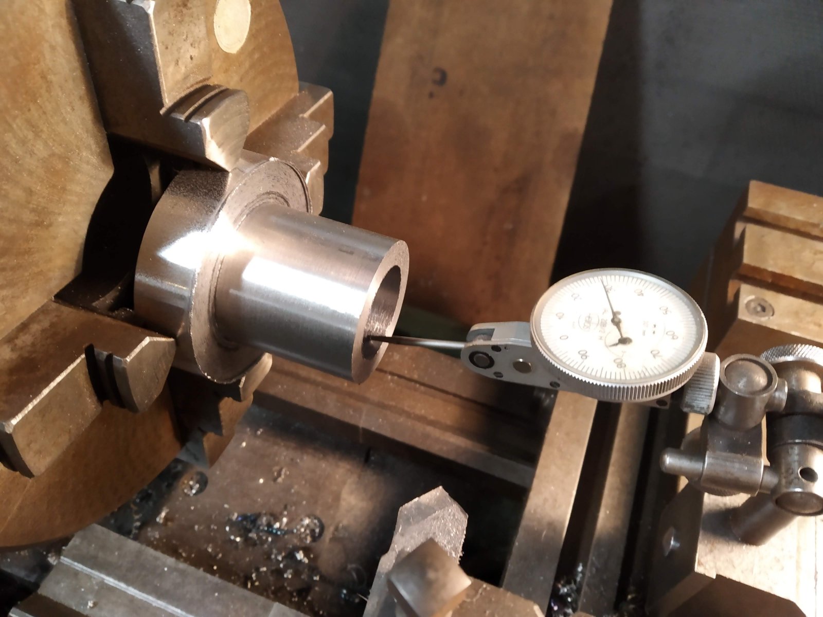

    hi @Carelsbergh_Stijn welcome to the forum and have to say your actuators have the makings of being quality units , do you have access to machinery or are these parts custom made by sub contracted machinist ?
    great to see another 6DOF project on the go , so like all the other followers , were looking forward to the development and progress of this version ..Lovely workmanship already and this is early days for you .. great stuff :cheers
  3. Carelsbergh_Stijn
    Carelsbergh_Stijn Member
    Jul 19, 2018
    58
    Belgium
    450Coins
    +58 / 0 / -0
    I'm making the parts myself, I have a lathe and a milling machine.

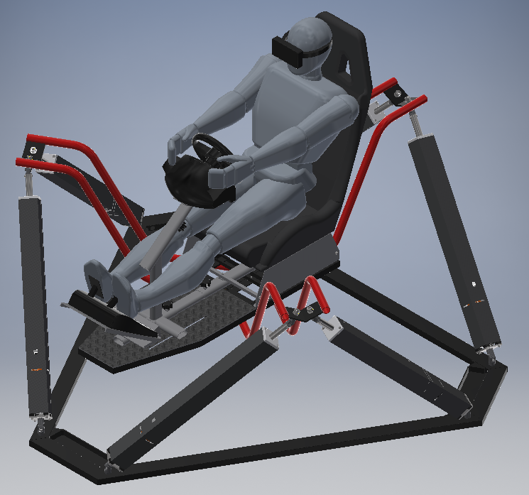

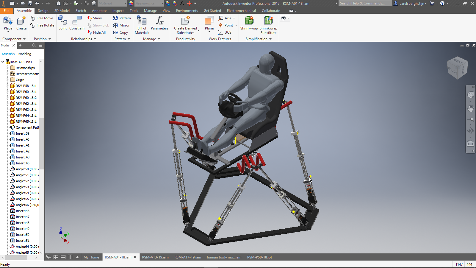

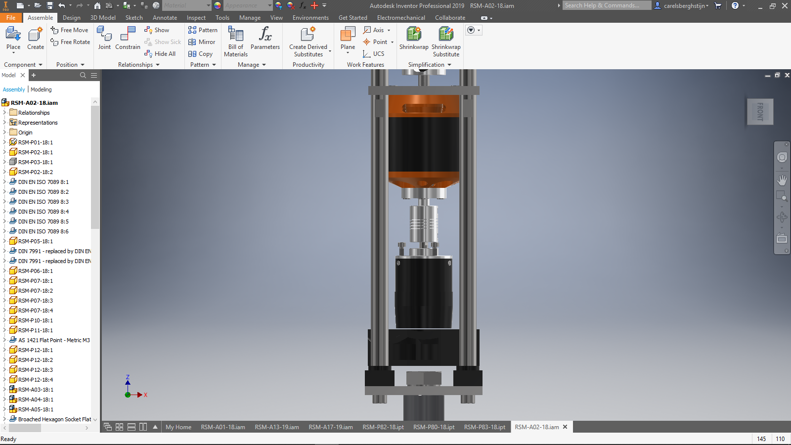

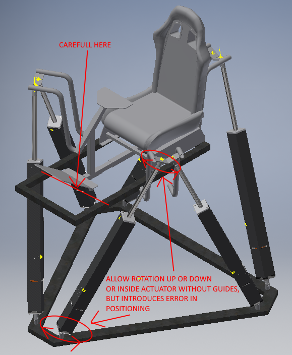

    I don't know the lengths yet but I can just chance them and everythings addapts to that, so no problem

  9. pmvcda
    pmvcda aka FlyPT
    Nov 3, 2010
    2,180
    Portugal
    15,391Coins
    +2,601 / 17 / -0
    Using ODrive? Curious to see the result.
    This drive/motors is on my radar for some time and if it works, it's a great and simple alternative.
    Be careful with the size in the feet area.
    Also, you have to allow rotation on the top or bottom or inside the actuator.
    In your drawing it's not visible, but with such a simple mounting, looks like there's no rotation allowed:
  10. Carelsbergh_Stijn
    Jul 19, 2018
    58
    Belgium
    450Coins
    +58 / 0 / -0
    I don't know if this is correct but I've not seen a 6 dof simulator with universal joints that allows roation of the actuators, but what I have seen is when using rod ends instead of universal joints, they do alow it, maybe you can tell me if this is correct?
    Do you have any suggestions on what to change on my design? for example get the tops of the actuators further appart? I already knew about the feet area, It was just to give an idea, this needs to be changed. my botom radius is 750mm, is this ok?
    many thanks
  11. pmvcda
    pmvcda aka FlyPT
    Nov 3, 2010
    2,180
    Portugal
    15,391Coins
    +2,601 / 17 / -0
    In my rig, I allow the top joints to rotate.
    It's no the best design, in my case. It has some play: https://www.xsimulator.net/communit...shless-diy-actuators.10799/page-6#post-163059
    You can do something similar or allow the actuator to rotate removing the internal guides. Rotation will be limited by the ujoints, so it still works.
    Removing the internal guides makes the actuator simpler, but if you are using positioning by rotation encoder, it will introduce an error, because one rotation on the motor might not be an exact rotation, since the actuator is compensating the fact of the ujoint being "solid".
    You could correct this by software, but it's not easy. You need inverse kinematics in real time for each actuator.
    I would go with first solution, like I have done, unless you where using a belt system with encoder/pot to detect position.
    But try to put a roller bearing or a good pivot. It's something I need to change.
    I think 750mm radius is enough, I'm using less than that. I wanted it to be compact.

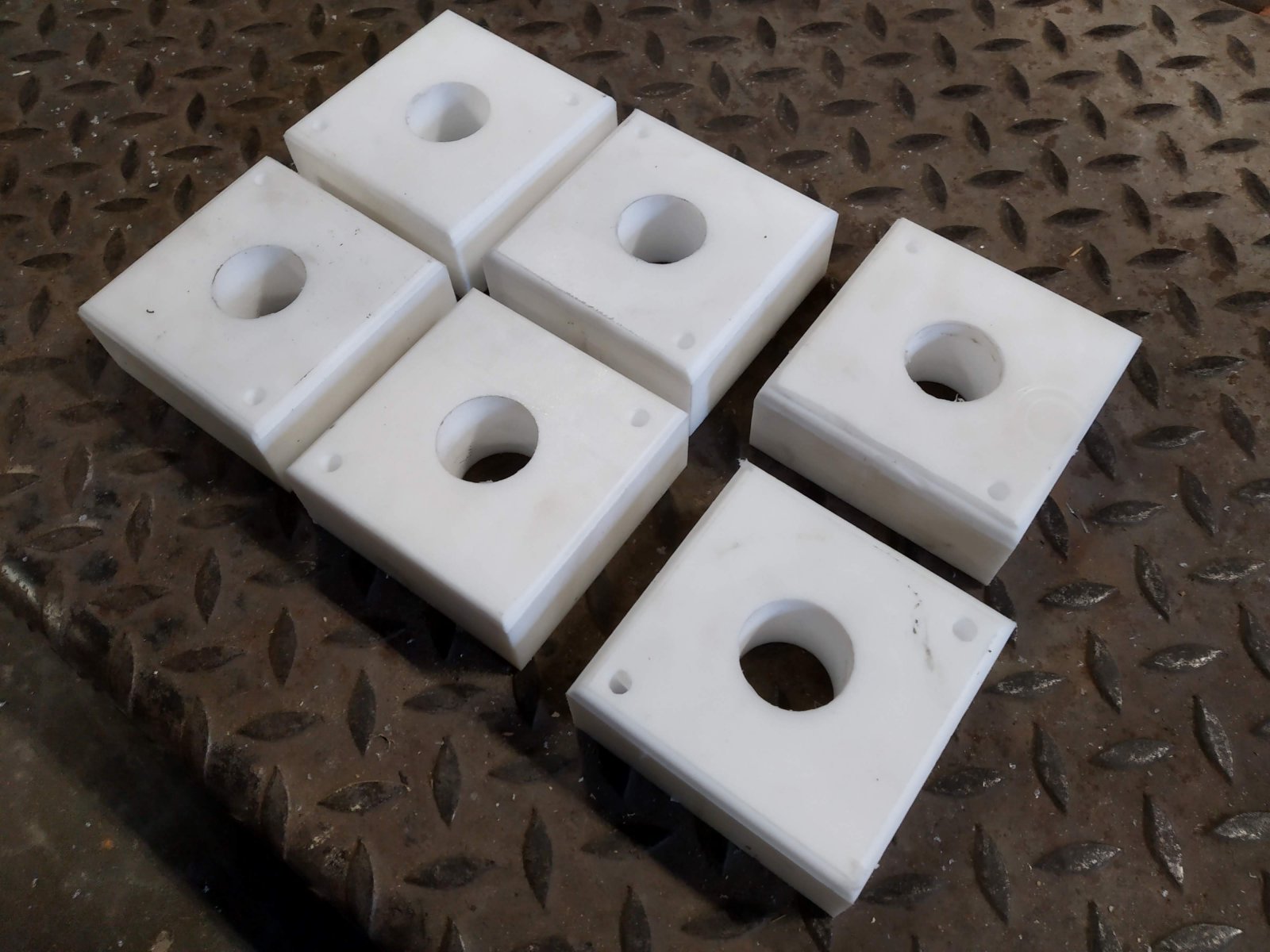

  12. Carelsbergh_Stijn
    Jul 19, 2018
    58
    Belgium
    450Coins
    +58 / 0 / -0
    The actuator doesn't turn much so if I program my system to not use the last 5mm of the actuator in the case that the actuator is rotated a little bit, could this solve the problem? I don't have a problem with the disseret angles not being perfect. (my actuator can turn inside the guiding block)

    For example, if you make Yaw, your joints must allow rotation.
    Or you can use a solution like @JAD (https://www.xsimulator.net/community/threads/jads-6dof-with-ballscrews.11686/). Where the actuator can freelly rotate. There's no guide, the guide is the joint that doesn't rotate.
    What I mean in the last post is that in this case (JAD), one rotation of the motor is not always the same travel, because you are compensating rotation on the ball screw.

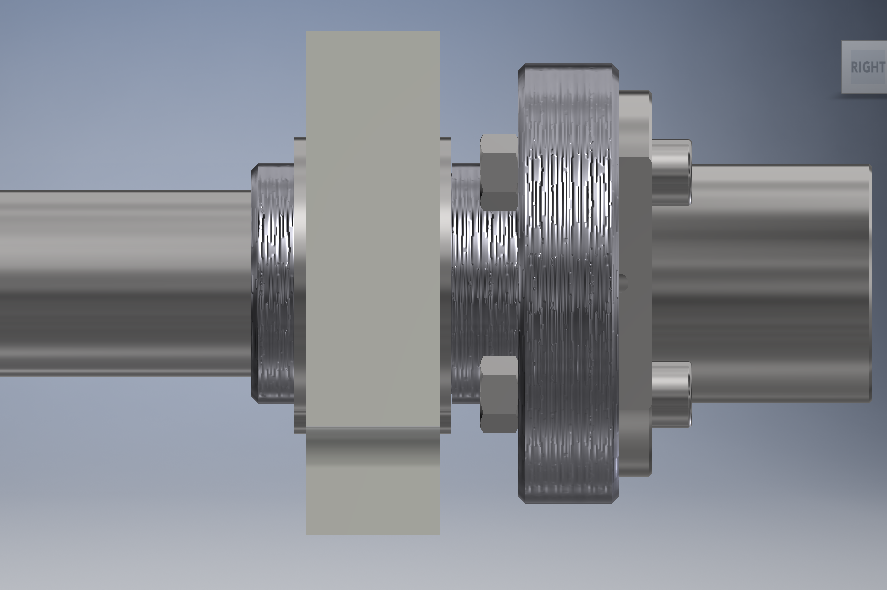

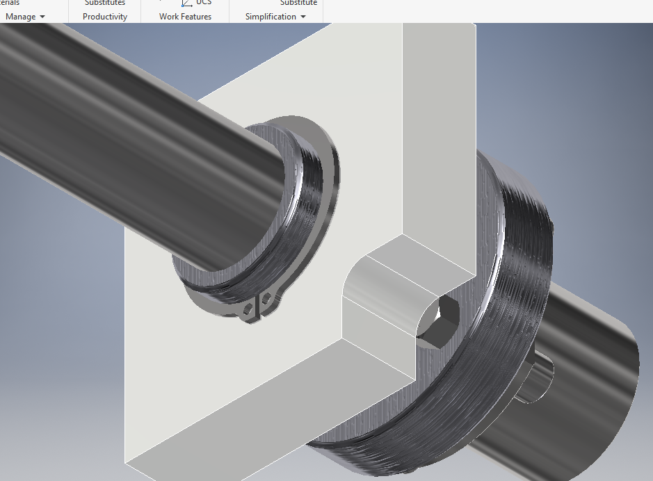

  14. Carelsbergh_Stijn
    Jul 19, 2018
    58
    Belgium
    450Coins
    +58 / 0 / -0
    Hi
    as you can see in the pictures, my guide block can rotate freely (it is held onto the metal with 2 circlipses), so there is no problem of the guiding block blocking the rotation:
    so the top part of the actuator is free to turn from the botom part, is there still another problem?
    Kind regards
    Carelsbergh Stijn
  15. pmvcda
    pmvcda aka FlyPT
    Nov 3, 2010
    2,180
    Portugal
    15,391Coins
    +2,601 / 17 / -0
    Ah, OK,
    I don't see other problems.
    Waiting to see it moving! :thumbs

    Thank you for the quick response, so the only disadvantage of doing what I do is that the encoder reading is not always 100% correct with the real position?

    I would recommend using track rod ends rather than universal joints they can get notchy at some angles and How's is your encoder setup any pics?

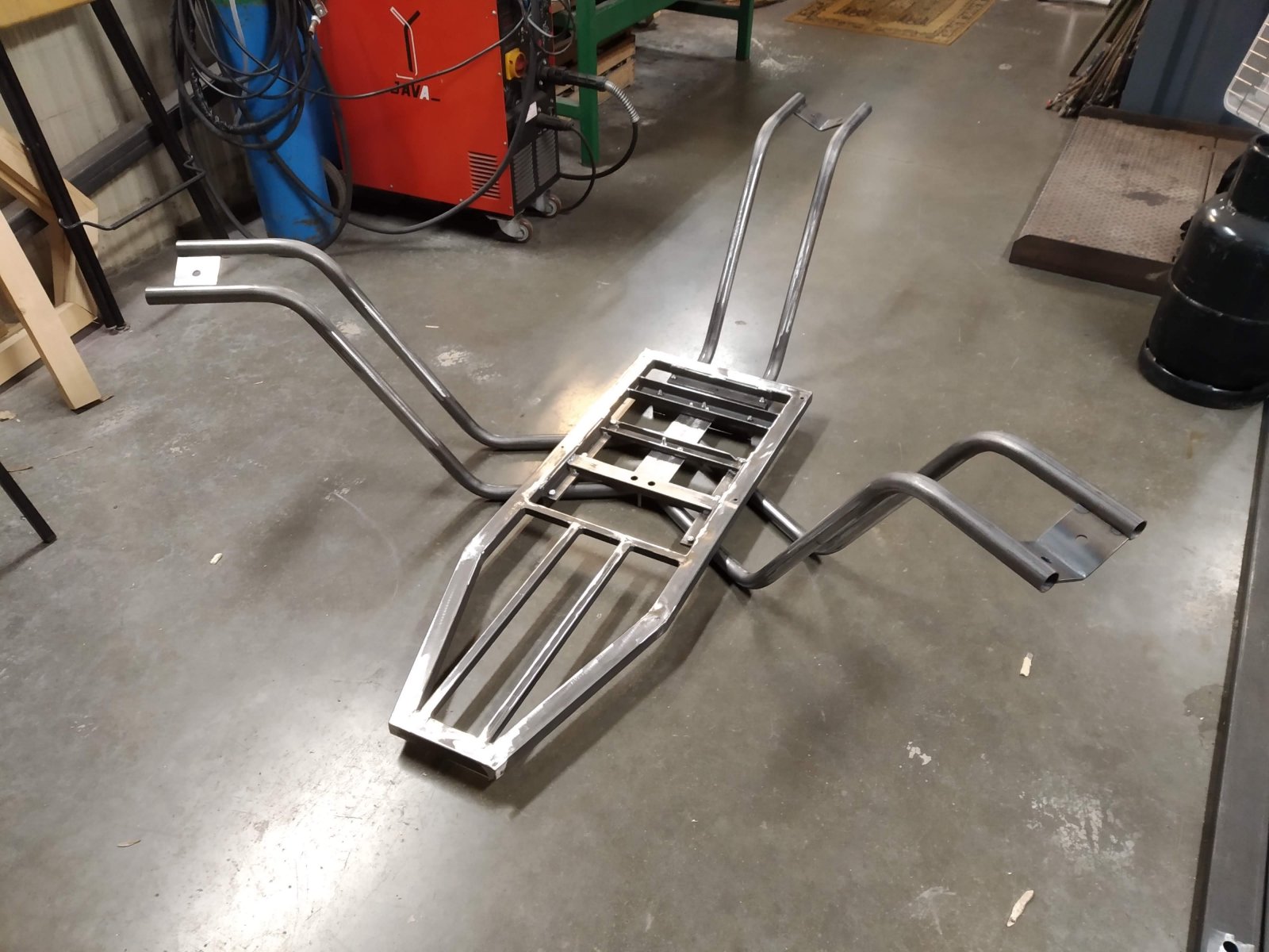

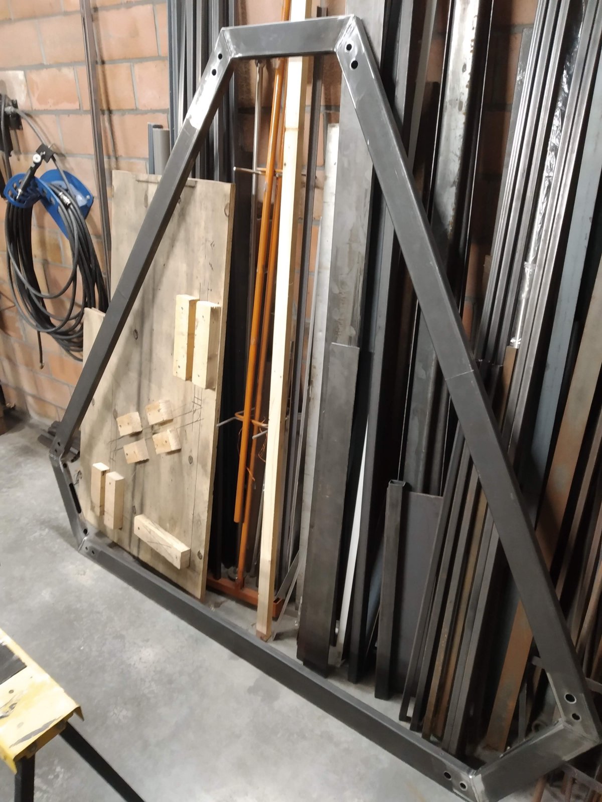

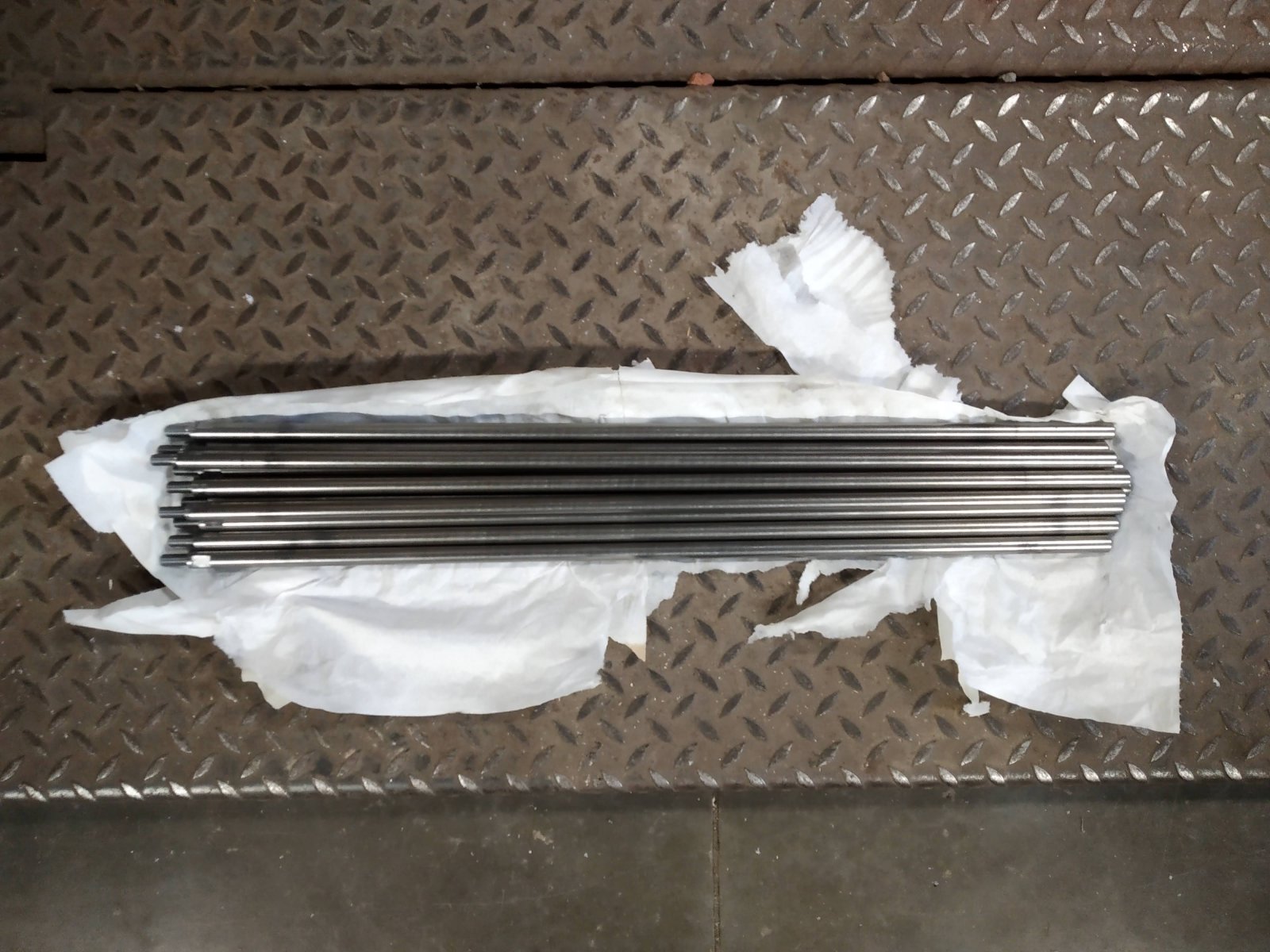

    small update on my project, all the parts for the actuators are done, now I'm starting on the frame.
    Cheers
    Carelsbergh Stijn

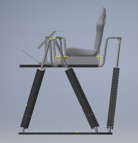

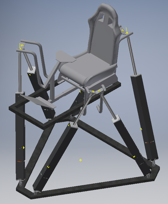

    Hi
    my frame is finished
    And my drawings too ofcource:
    Now all that's left is programming the thing, I have already asked for a DIY licence twice and I don't get a reaction, does anyone know why?
