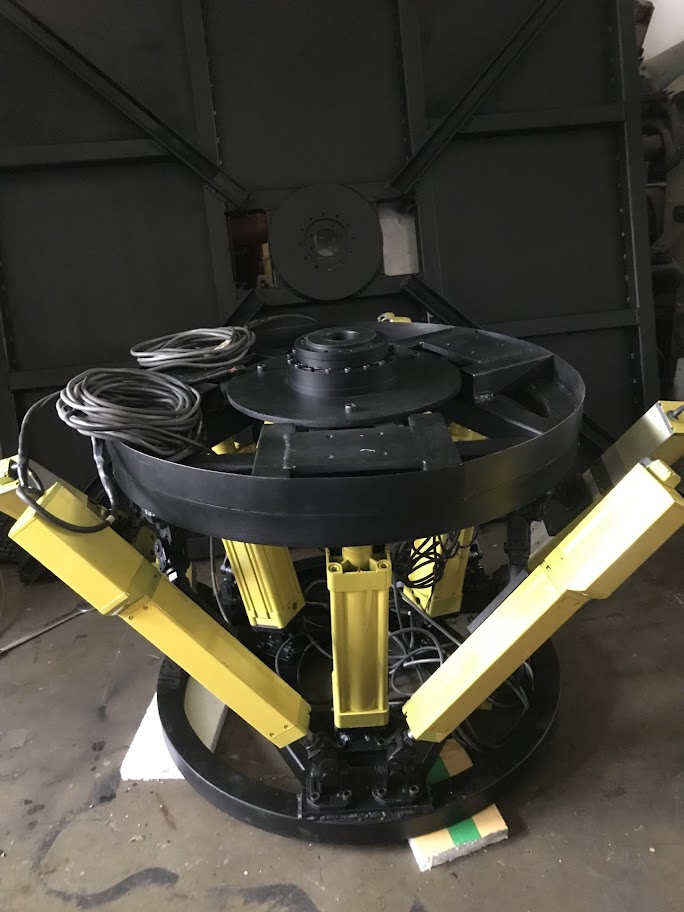

    Hi everybody.
    this was completed last month.
    it still needs to be
    more perfect.

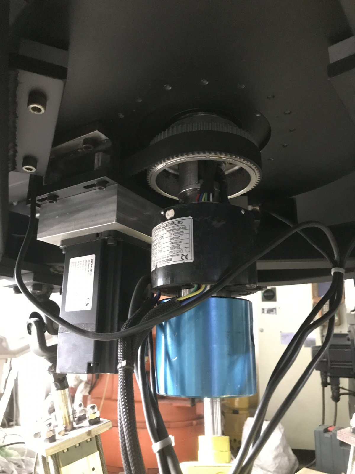

    Can you give a bit more detail about the rotation design and implementation?
    I am also curious, given the relatively narrow base is it bolted to the floor?

    yes, it is slid to the floor by 4 12mm bolts.
    The Rotary is used with a 1:160 size 45 harmonic gearbox.
    This is first design.

    I use slip ring to prevent cable kink
