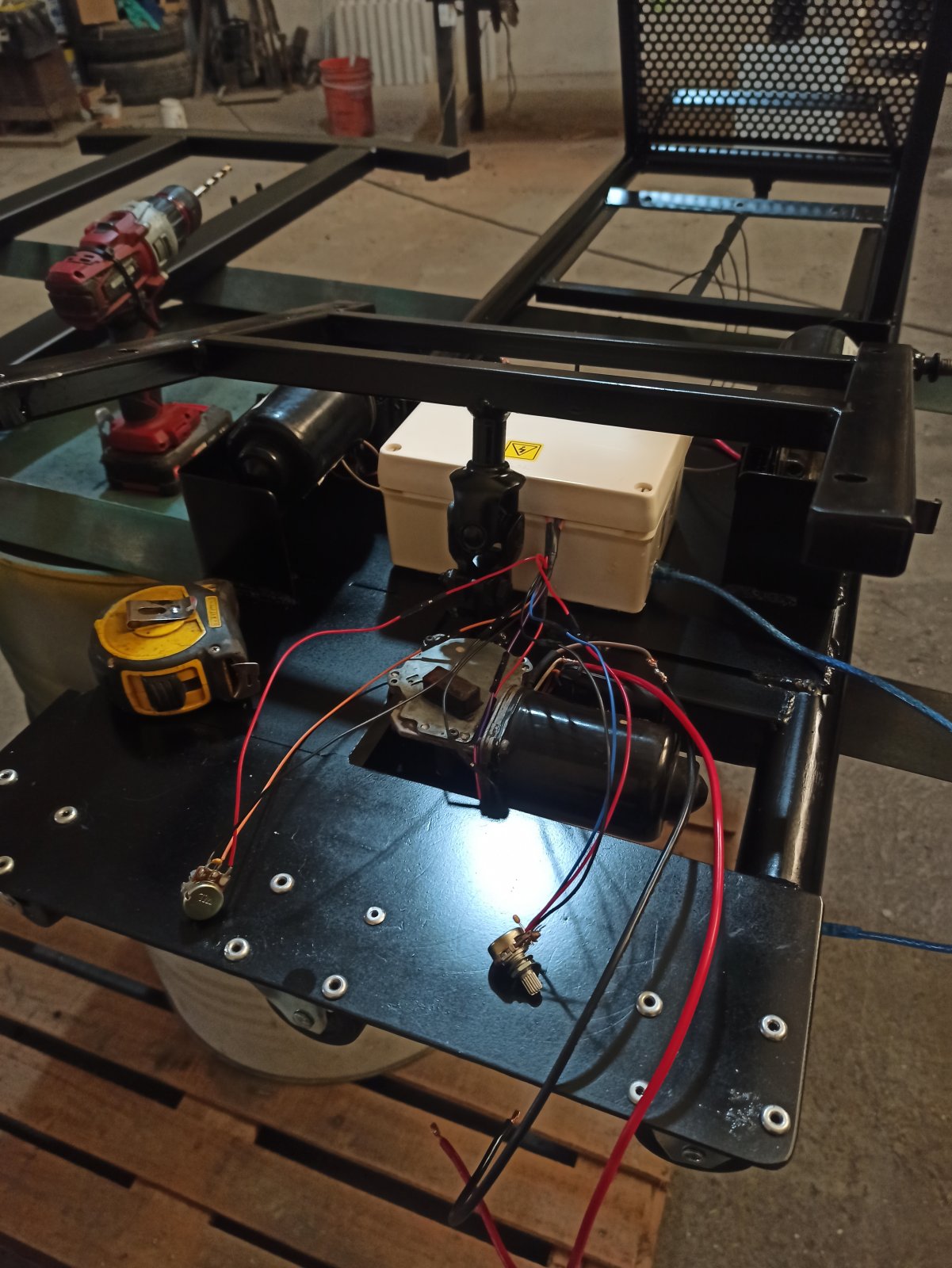

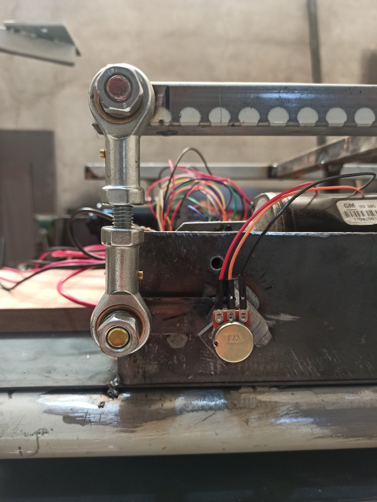

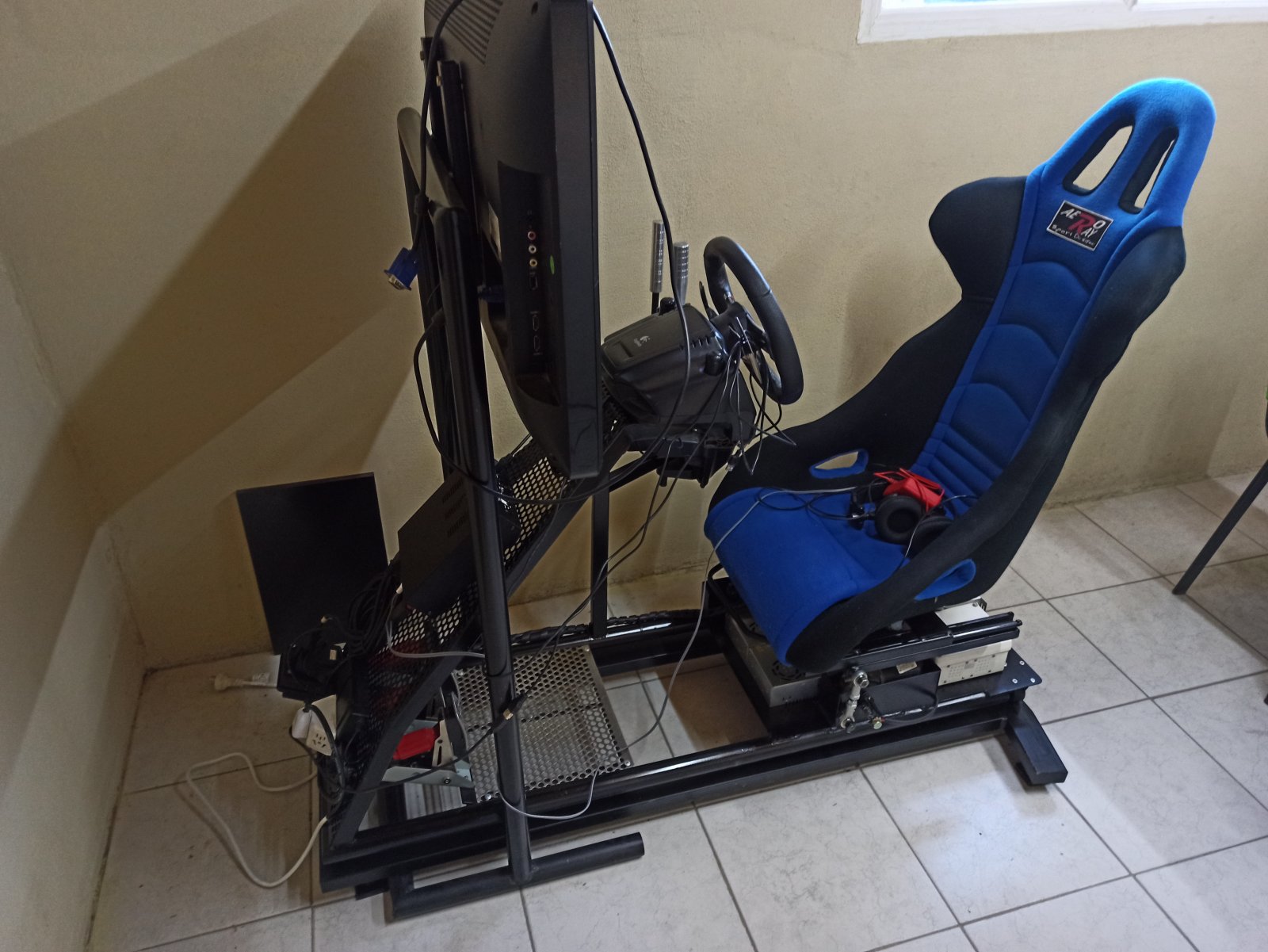

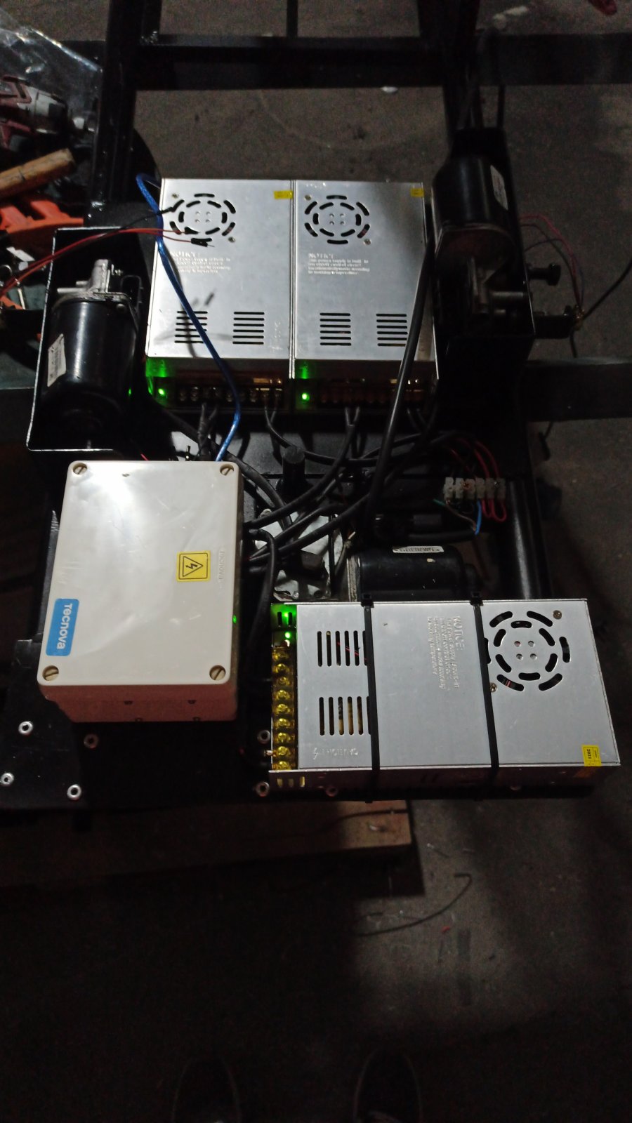

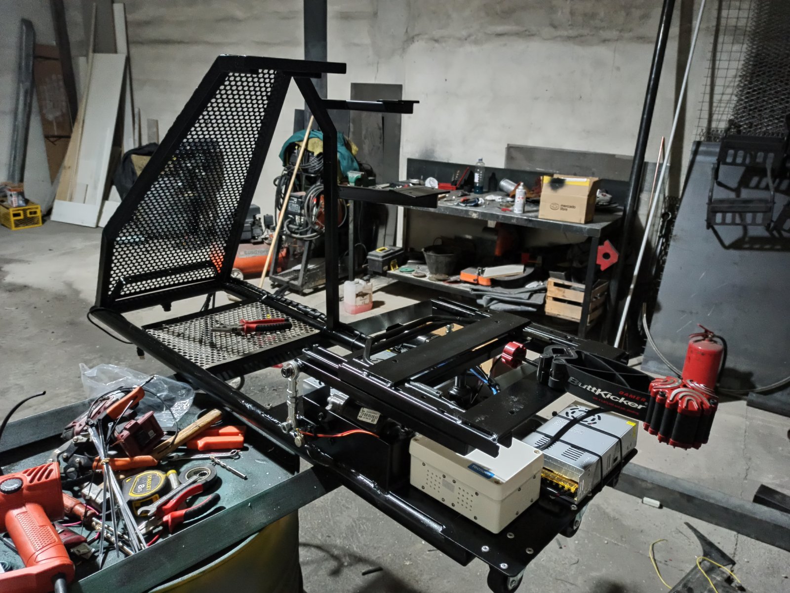

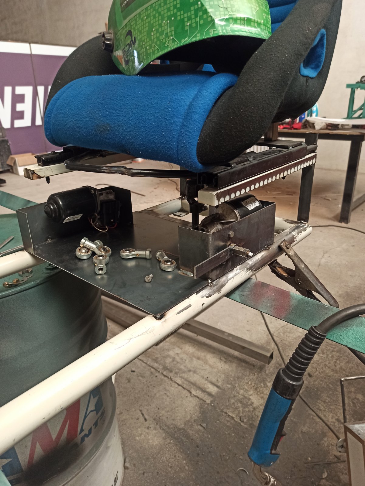

    Hello everyone, I am new here. From Argentina I am building my 3dof from a static structure that I had a while ago. Thanks to the SCK Gaming tutorial I was able to do it and now it only remains to be able to download the plugin for dirt 2.0. At this stage I also add a buttkiker that the truth gives an incredible realism. Later I will go for some oculus to make everything more real.

    I presume those are wiper motors, are they ground isolated?

    hello, if they are wiper motors and are insulated from ground. For the moment they work correctly. You would have to check the temperature after a few hours of use

    Hello friend, for me that weight of 70kg is a very good option. I use Chevrolet Corsa wiper blades. The levers are 5cm long ...
