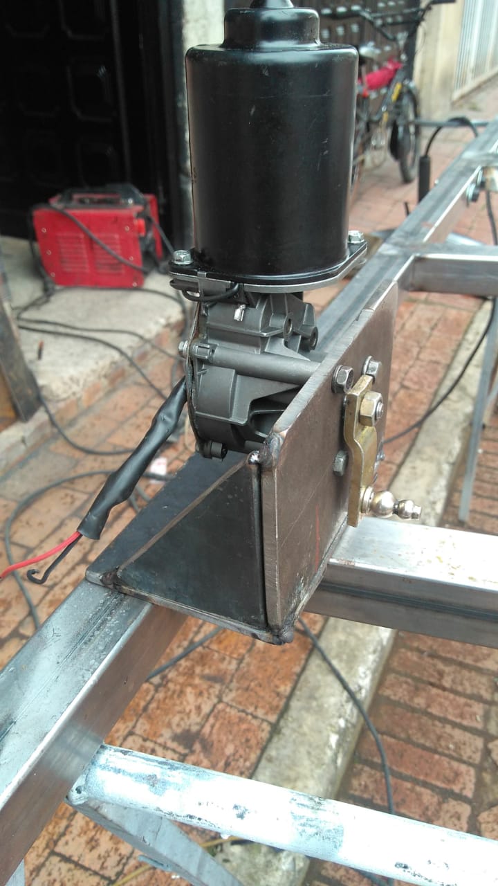

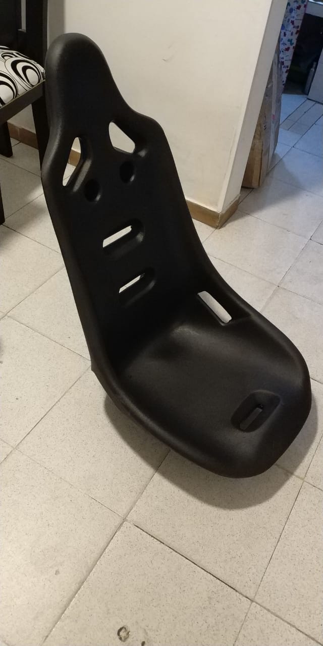

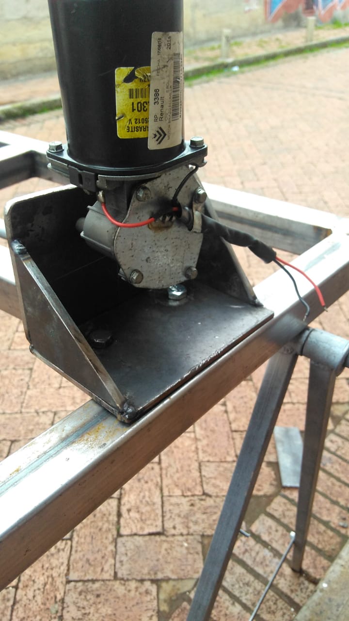

    Hi.
    I´ll show you my updates on this project with photos.
    Thanks for your comments.

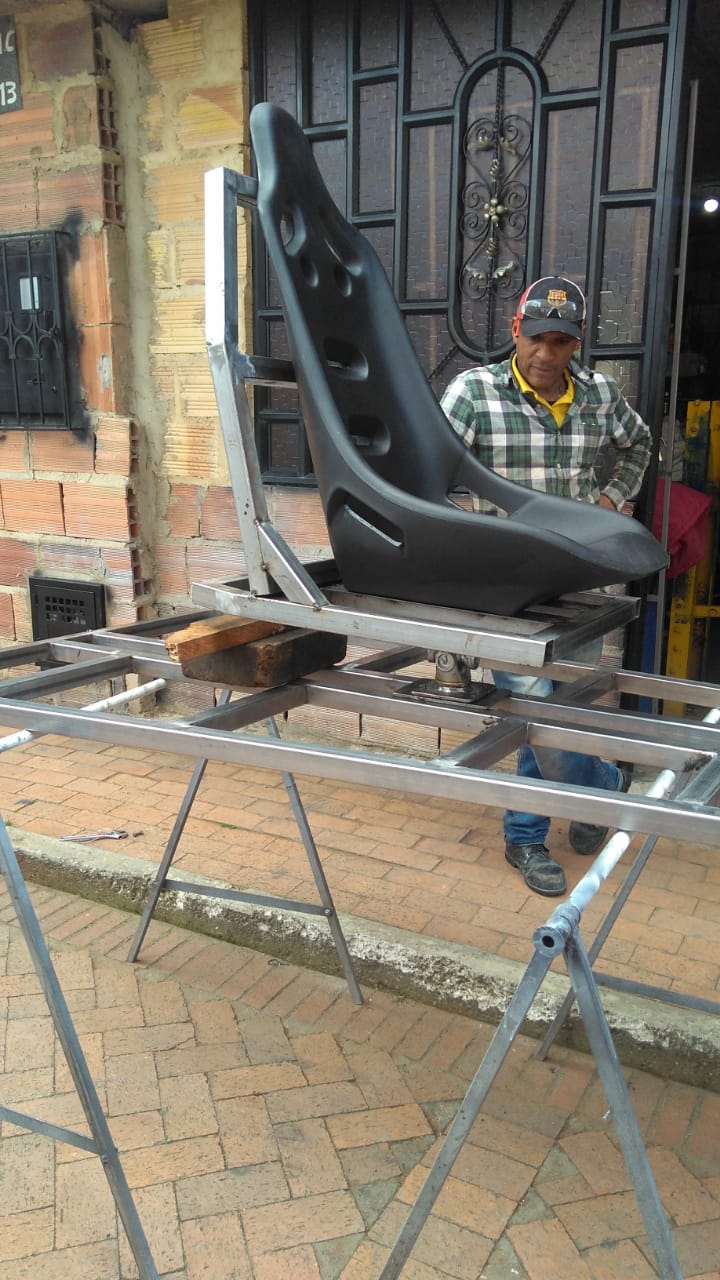

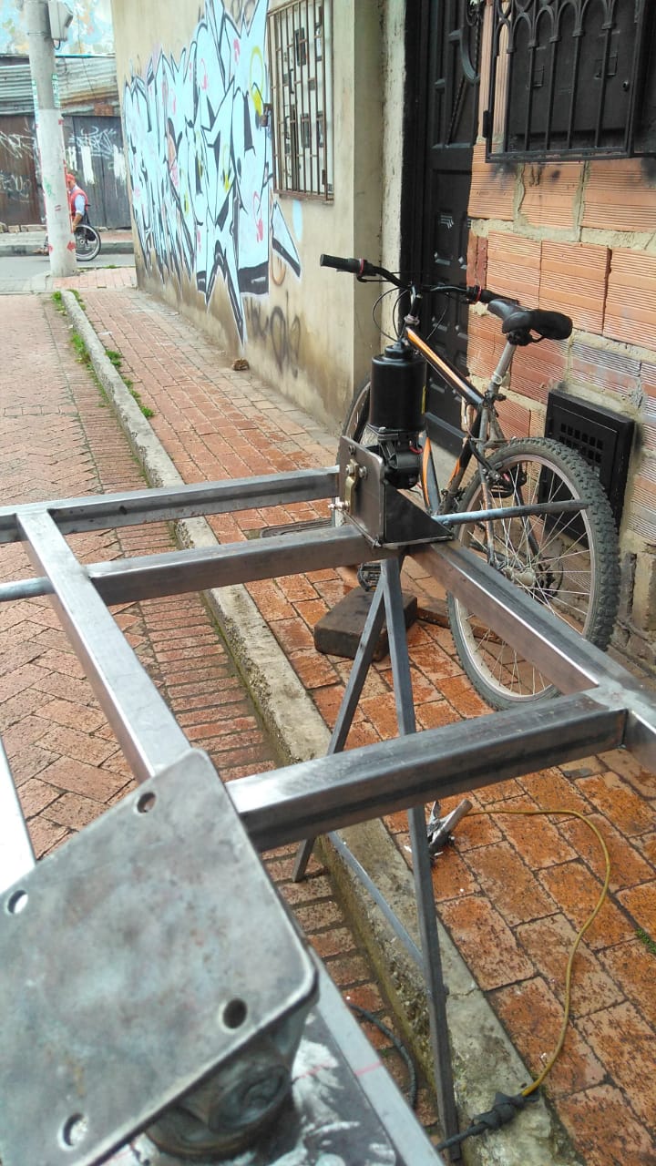

    The begining

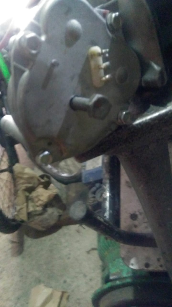

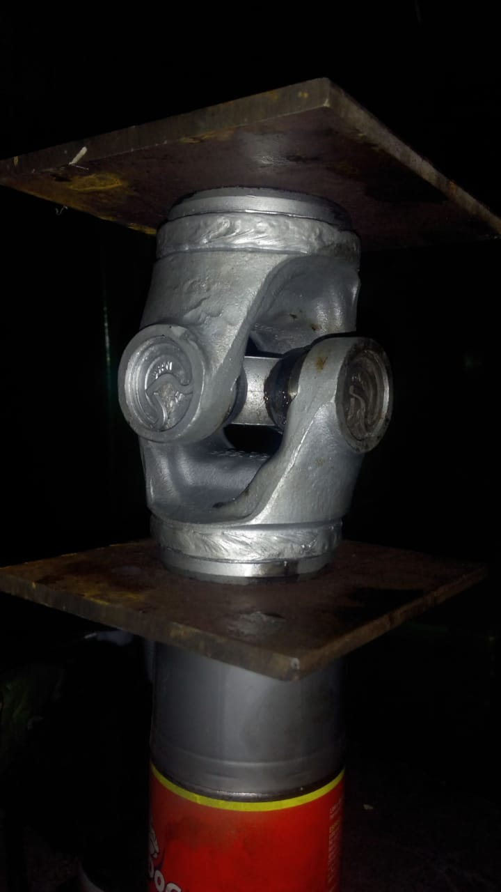

    Working on it.

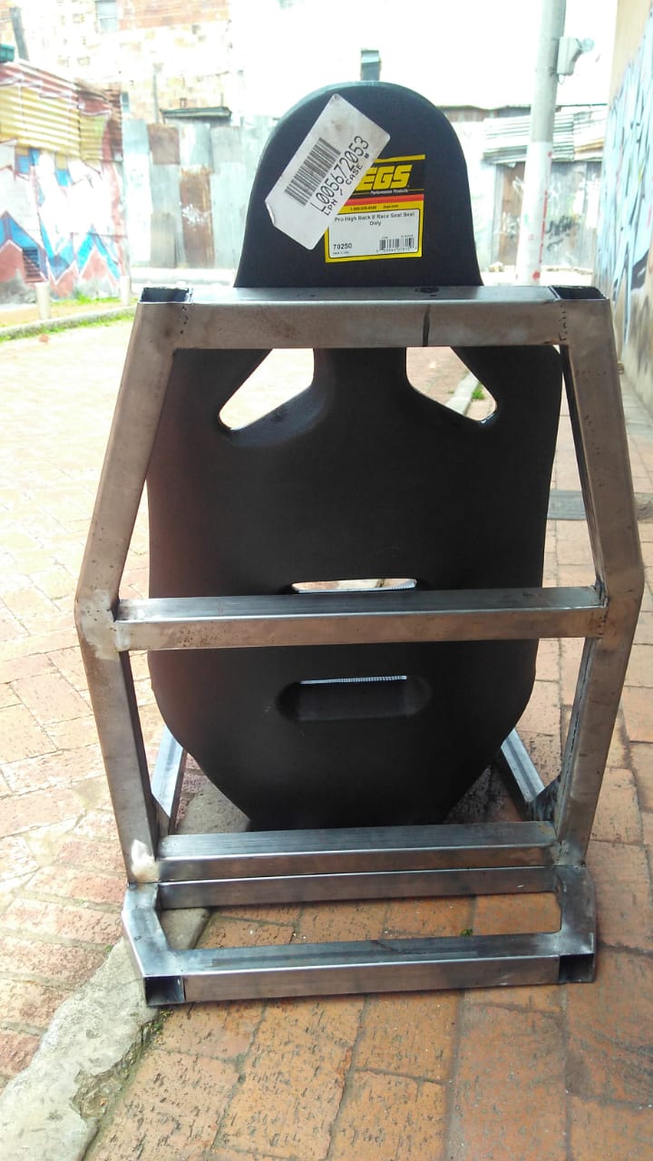

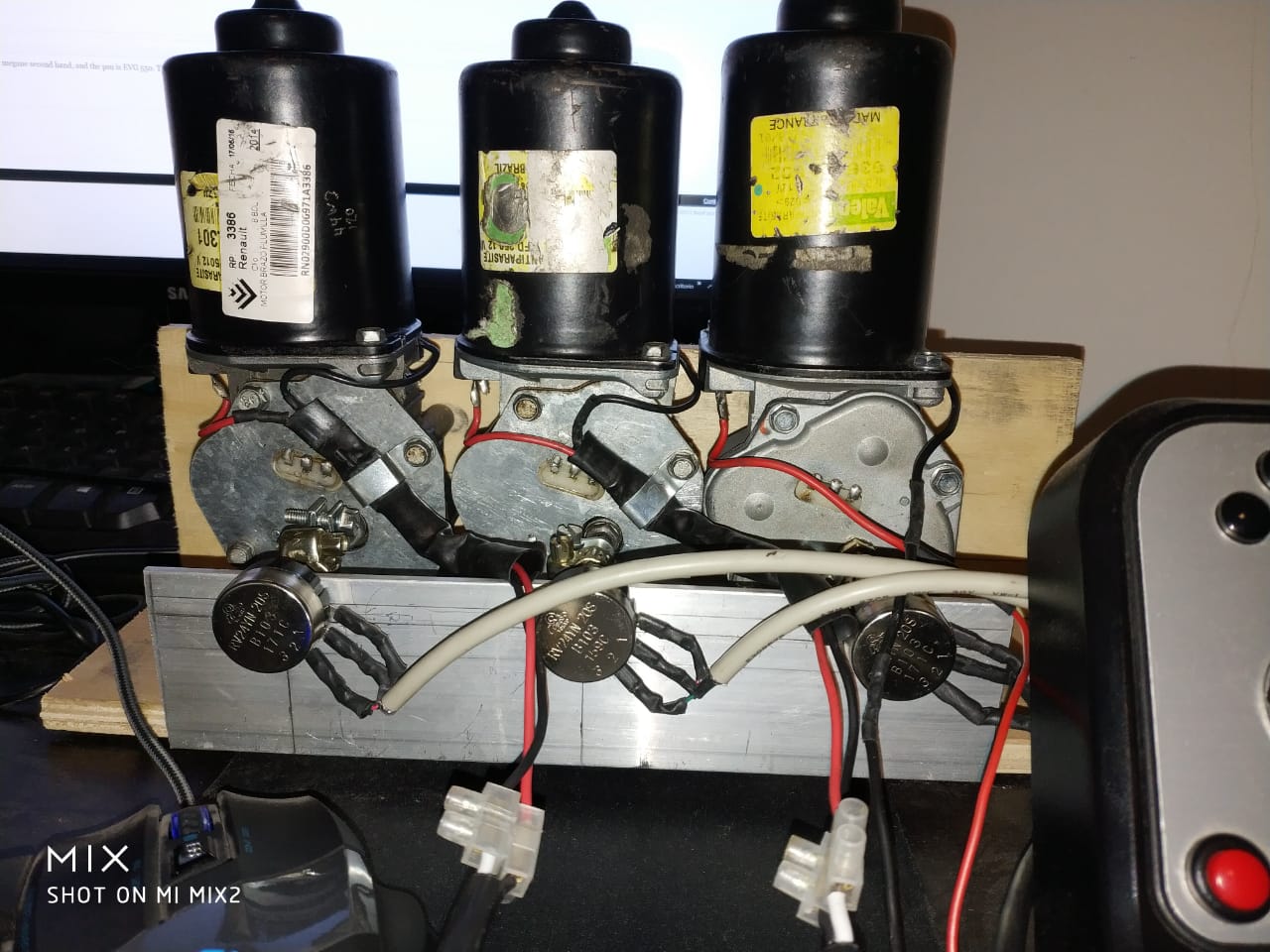

    More Photos

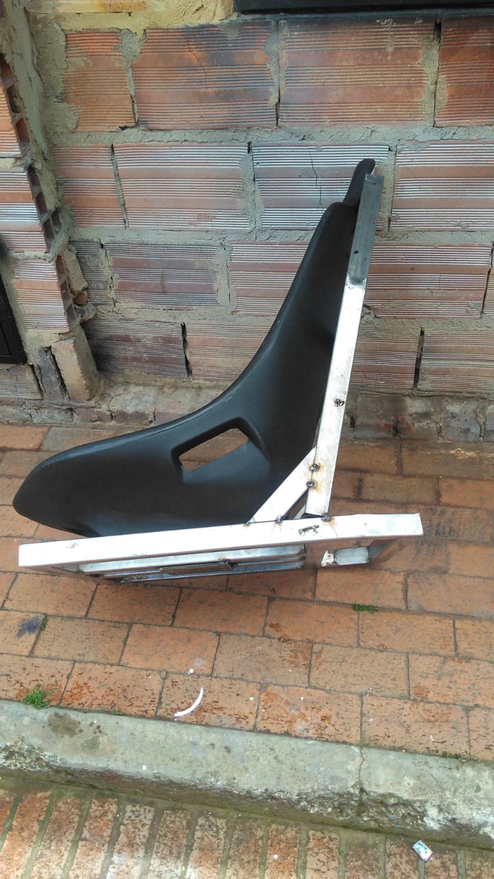

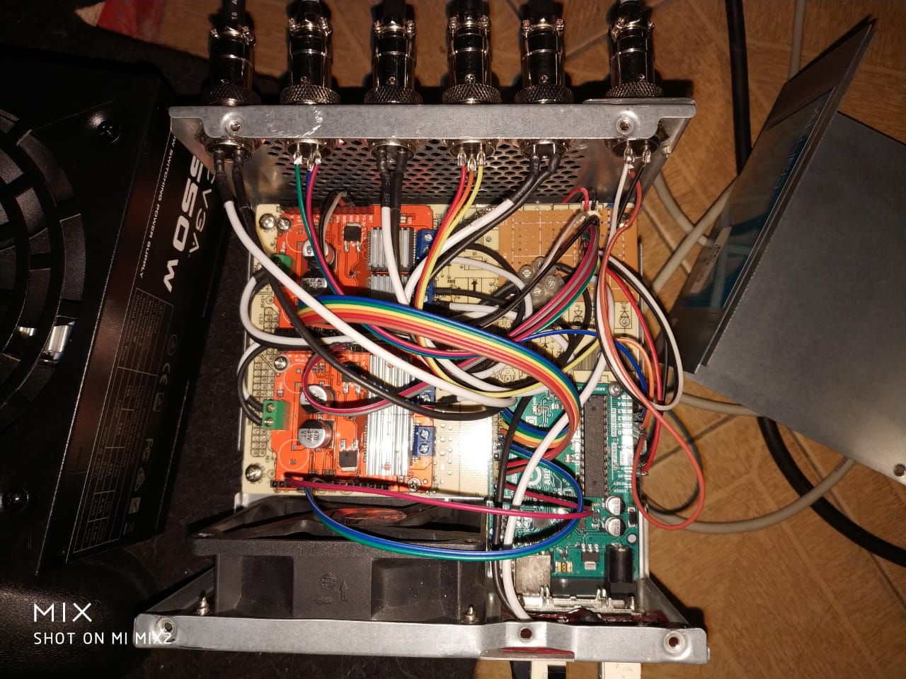

    Almost done

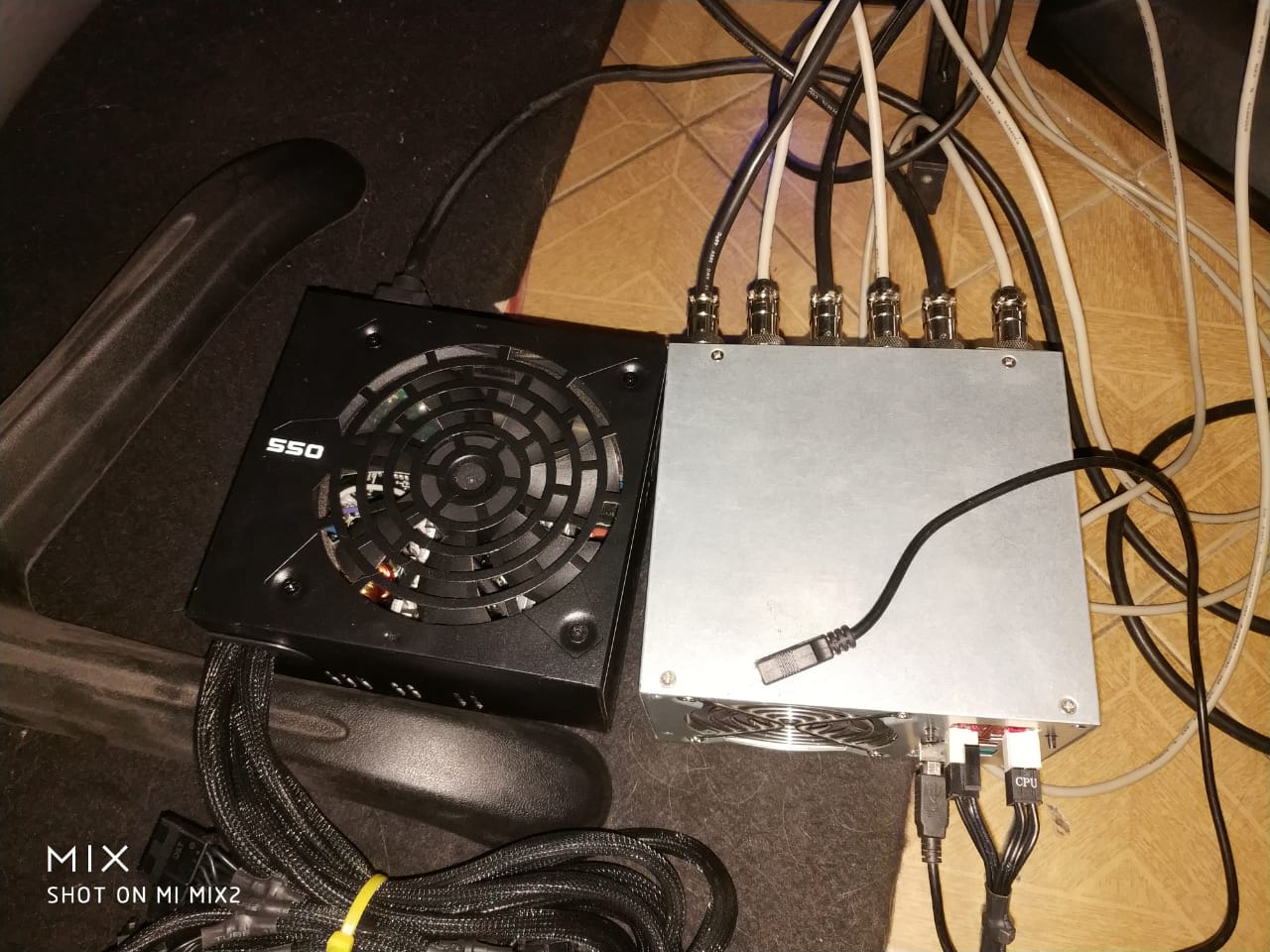

    Great progress so far :thumbs
    What brand of control boards, pots and PSUs are you using?
  7. Yafar Abdala
    Yafar Abdala New Member Gold Contributor
    Jun 18, 2018
    7
    Colombia
    - 97Coins
    I´m ussing arduino uno and two sparkfun moto driver, with the smc3 3dof configuratión. The pots are renault megane second hand, and the psu is EVG 550. Till now I havent test it I hope do it this weekend. I´m not sure if one PSU will be stable. If not I will add another.
    With this PSU without any weigth the 3 engines move well.
