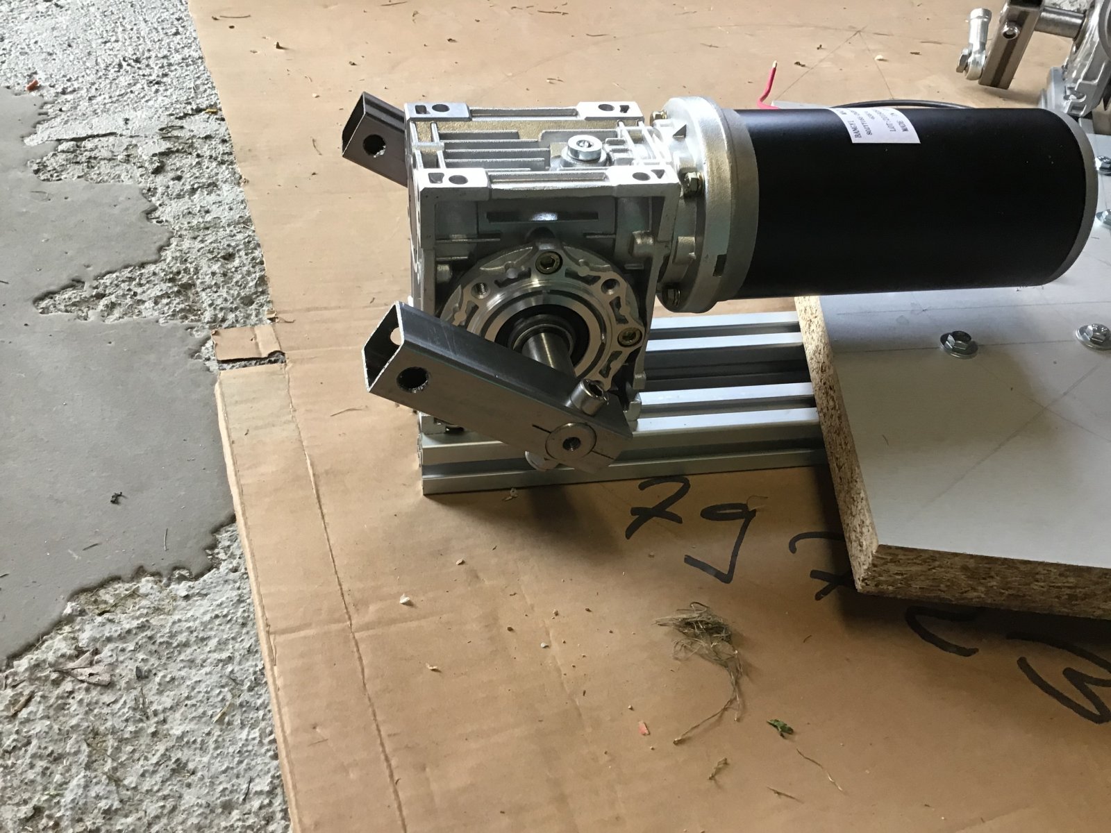

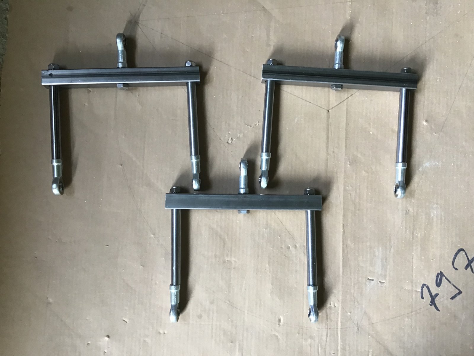

    Hi guys. here are the latest news. this week I made the cranks:
    25x25 steel tube
    between axis 70mm
    The most complicated was drilling at 18mm and the holes are coaxial.

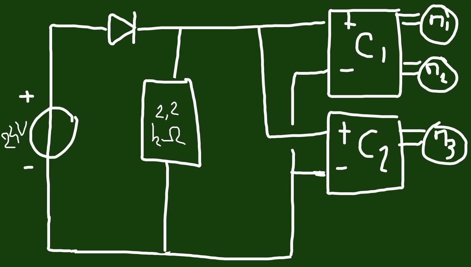

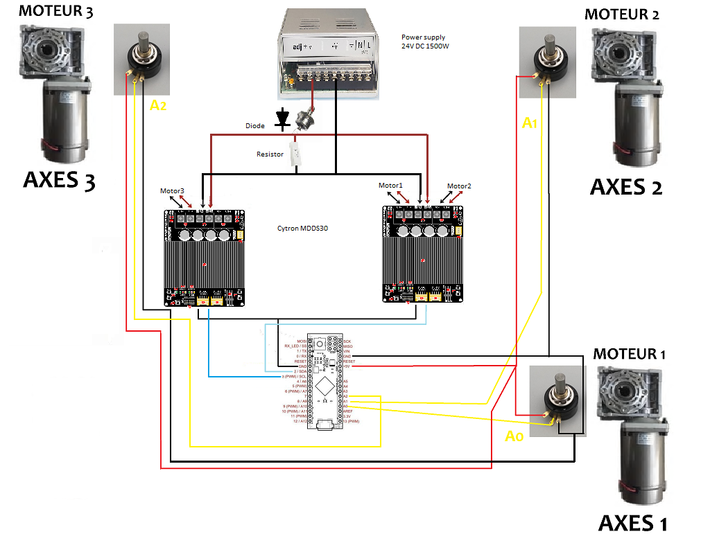

    Hello everyone. can someone reassure me about my motor controllers? they are not protected against regenerative currents and I thought I would use this circuit to protect theme. power supply 24V 1500W

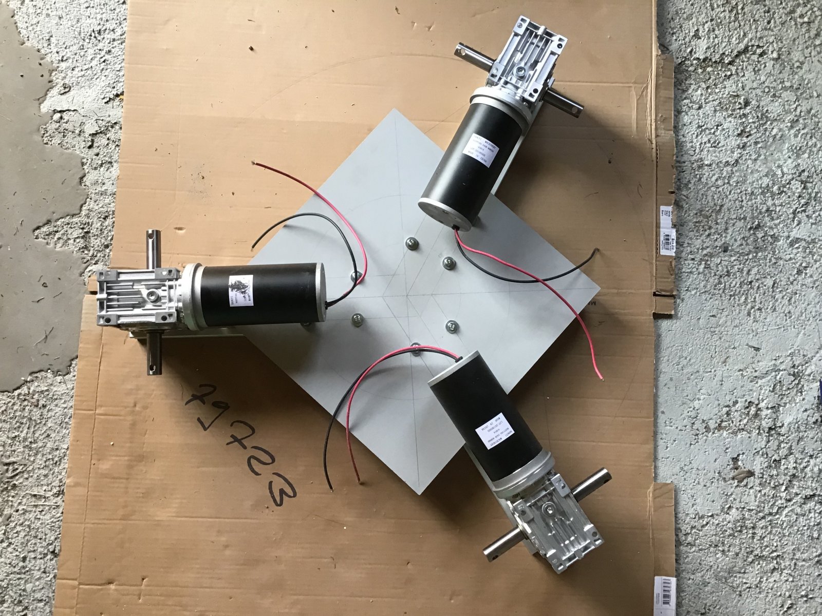

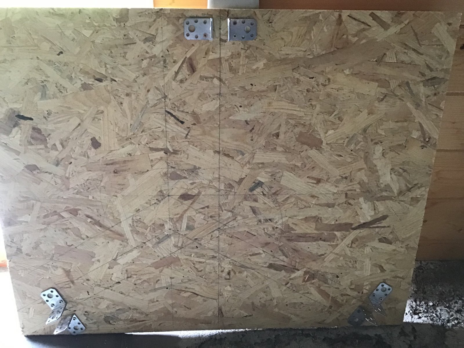

    I also made the « deck »
    Next step assembly

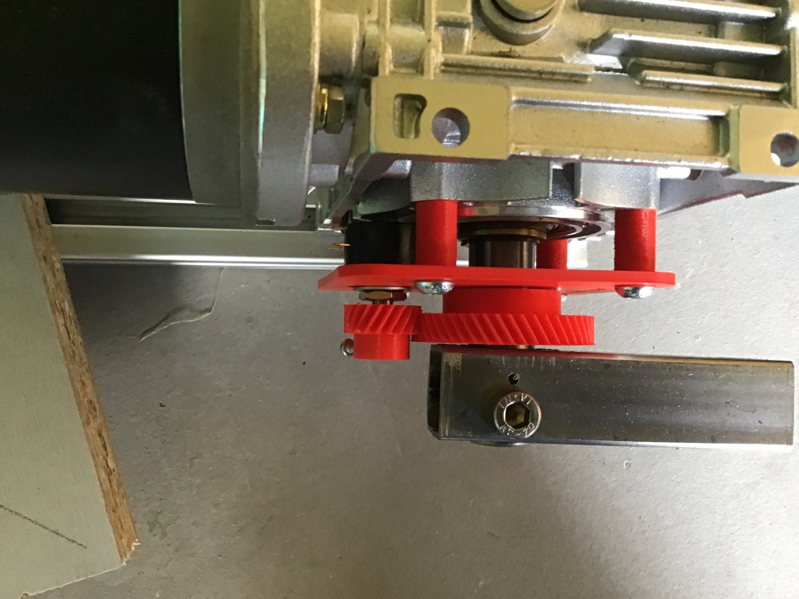

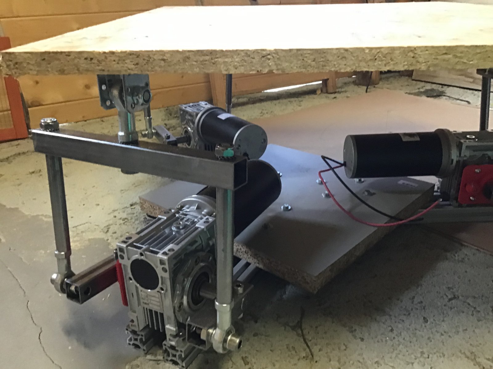

    Hello
    Today i made the plate and mount the mecanic of my 3DOF C7DA8417-C687-4893-BB1F-729D44DA3AE9.jpeg
    There is a little radial displacement with my cranks and worm Gear but it seems ok
    Next step is électrique and electronic assembly

    Hello evryone !
    Today i post the electric plan of my project

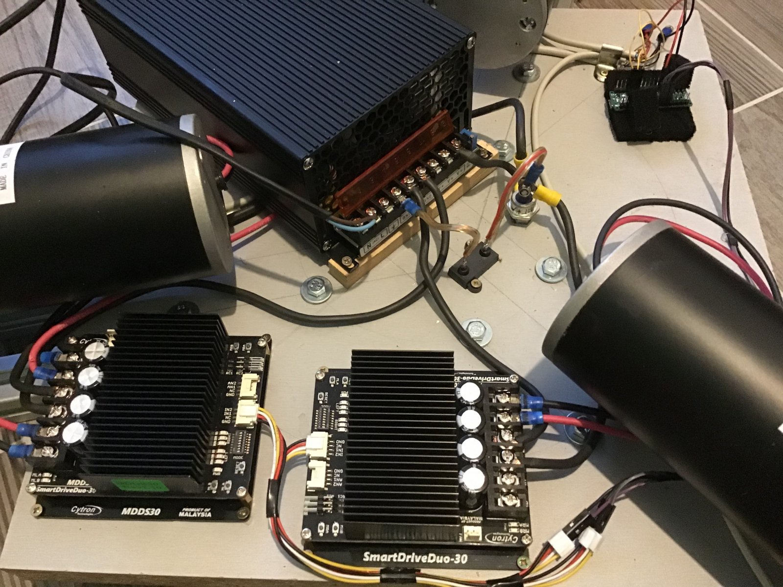

    This WE i made the wirering of my project
