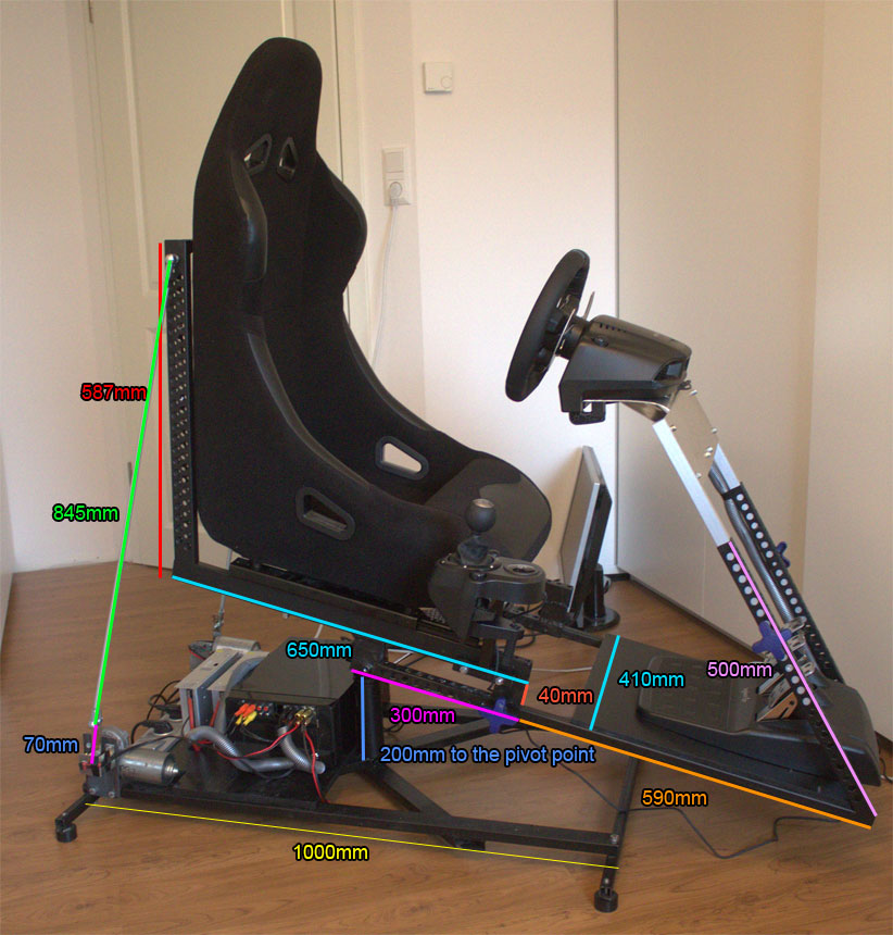

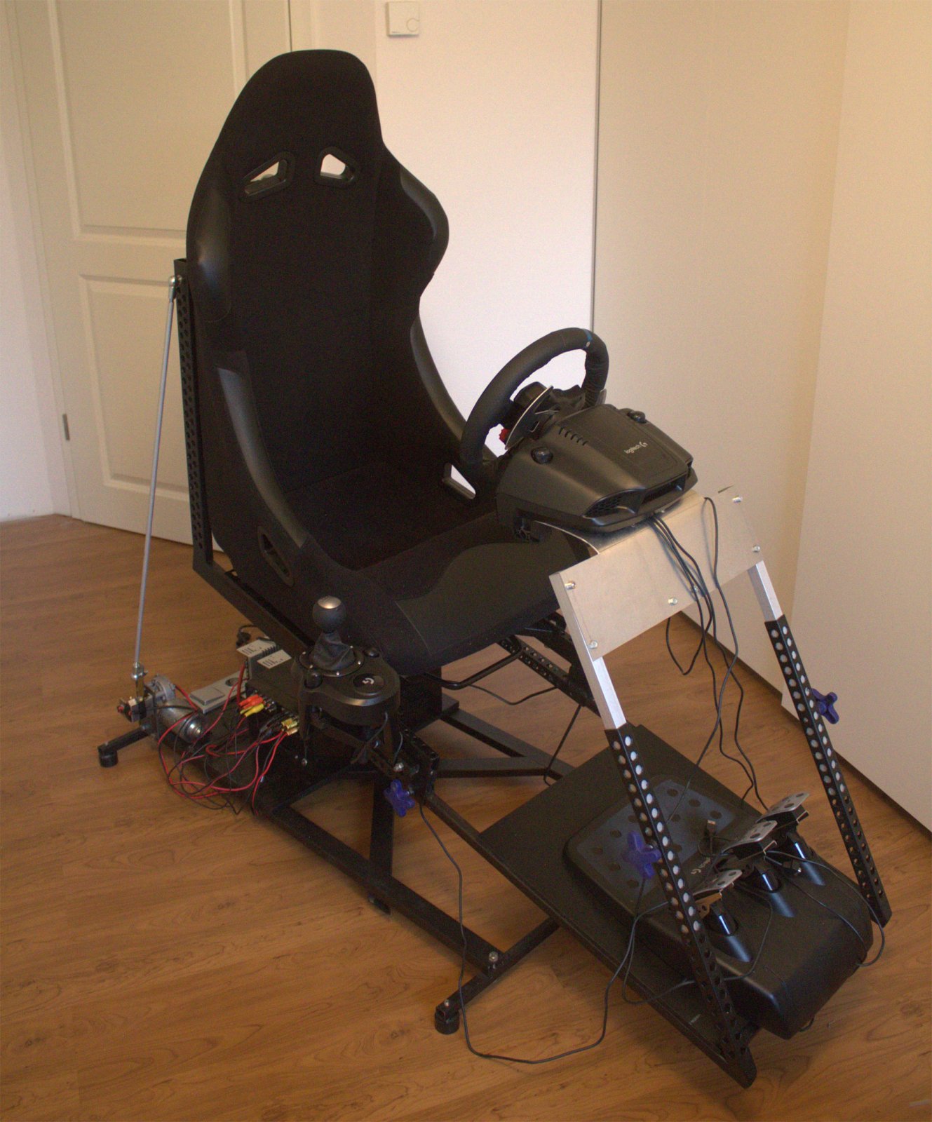

    Finally, the first pictures of my 2DOF, more will come once I cleaned up my mess and the wires.
    I will also add the dimensions then but for now some little tweaks and changes still need to be done.
    Let´s start with the required stuff / shopping list.

    Don´t look too close to the welding, I suck at it but hey that is the first time I ever used a welding machine and trust me it is no fun if you have a cheap machine.
    Basically I followed the nice tutorial
    https://www.xsimulator.net/author/RacingMat/
    (Thank you for that!) made by RacingMat and did some tweaks to my setup. I wanted everything to be as variable as possible so I can change it to fit the size of my kids.
    You can move the seat, you can move the pedals and it is possible to change the height of the wheel.
    And you can unmount everything so you can move this to a different place.
    Thanks to RufusDufus for the SMC3

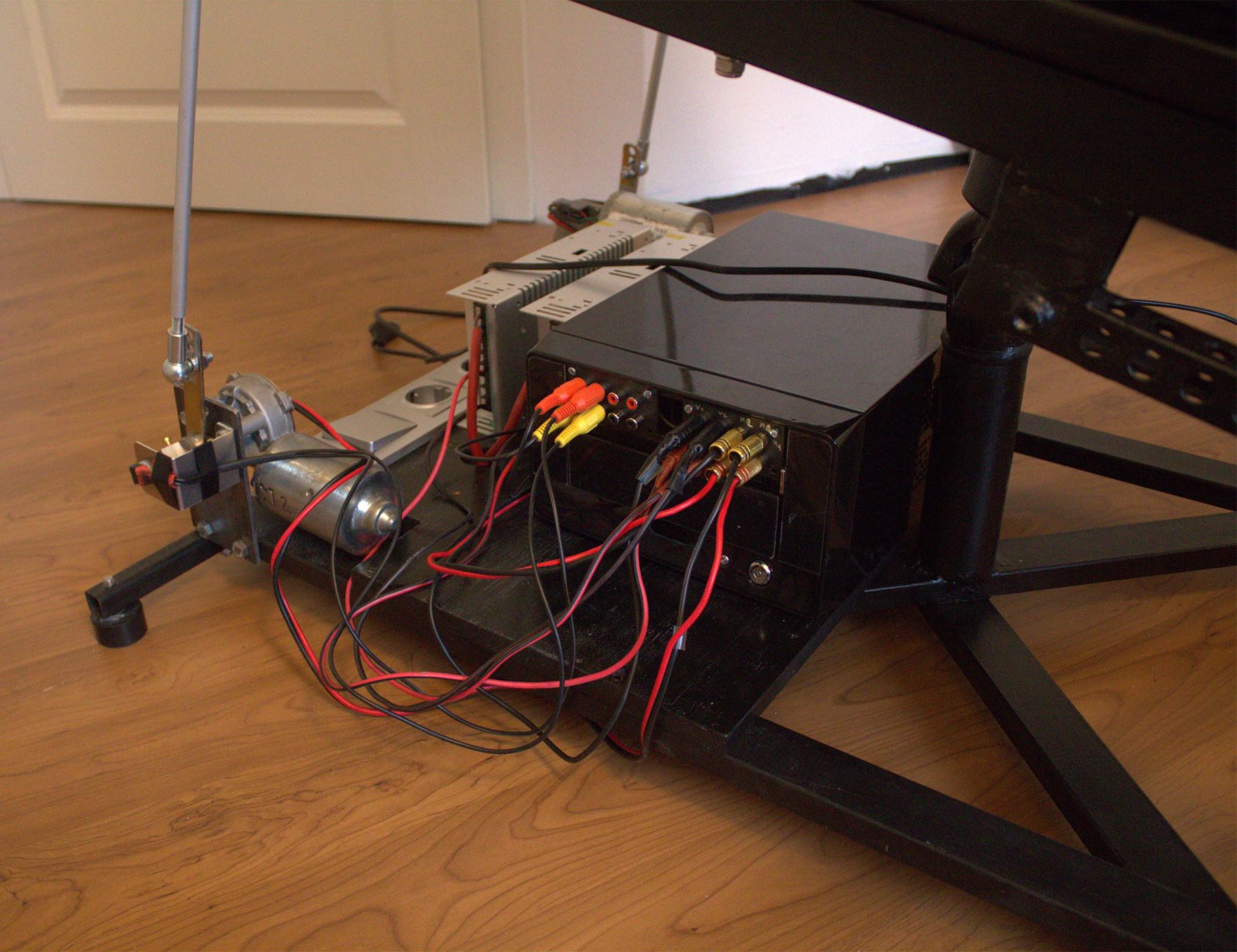

    Things that need to be done / changed:
    - The motors need to be replaced, these wheelchairmotors do work but they are too weak and I assume
    they will die soon. They run on 24/2A so I guess something with 24/5A should do the job way better.
    - I need to extend the wire for the shifter, it isn´t connected yet because the wire is too short.
    - All wires need to be sorted so it doesn´t look that messy.
    Feel free to ask questions or give suggestions :D

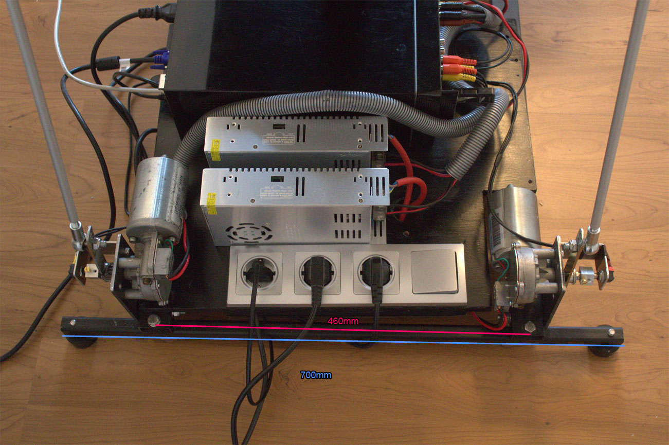

    EDIT 20th feb 2017: As promised some more pictures including the dimensions...all other dimensions should be clear by this.

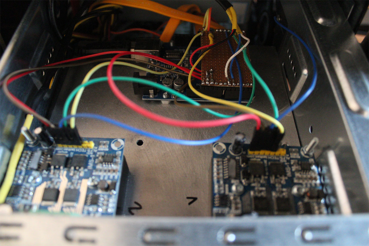

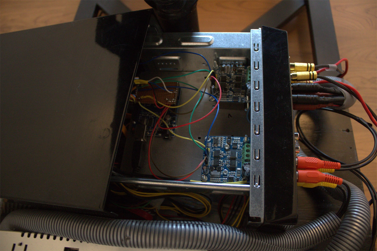

    Beautiful and clear thread..but we want to see in action :) Do you have photos of the electronic parts?

    OK...what kind of jack do you have used to connect motors to Arduino? They are very pretty :)
  10. xytras
    xytras Member Gold Contributor
    May 28, 2015
    92
    germany
    587Coins
    +23 / 0 / -0
    The golden ones ? They are some cinch... oh I forgot these in the list.
    They look nice but they suck here because there is high risk that they connect if you pull them out. The plastic stuff is better.
    I removed some cable protection "spring" part from them which even increased the risk of connecting them and insulated the ones for power.
    www.ebay.de/itm/370746403251

    added some photos and dimensions, the motors still suck :-/
