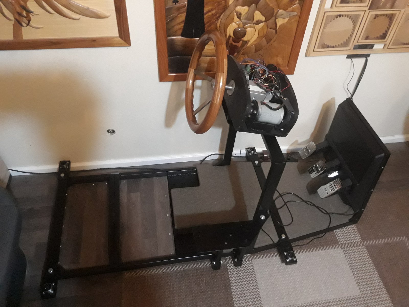

My 2DOF with wheelchair motor
Discussion in 'DIY Motion Simulator Projects' started by Ivan Ilic, Apr 30, 2021.
  1. Ivan Ilic
    Ivan Ilic New Member
    Mar 11, 2021
    21
    - 252Coins
    Whellchair motor 300w 1:26 22.5v
    IBT2
    Power supply 2x 500w 18.5v
    Diy hall sensor (49E)

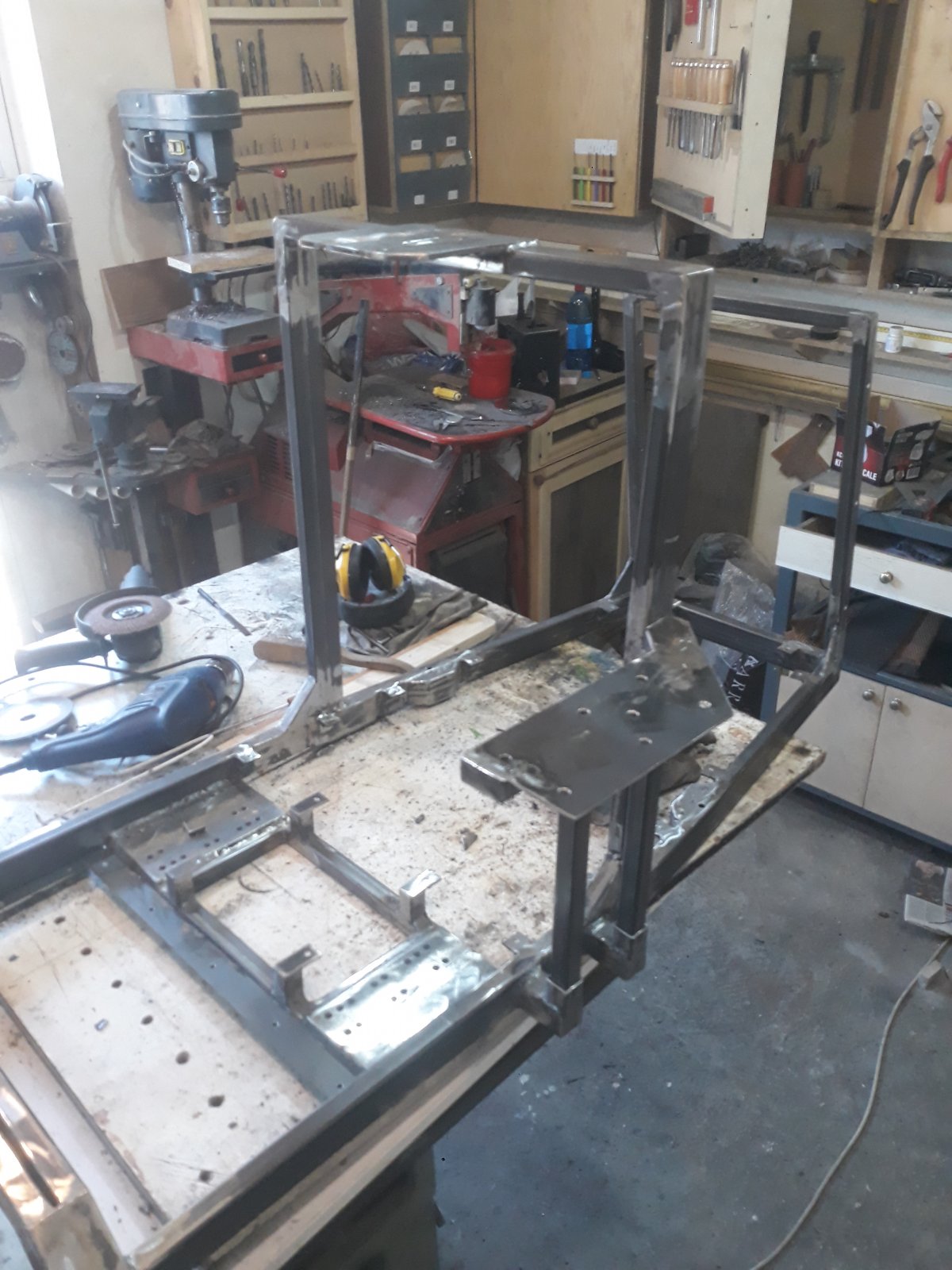

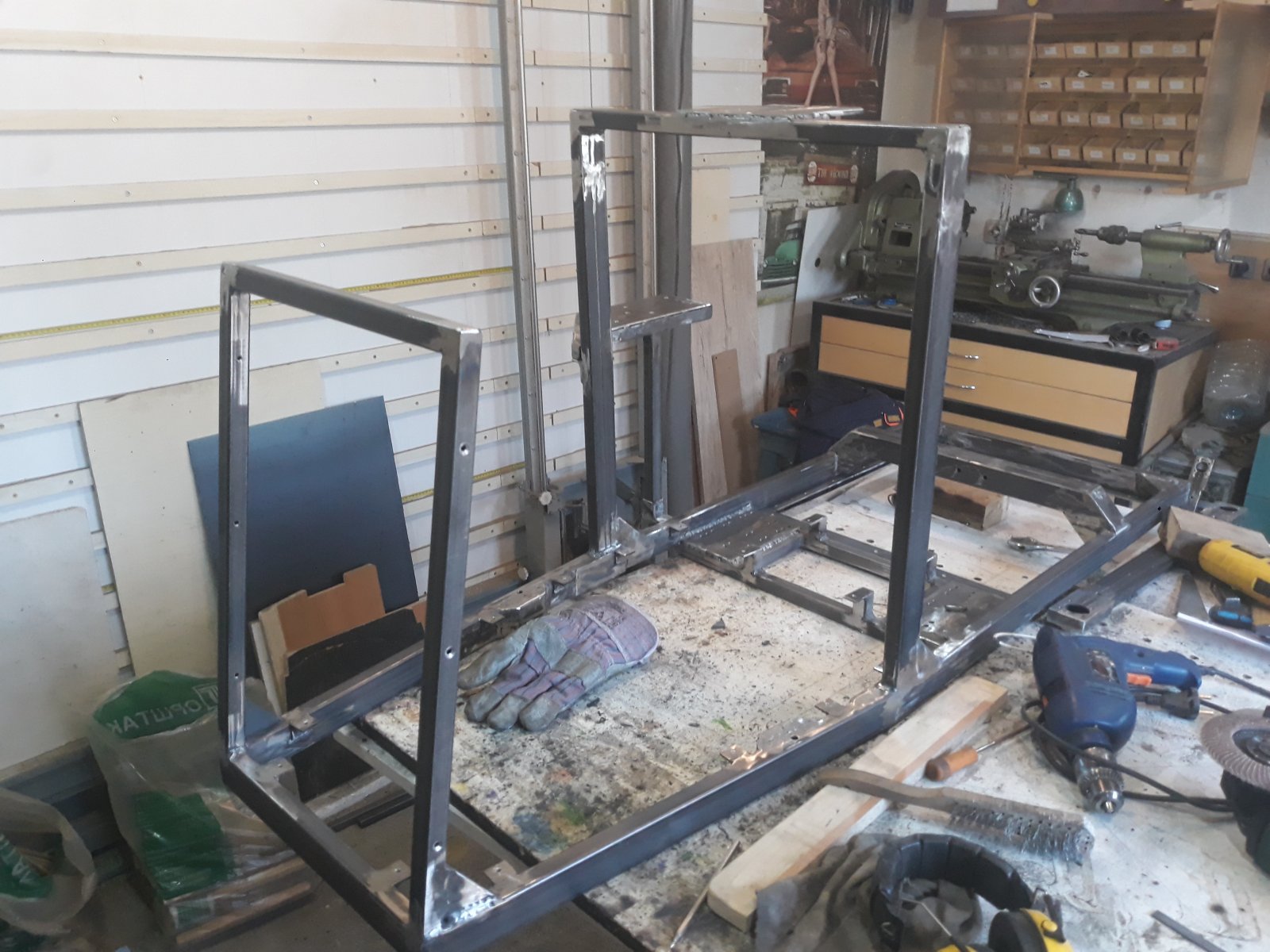

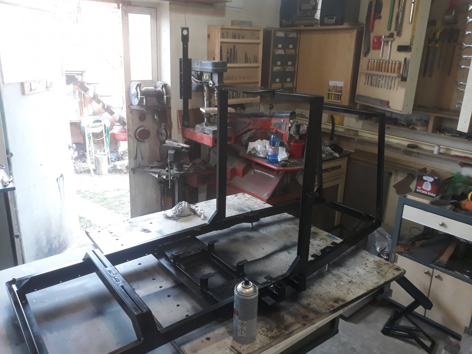

  2. Ivan Ilic
    Mar 11, 2021
    21

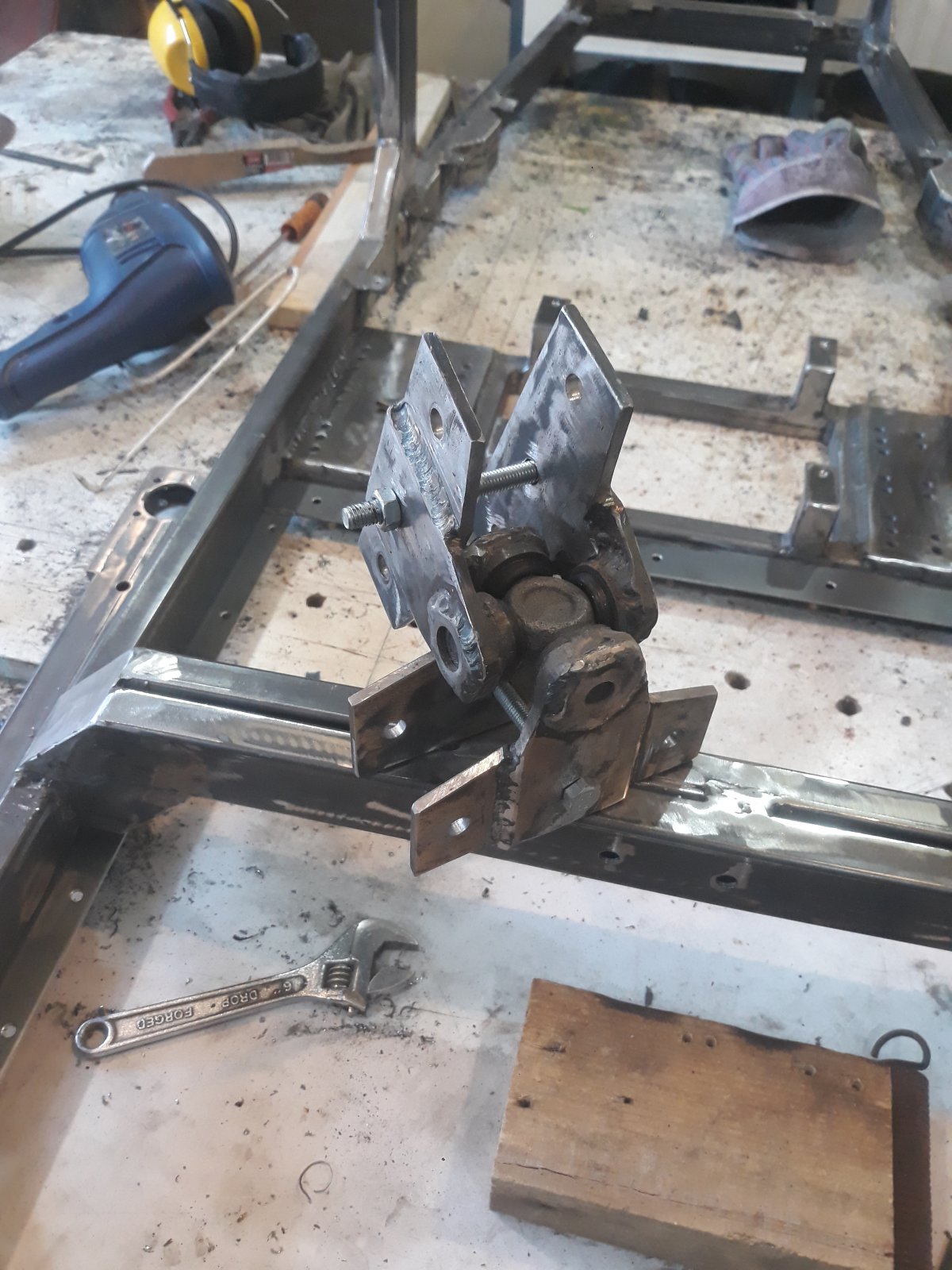

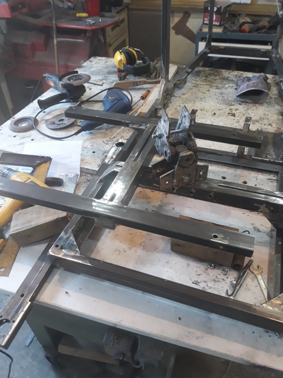

    - 252Coins

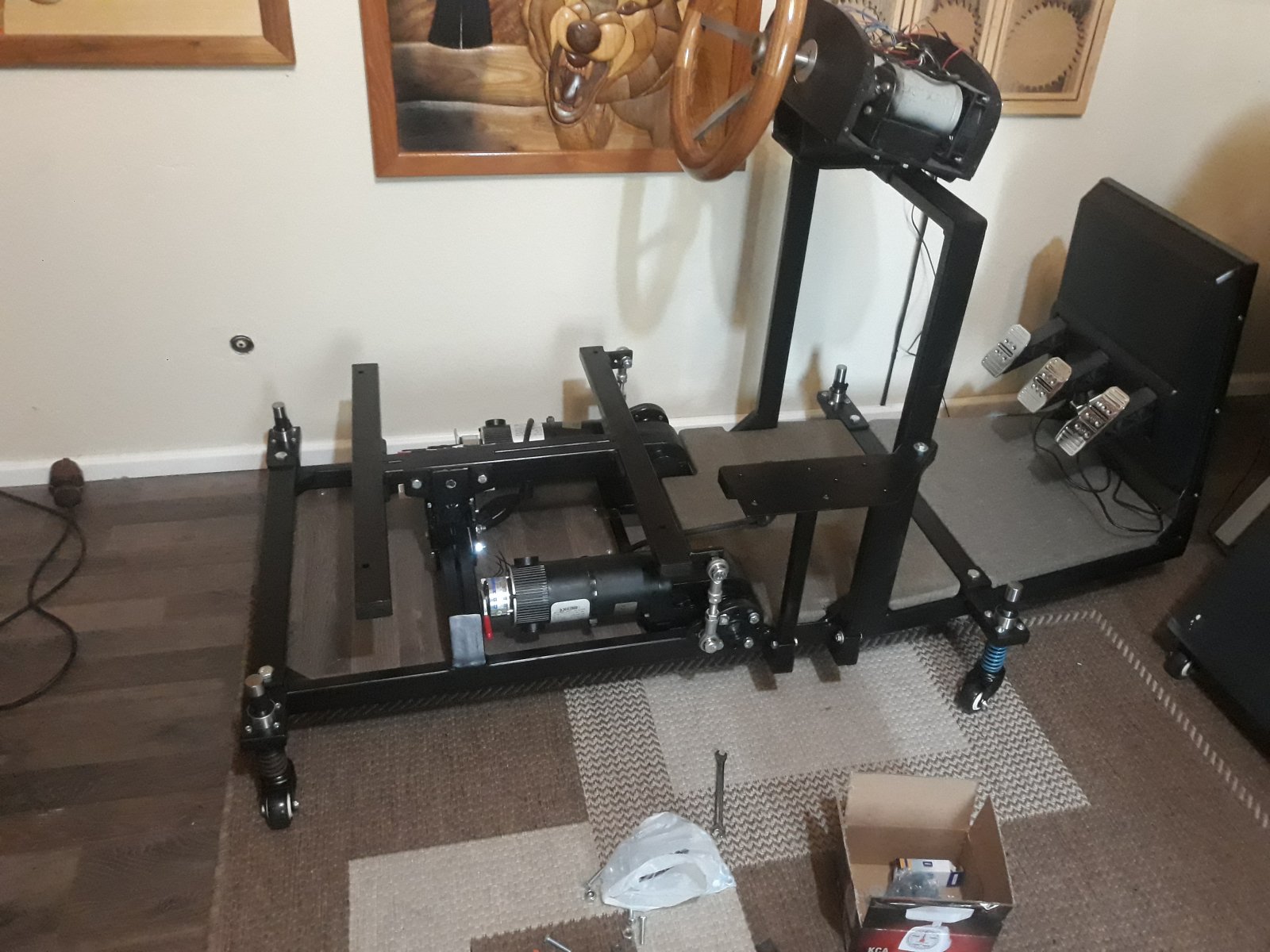

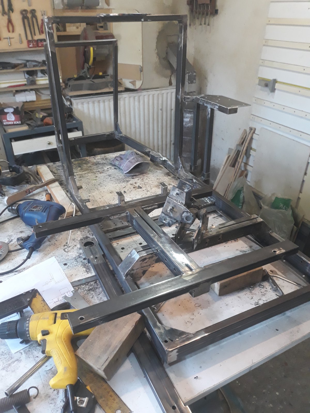

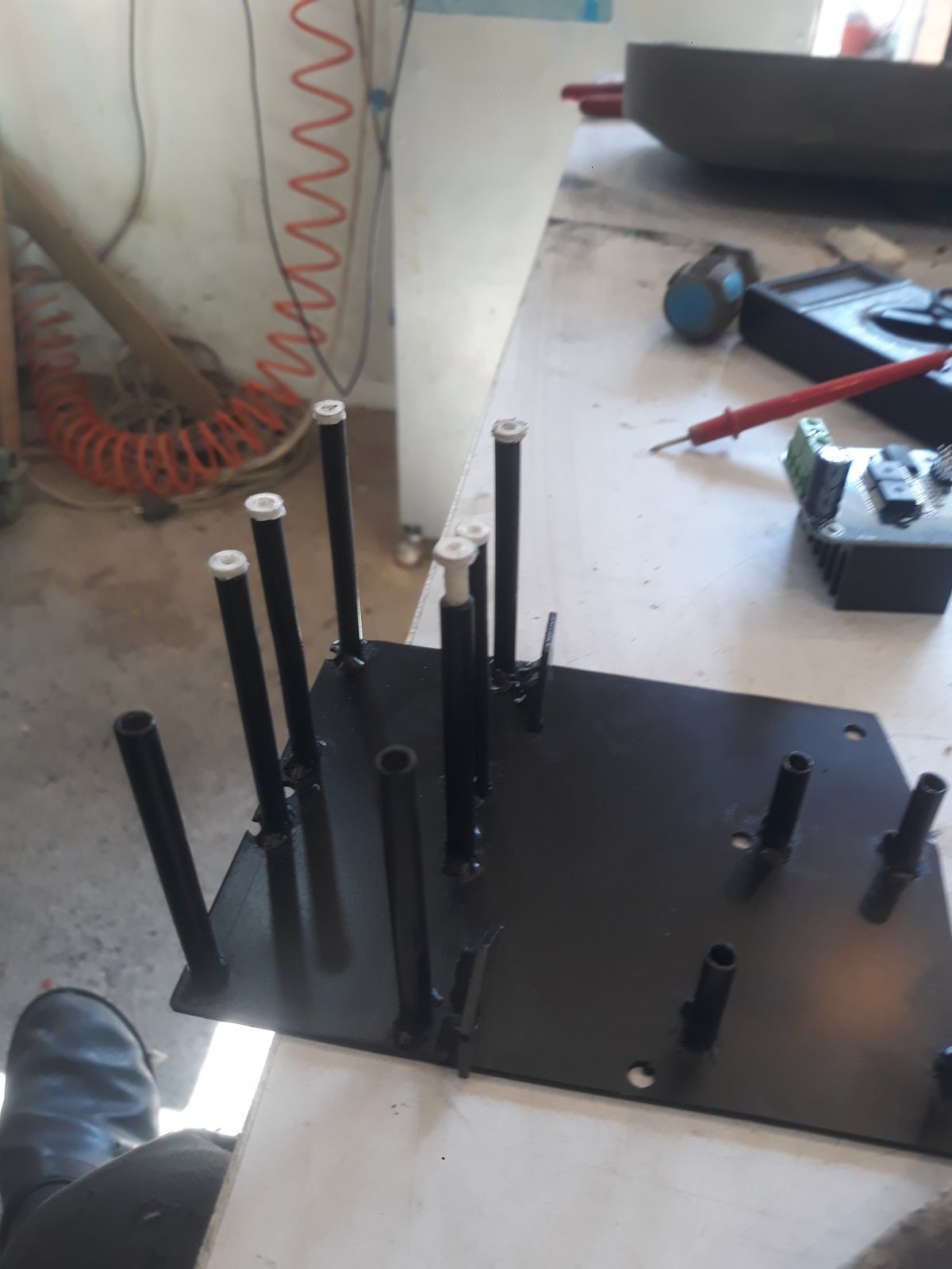

    the metal construction and my diy leonardo wheel

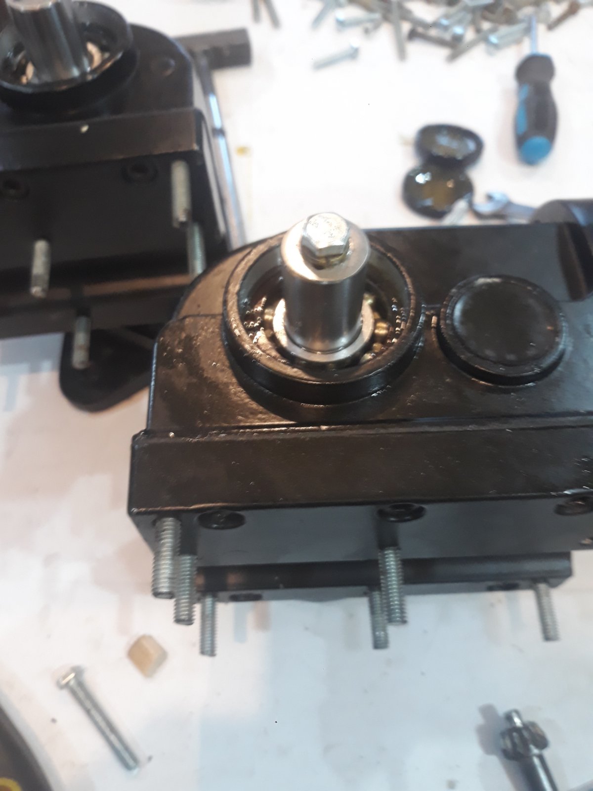

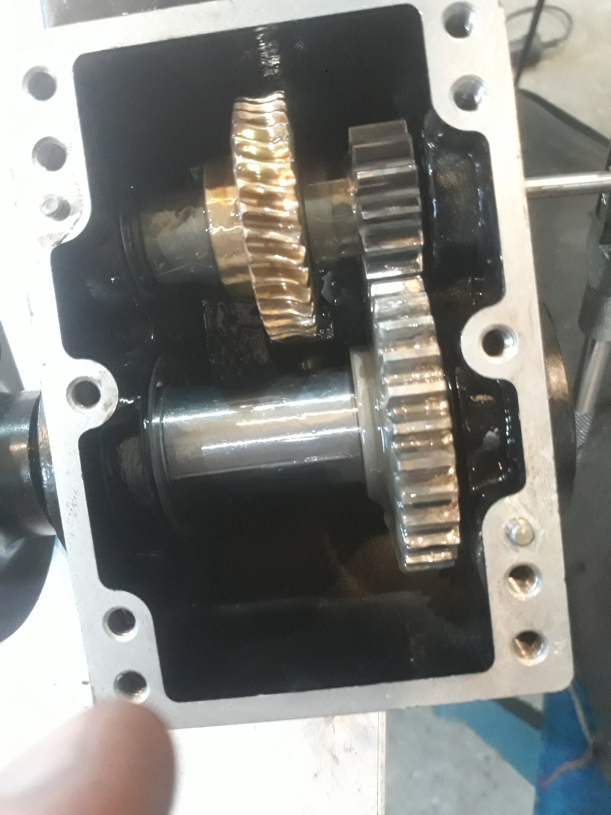

  3. Ivan Ilic
    Mar 11, 2021
    21

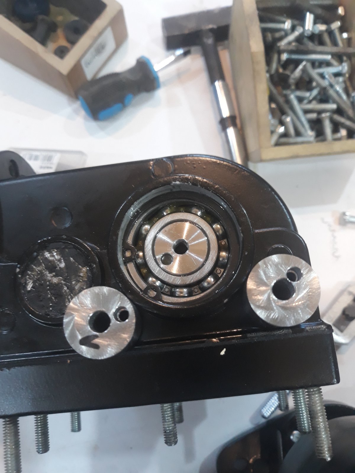

    - 252Coins

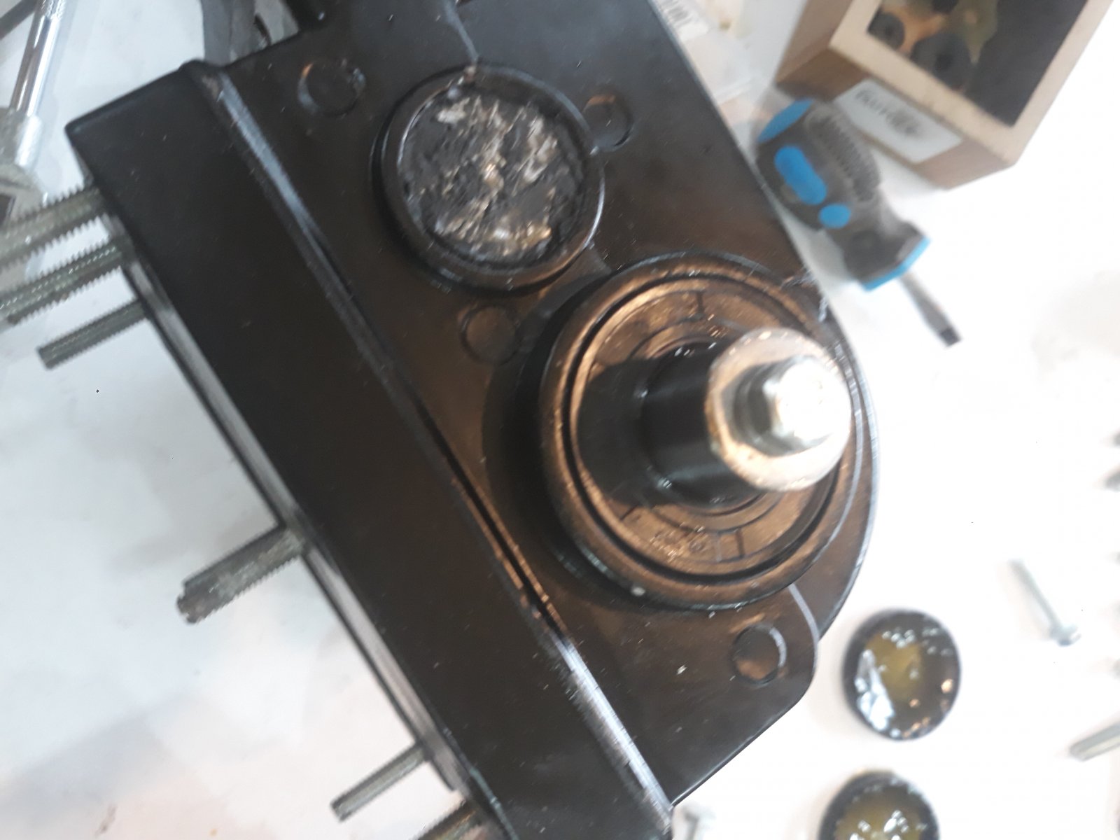

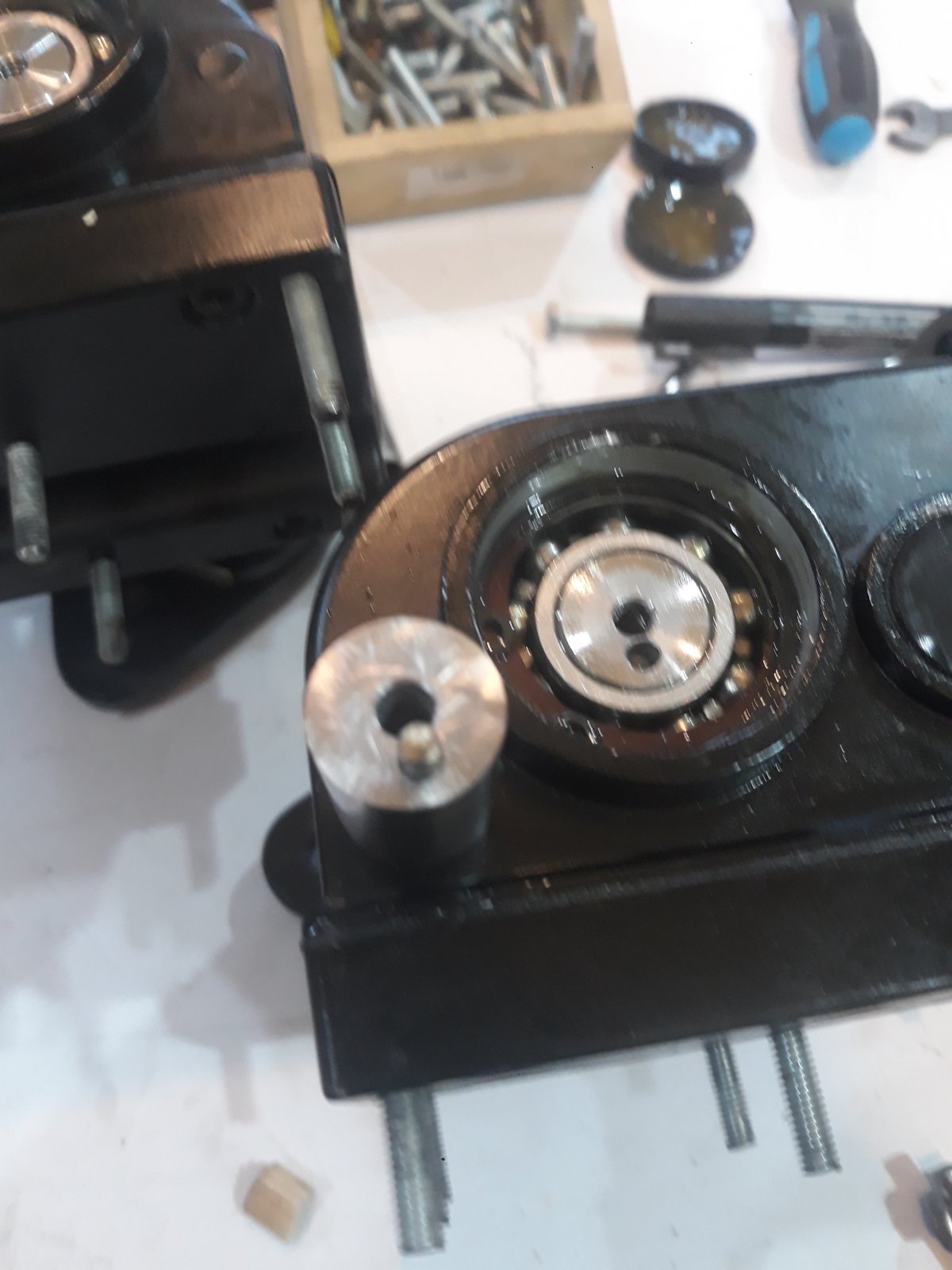

    Inside motor gearbox

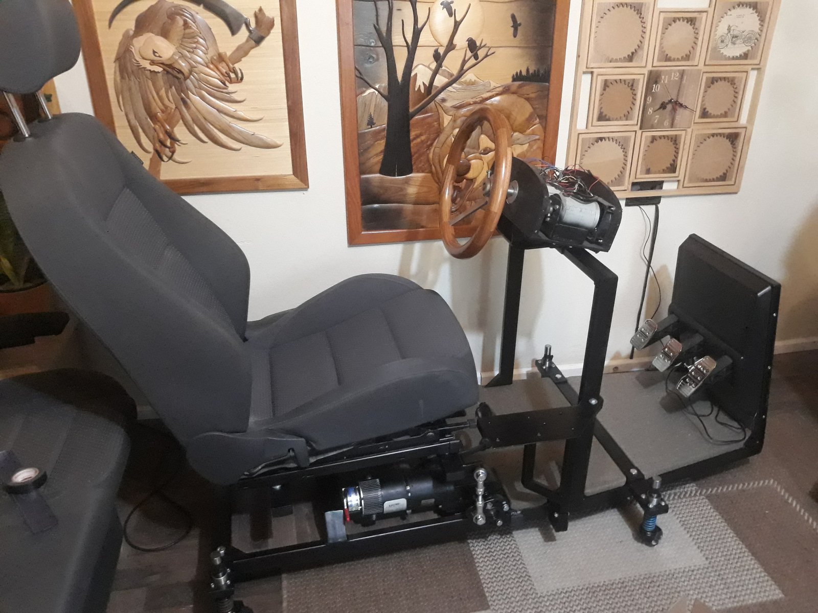

  4. Ivan Ilic
    Mar 11, 2021
    21
    - 252Coins
    seat Golf V

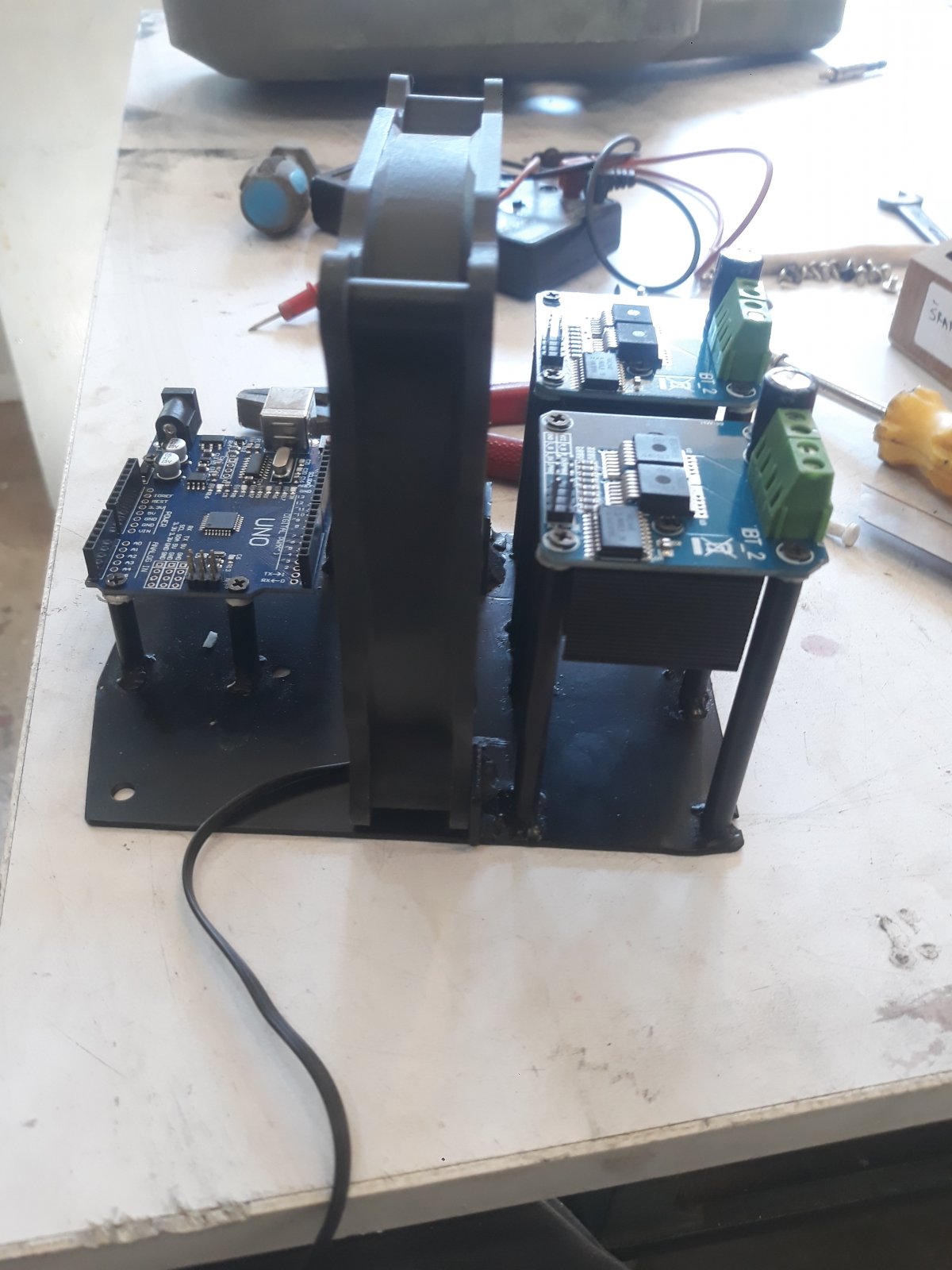

  5. Ivan Ilic
    Mar 11, 2021
    21
    - 252Coins

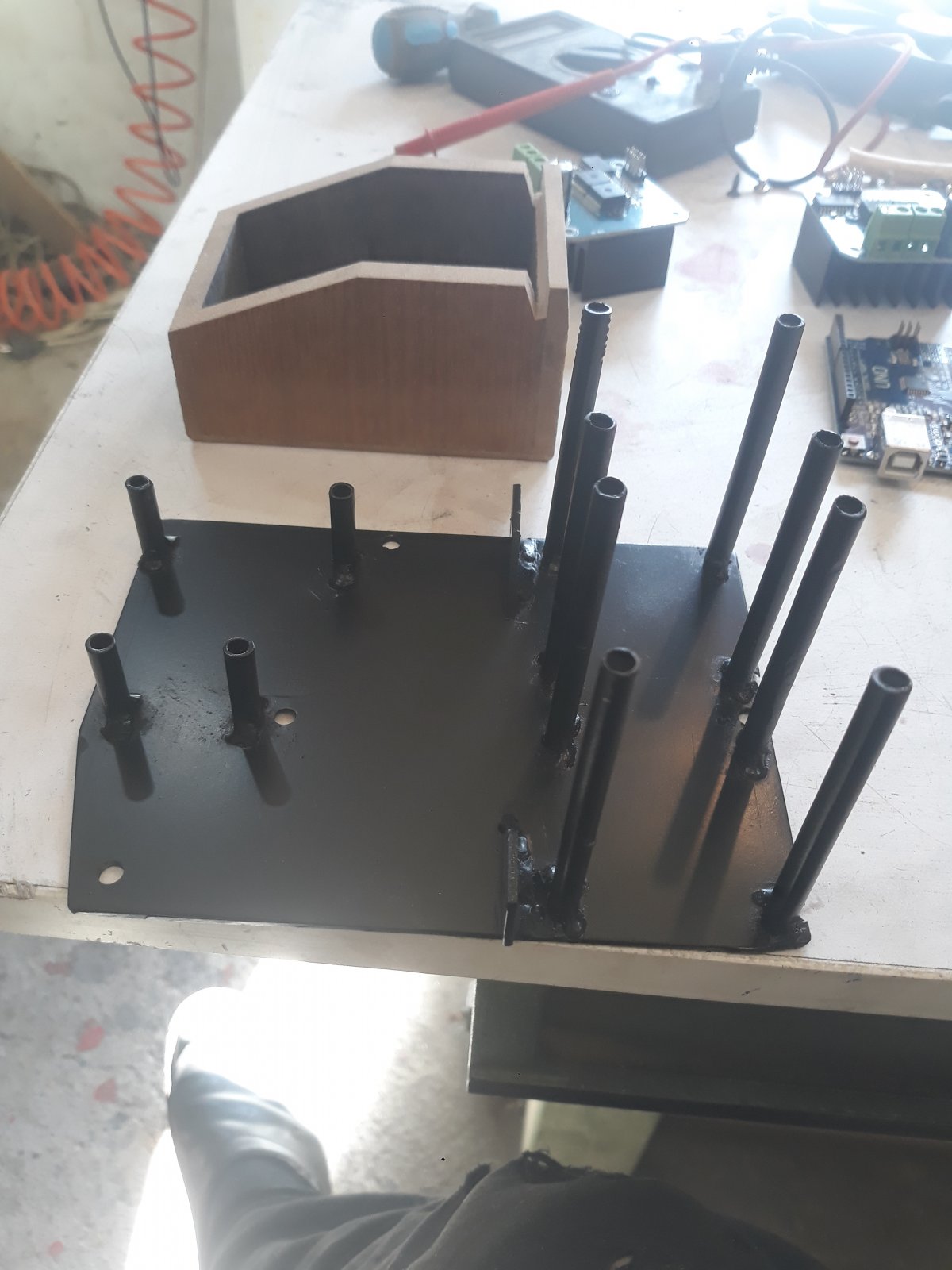

    electronics holder

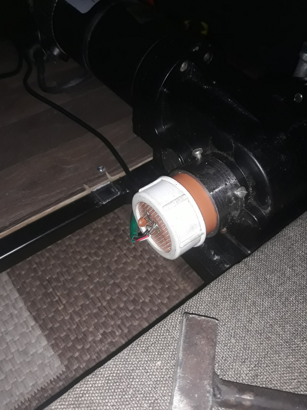

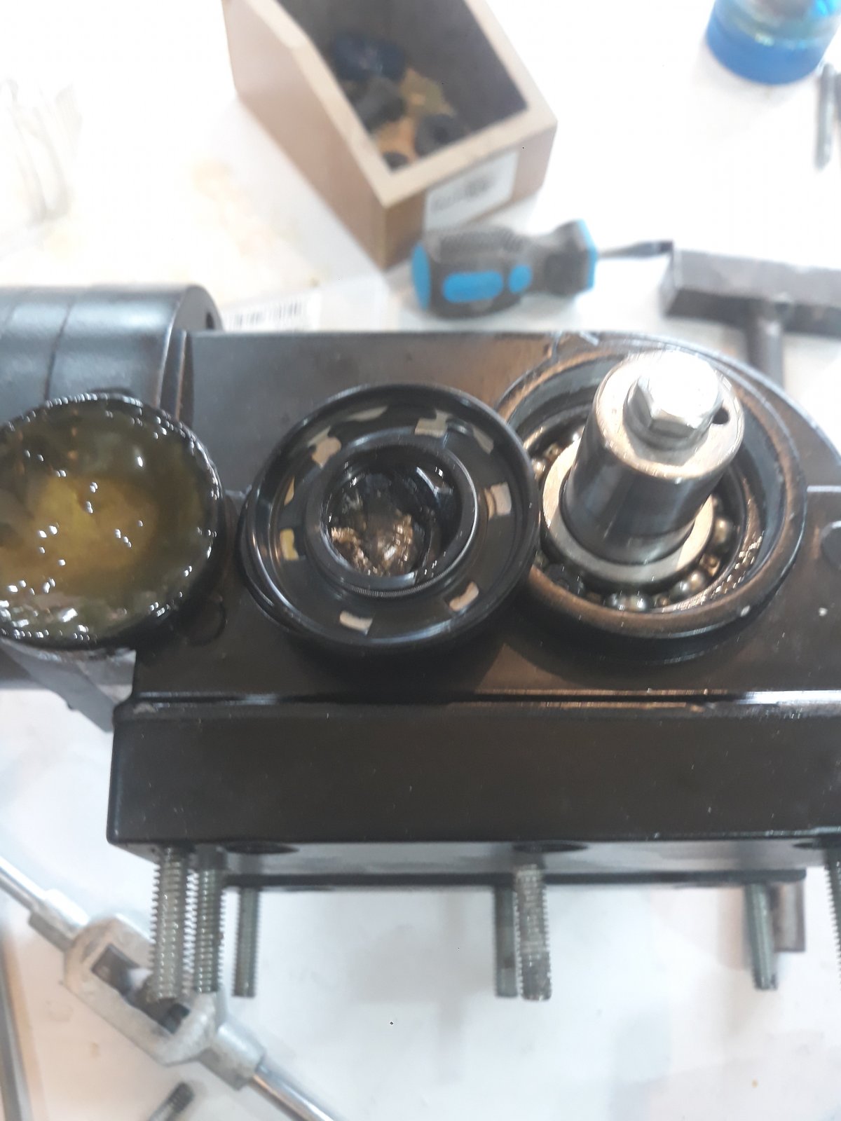

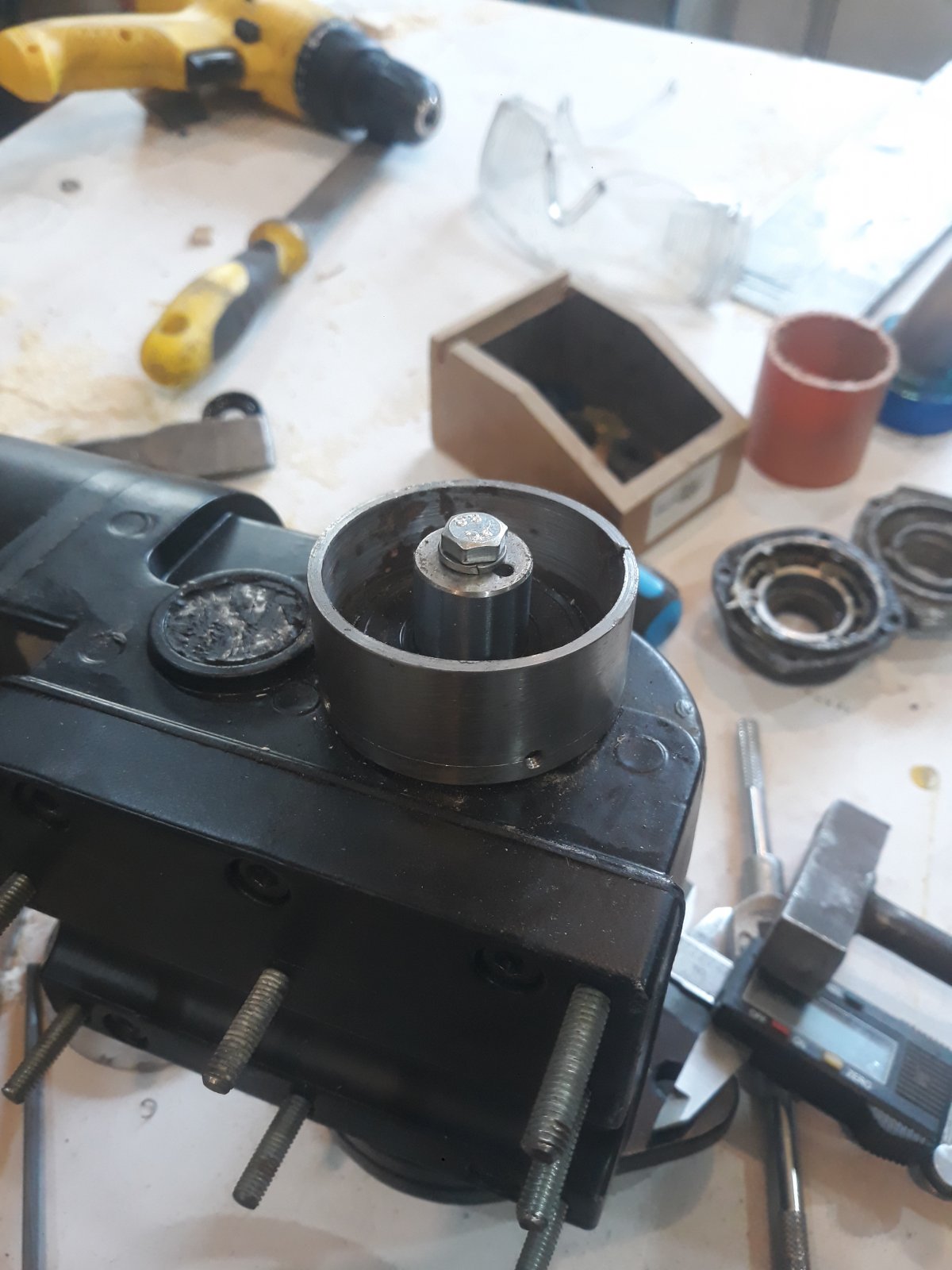

  6. Ivan Ilic
    Mar 11, 2021
    21
    - 252Coins

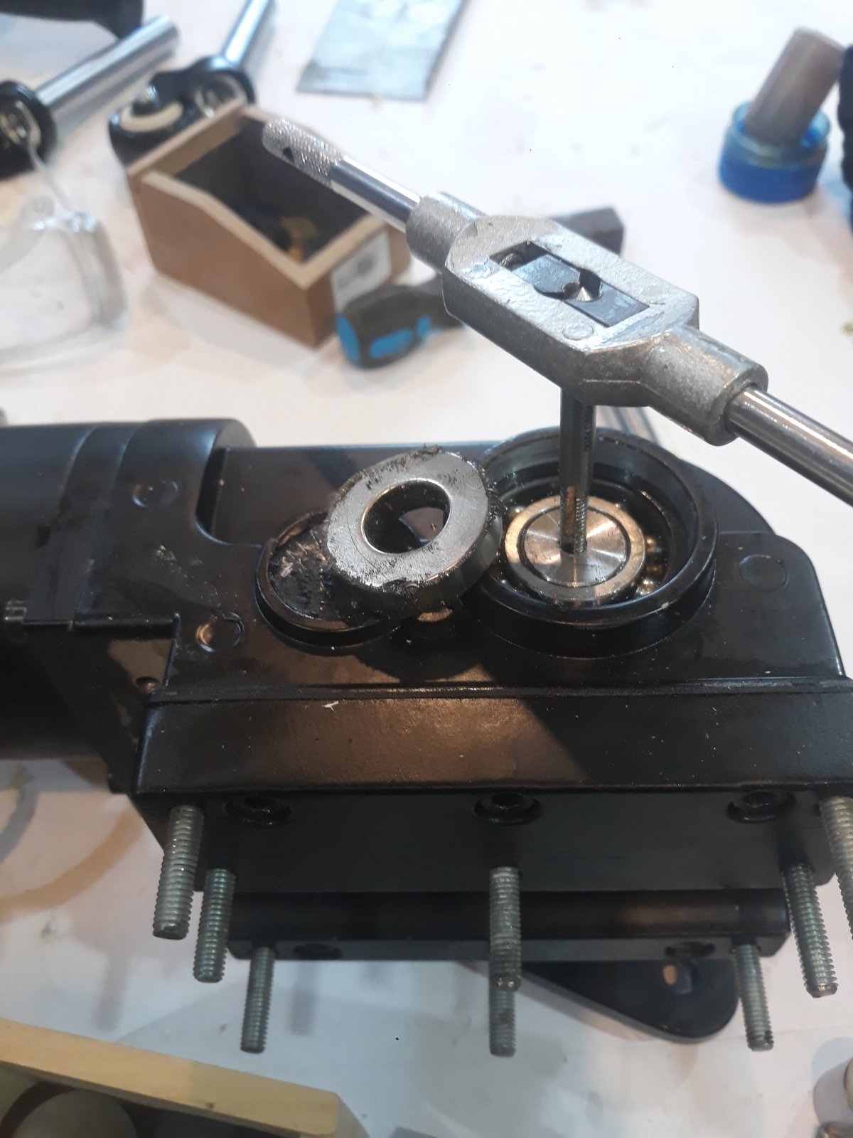

    Since the shaft has no outlet on the other side for hall sensor, I had to extend the shaft and install an oil seal instead of a plug

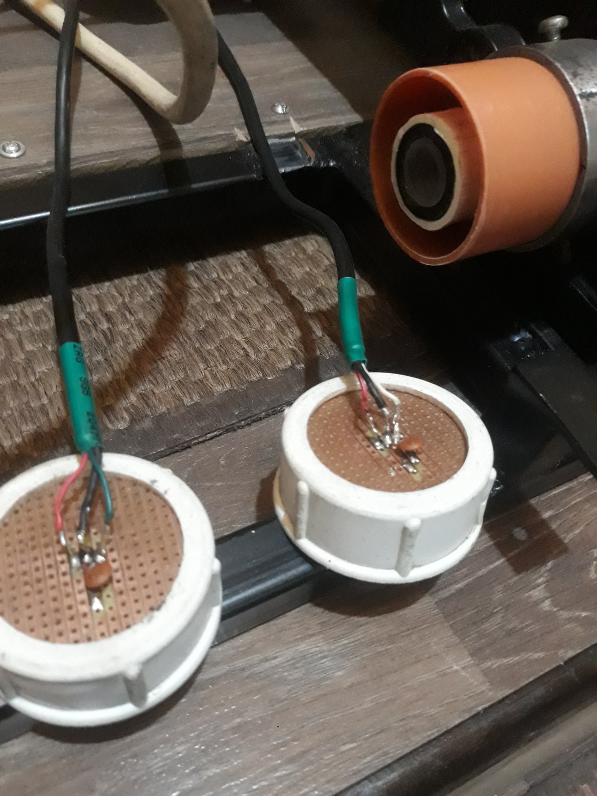

  7. Ivan Ilic
    Mar 11, 2021
    21

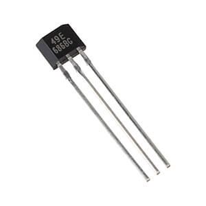

    - 252Coins
    Hall sensor

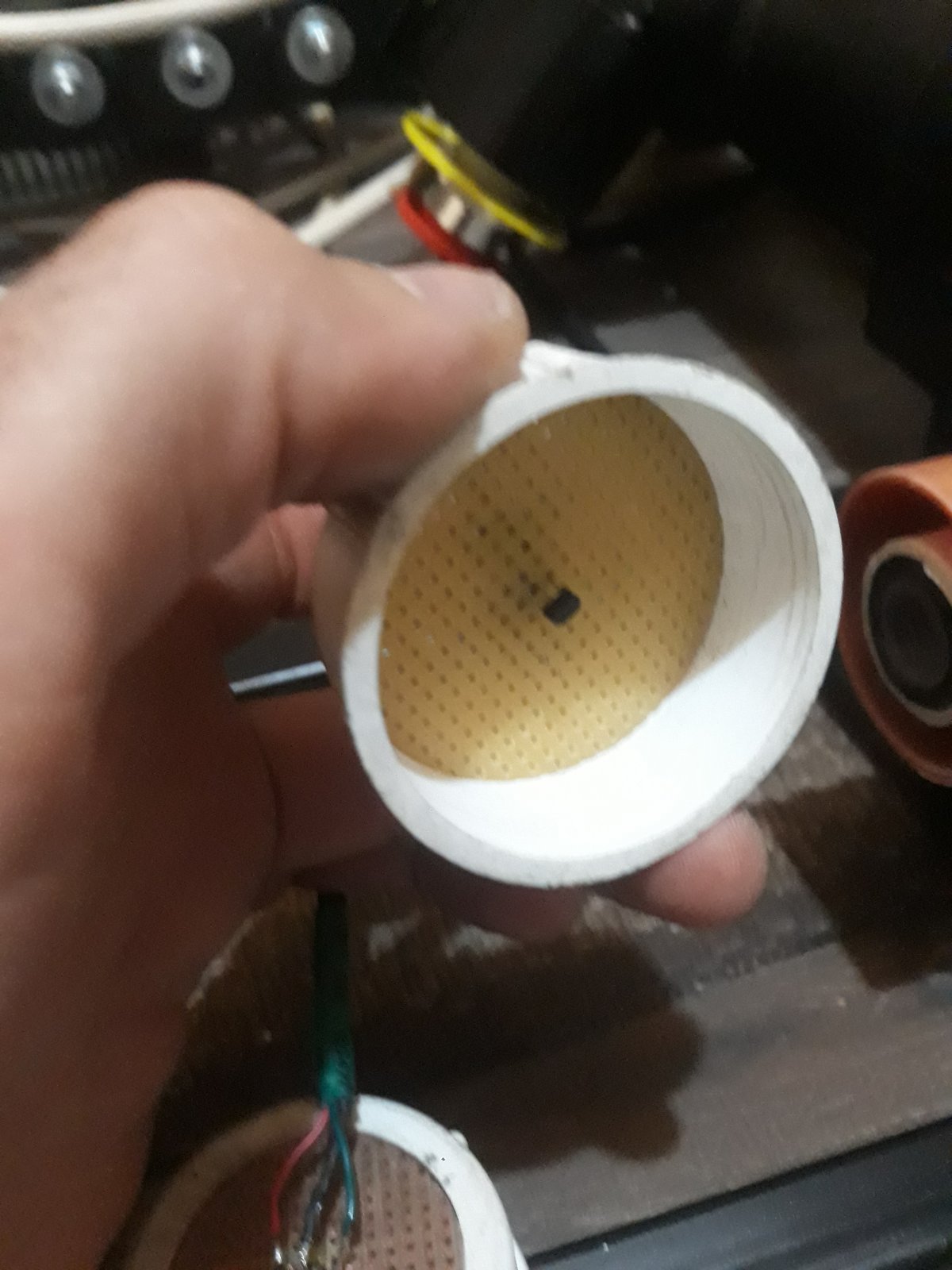

  8. Ivan Ilic
    Mar 11, 2021
    21
    - 252Coins
  9. RacingMat
    2,237
    21,050Coins
    congrats! you have a working simulator :) you can be proud!
    now, you will have to tweak the setups to make it moves maybe a bit more.
  10. Ivan Ilic
    Mar 11, 2021
    21
    - 252Coins
    Yes, definitely, this is just a test drive, I didn’t play too much with the settings. And I'm probably going to make the whole platform move, not just the seat
  11. RacingMat
    2,237
    21,050Coins
    let's see first how hard you can shake the seat under load, before upgrading to whole platform ;)

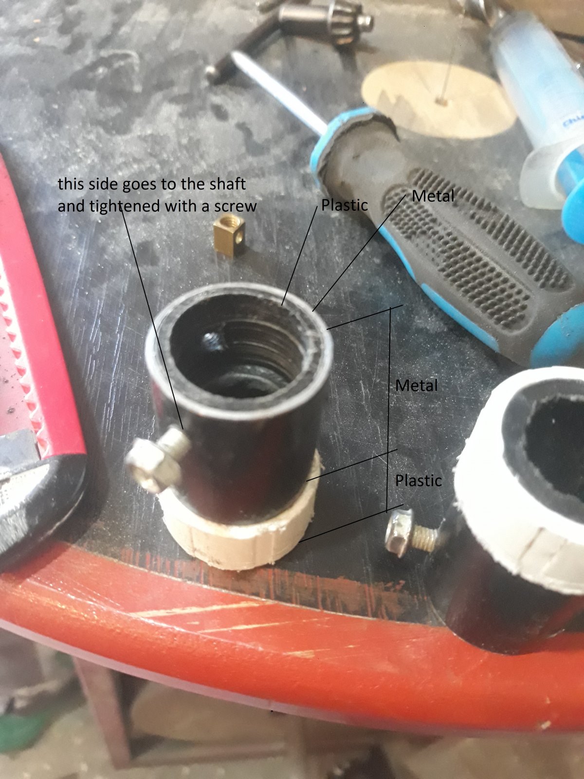

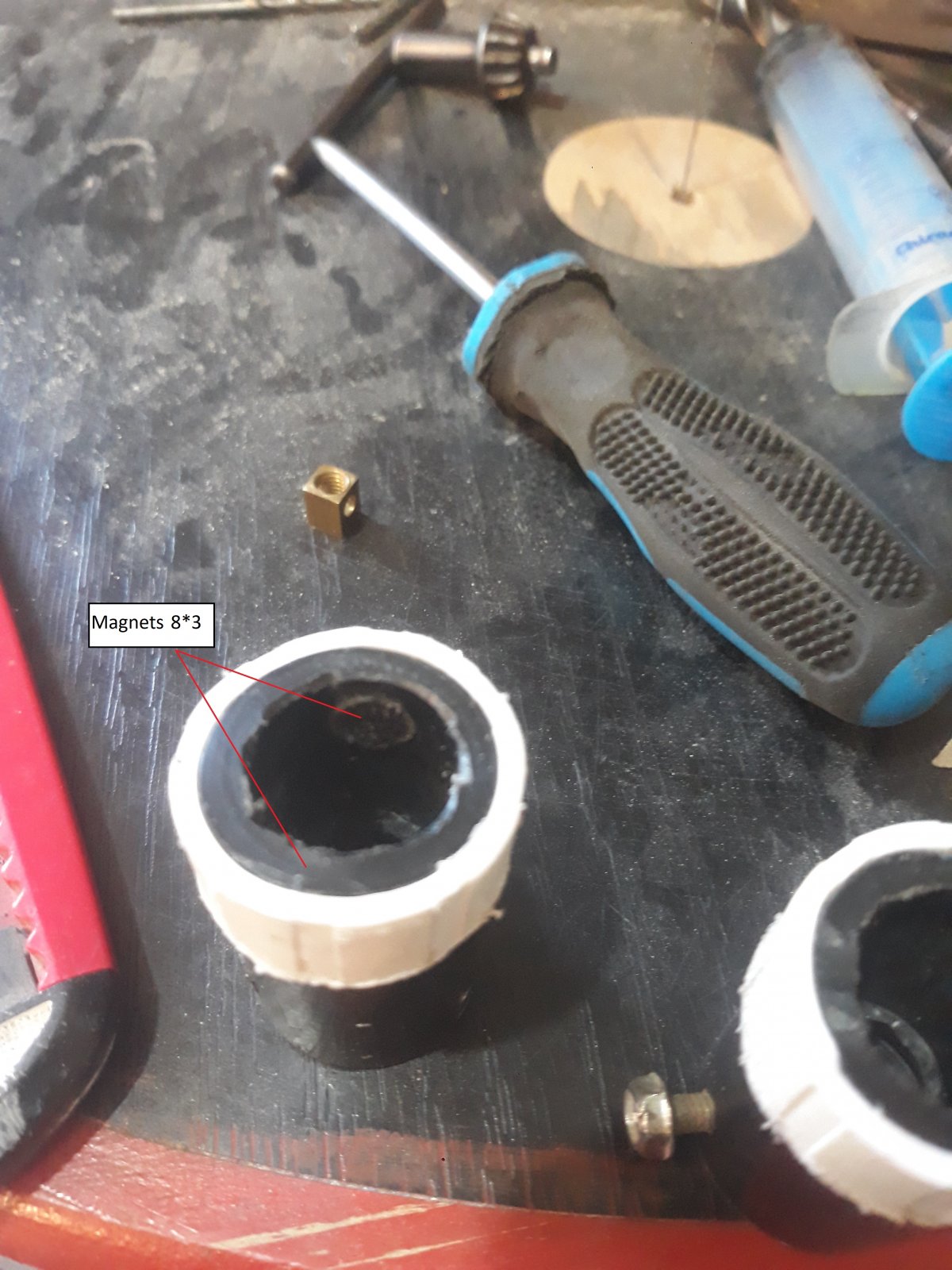

    3DOF, DC motor
    Hi Ivan, Good day to you. I used the same approach mounting the hall sensor in a piece of circuit board and the magnets inside a plastic tube clamped at the end shaft of the drive. I noticed you placed a small ceramic filter capacitor..is that across the 5 volt supply line? what value did you use. What magnet did you use? what number of ratiometric hall sensor did you use? Nice project...like it. Cheers!
  13. Ivan Ilic
    Mar 11, 2021
    21
    - 252Coins
    No, it's between the Ground and Analog input. The capacitor label is 104 (100nF). Neodymium magnet 8x3mm. Hall sensor is 49E Series. Thanks:)
  14. ZipRacer
    ZipRacer 2dof full frame + seaparte L&R seat mover
    Dec 31, 2017
    25
    phils
    63Coins
    3DOF, DC motor
    Thank you Ivan, Did you mean analog OUTPUT? Will adopt the circuit to filter out noises. Nice project. Hope I can find time to document my set up as well. Cheers.
  15. Ivan Ilic
    Mar 11, 2021
    21
    - 252Coins
    Yes output, just leave 5v, and conect capacitor to other two pins on hall sensor. And I noticed that I had to put the magnets closer to the sensor
  16. ZipRacer
    Dec 31, 2017
    25
    phils
    63Coins
    3DOF, DC motor
    Thanks for the tip re moving magnets closer to Hall sensor. One thing nice about using hall is you do not worry in case of runaway motor as there is no built in stop, unlike pots. Have you measured the rotation speed of the output shaft under load? How many rpms? Thanks (salamat in Phils.).
  17. Ivan Ilic
    Mar 11, 2021
    21
    - 252Coins
    I did not measure. On the motor label output shaft is 118rpm on 22.5v, i use it on 18.5.
    By turning this white plastic I adjust the position of the lever. When i turn a few degrees nothing happens, now that i have moved the magnets as close as i could, the lever moves as soon as i turn the white plastic with the sensor - I lost that dead zone by moving the magnets.
  18. ZipRacer
    Dec 31, 2017
    25
    phils
    63Coins
    3DOF, DC motor
    I have the same exact experience..if you turn the magnet beyond the sweet spot, nothing happens. as it makes sensing, the motor starts tracking again..it works but needs some fine adjustment..then you are ok and safe as nothing could break in the sensor side. I like hall over pot. My sim is a full frame and in addition to the two actuator motors (worm gear, 12 volts, 1:50 ratio, motor RPM 2400 to 32oo...under load more like 1750 rpm, thereabout) But I had the car seat mounted on a universal joint from the steering wheel and connected it to w wiper motor actuator. The drive is taken off the g27 motor line...voltage driving the motors is tapped and dropped/reduced thru a 10K resistor and used to drive a back to back optocoupler which in turn drives a relay to reverse the current driving the wiper motor in response to the turn/direction of the steering wheel...you can imagine the full frame moving in response to the game signal and the seat swaying opposite the direction you are turning the steering wheel..nice. Try it...so you have , in effect 3 dof ! Cheers.
