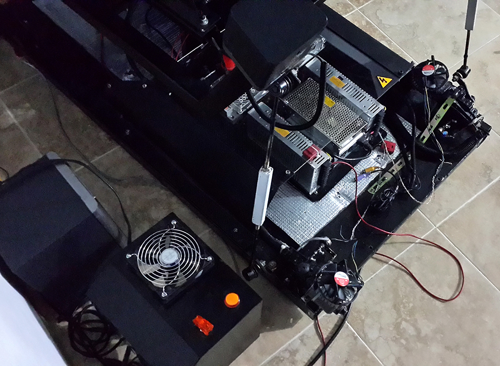

    Hello, i'm new here
    I like to show my homemade racing sim
    it's use arduino UNO and 12v car wiper motor.
    i would like to test it with simtools. i read @RacingMat tutorial and will use it
    thanks in advance
    here's the picture
    I don't know if i make it right
    sorry for my bad English.:grin

    Your English is fine @mracs and thanks so much for the pictures...it looks like you have done a great job :thumbs
    I am sure we will all look forward to a video once you have Simtools up and running. There are some really clever and helpful people on this forum so please do post any questions you may have.

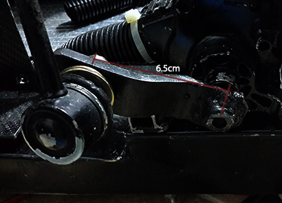

    Hi!
    The amplitude of movement are a bit too small IMO.
    What is your lever length?
    Maybe you can use the tuning center or Game Engine to calibrate greater movements?
    It's up to your feeling and needs ;)

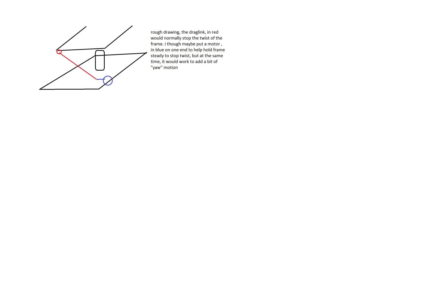

  11. bsft
    motion looks good, maybe some refinement, but that is learn in time and also personal preference.
    However, I can see a lot of twist in that frame. A draglink setup to help stop the twist would improve the motion feeling.
    Also, maybe try @RufusDufus or @prilad codes as well. They are more complicated, but you may get a better result again,

    hi @RacingMat do you mean this length?
    I lowered settings. i use 60% in game manager.
    thanks @bsft, you're right, It feel much twisted. I will arrange to put the draglink
    i will try that code, to see the difference:thumbs
  13. RacingMat
    2,237
    21,022Coins
    yes! 65mm and 60%

  14. bsft
    I had a thought, you could attach a wiper to the drag link and give yourself a bit of "drift" in the frame.

  16. bsft
    a drag link is a rod with ball joints (rod ends) on it to help stop twist. I though maybe put a drag link on on corner at the back and attach it to a motor, and run "yaw" force through it.
  17. mracs
