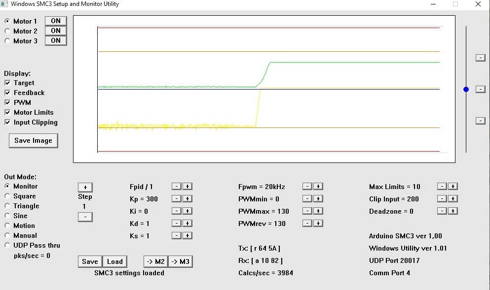

    Hello, now I have a little problem with the 2dof, I don't know if it's from the SMC3: it was going well but I touched the hall potentiometers to make the simulator flat and when I went to try it, the cockpit started to shake. I show the graph. I did similar tests before and it went well... I don't know what happened. Any ideas?

    reduce clip input
    increase pwm max to 255
    reduce kp to 100 and increase slowly from there

    Hi, I did it but still the same, even I changed the bts7960 module... maybe hall sensor is on failure? or arduino?
    21,489
    150,554Coins
    +11,017 / 55 / -2
    Try following the SMC3 setup steps from scratch and let us know if that resolves the issue, or at what step the issue starts:
    8. Set Kp to about 400
    10. Do the above for each motor

    Hi are your hall pots loose at all ?

    No, they are fastened to the belt

    I swaped the hall sensor and it goes the same, then the halls are ok.

    double check your settings in smc3 utils
    start from scratch and slowly bring the pwm up till you get movement in a sine wave

    I had that issue when I was using SMc3, increasing the FPid fixed it.

    At last I found the solution after doing wht you say and it did'nt work, except checking the wire. The problem was a bad connection with the 4 gnd wire they were hide and moving the wires the motor did sometimes a buzz, it was solved by welding this 4 black wires and apart the 4 red wires. Now I have other issues than deserve a new thread.
