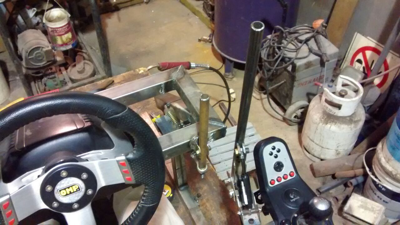

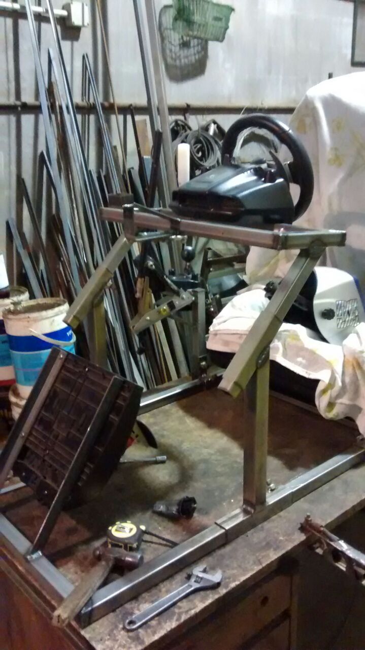

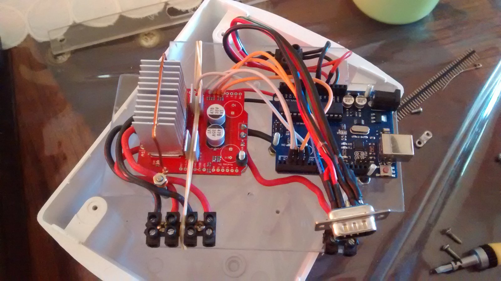

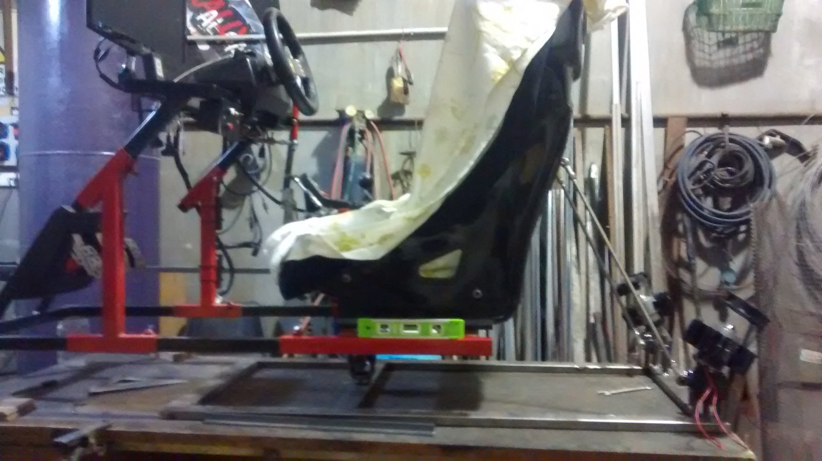

    Buenas noches, amigos.
    Hace un año empecé con mi proyecto, debido a la falta de tiempo me detuve un poco.
    Construido con los limpiaparabrisas VW Gol, placa Arduino Uno R3 Monster + Moto ...
    Usarlo muy poco y aviso de la temperatura en el monstruo de Moto con los refrigeradores y más fresco ..

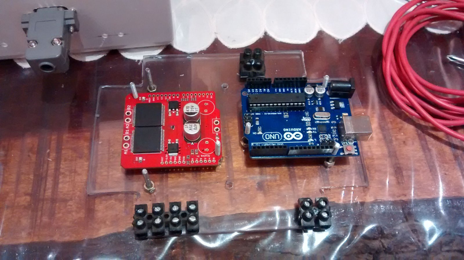

    En el momento en que dejé el proyecto, hice una compra de la IBT-2, que ya tengo en mi poder.

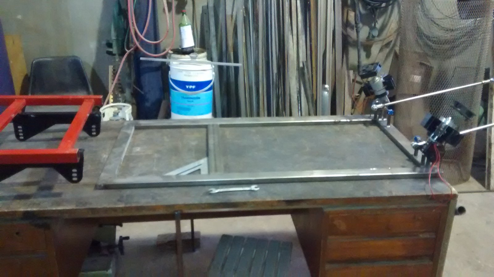

    Ahora voy a construir todo desde cero y voy a añadir un tercer motor para la pérdida de tracción ..
    Bueno les dejo algunas fotos del simulador y un corto video de una de las pruebas con Richard Burns Rally
    Good night, my friends. A year ago I started with my project, due to the lack of time I stopped a little. Constructed with VW Gol wipers, plate Arduino Uno R3 Monster Moto ... Use it very little and notice the temperature in the Moto monster with coolers and cooler .. The moment I left the project, I made a purchase of the IBT-2, which I already have in my power. Now I will build everything from scratch and I will add a third engine For the loss of traction .. Well I leave some photos of the simulator and a short video of one of the tests with Richard Burns Rally

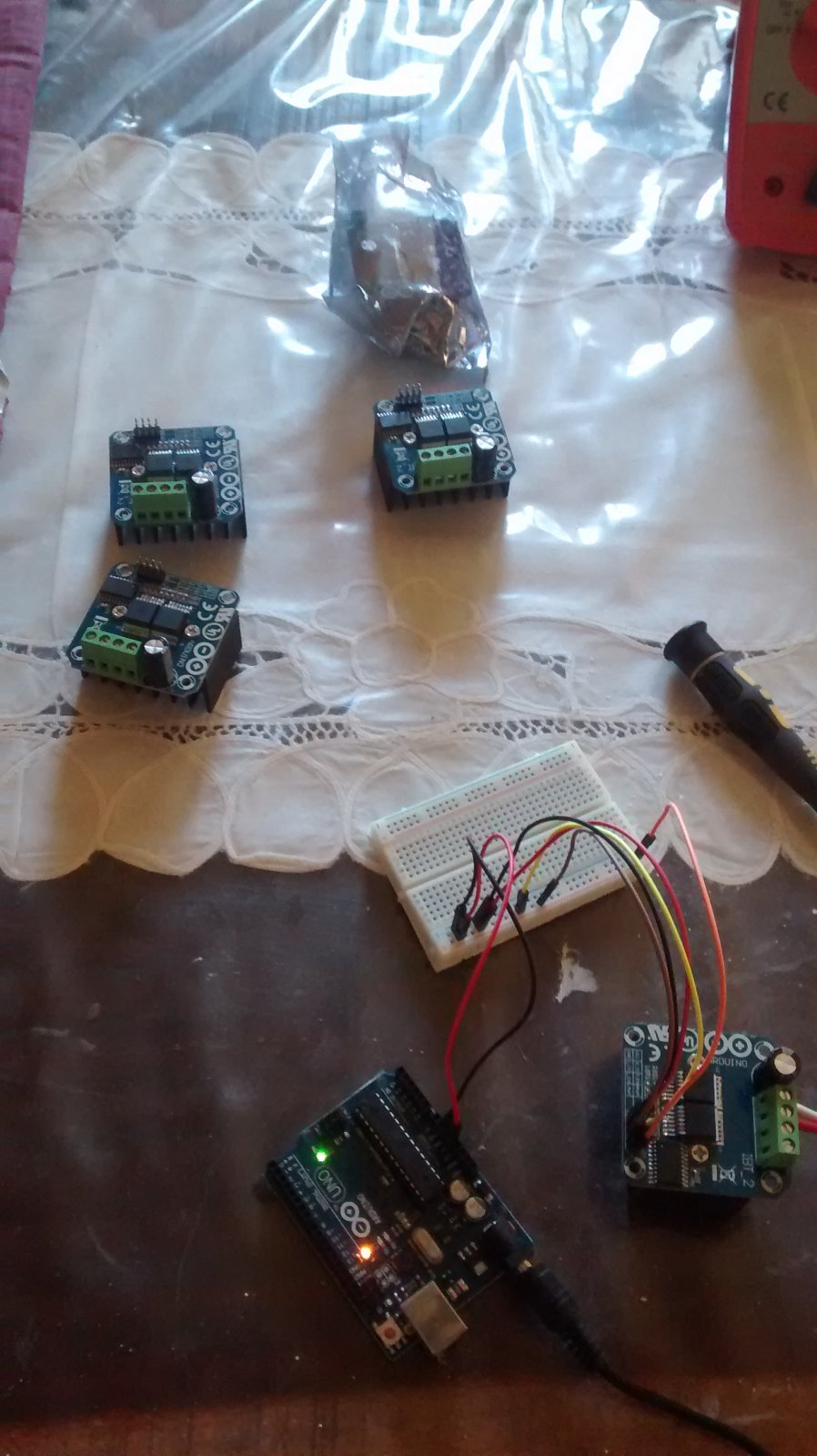

    Prueba de la IBT-2

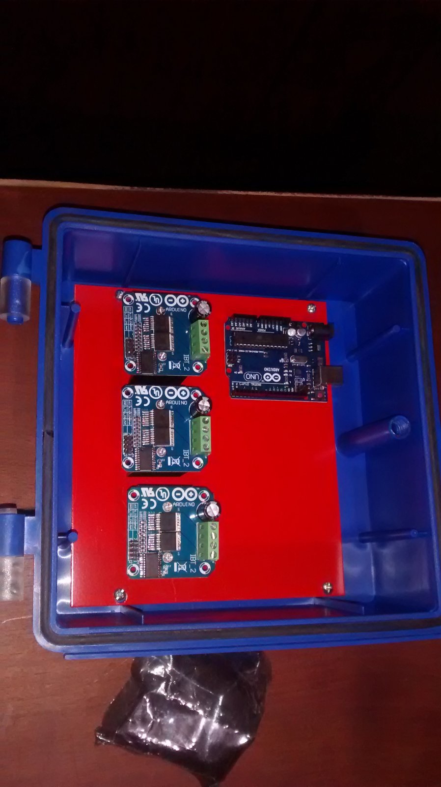

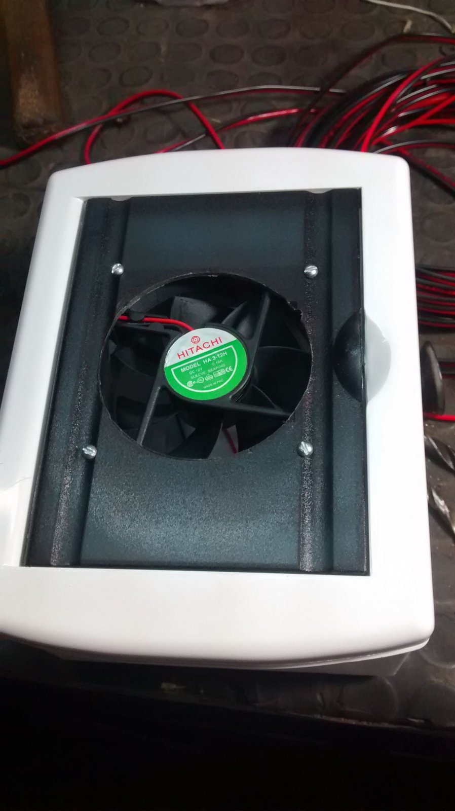

    New cabinet

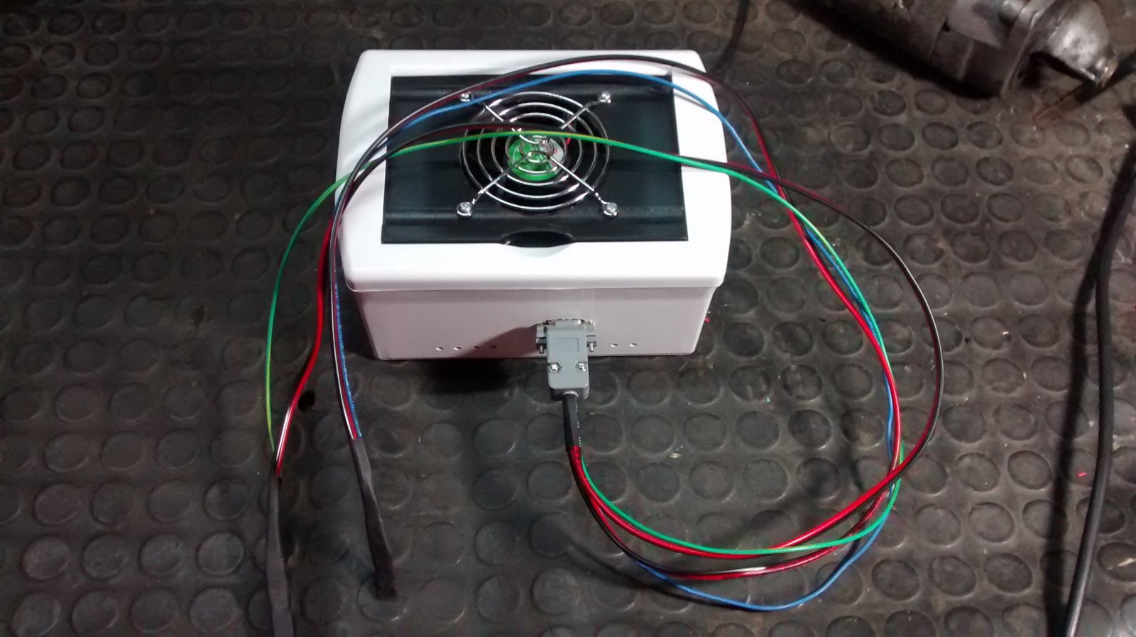

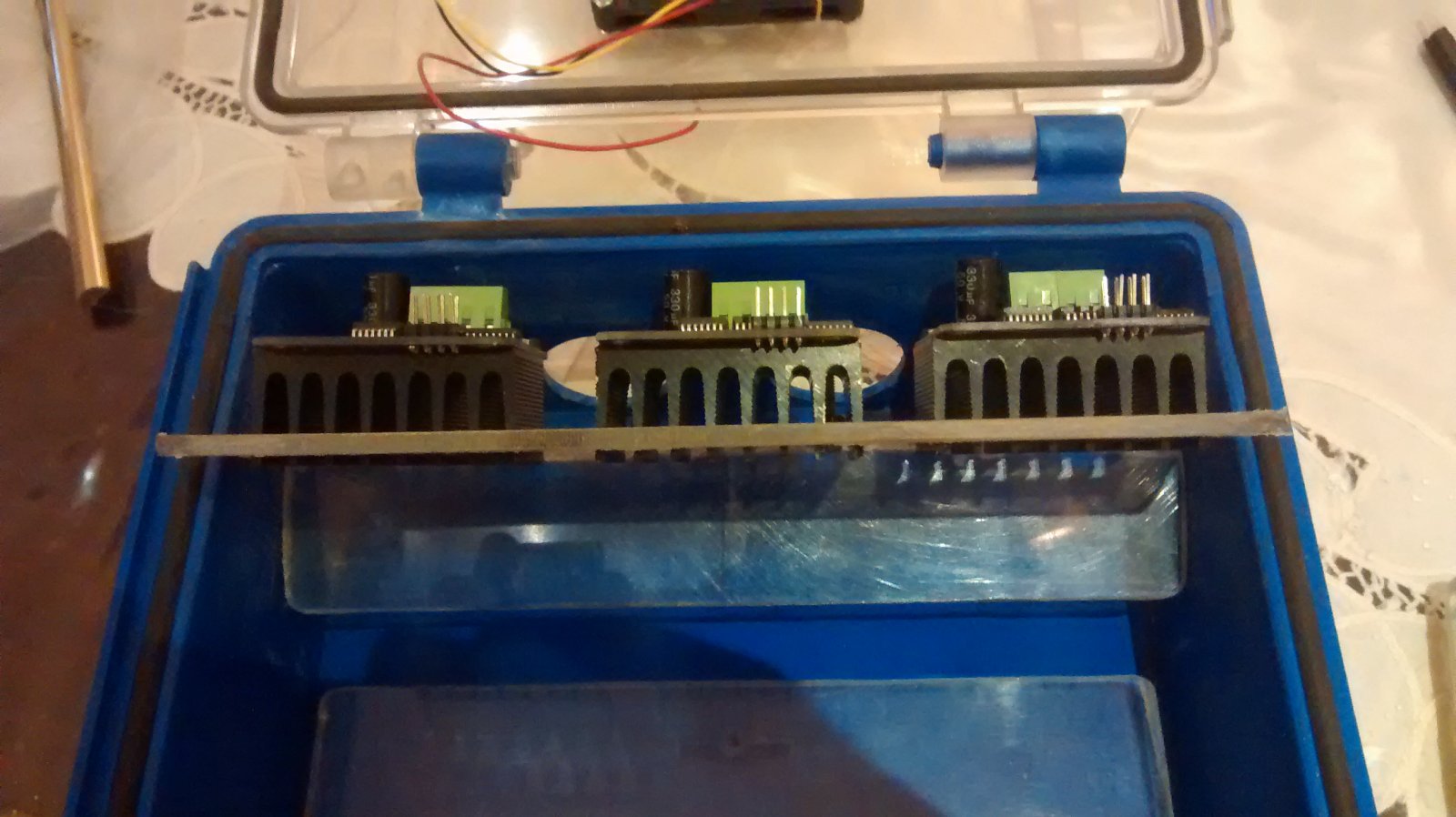

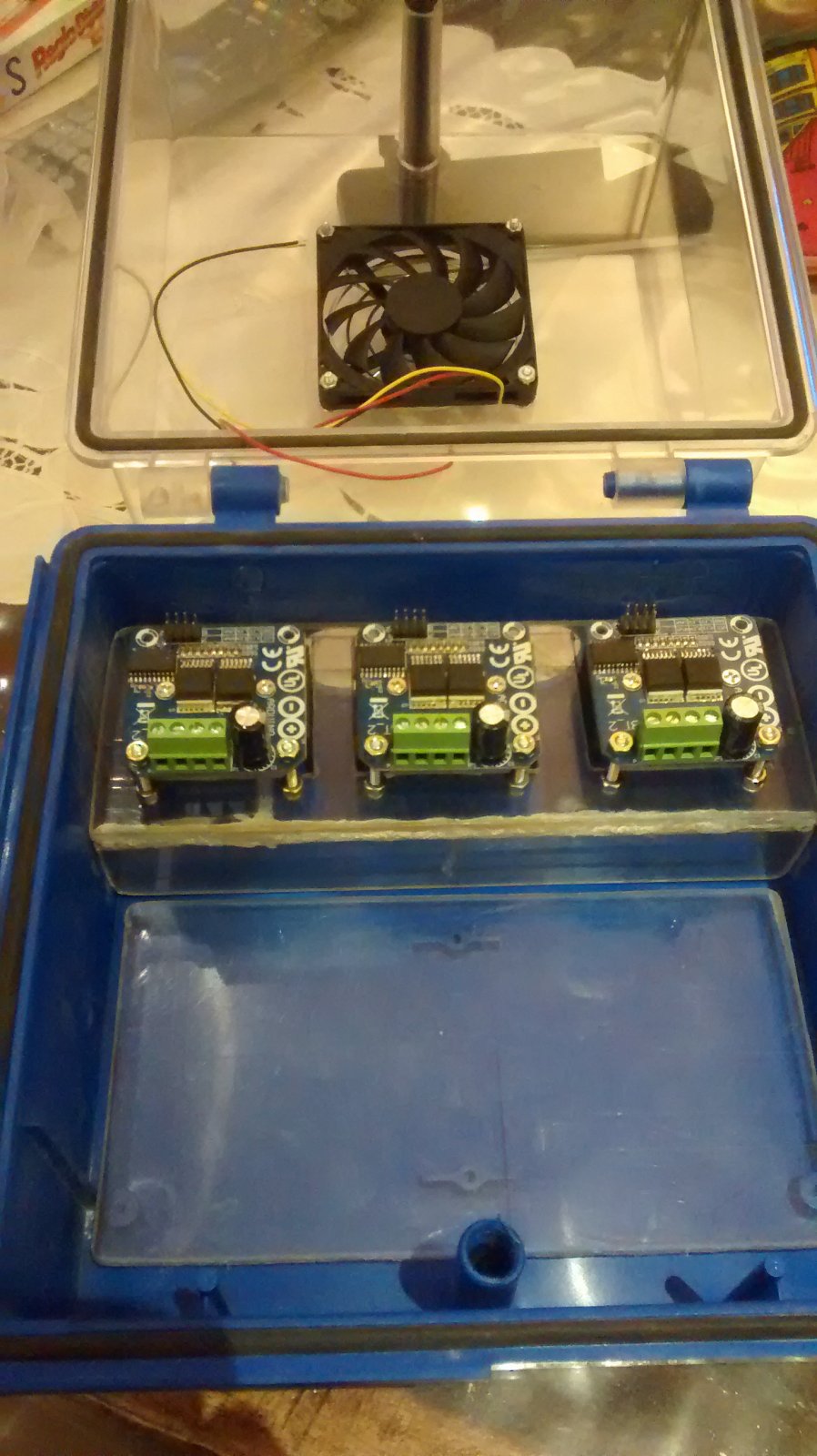

    progress !!!
    IMG_20170130_235712920.jpg IMG_20170130_235801143.jpg IMG_20170130_235811379.jpg IMG_20170130_235826194.jpg IMG_20170130_235955008.jpg

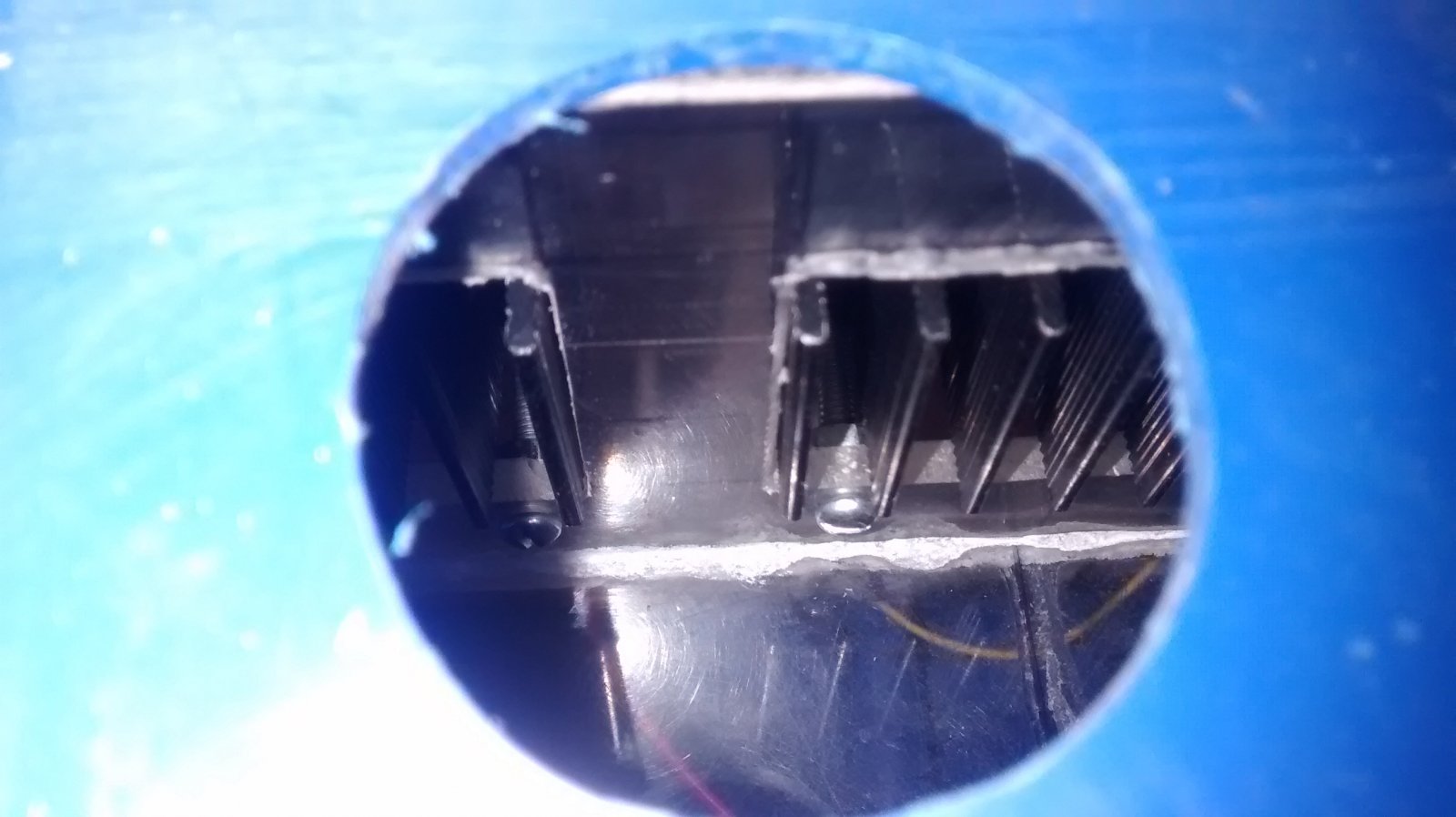

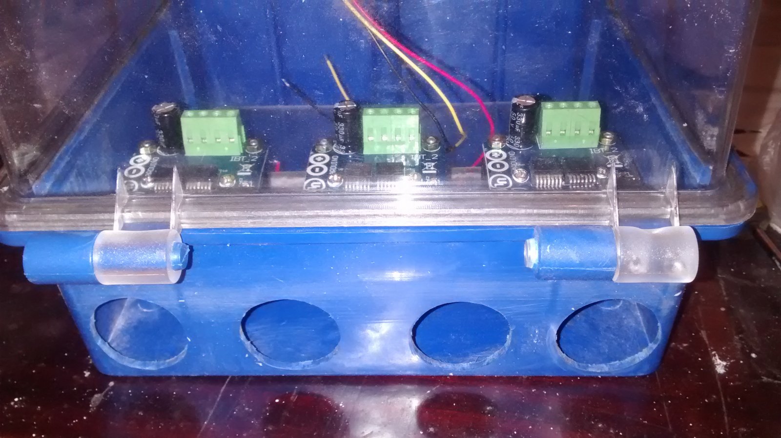

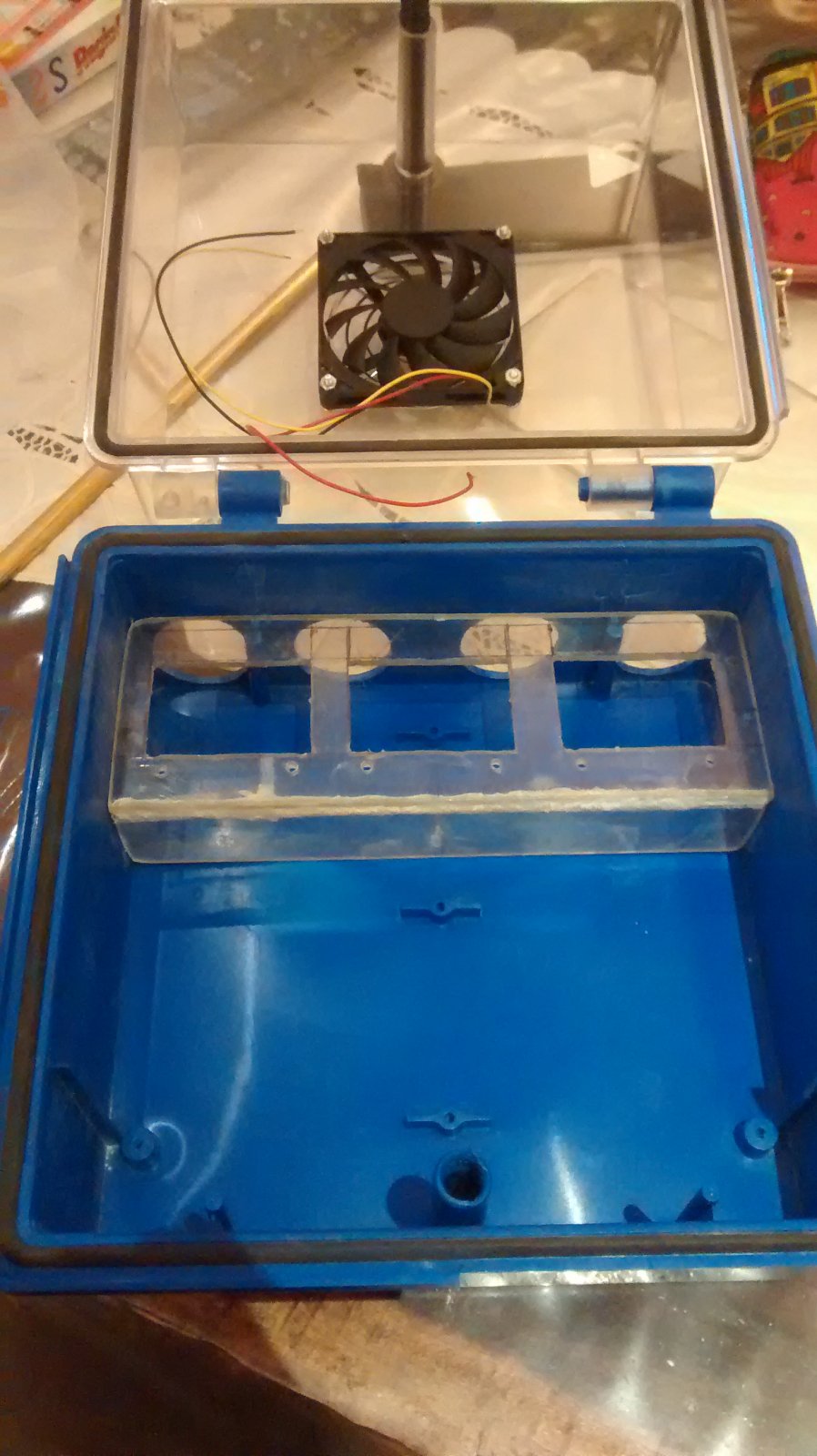

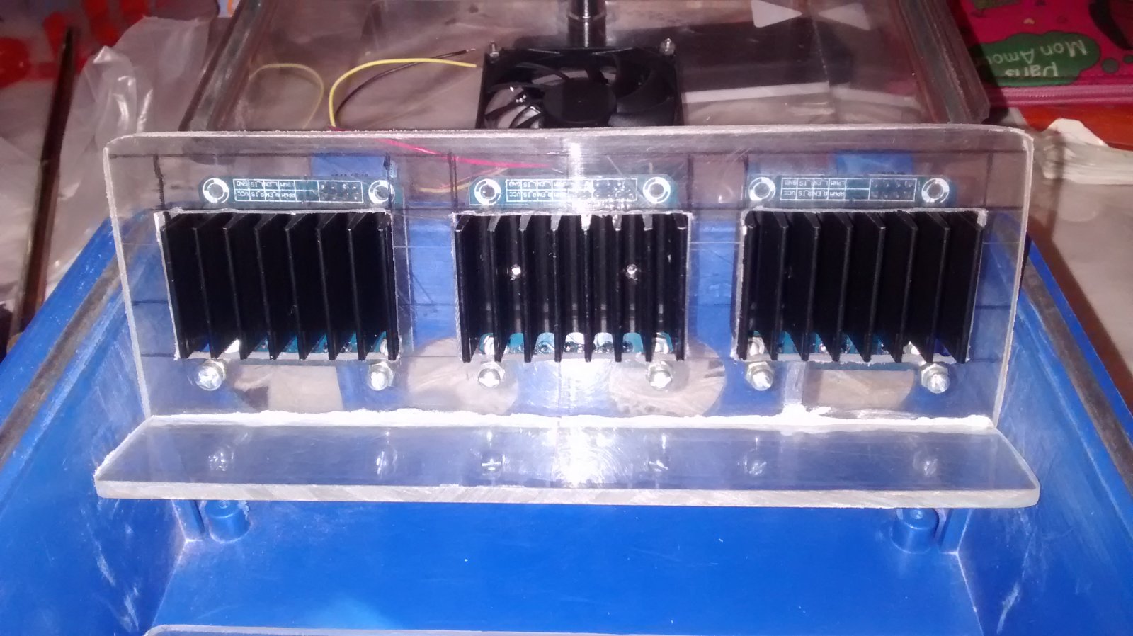

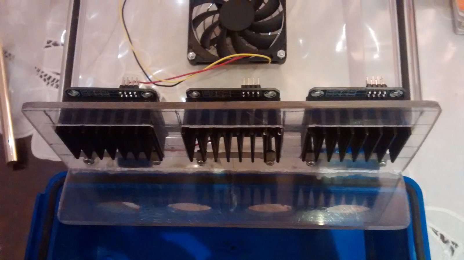

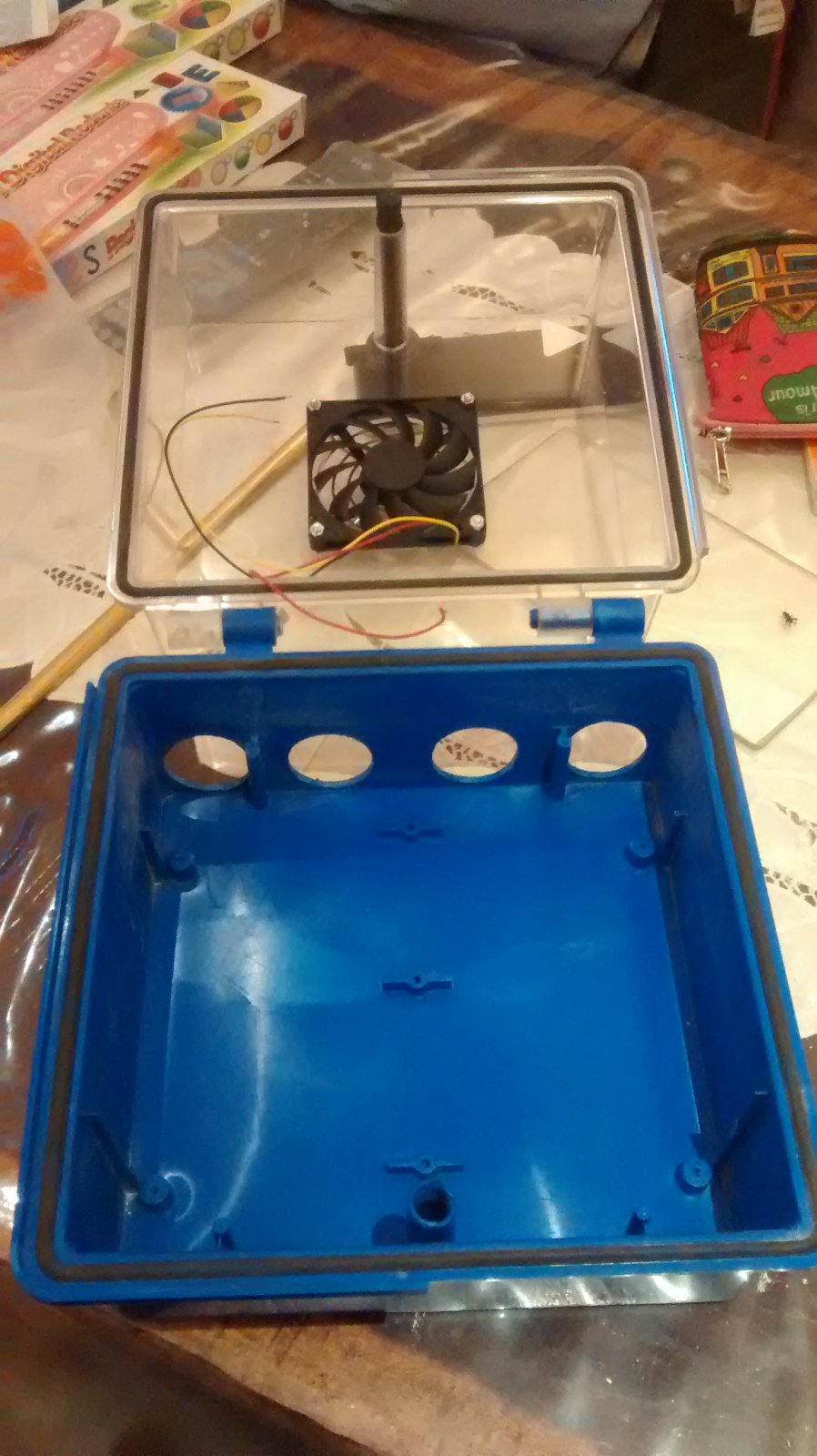

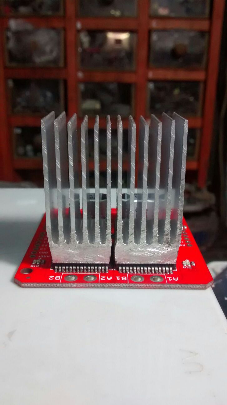

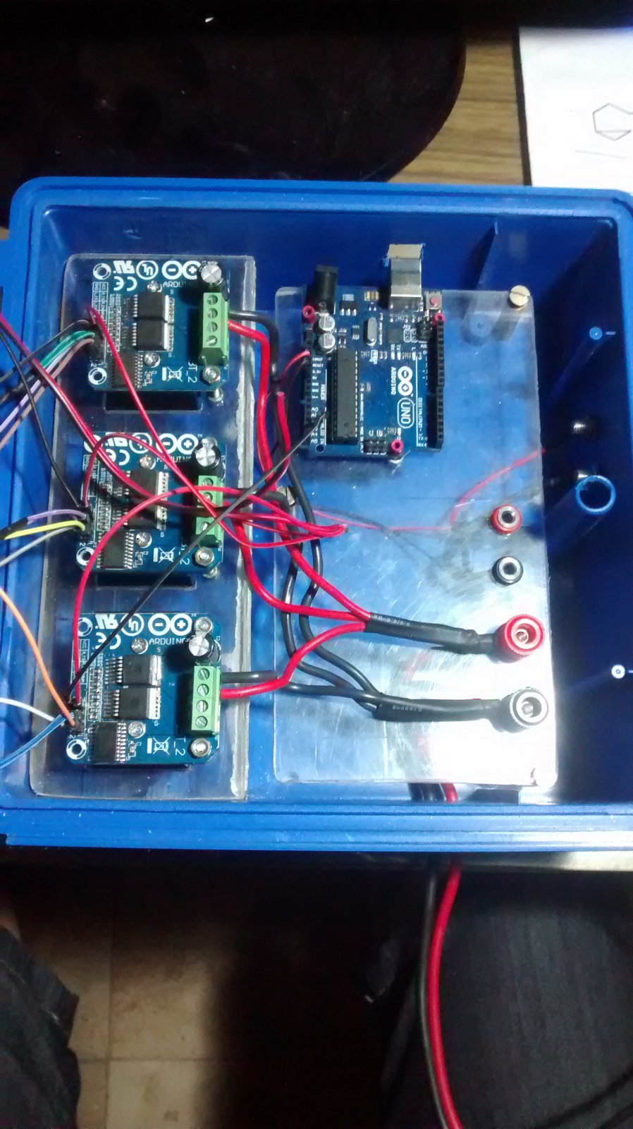

    The air enters through the four holes of the upper part, passes if or through the heat sinks and the one removed by the cooler from the lid .. which I am going to put a bigger one !!! If we see well in the second image I made an acrylic base in which are the IBT-2 and the air only passes through the heatsinks ... they like it? I hear recommendations ...

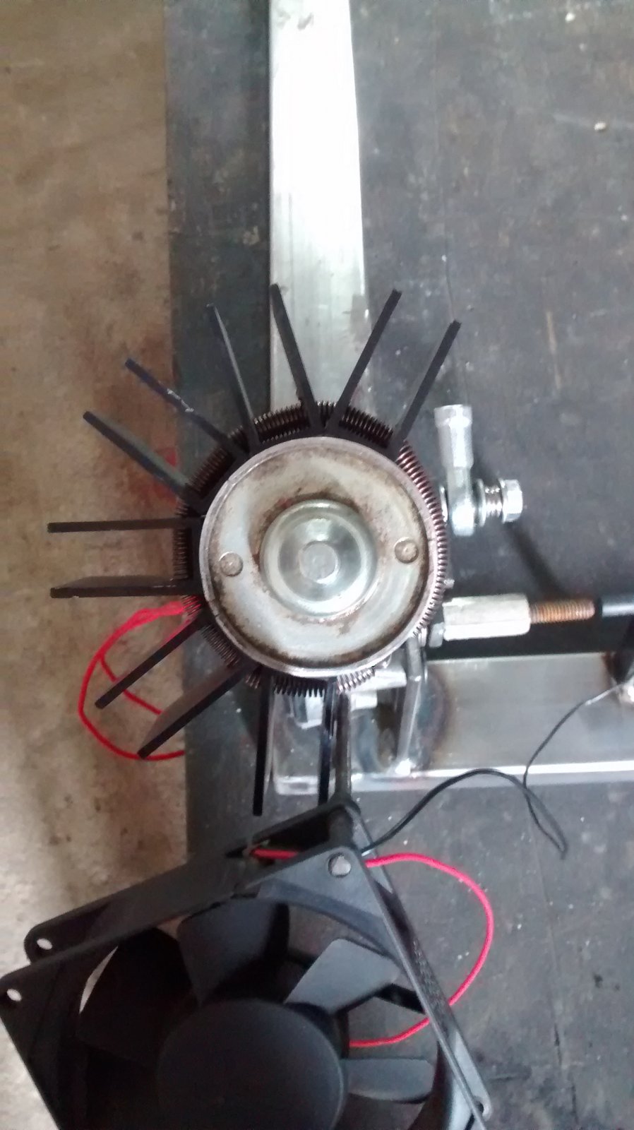

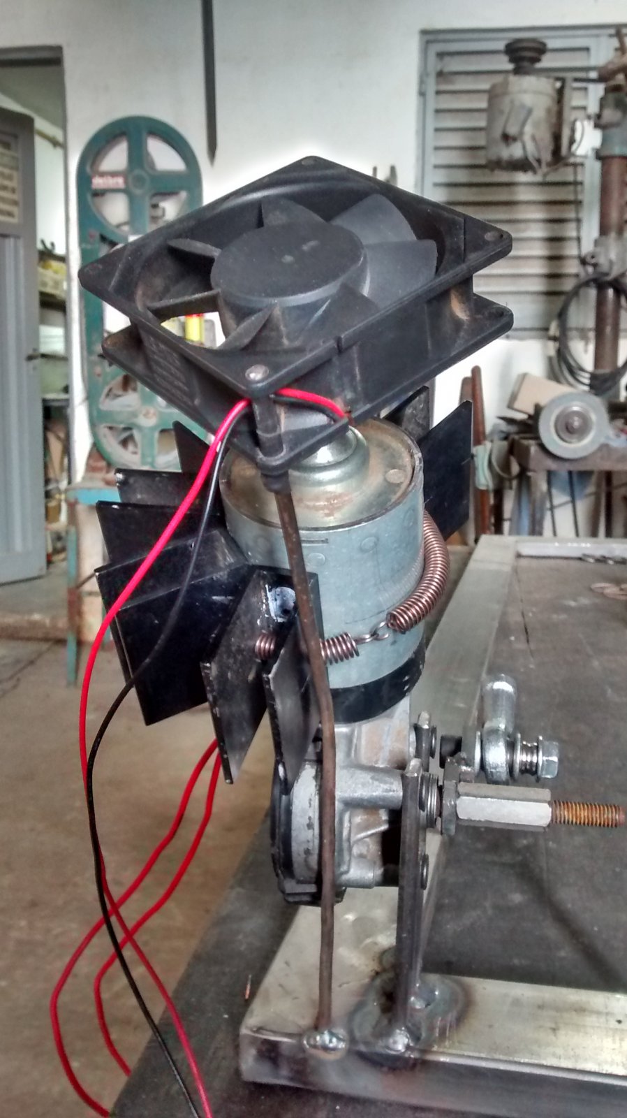

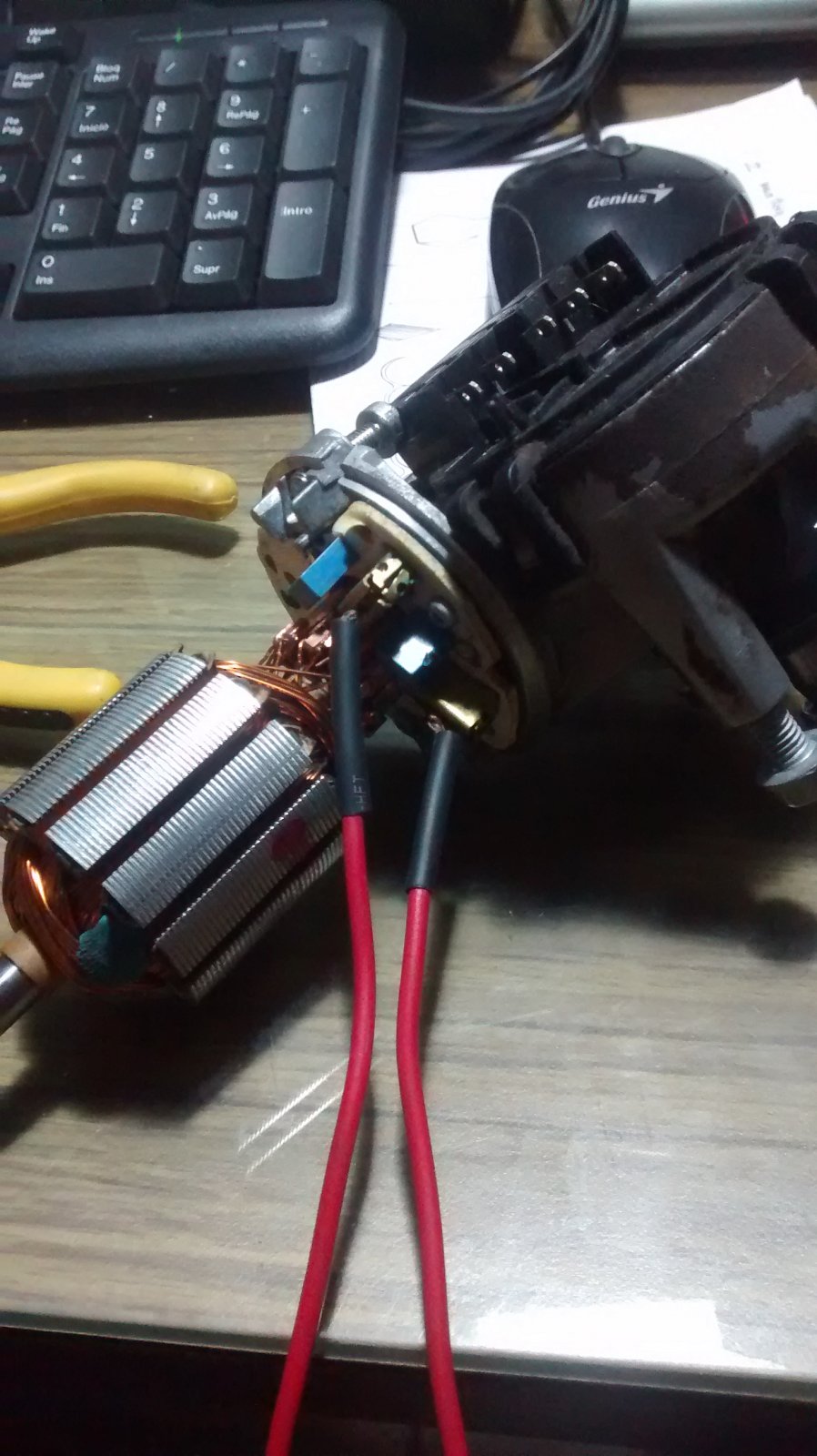

    Hello guys .. engine theme I have a query ... isolate and pull the three wires out directly from your coals to find the fastest speed ... it turns out that the faster speed give me between the coals that are closer and the Spend time start to rise temperature ... with the other cables goes too slow! What will be happening
  11. insanegr
    insanegr !N$@n€
    Jan 14, 2014
    504
    Athens
    16,721Coins
    +499 / 1 / -0
    you don't need a wire for the low speed brush. only for the hi and common brush

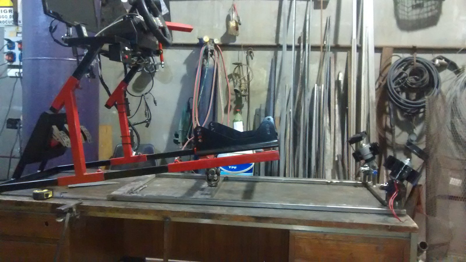

    working!!!

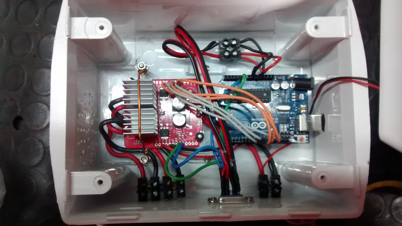

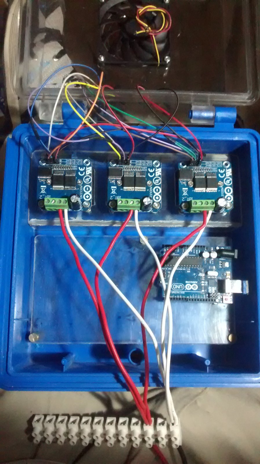

    A bit tidier wiring ... still missing !!!
  15. Pit
    3,012
    30,480Coins
    +3,097 / 31 / -0
    Congrats mate, any video on this? I'm looking forward to the first long tests if the ibt chips will "survive" or not. So thinking positively.
  16. Juanjo1986
    Juanjo1986 Member
    Jan 6, 2016
    53
    Comerciante.. Copiloto Rally...
    Argentina
    489Coins
    +18 / 1 / -0

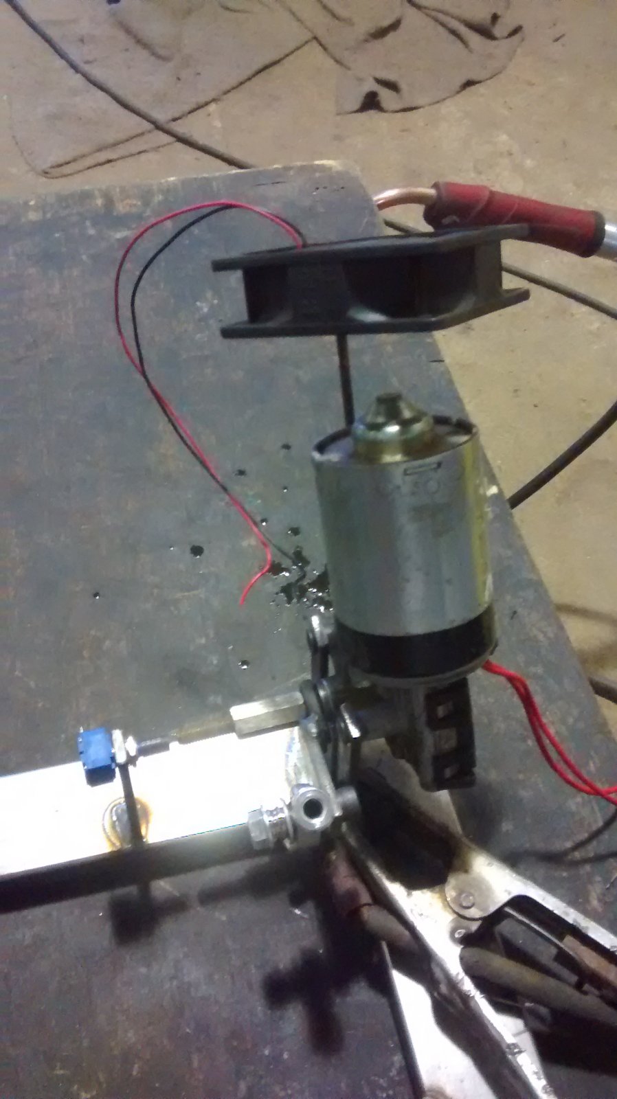

    Hi pit You say that the IBT-2 are going to rise and they will burn? :-( :-( Carry a cooler the cabinet for cooling
  17. Pit
    3,012
    30,480Coins
    +3,097 / 31 / -0
    In any case you have to use active fans on the cooler, passive cooling is not enough.
  18. Juanjo1986
    Juanjo1986 Member
    Jan 6, 2016
    53
    Argentina
    489Coins
    +18 / 1 / -0
    Ok, I'll see to incorporate some cooler above the heat sinks. The passive circulation of the air if or if it passes through the fins of the heatsinks
  19. Pit
    3,012
    30,480Coins
    +3,097 / 31 / -0
    passive circulation is just not enough.
  20. Juanjo1986
    Juanjo1986 Member
    Jan 6, 2016
    53
    Argentina
    489Coins
    +18 / 1 / -0
    Ok thanks a lot for the recommendation
