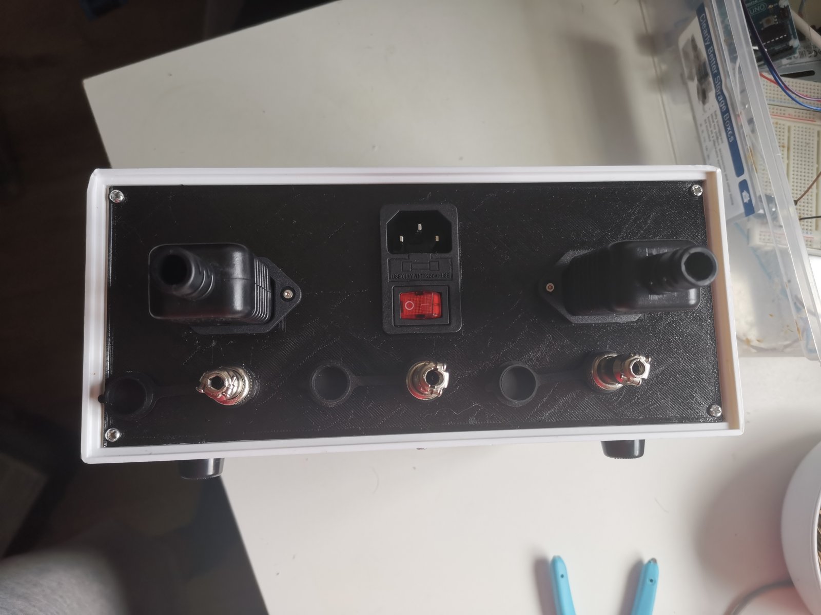

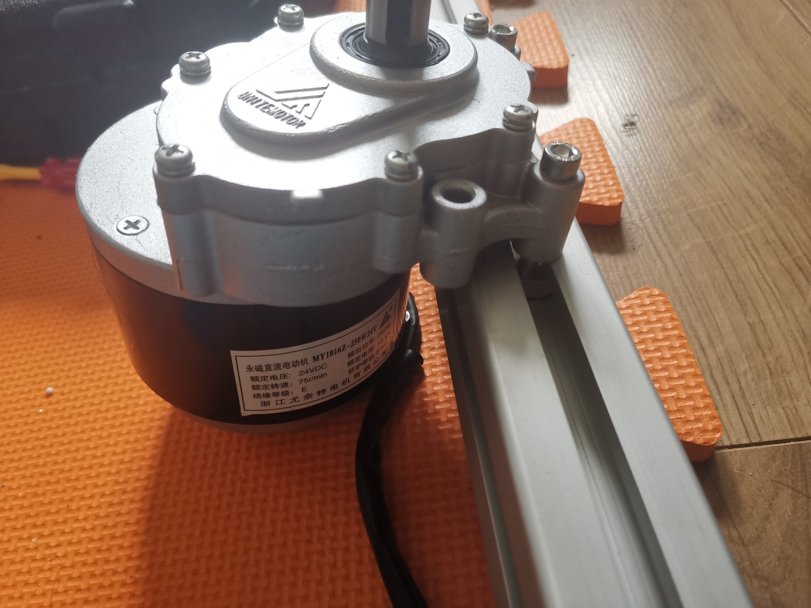

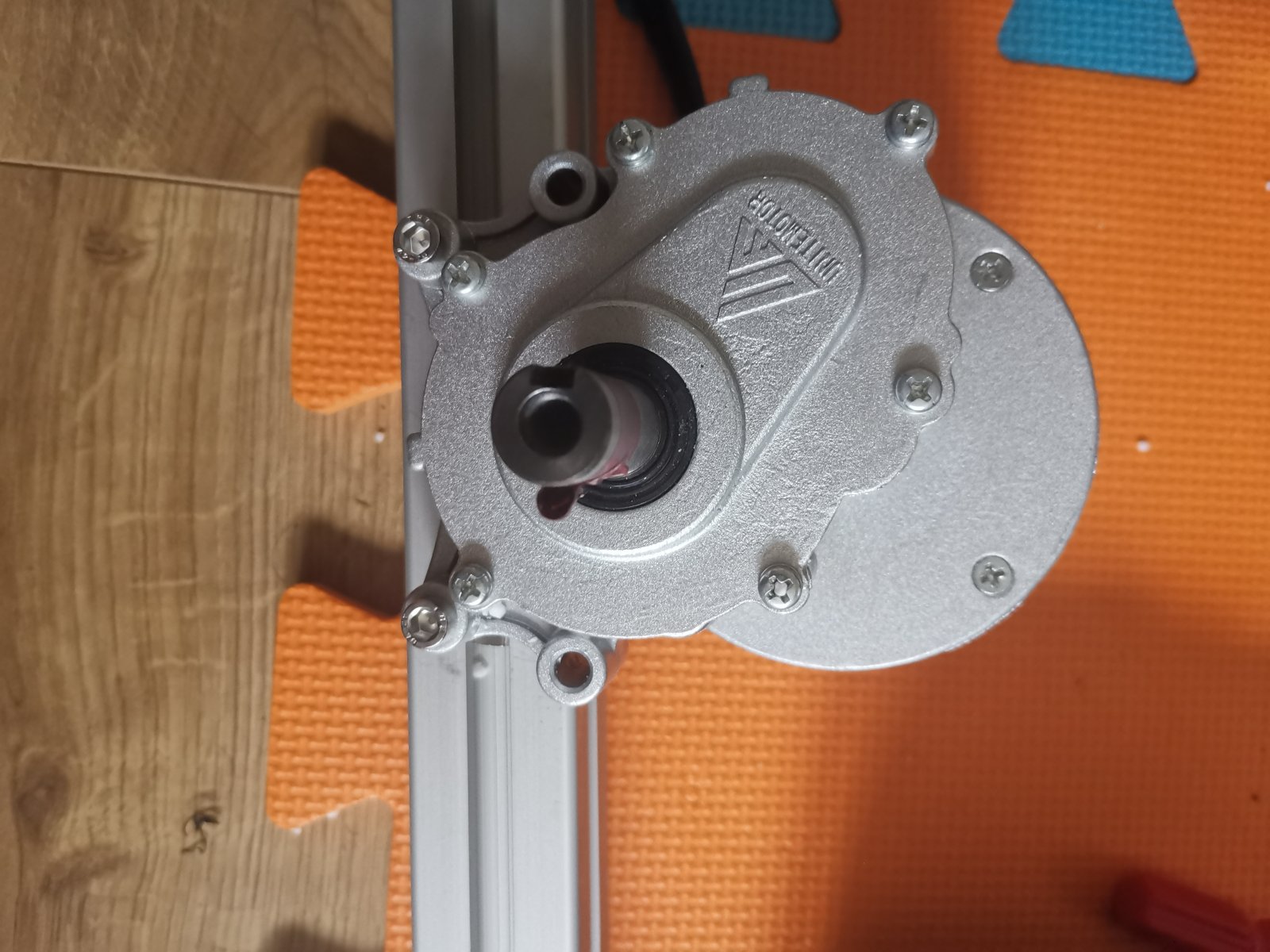

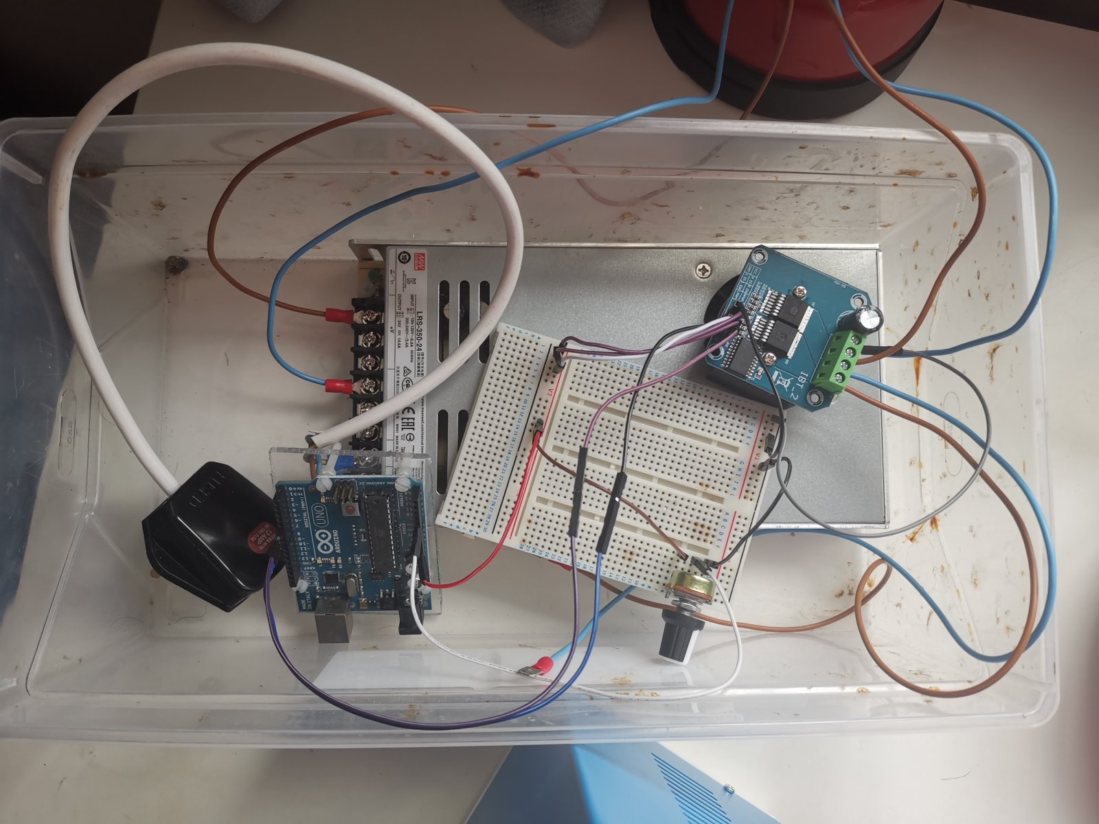

    What I currently have are the following:
    Two motors from Amazon UK. The same model 24V 250W 75rpm.
    Meanwell LRS-350-24
    Motor controller BTS7960B DC 43A
    Electronics box with 3D printed front panel.

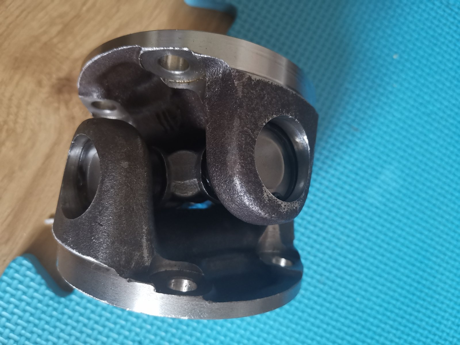

    U joint from Bearmach (BR1741 and BR0664).
    A lot of different Arduino and RaspberryPi.
    very basic 10k potentiometers

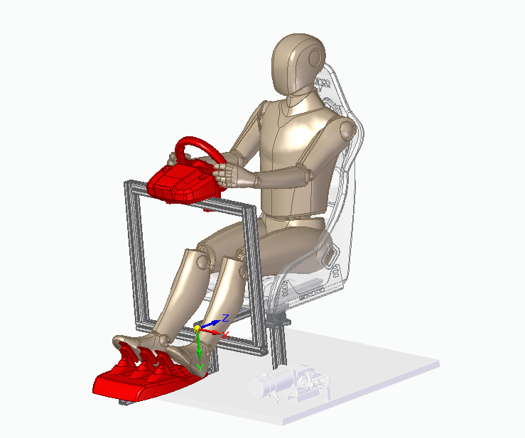

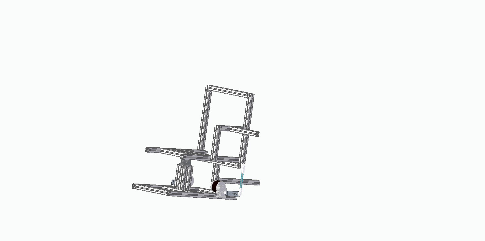

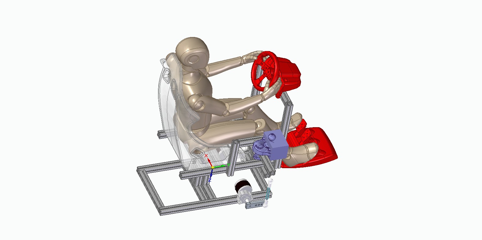

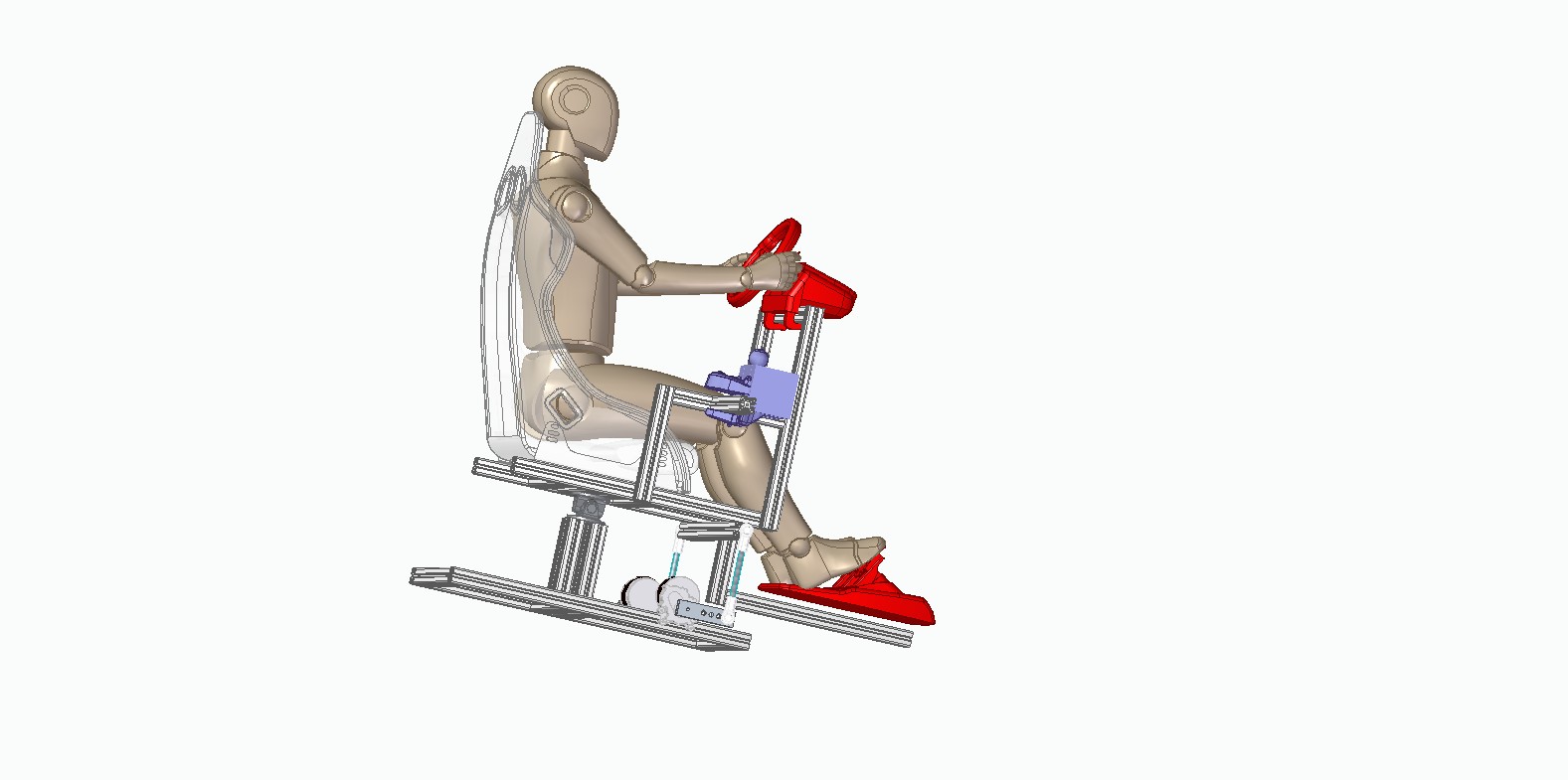

    For the design, I tried to combine @Caveman 's Prototype Racing Sim v4 and @noorbeast DX design. Currently will be 2DOF, but for the future, I want to add traction loss as well. The design is based on the aluminum profiles. It is not finished but will be like this.

    That link for the u joint is a life saver, have you tested it yet?

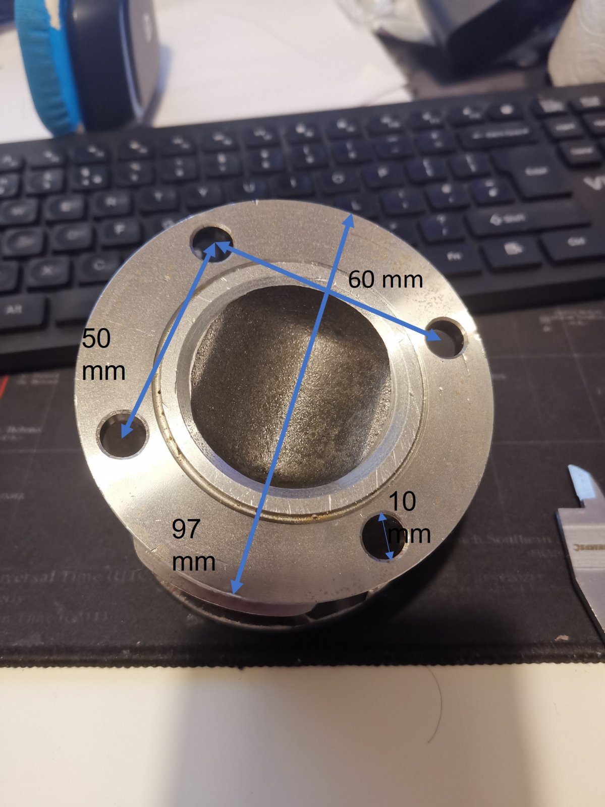

  6. Hao
    Hao New Member
    Mar 29, 2019
    8
    United Kingdom
    - 11Coins

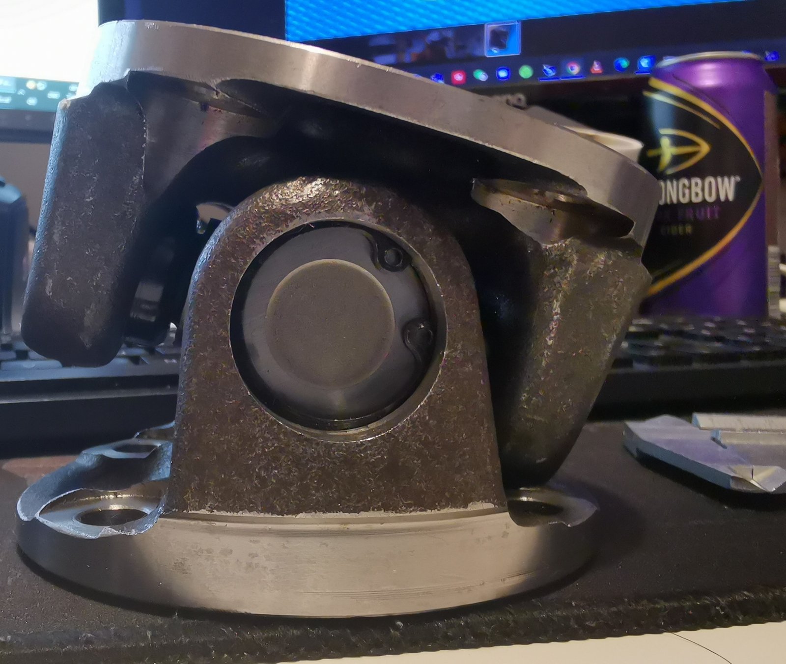

    I have not tested it yet. In the current stage, I am still designing the rig. I plan to build it using an aluminium profile or strut because I don't have a welder. I need to get the key component like this U-joint, rose rod and motor arm, then I can fix my design and order the strut.
    I have some basic measurements for you, hope it helps.
    I think the angle will go +- 15 degrees.

    Next is to finalize the design of the simulator.

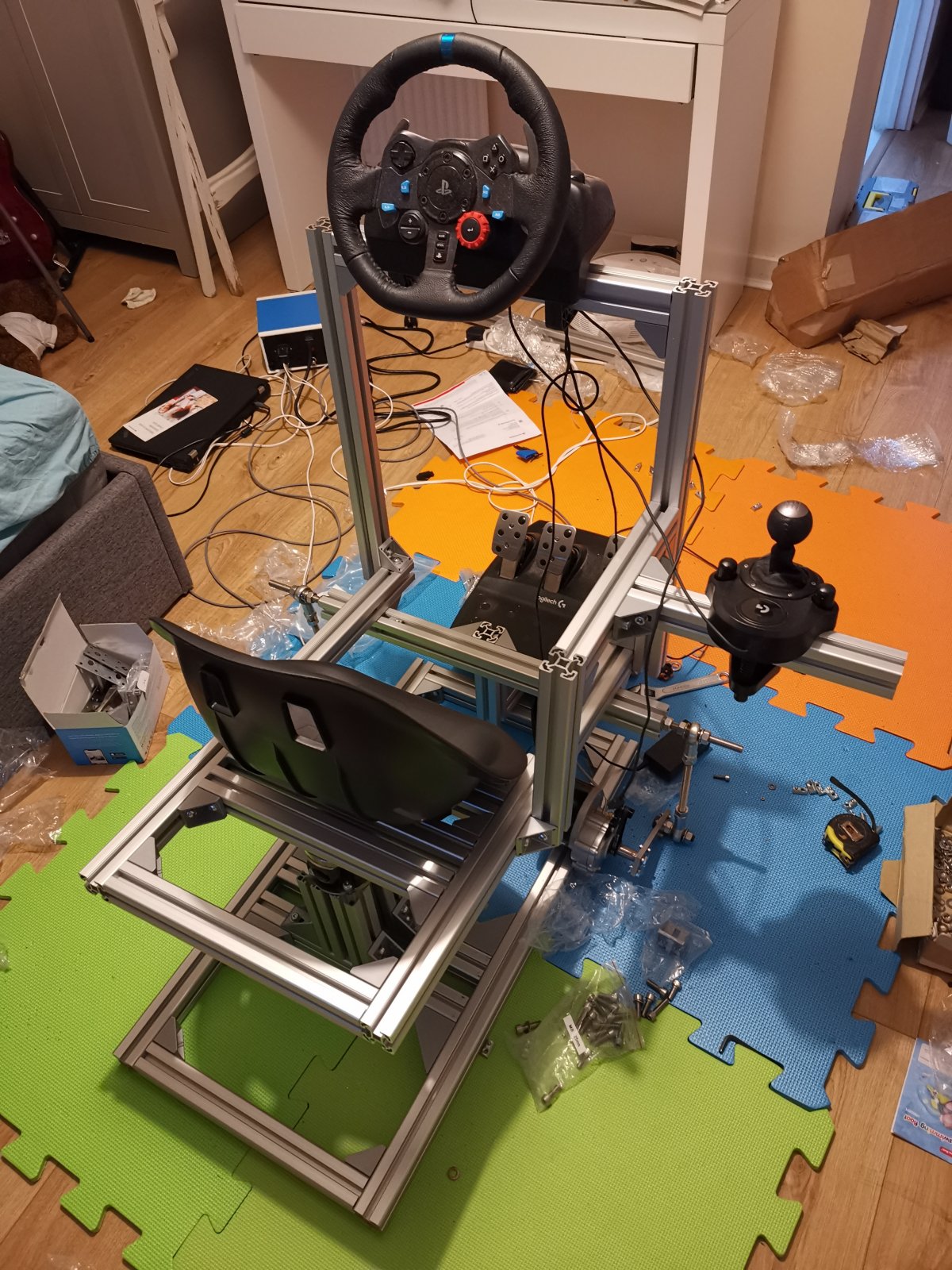

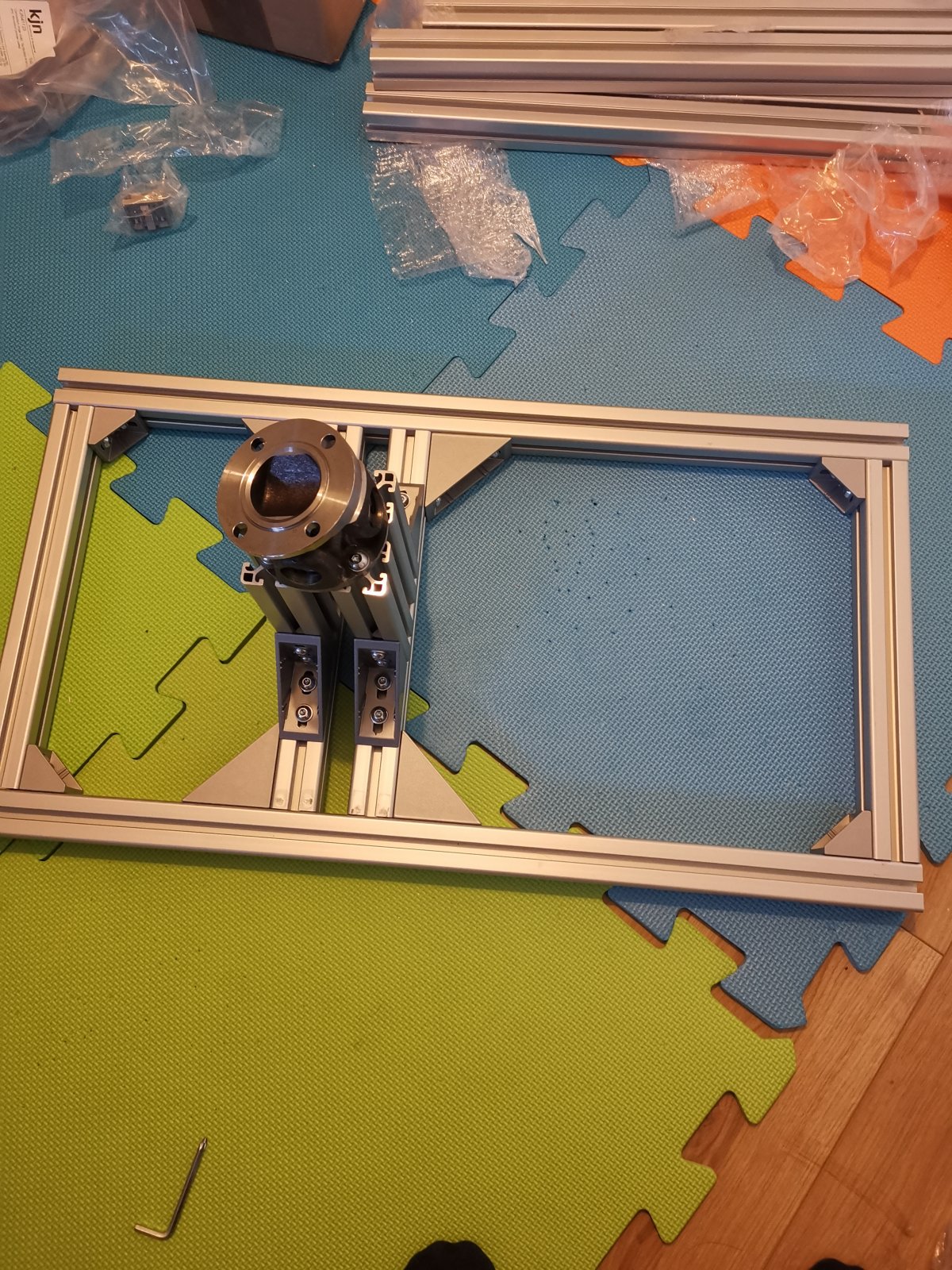

  10. Hao
    Hao New Member
    Mar 29, 2019
    8
    United Kingdom
    - 11Coins

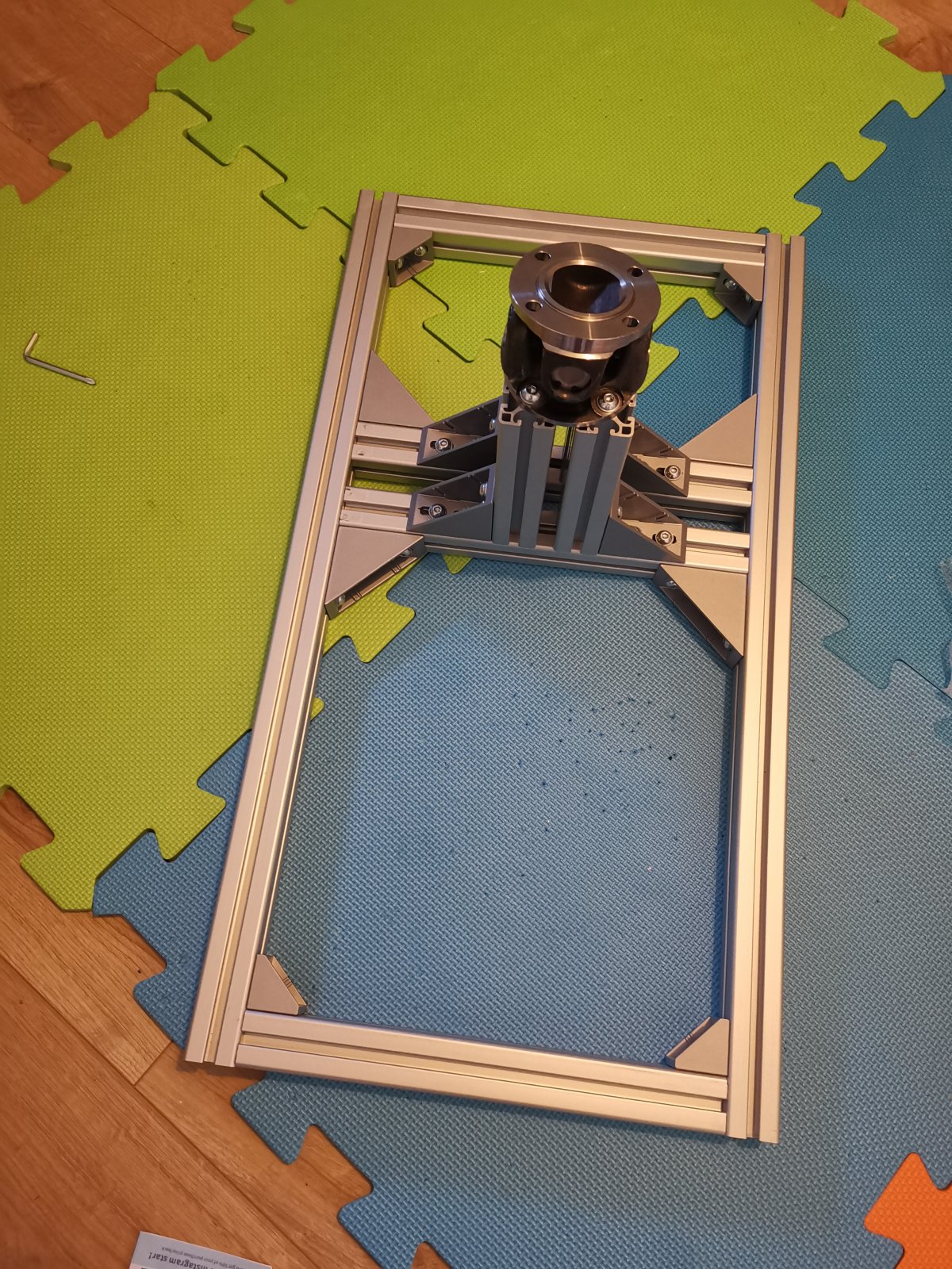

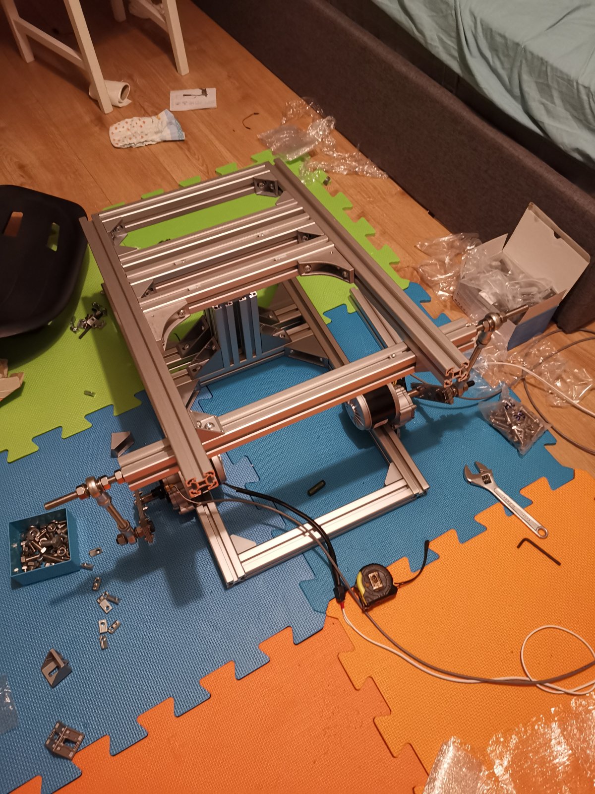

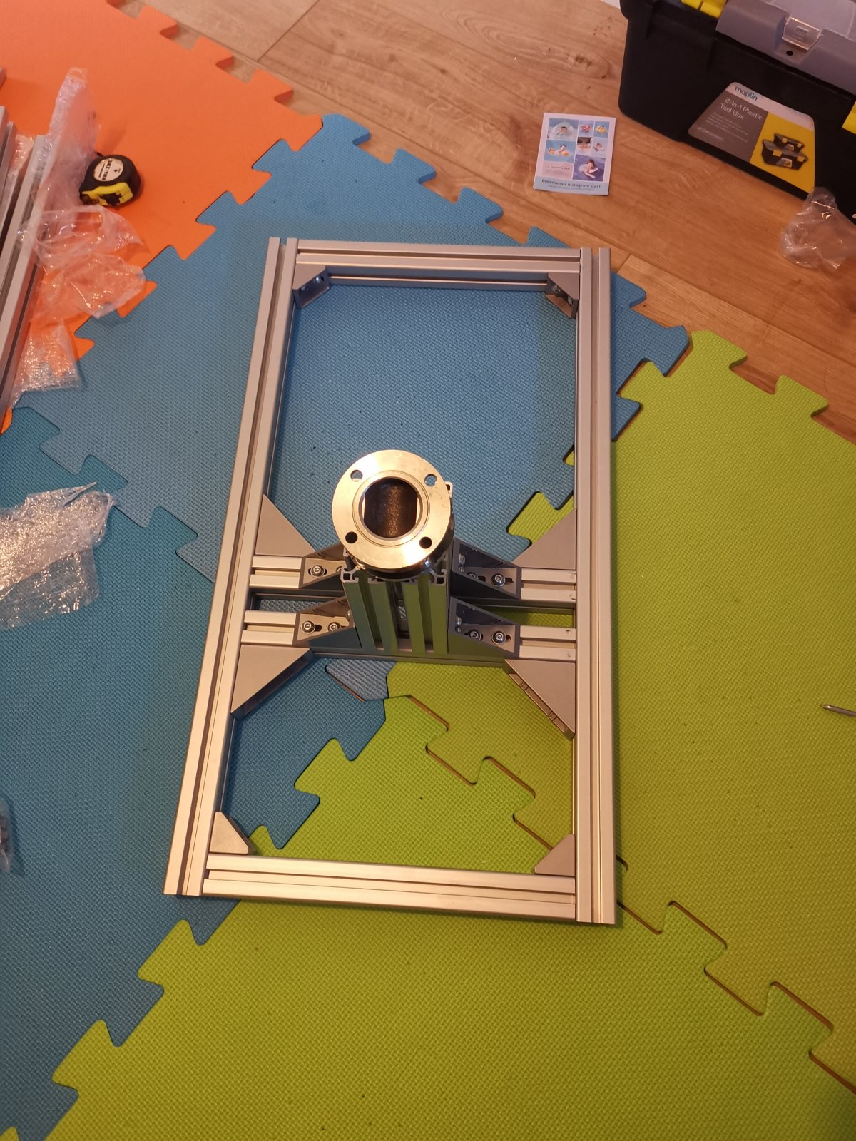

    Get the frame ordered from https://www.aluminium-profile.co.uk/. Two types of holes are needed. One is the M12 to connect the M12 end rod for the motor arm. One is the M8 hole to connect the U joint.
    Begin the building.
    1. Bottom frame.

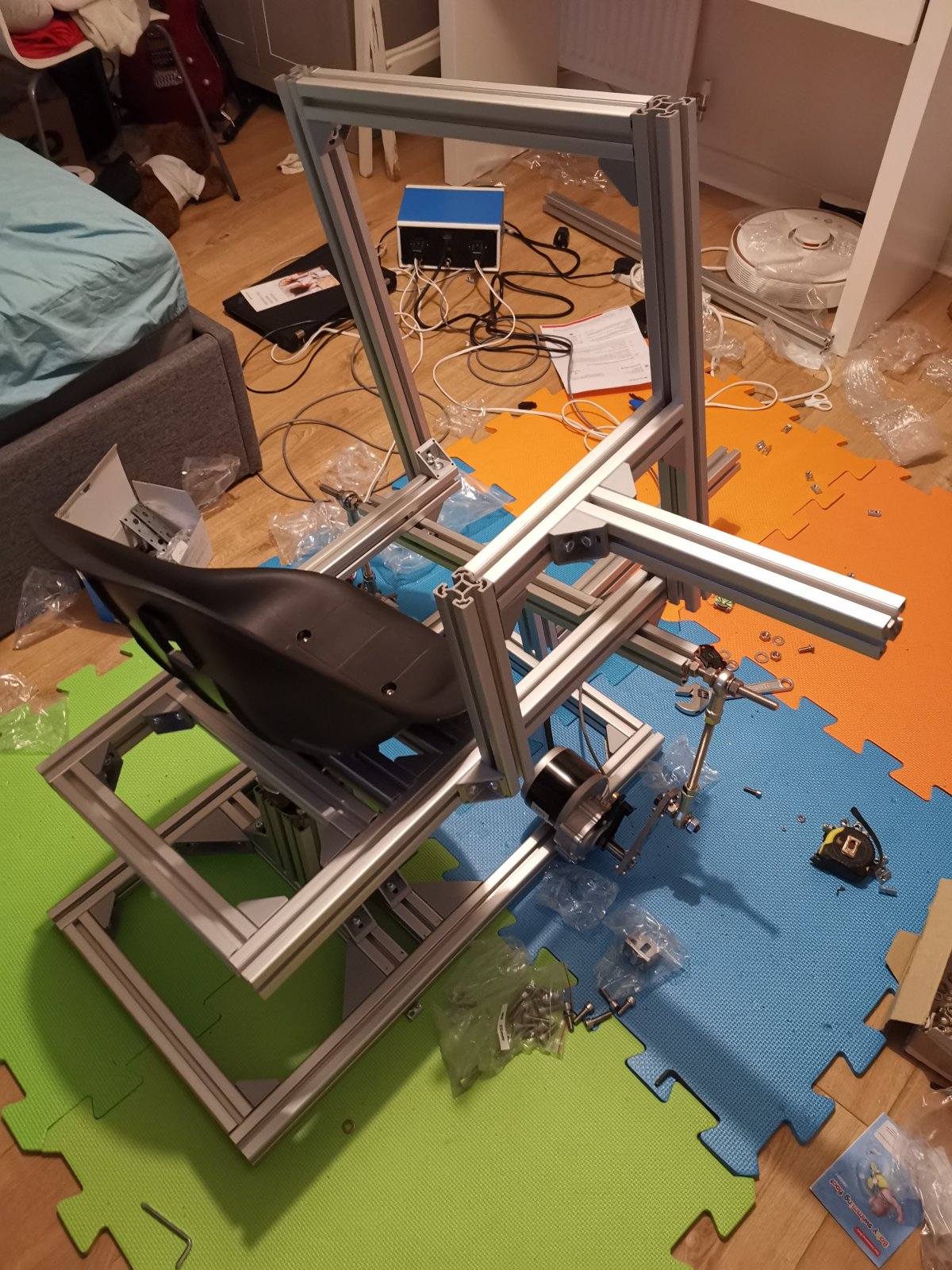

    2. Top Frame.

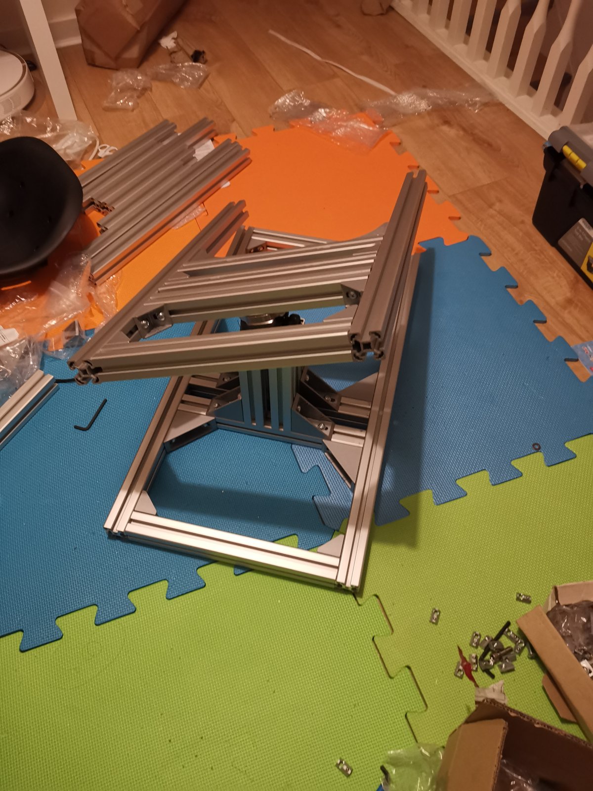

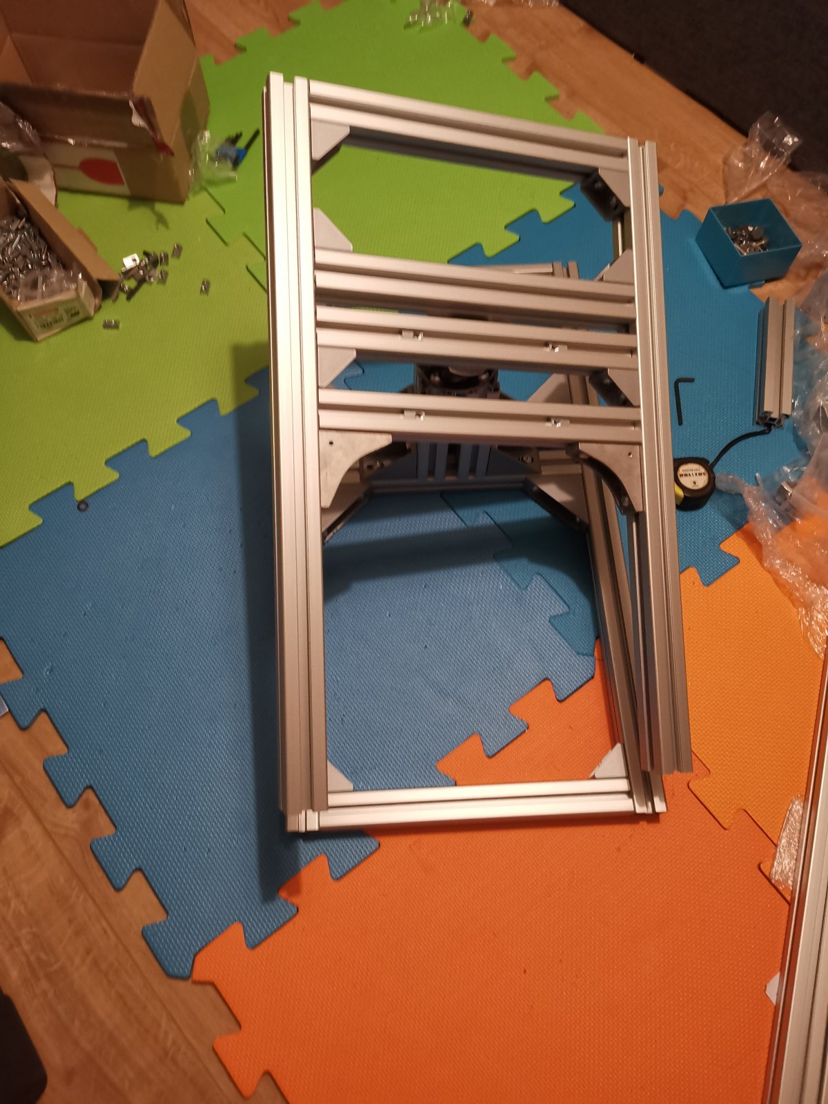

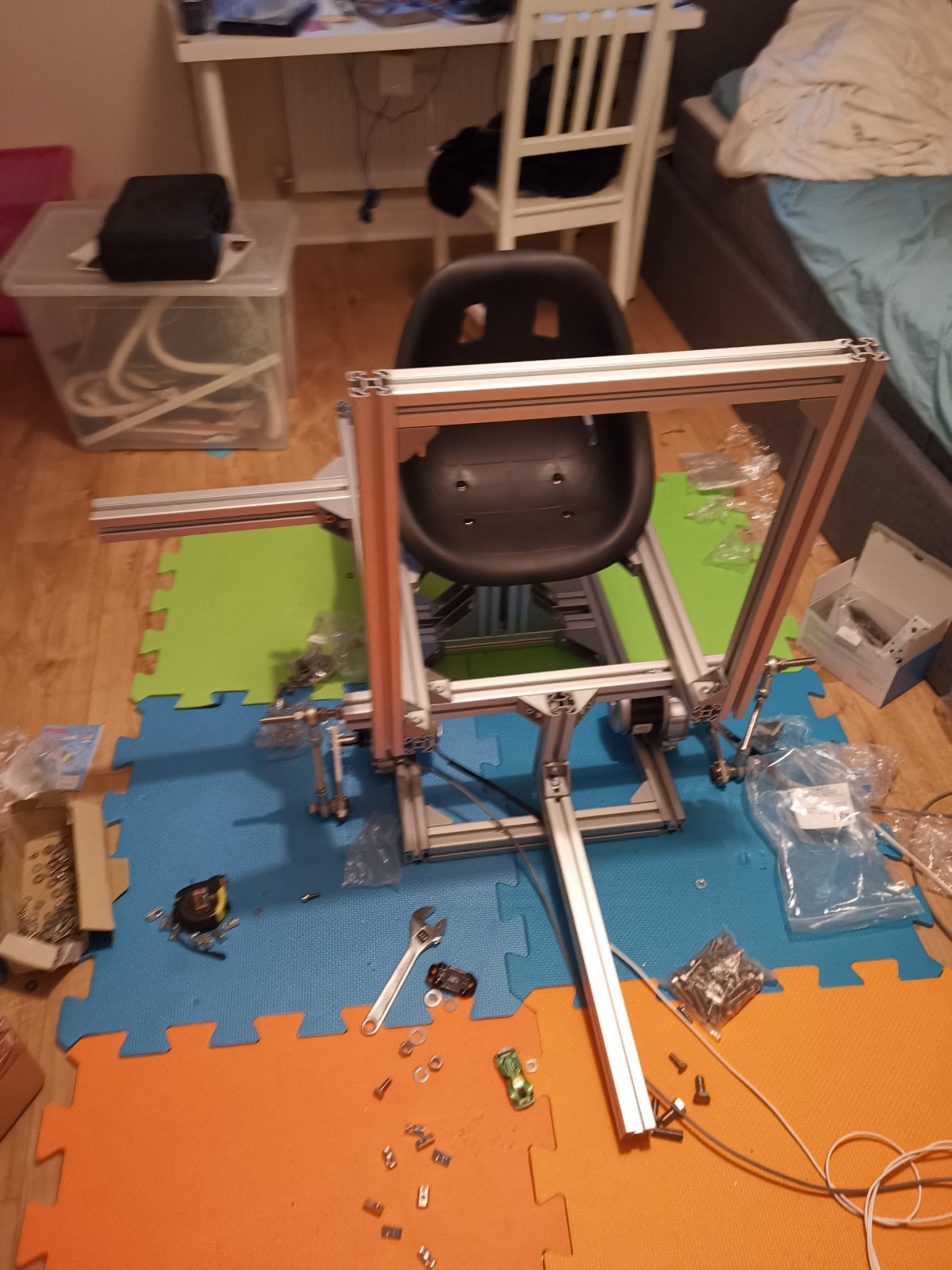

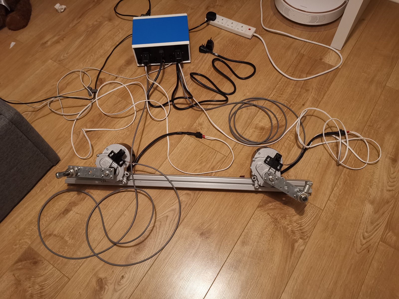

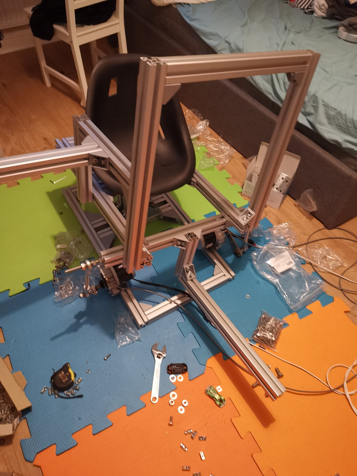

    3. Motors.

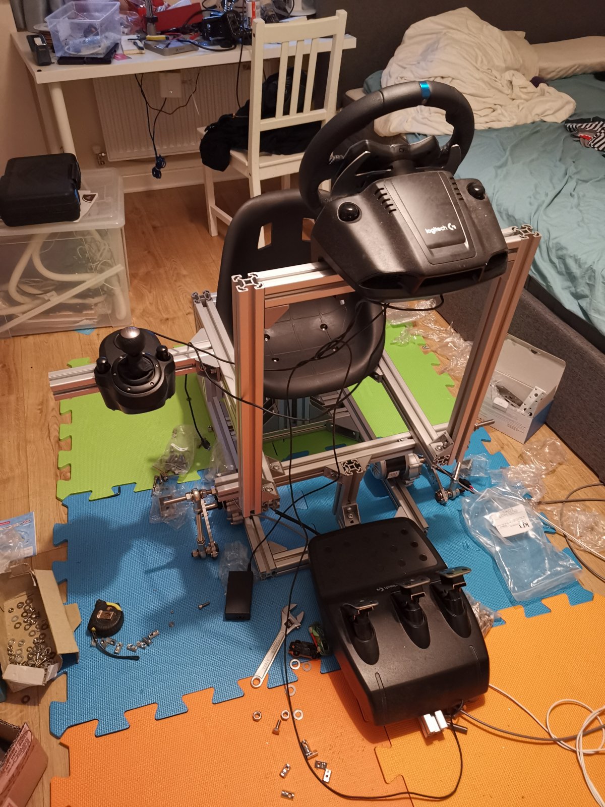

    4. Seat and mounting frame.
    5. Attach Logitec G29
