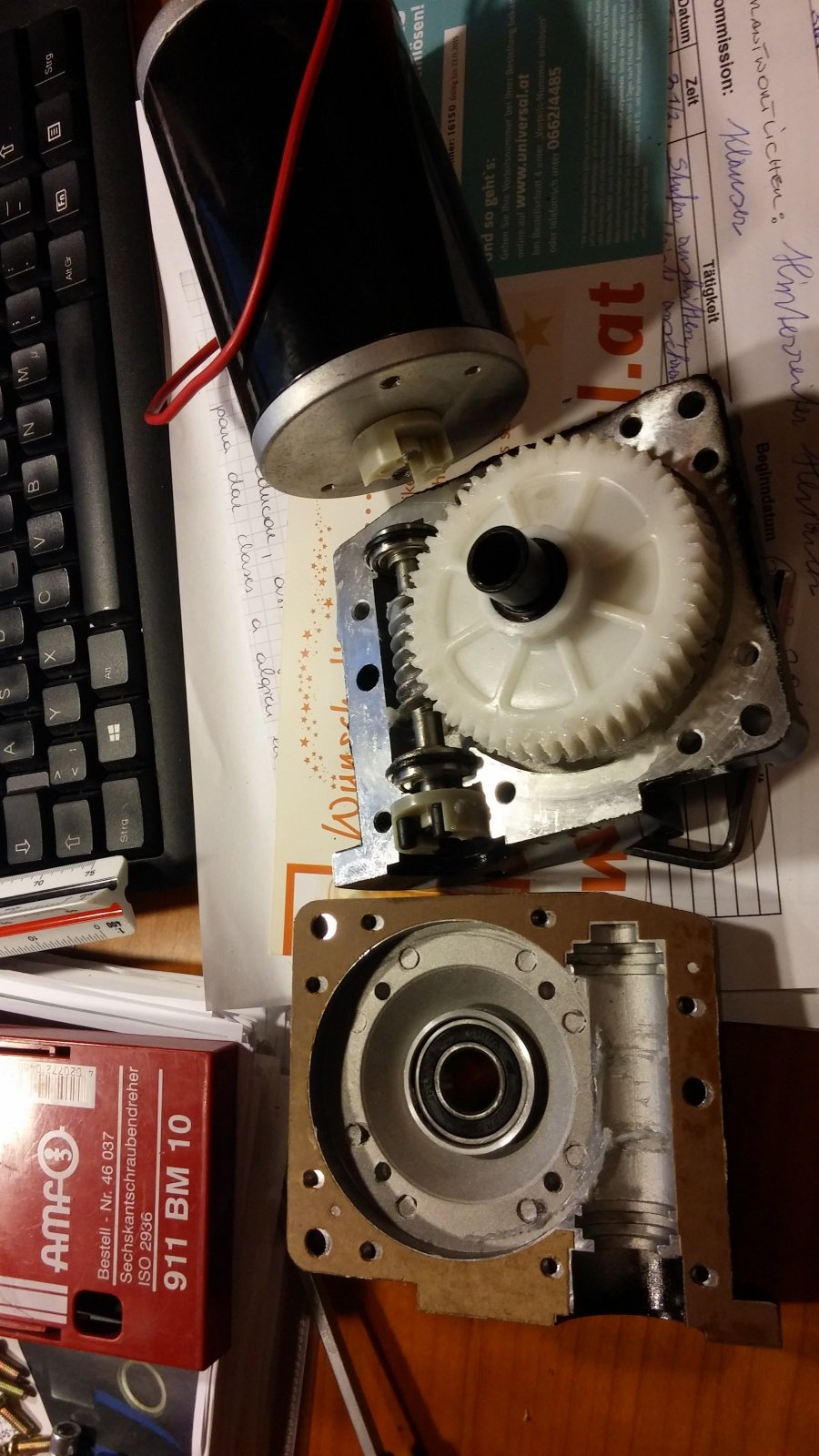

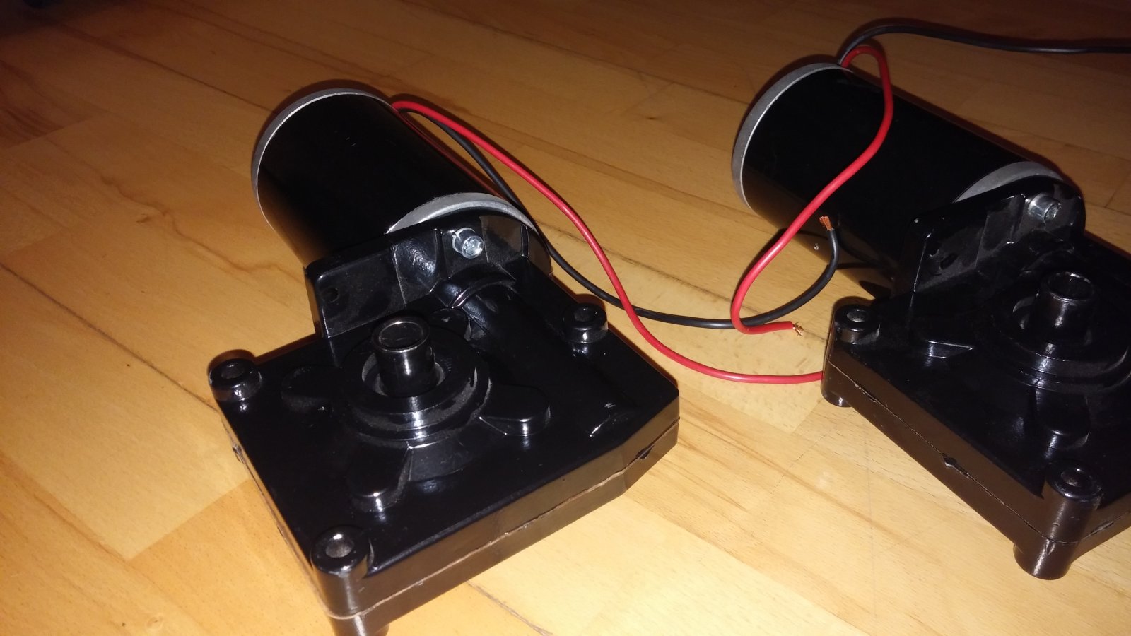

    Got my Motors after 3 weeks from Canada.
    How can i change the rotation direction?
    21,487
    150,542Coins
    +11,017 / 55 / -2
    I am not certain what you mean by "change the rotation direction".
    Do you mean how is the motor wired to the controller and pot so that altering the pot changes the motor direction, if so it is like this: http://www.xsimulator.net/community/attachments/jrk-wiring-jpg.16435/
    Or do you mean how do you change the gearbox so there is a left and right configuration, in which case you disconnect the gearbox from the motor, unbolt the gearbox 2 halves, turn the main gear over and bolt it all back together.
  4. Mo165
    Mo165 Member
    Sep 22, 2015
    48
    Austria
    103Coins
    2DOF, DC motor, JRK, Motion platform
    I mean the gearbox thanks! ;)

    I'm not sure why you would need to mess with the gearbox unless you had some extreme space constraints. The motor will spin both directions by reversing voltage (switching the red and black wire). Your controller (JRK, MonsterMoto, etc.) will do that for you. But to try it manually just switch the wires to your 12V power.
  6. Nick Moxley
    17,056Coins
    +2,506 / 30 / -2
    You open the gear box and swap to keep thing's Symmetrical, plain and simple. That is unless you want thing's to be a little "wonky" on the motor placements on an other wise square frame.

    Today I changed the gearbox on one motor.

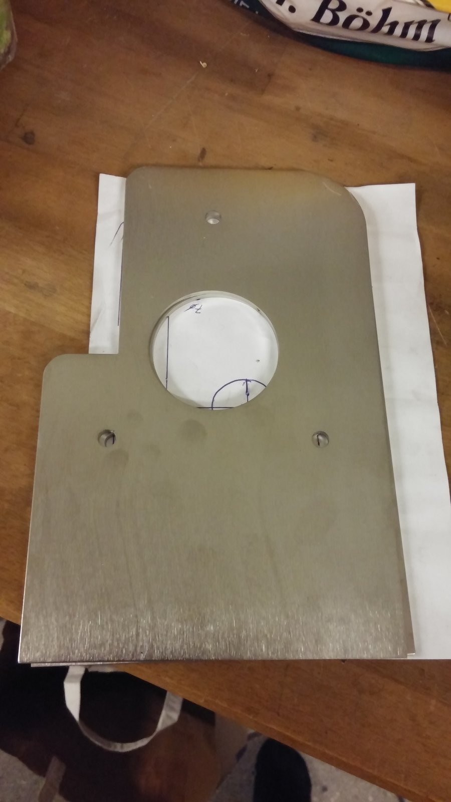

    And I've got the motor mounts!
