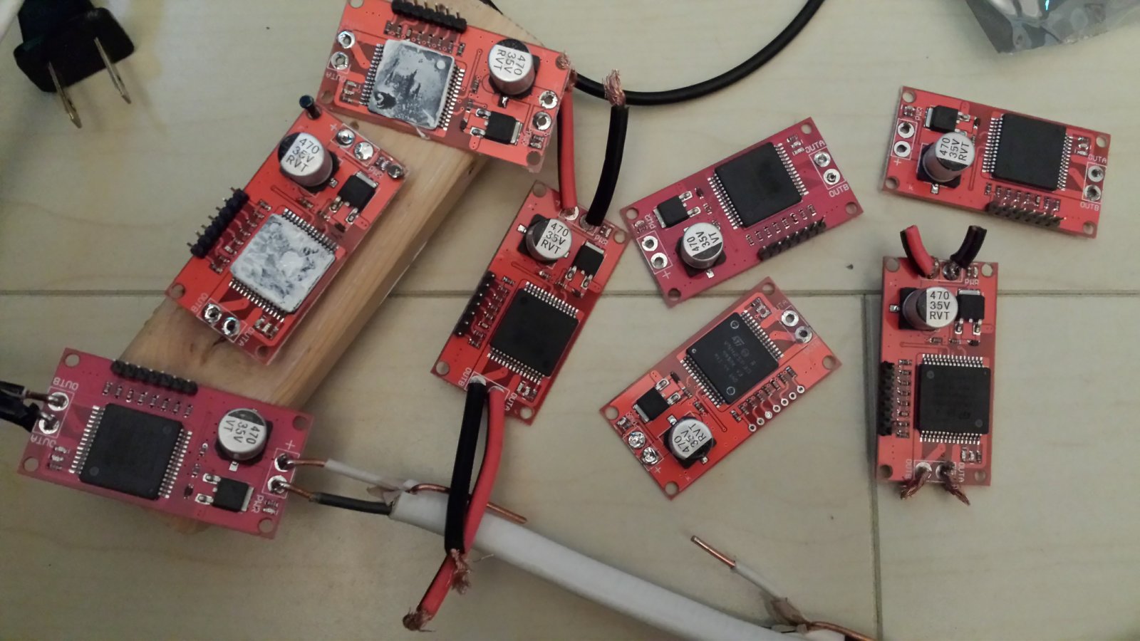

    ok! so i tried different configurations and combination of monster moto shield, psu, and motors, and this is the conclusion:
    motor1 - has been driven by a GOOD monster moto shield
    motor2 - FAULTY monster moto shield - goes backwards slowly, if at all
    motor3 - FAULTY monster moto shield - very random in many ways
    and the kicker is that i bought the MM boards more than a month ago and therefore cannot return them...
    i should have read the forums before, because now i see that many people have had this problem and Noorbeast recommended that we test them out first.
    okay, i'll be ordering some boards from Amazon, as they have fast shipping and the return policy is good. also in the meanwhile, i'll be ordering some boards from China -- maybe a handful of the cheapest ones? or should i buy just 2 from a recommended seller?

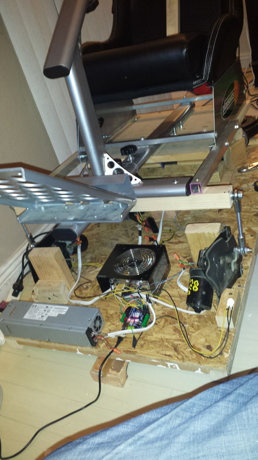

    here is a pic of my PSU and board placement. wires are everywhere
    *SIZZLE* *SMOKE* -- i accidentally fried the ONE good board i had yesterday.... :(
    i ordered some more MM boards, and will not be able to do anything until they arrive...

    So Armpit kindly sent me a handful of MM boards, and i also received some boards from Amazon. With a total of 2 double boards and 9 single boards, i was able to find 3 working chips -- so, 3 out of 13, or 23% success rate... it took some time to test all of them, but now i'm finally able to move forward! Thank you Armpit!
    Here is the pic of the casualties:
    Next is putting heat sinks on them and wiring them up -- the finish line is in sight!

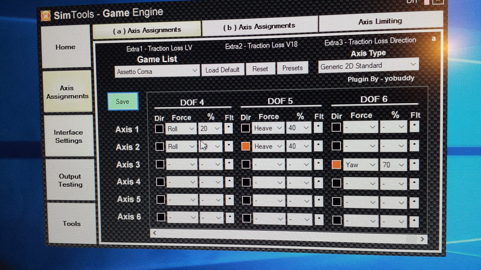

    HEEELLLPPP!
    i put the pots on using J & B weld to the screws that i installed on the wiper motors, and everything from SMC3 utilities is working great!
    HOWEVER, after installing Simtools, and installing the Assetto Corsa plugin, i CANNOT get the Traction Loss to work.
    here is what happens:
    - Surge, Sway, etc. all work fine on the 2dof wiper motors, and i can drive without problems in-game and feel all the forces.
    - When i put "Extra1" for Axis 3, the Output Testing works flawlessly when i move the slide "Extra1", however, in-game, nothing happens
    - When i put "Extra1", "Extra2", and "Extra3" under Axis 3, the Traction Loss motor goes crazy and random in-game. For example, it moves when i shift gears, and also moves randomly, like it's fighting itself at times.
    - This also happens when I put on just "Extra2" -- the craziness is there in-game.
    - When i put "Yaw" as the force on Axis 3, it works perfectly.
    I noticed that on the plugin, it says, "Extra1 - Traction Loss LV", "Extra2 - Traction Loss V18", and "Extra3- Traction Loss Direction" (you can see it in the picture)
    hmmmmm... which one is the right one, and how do i use these functions?
