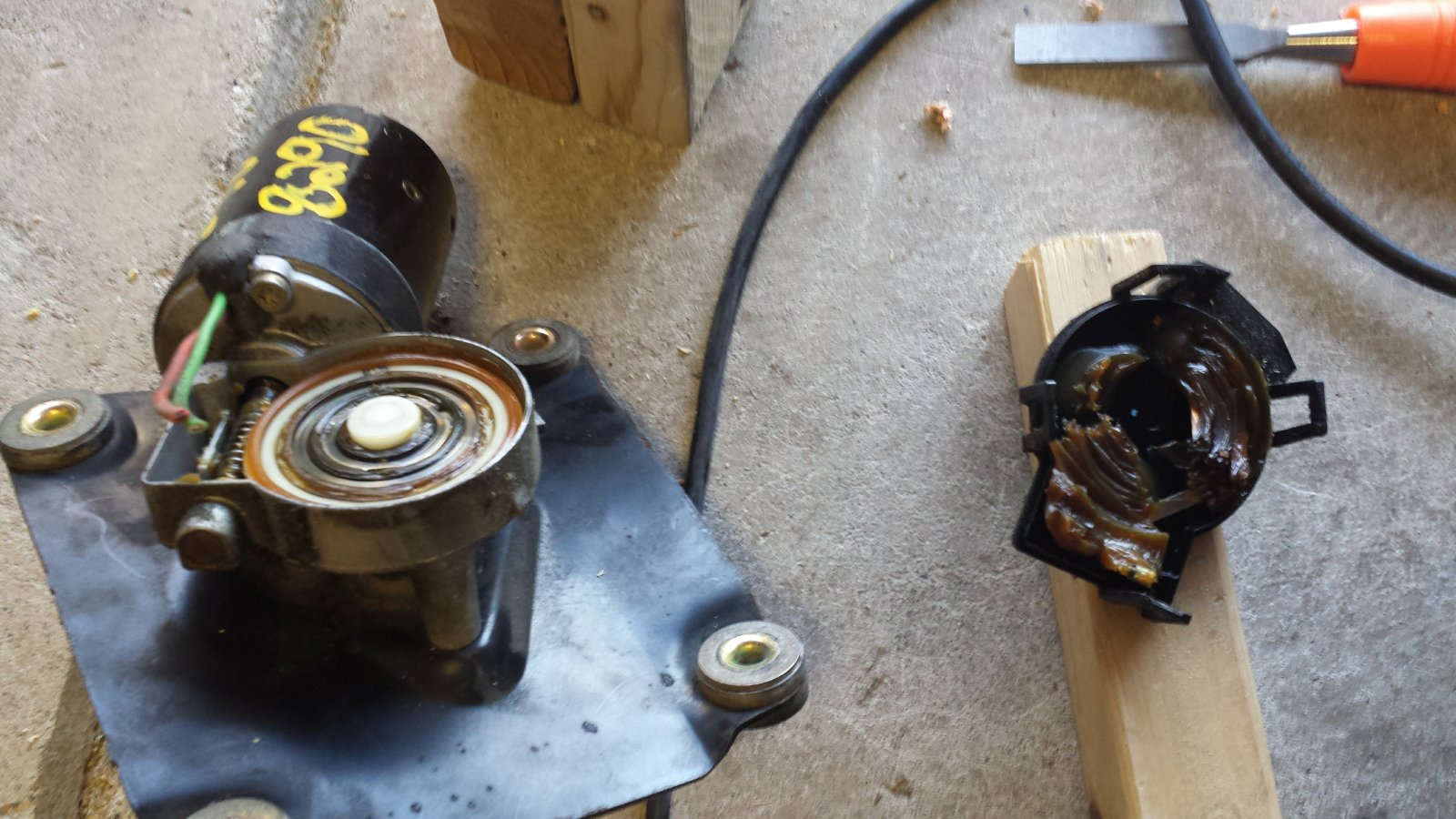

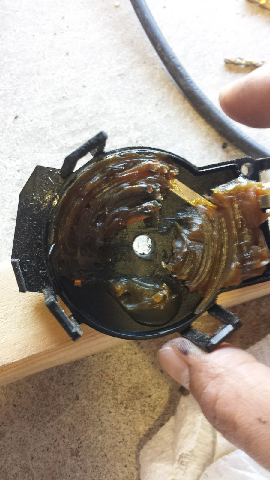

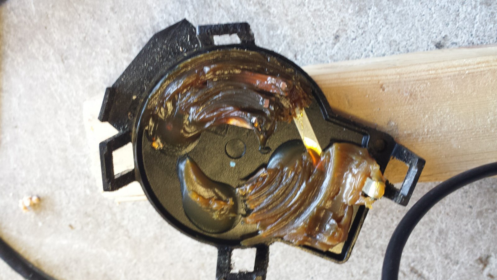

    Oh no.... I finally got around to testing out the wiper motors. They work, but for some reason, they sound pretty loud... oh well ... I'll still use them. (I'd advise against getting the volvo s40 wiper motors)
    • Optimistic Optimistic x 1
  4. armpit
    armpit Active Member
    Jan 7, 2016
    128
    Software Engineer
    SC, USA
    - 8Coins
    +132 / 0 / -0
    Did you test them with straight 12v or was the testing through the motor controllers?
    If it's through the controller there are various things you can do with the PWM frequency or update rates to reduce the 'electrical noise'. (if you are using the SMC3 code, look into increasing the Fpid value and reducing the Kd value to zero for testing)
    If it was with just straight 12v you could try opening them up to add a little extra grease in the worm gearbox which will reduce mechanical noise.
    Or like you said, just use them anyway. Are you married? ;)
  5. Qlittles
    Qlittles Active Member
    Sep 27, 2017
    119
    Union City, California, USA
    226Coins
    +65 / 4 / -0
    Haha, yes, I am married, and the sim chair is actually set up in my bedroom for the lack of space. I'll be racing at very specific and limited times.
    I was testing the motors with straight 12v. I had opened the gears and there were plenty of grease on them, and I also tried running it without the top, as there were some metal leads that touch the gear wheel from the top... but the sound seems either to be the motor itself or the gears.
    But wow, I didn't think what you mentioned about changing the output was even possible. I'm a bit mind-blown, as I don't know much about electric circuits in general. A possible solution or a way to mitigate the problem may exist thanks to your help :) I'm really appreciating this forum because of such helpful members!
  6. Qlittles
    Sep 27, 2017
    119
    226Coins
    +65 / 4 / -0

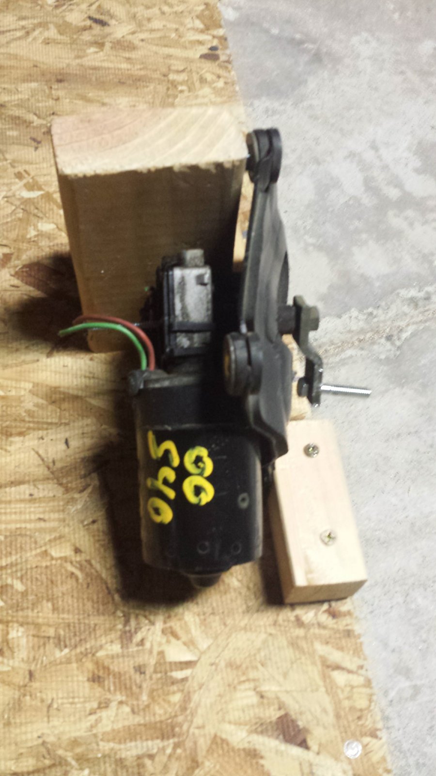

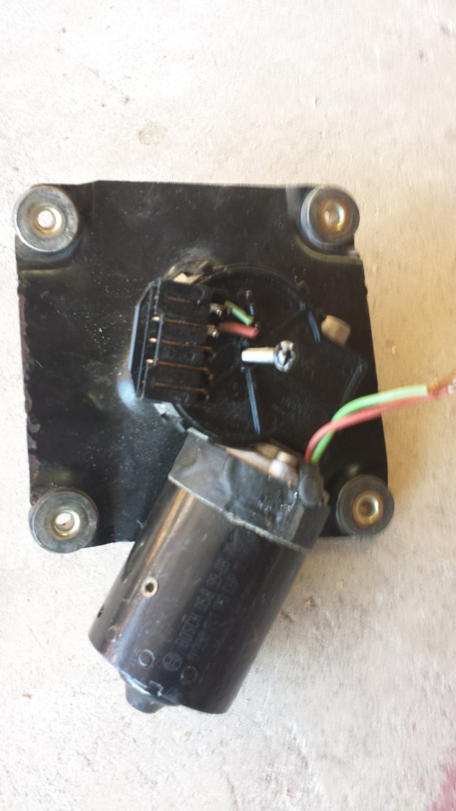

    Next, I prepared the motors for the pot.
    Here is the motor opened
    Close up of the cover
    I drilled a hole in the middle
    I put the cover back on and drilled in the center using a thin metal drill. I drilled maybe 1/2 centimeter, then put a screw in with super glue at the tip.
    It feels secure enough, and when I rotate the arm, it spins freely.
    That's all for today

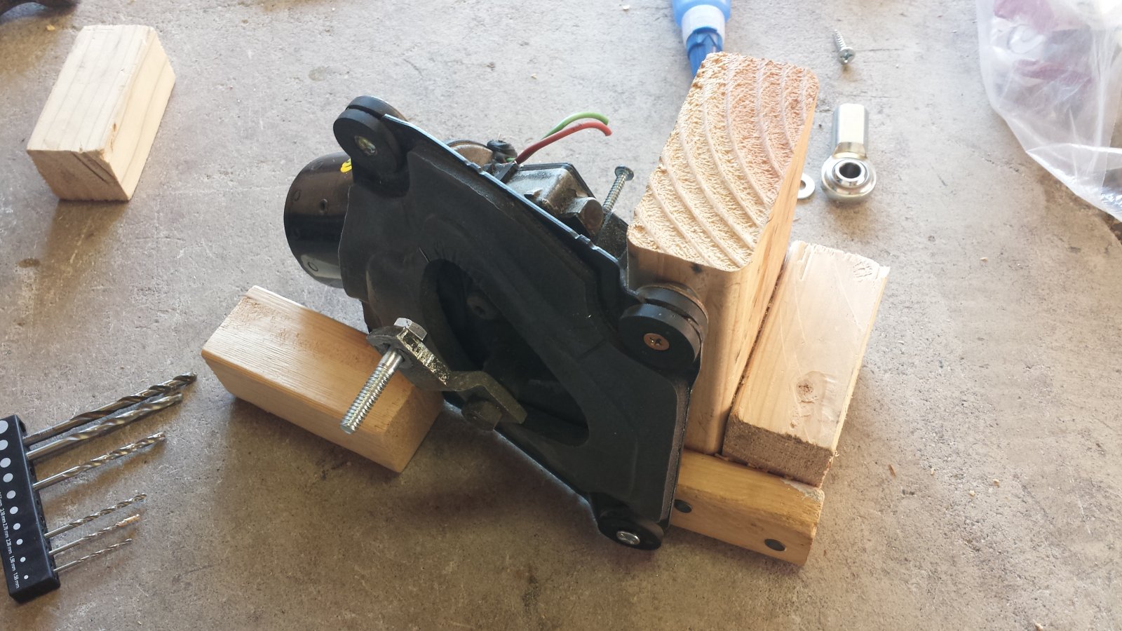

    Next, I attached wooden blocks to the motor to keep it secure.
    Here is one side
    And here is a pic from the other side
    The bottom side of the square metal piece is flush to the ground so that the majority of the weight transfers directly to the platform rather than through the wooden blocks. I thought about buying some metal L bars, but went the cheaper wood route...

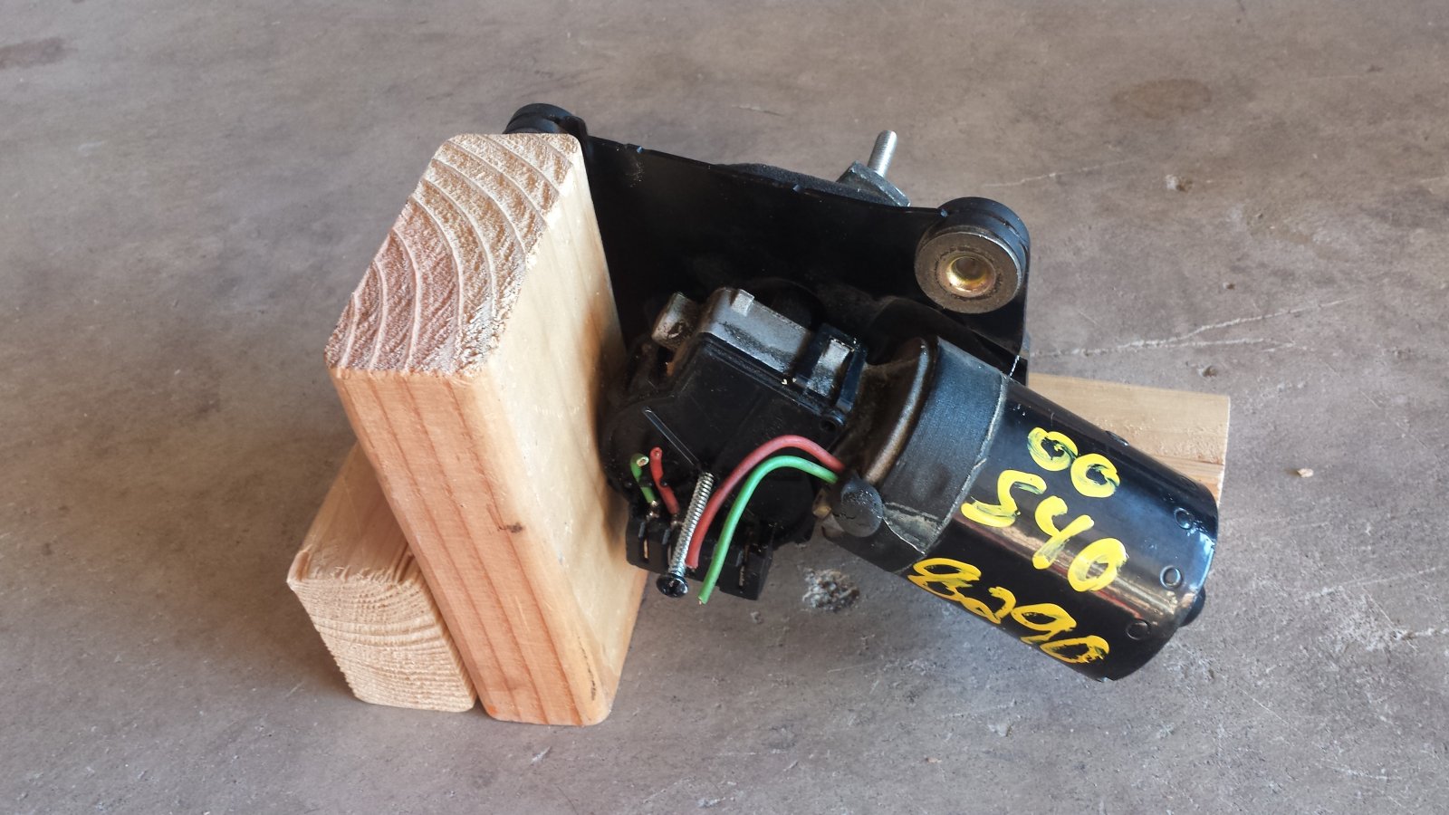

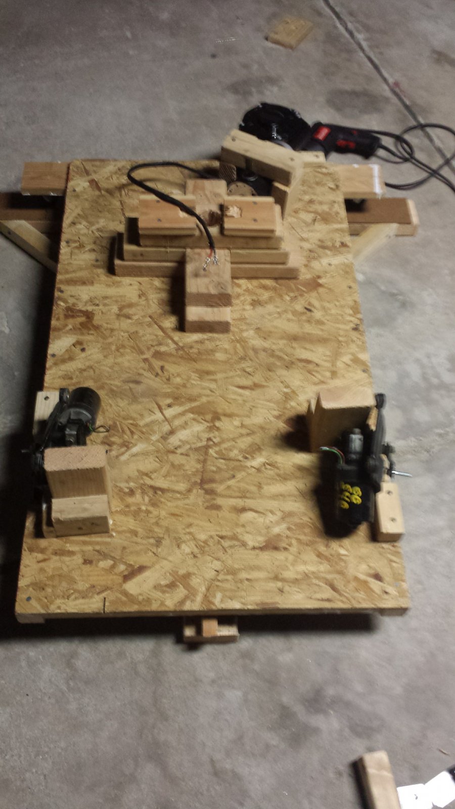

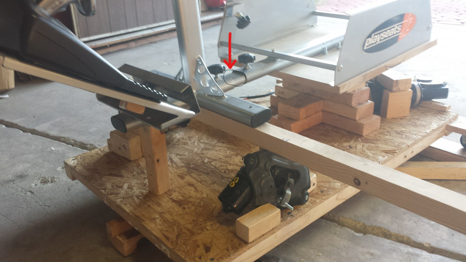

    Next, I mounted the wiper motors to the base platform.
    the little wooden piece is screwed down from the top, but the other bigger block is screwed from the bottom with a long wood-nail
    zoomed out to show all the motors
    the seat is placed on the platform for the final time (I hope)
    that's all for today!

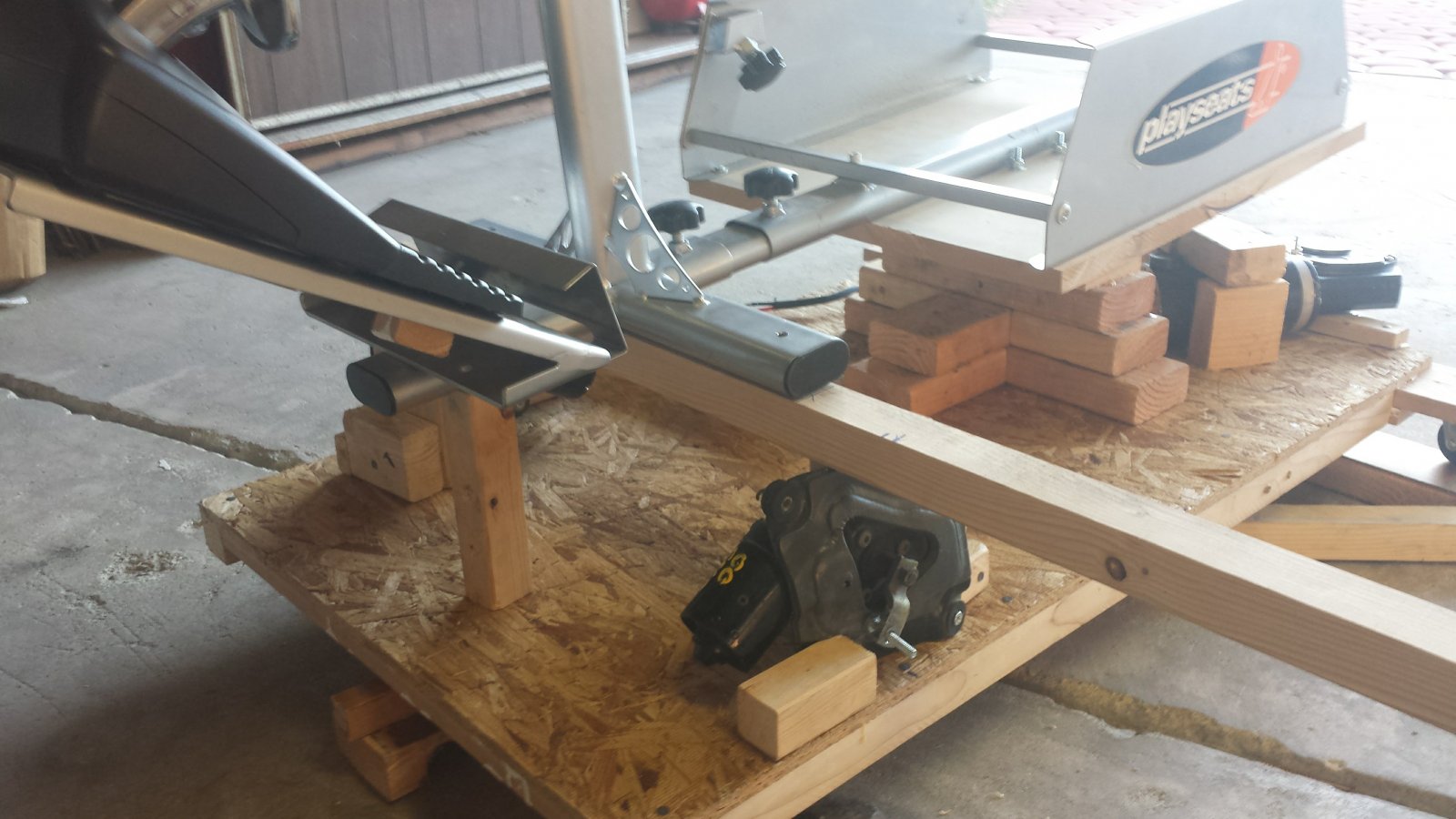

    Here is some more work done
    I put the heim joint on the motor arm
    The heim joint has a 5/8 inch openings, which i thought was thick enough for my application.
    However, since the biggest drill i had was 1/4, i put a 1/4 bolt through the arm and the heim joint, and filled in the gap with JB Weld (I did the same for the traction loss motor arm).
    A little messy, but snug and tight.
    Here is the arm attached to the seat frame

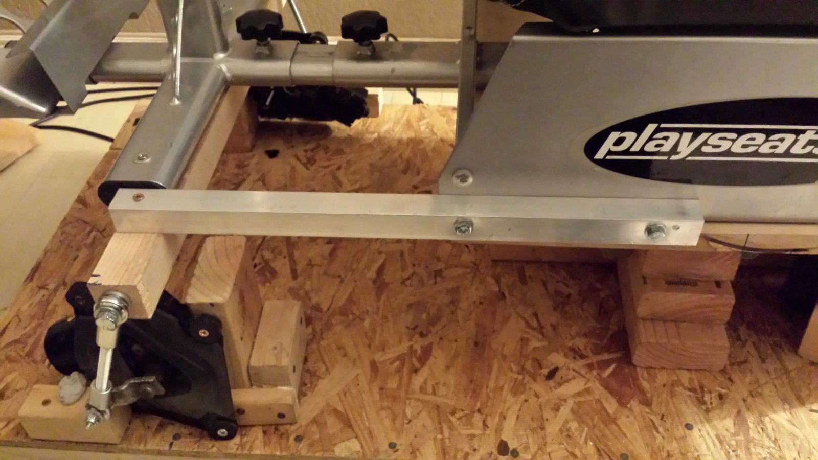

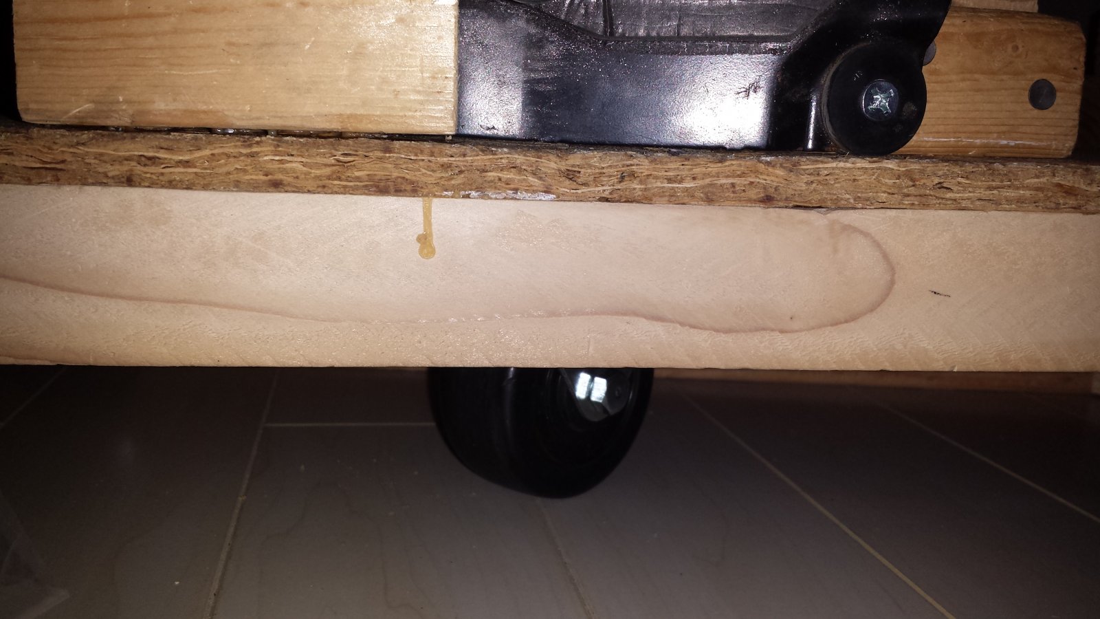

    I ran into a problem when I sat on the chair after -- the chair would wobble vertically about an inch on the left and right side. I noticed that the seat frame would wobble because the frame towards the feet is attached to the seat frame with only a knob (so, it's not a solid one piece). Here is where it wobbles:
    The solution? I think I will put some aluminum metal bars to enforce the frame where the motor arm attaches to it (I thought about moving the wiper motors to the back of the base and attaching it to the back of the seat frame... but there is no space because of the traction loss motor).
    Oh man, I think if I had to do it again, I would put the wiper motors on the back and have them attached to the seat frame itself.
    This mistake sets me back $10 (for the aluminum metal bar).

    Next I installed aluminum support bars
    After I installed the bars, the wobbling from the seat frame stopped. However, I noticed that the base frame would wobble where the wiper motors were. I think this happened because the base was made out of wood, and because the only thing supporting it was the center caster wheel (modified). As a solution, I bought 2 wheels to place under the wiper motors so that the weight would go directly to the floor.
    Once again, I think if I put the wiper motors on the back, I would not have run into this problem (or alternatively, if I went just 2dof and not traction loss).
    Well, since I bought the aluminum bar, and also ordered a seat belt ($5), the price for 2dof has gone up to $204.
    Also, since I had to buy the extra wheels ($7) for traction loss, my spending for traction loss is now $97.
    I hope I don't have to spend any more $$

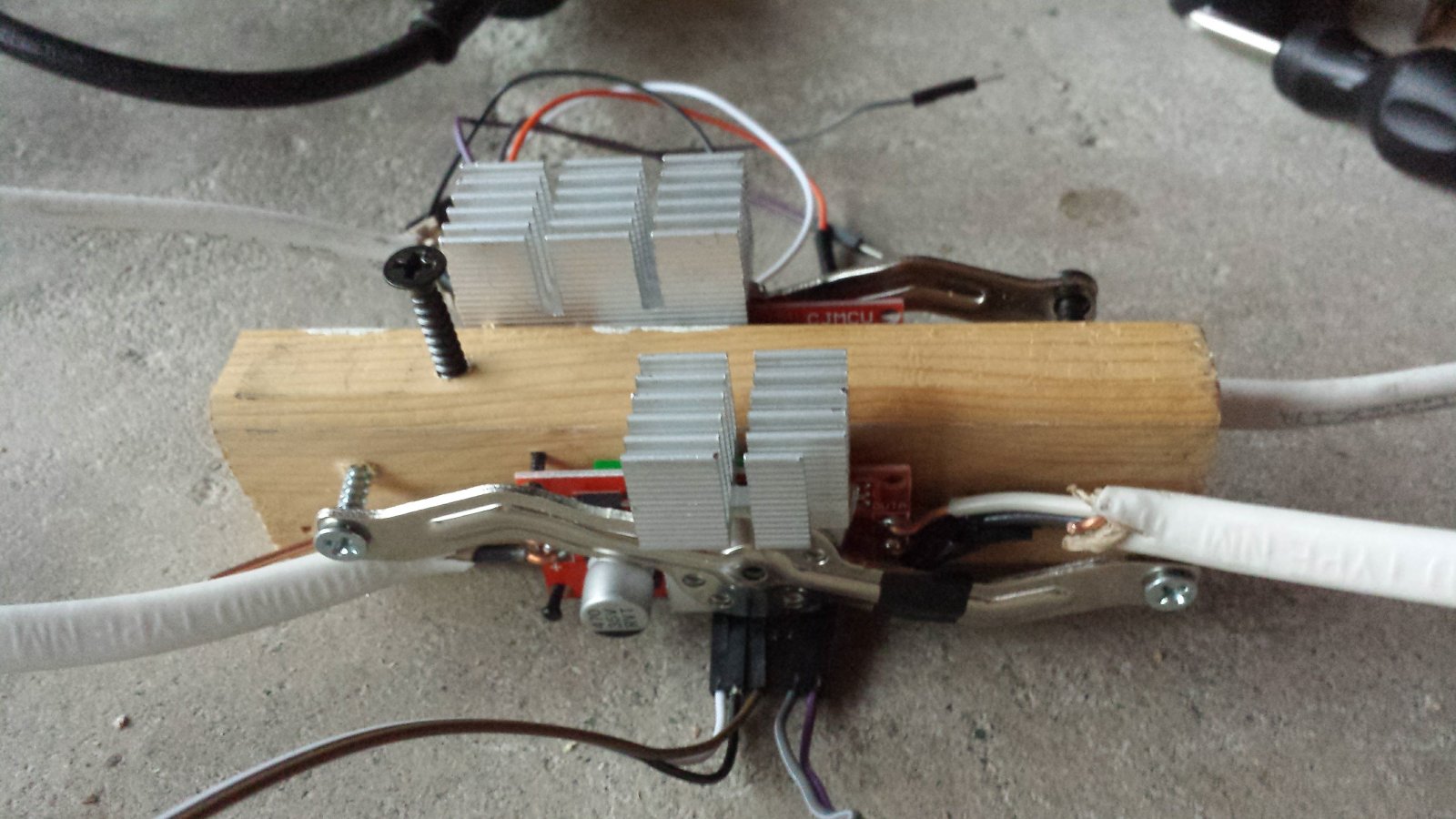

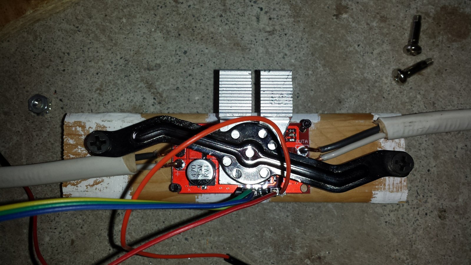

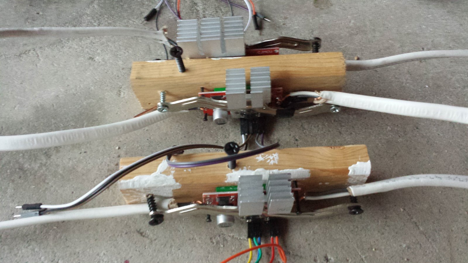

    next, i attached heatsinks to moto-monster boards.
    i thought about buying the heatsinks and either use double sided thermal tape, or buy heatsinks with thermal tape on them, but looking online, they would cost at least $8.
    since i am $1 over the total budget, i opted to go the "free" route and took apart a broken PSU, took out the PSU heatsink, and sawed it down to 3 pieces.
    i had to position the moto-monster vertically since the heatsink is vertical.
    this is a sandwich of wood, lego, moto-monter board, thermal paste (which i already had), heatsink, and CPU heatsink holder.
    this took me a while to put together, but it feels secure, and the heatsink is bigger than what i could find for cheap online.
    here are the other 2 moto-monster boards
    the one with the larger heatsink is the moto-monster board that will control the wheelchair motor.
    here they are in 1 pic
    this will be placed under the top case of the PSU that holds the fan. good thing i kept the broken PSU instead of throwing it away!
    it's a Frankenstein, but i need to test it to see if it is alive :)
    next is wiring.

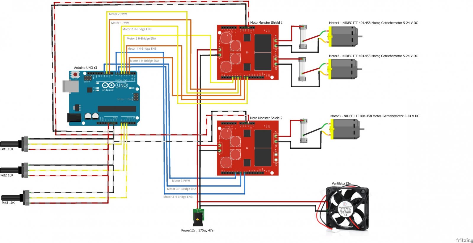

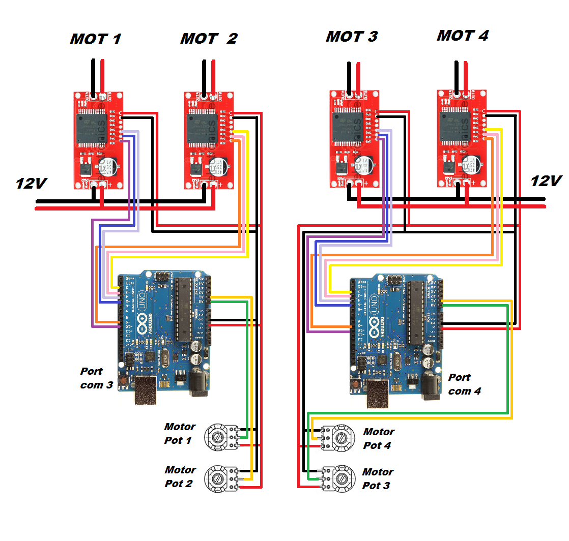

    i'm looking at the wiring, and it looks like i can combine these 2 wiring diagrams for my 3 half moto-boards and 1 arduino
    upon closer inspection, the wires are placed in differently between the 2 diagrams... i'm assuming that the wiring doesn't need to be exact?
    ok, now i'm going into the "unknown" territory of electronics and programming.
    there is a reason why i put this part off until now -- i just don't know what to do, and i'm feeling my way in the dark.
    for example, i have 3 motors... is there arduino code for 3 motors? i found one for 3dof, but mine is 2dof + traction loss. does it make any difference for arduino since simtools will control the motors? if i need to get the code for 2dof + traction loss specifically, where would i find it? or would i have to learn coding for arduino?
    help would be greatly appreciated!

    Wow, what a quick response! Thank you mucho for pointing me in the right direction -- i will check it out tonight and see how far i can get on my own :)
  15. llluis
    Mar 30, 2017
    164
    Quebec
    1,630Coins
    +103 / 1 / -0
    All the info you need is in the first page. Keep us posted.
    Your connection will be very similar to your first image, just pay attention to the right wires at the arduino.
