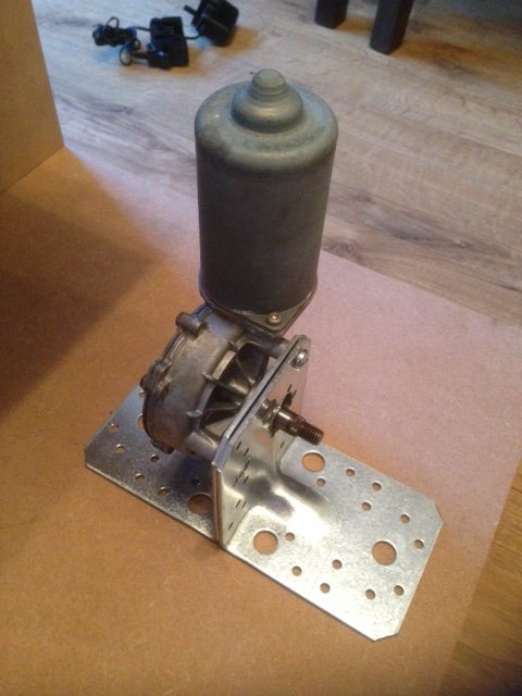

    Congrats on the purchase of SimuKit, its a great introduction to Sim building.
    A few words of advice, I found B&Q to be hit and miss with stock for M10 bolts and nuts, so just get them from screwfix.
    The 2inch x 3mm mild steel bar is in B&Q
    Also, the threaded rod bin is always hit and miss, I got mine off of ebay, very cheap and quick delivery. You can order sizes very close to what you need, so no need for hacksawing.
    If you can find a bracket to attach the pot gear to the motor, it will move with the motor if the brackets flex too much.
    I decided to get a local garage to weld me a brace to stop the gears slipping. They would only slip if the profile was at 90%+, but still. Now I can run it at 100% no problem.
    Also, in @Wanegain's original build, the vertical panels were too high. I reduced the height to 17cm, and adjusted the other measurements accordingly.
    Decide what you want your seat height to be, then calculate the difference, with the 18mm MDF, the 8.5cm U-Joint.
    You will need to use battening on the bottom of the MDF to give it support and raise the bolts off the deck.
    But with good planning, and all the kit ready, you can have it built in a day.

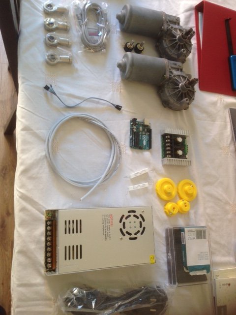

    6 Parcels arrived so far, a few more to come and then time to get building!

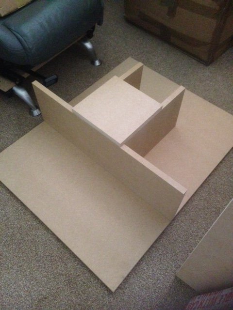

    Made a start laying out and measuring, can't wait for the motors to arrive!

    Good start! Gutted it didn't arrive in time for the weekend.
    Are you making a full-frame or seat mover?
    If you are making a seat mover you can follow Wanegain's tutorial measurements.
    If you're making a full frame, I found the centre of gravity needed to be further forward, I needed to shift the u-joint mount about 15cm forward, but you can only calculate that once you have your rig and find the COG.
    Though, you could mount the seat on car seat sliders so you can adjust later, if you add the pedals and wheel at a later stage. But I have heard thats harder to get accurate.

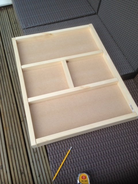

    Bit more work while waiting for the postman :thumbs

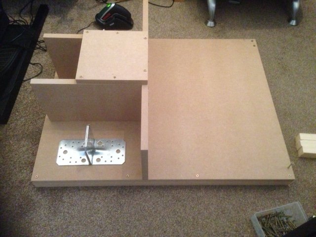

    The plan is that the seat shaker will be a test of my getting it working skills so I will just raise the pedals etc. for that stage. If all works ok then I will build something for the pedals. I have built the base to plan for now...

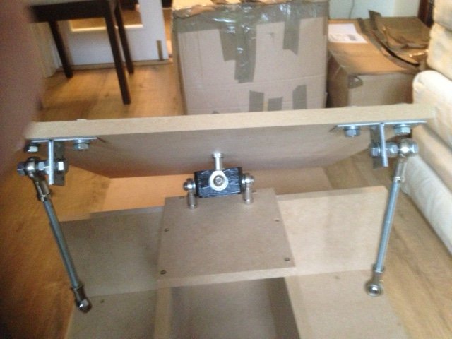

    Everything has now arrived ready for the final build :thumbs

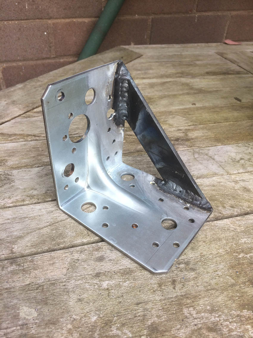

    Bit by bit, need to buy some steel plate tomorrow to mount the joint properly.
  20. Paul Shortland
    Paul Shortland Active Member
    May 13, 2015
    154
    Northampton - UK
    317Coins
    +77 / 1 / -0
    2DOF, AC motor
    First motor mount completed, going for the back to back bracket version to increase rigidity. So much drilling and filing :eek:
