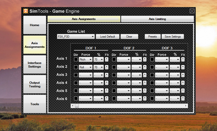

    It does work that way, when I manually move the slider, it does go to it's min and max BUT when in the game(FSX) it will not and I maxed all my settings in the game and profile??

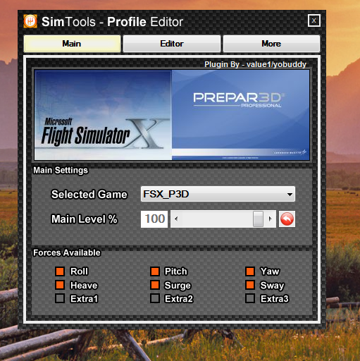

    Can you post pictures of your FSX profile settings.

  12. insanegr
    insanegr !N$@n€
    Jan 14, 2014
    504
    Athens
    16,721Coins
    +499 / 1 / -0
    @terry wells if you have one motor for pitch and one motor for roll your profile is correct but if you are using two motors for pitch and roll then you have to do what @noorbeast told you

    @terry wells if you put 100% instead of 70% in your profile do you have the desired motion?

    Well here is what I did. I went into my tuning center and manually changed the force numbers in pitch and roll, they were 180 and -180, I changed them to 50 and -50 and all worked well. Both the pitch and roll went to it's min's and max's. Do you think the numbers are ok or do I need to change them somewhat?
    terry.
  16. noorbeast
    21,498
    150,608Coins
    +11,017 / 55 / -2
    That is exactly what the tuning center is for, so if it feels right then you just about have it nailed and can work on some of the other forces. Just do them one by one until they feel right, then check together.

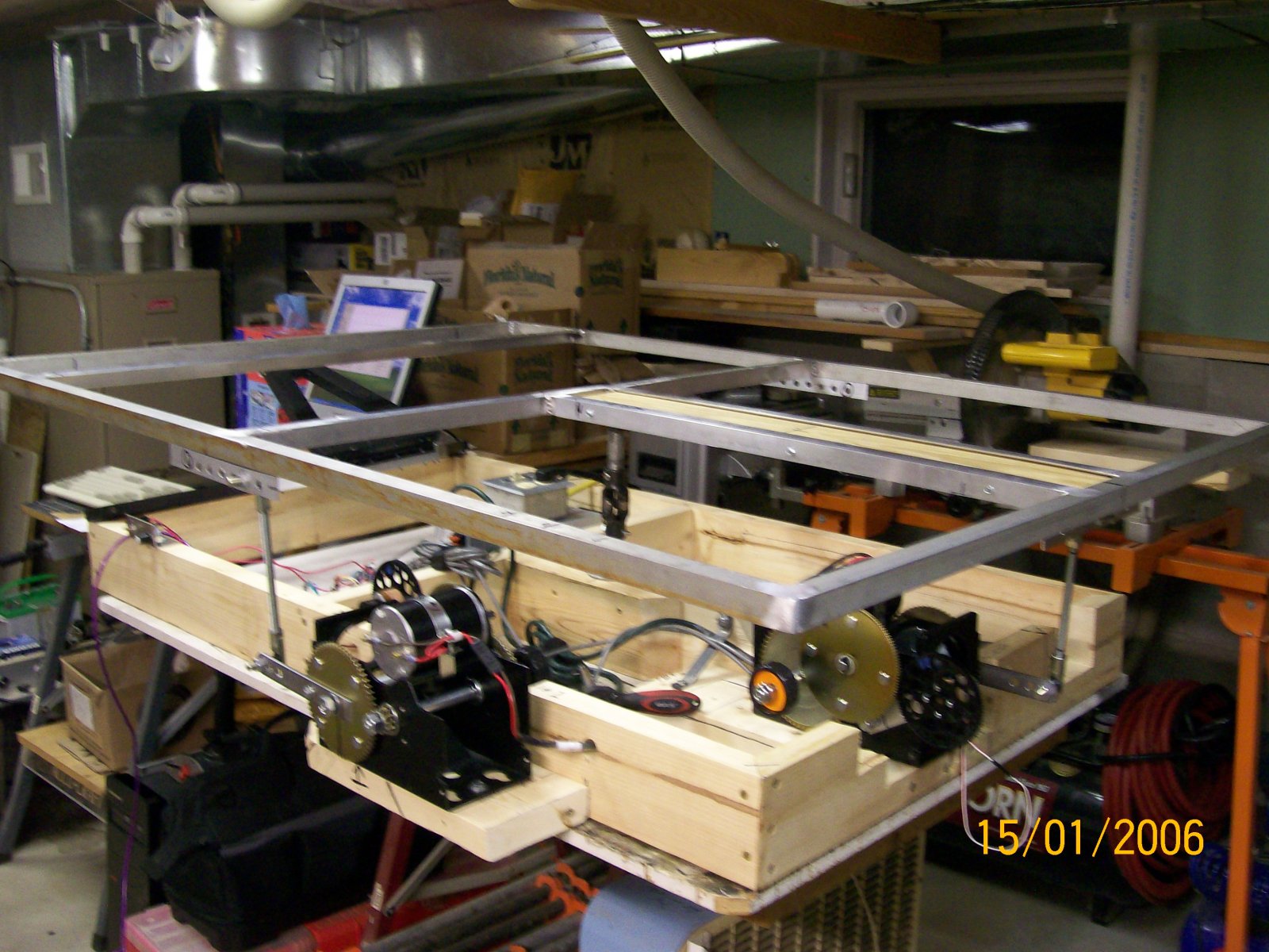

    Well, bad news for me, went to get onto my motion platform and the break was not set so I screw up the pot control on one motor. Question? when is the break set to "ON" so one knows when he can step onto or off of the platform??? and If I were using "Continuous Turn Pot's would I have had this problem with going to far?? Do continuous pot's come in 10k or so??
