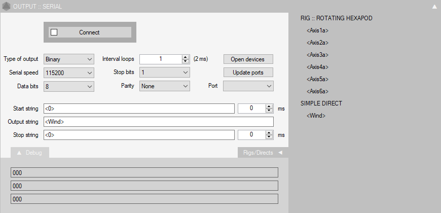

    So, here's some code to control the fans with the Arduino.
    Needs to be adapted to your controller.
    That's what @SilentChill is using.

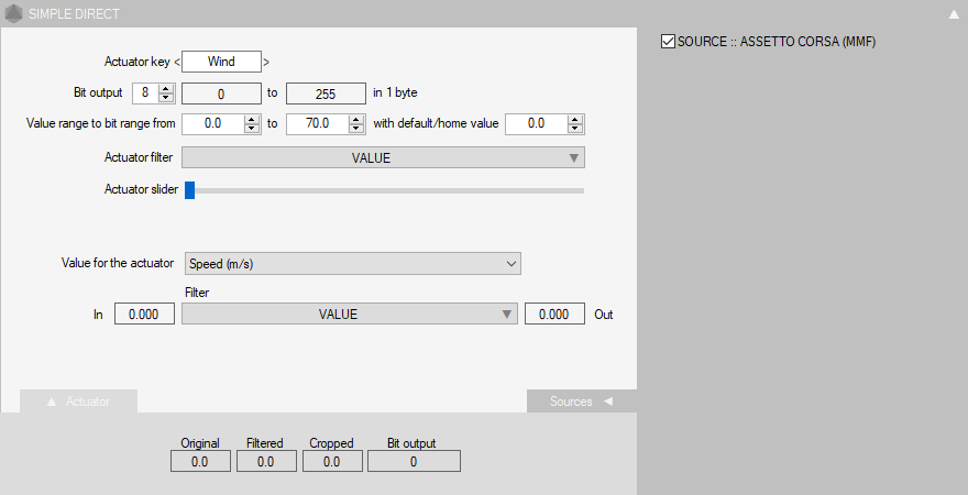

    The code expects 8 bit values, so use the following simple direct module:
    We are mapping 0 m/s to bit value 0
    70 m/s (+-250 km/h) to bit value 255 (the maximum speed)
    Any speed above 70 m/s will always output bit 255.
    I'm using Speed as the value. But in DCS for example, we have the wind value also.
    The wind value in DCS looks for the amount of the cockpit open and calculates the amount of wind from that.
    So not all values are available.
    Add a serial output with:
    Select the correct port

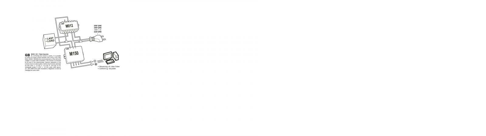

    Thanks @pmvcda and @SilentChill, I have 2 Fans 120 v AC and with modules M012 and M150 , works perfectly!!

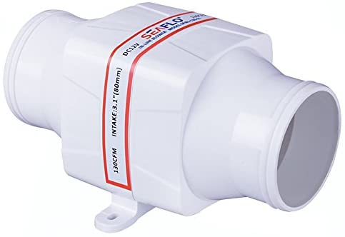

    @C1500 I use two Seaflo bilge fans. 12V, high volume. Connected to a 12v LED power supply.

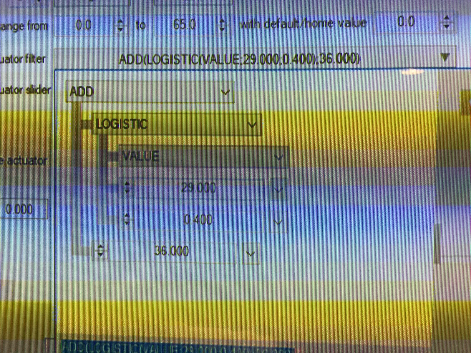

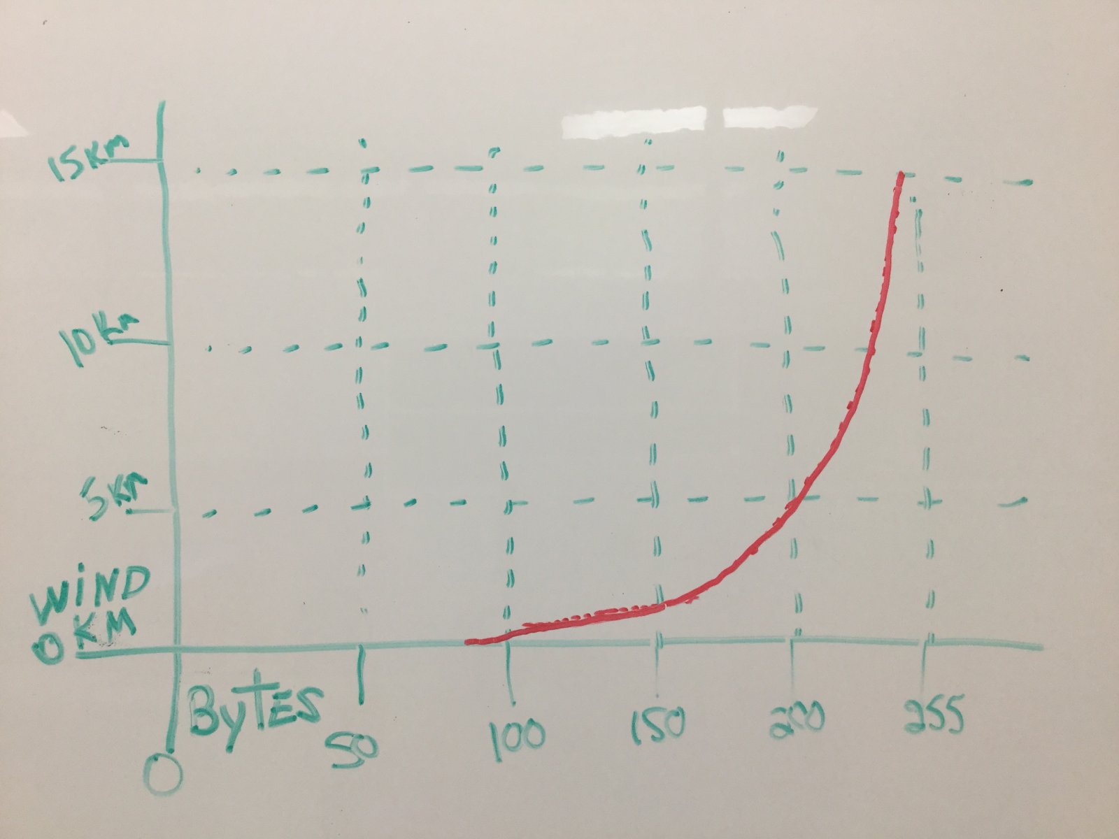

    Hi, @pmvcda
    I give you a exemple ( shema) of my situation with my wind simulater .
    To 0- 150 bytes I have no wind but over 150 to 255 you can see its progressif curve !
    Q- How I can fitre this curve to have a strait line ( constant line ) and more stretched ?

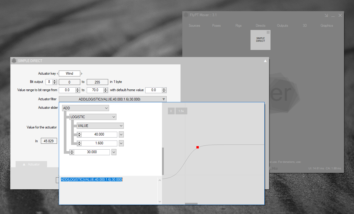

    OK, I said cubic, but I meant logistic.
    I just edited the above post.
    We should act in the bit output, not in the speed value, because the problem you have is at hardware level.
    But we can't do that, so we have to act in the range of values we are using (would be good to do the correction at hardware level, in the code of the controller).
    So I'm using an 8 bit output here (0 to 255).
    And a maximum speed of 70 m/s (around 250 km/h).
    So, I'm mapping the 0 to 70 speed to the 0 to 255 bits.
    But has you said, there's a deadzone under around bit value of 100.
    So I add 30 m/s (around bit value 108 without filter) to the received value.
    So now we have value 30 m/s up to 70 m/s we want to transform with a logistic to compensate the curve you have.
    So we make a logistic with maximum value of 40 (40+30=70).
    The 1.6 is the "gain" of the logistic and in your case, to compensate the curve it should be above 1.0.
    Now, if you look at the input/output graph, you can see that at speed zero, the output is 30 and above it, it increases on the logistic curve up to 70. All this is remapped to bits 0 to 255.
    For now, this is what you can do in Mover.
    I can add a logarithm filter, (i have it done but not exposed) that might make it easier, but I also consider an editable curve for the future (but not soon).
    Also note that the actuator filter, acts over the value and not the bit value!
    I already considered the possibility to change it, but might cause more confusion, although in this module it seems the more correct to do, in linear actuators, it makes more sense to use real measures.
  19. Flymen
    May 19, 2018
    336
    Montreal, Canada
    2,425Coins
    +191 / 2 / -0
    DC motor, 6DOF
    Thanks a lot again !! You make my day !!hug:
    Fast and full instructions !!
    You are my Tony Stark ( Ironman)/ simulator. :grin
    My set up is :
