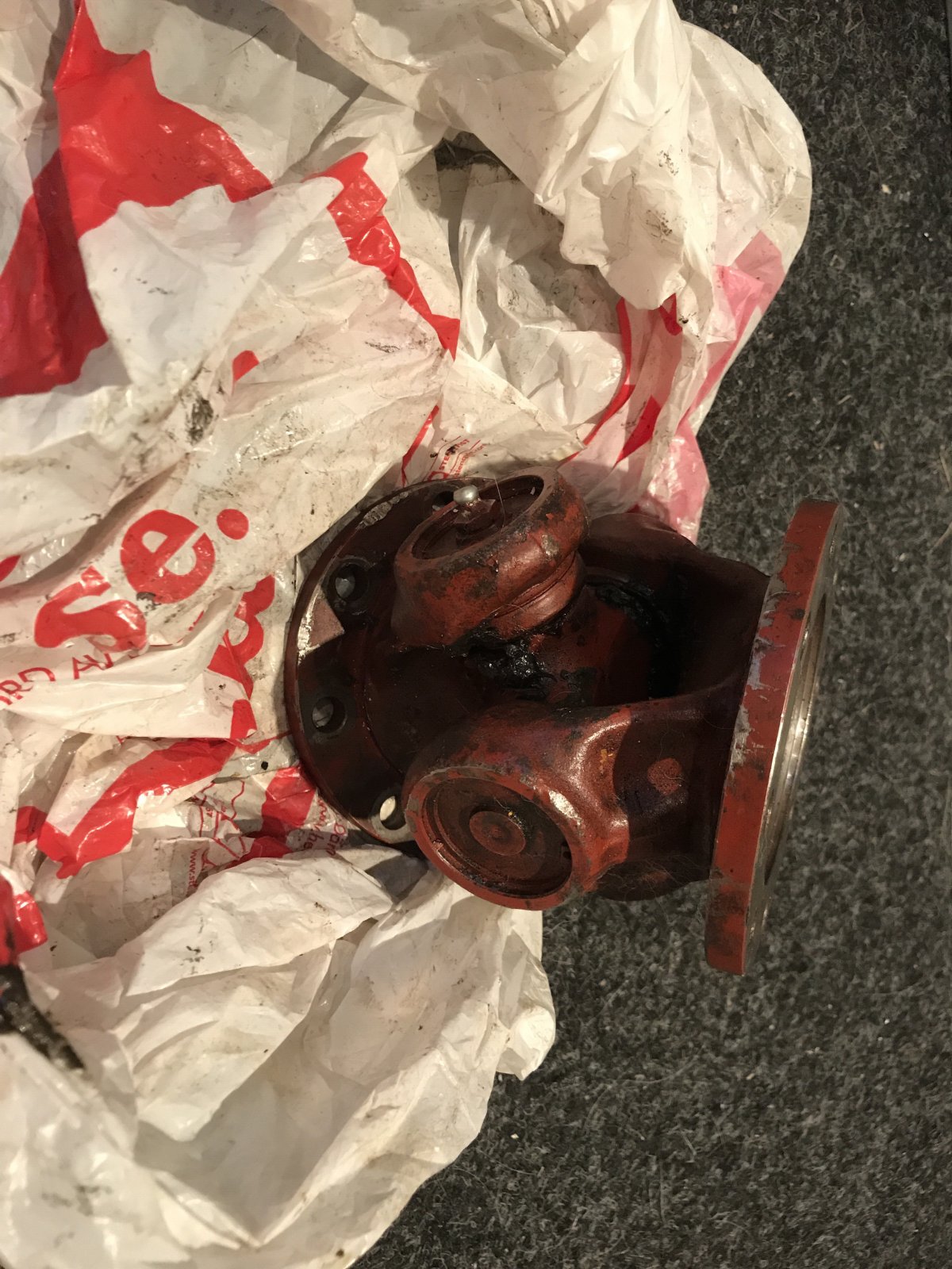

    I need help and ideas what to use under the chair on a motion rig. I have this as on the picture. The problem is it’s to high. I need something that is like that but as low as possible.

    You wont find a much shorter/smaller U joint than what you already have, maybe slightly shorter But why not modify the frame to suite the parts you have ?

    It’s too late. I then must rebuild everything. I want to lower the seat position. No room. That I have is for a tractor so it must be something smaller I hope.

    Google "Flange U Joint" These style's are going to be the Shortest/Most compact/Durable joints your going to find.

    It looks like that's what he has now. Mine is 3¼" tall and is the shortest I could find.

    3¼ tall is way lower than what I got. That would work perfect.

    Smaller I think you will not find, to reform the chassis would be a lot of work

    I got this

    It looks pretty solid, I think it would work fine
