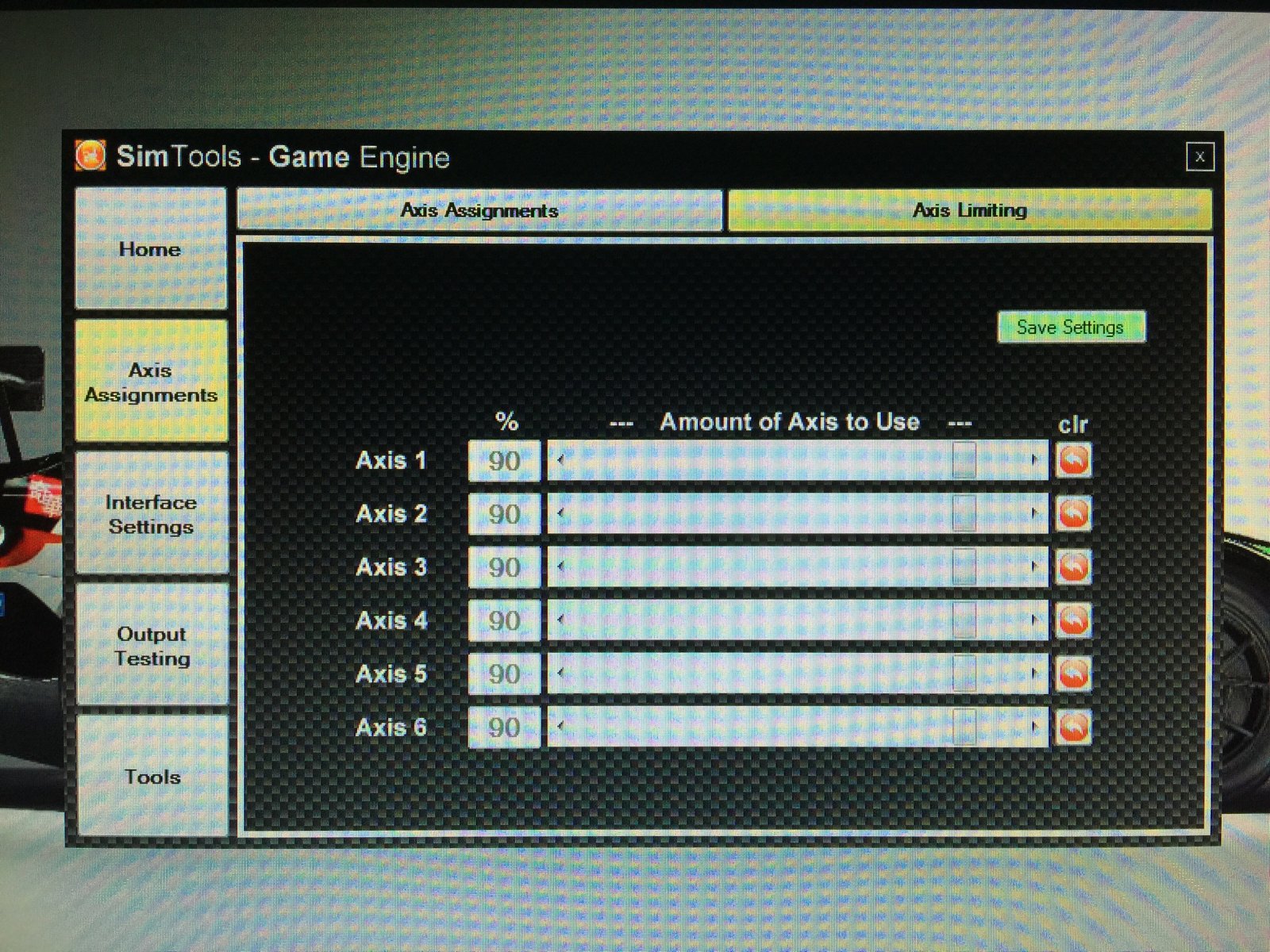

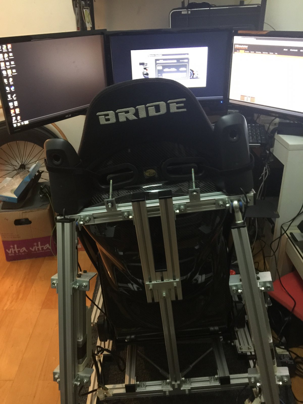

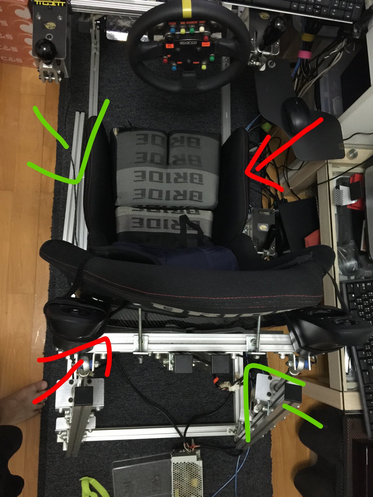

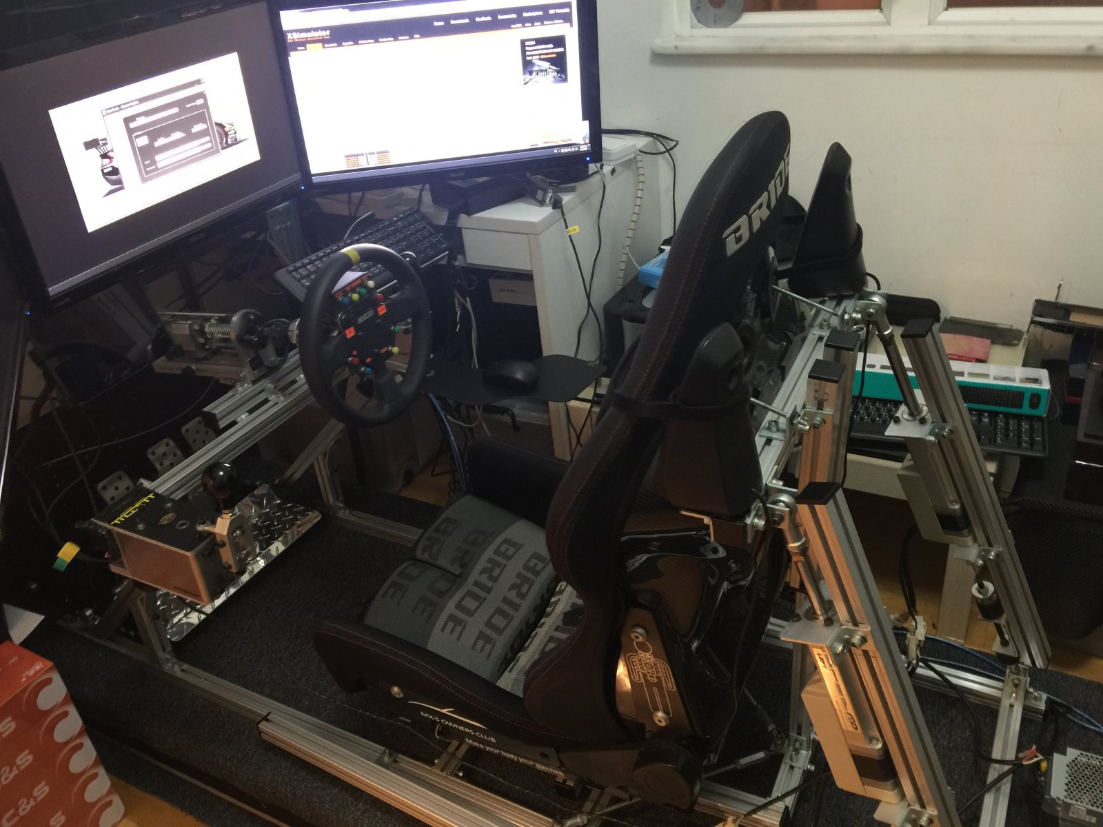

    Dear experts,
    I'm so sorry by asking and asking again. Finally in sin tools in test the motion (my Frex motion) moves. Also feel a bit shaking in game in assetto Corsa. But below show the photo the angle of my chair is on a side. I had follow totally the instruction I dunno where went wrong.
    Hope someone can help me on this.
    Thanks in advance
    21,518
    150,728Coins
    +11,018 / 55 / -2

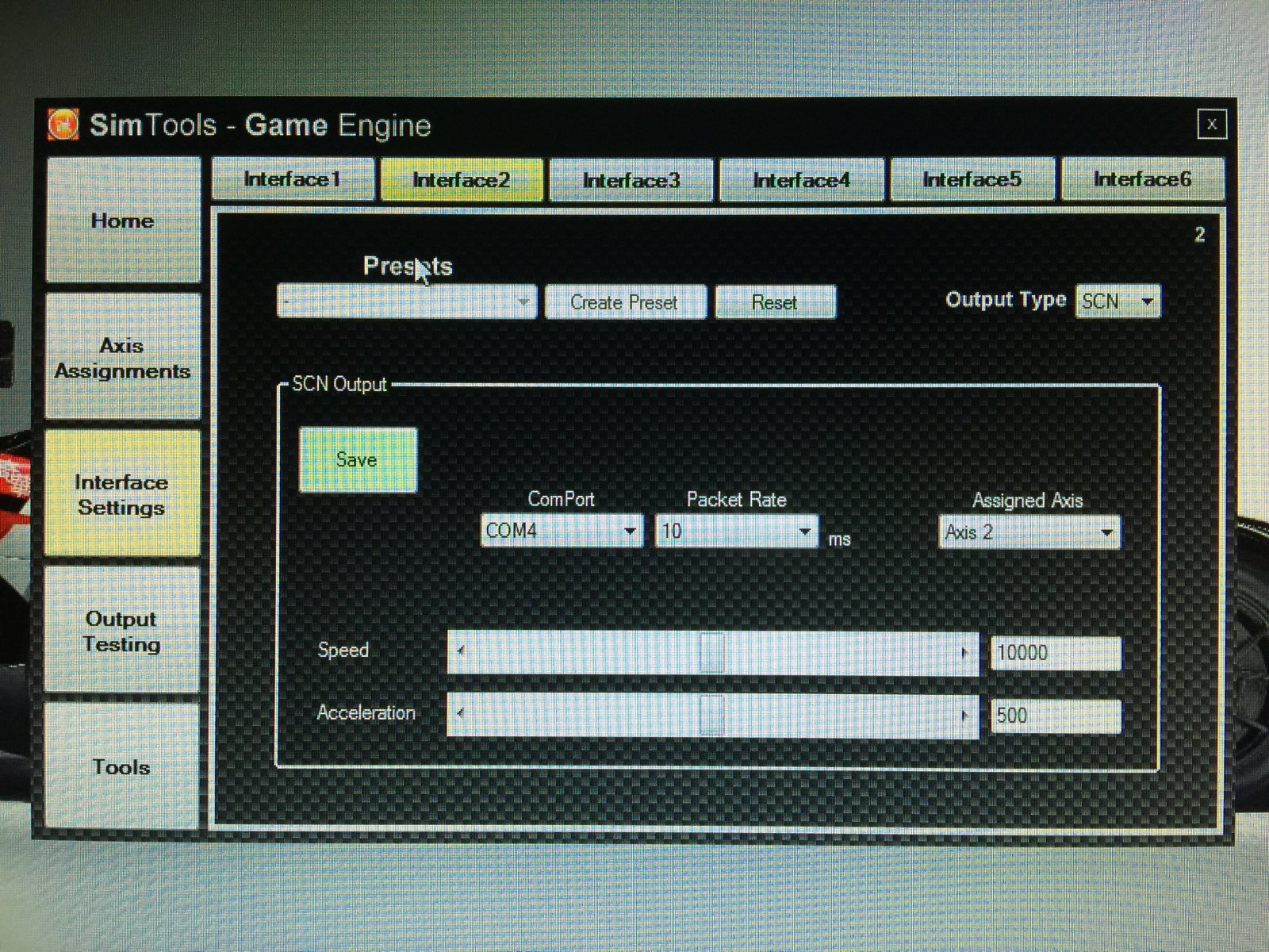

    Can I clarify if the actuators move correctly when using the Output sliders for testing in the SimTools Game Engine?
    Can you please post screenshots of your settings.

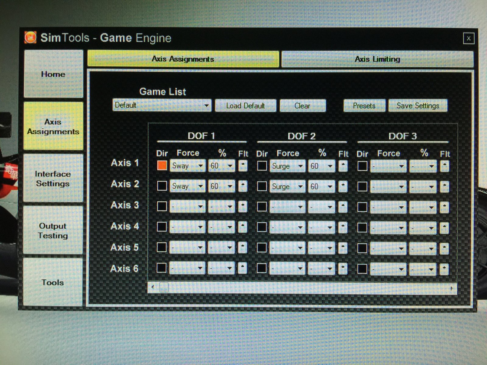

    im not sure if I copy the correct file for you guys to see. Many thanks for your helps.
  4. Kool7789
    Kool7789 Member
    Jul 4, 2015
    37
    Macau
    258Coins
    SCN5, SCN6
    image.jpg image.jpg I need to make it separately. I got nothing set in interface 3 and so on.

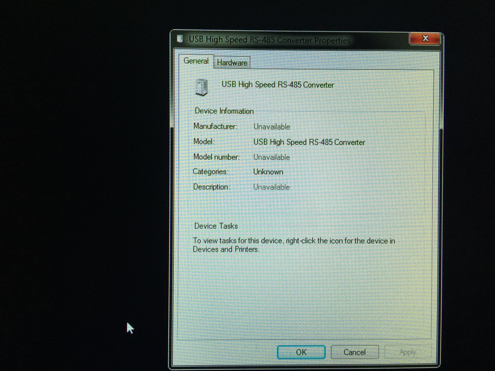

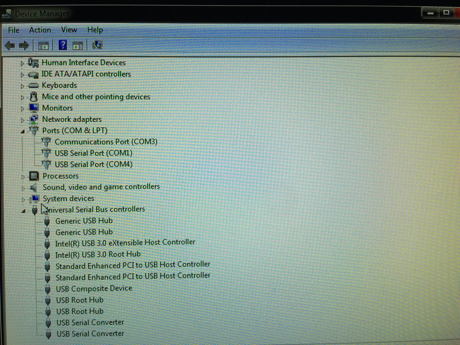

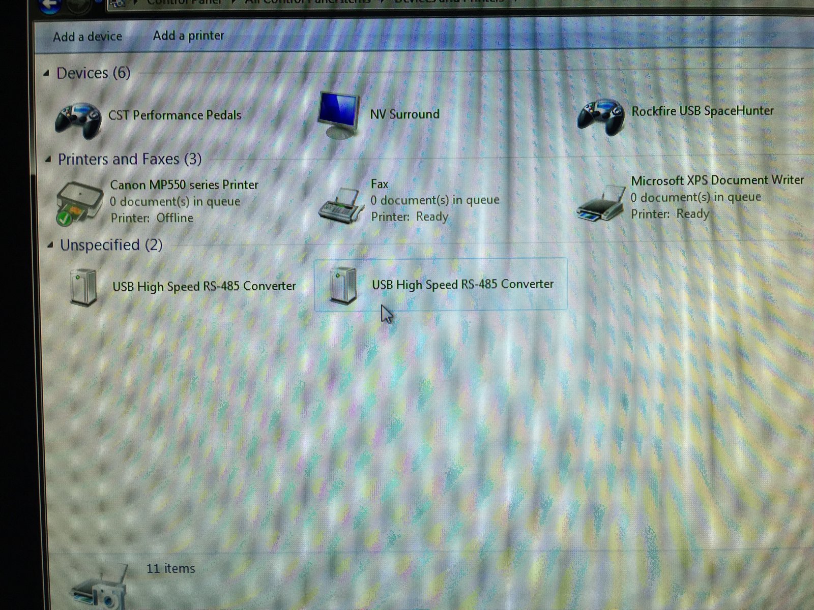

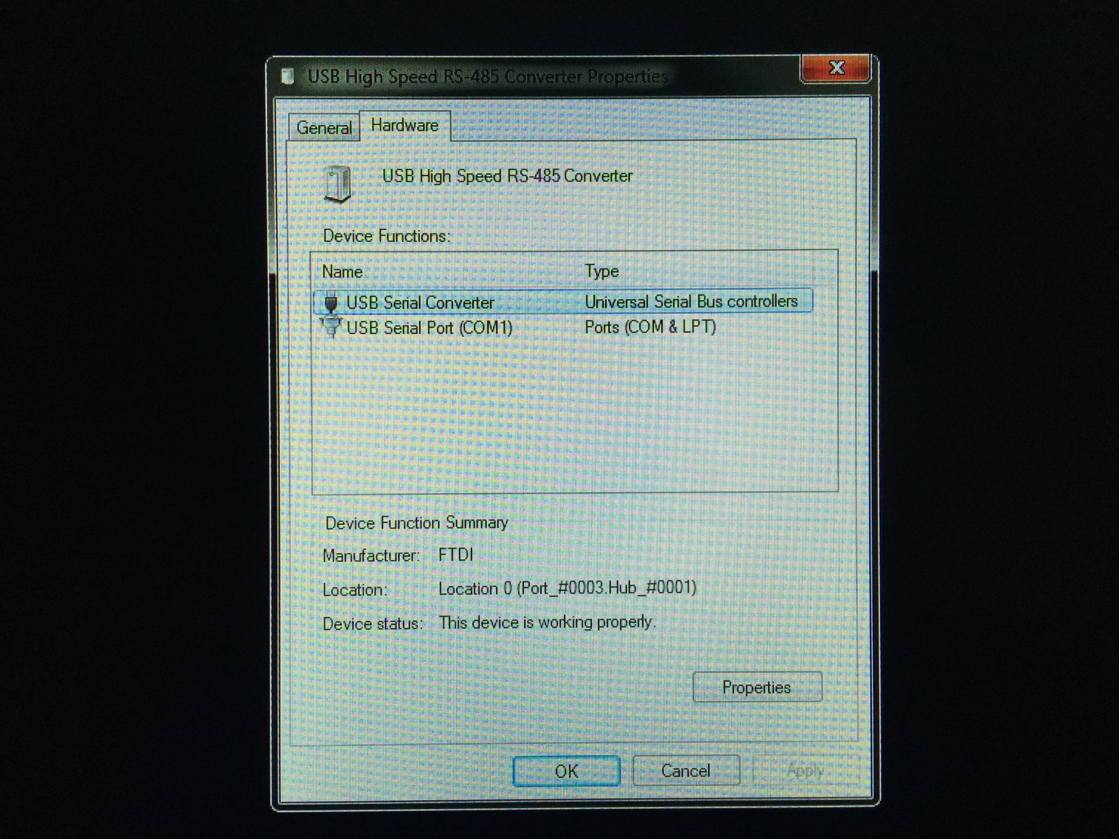

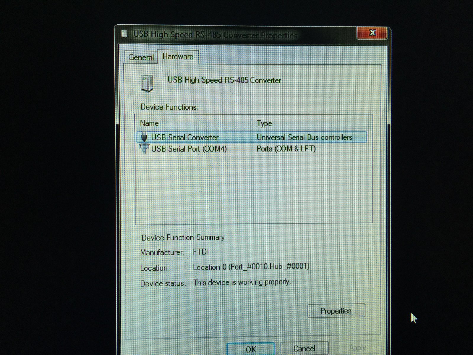

    Also include my pc some Datas
  6. Kool7789
    Kool7789 Member
    Jul 4, 2015
    37
    Macau
    258Coins
    SCN5, SCN6
    image.jpg image.jpg image.jpg image.jpg image.jpg image.jpg image.jpg image.jpg image.jpg
    Anything I miss?

    Normally when it start (in Straight back) I switch on the electricity the chair will move like the attached photo. Red to red arrow front and back and lean on a side after or Greeb to Green arrow. It seems depending the mood on which way.

    I did ask earlier if the actuators move correctly when using the Output sliders for testing in the SimTools Game Engine?

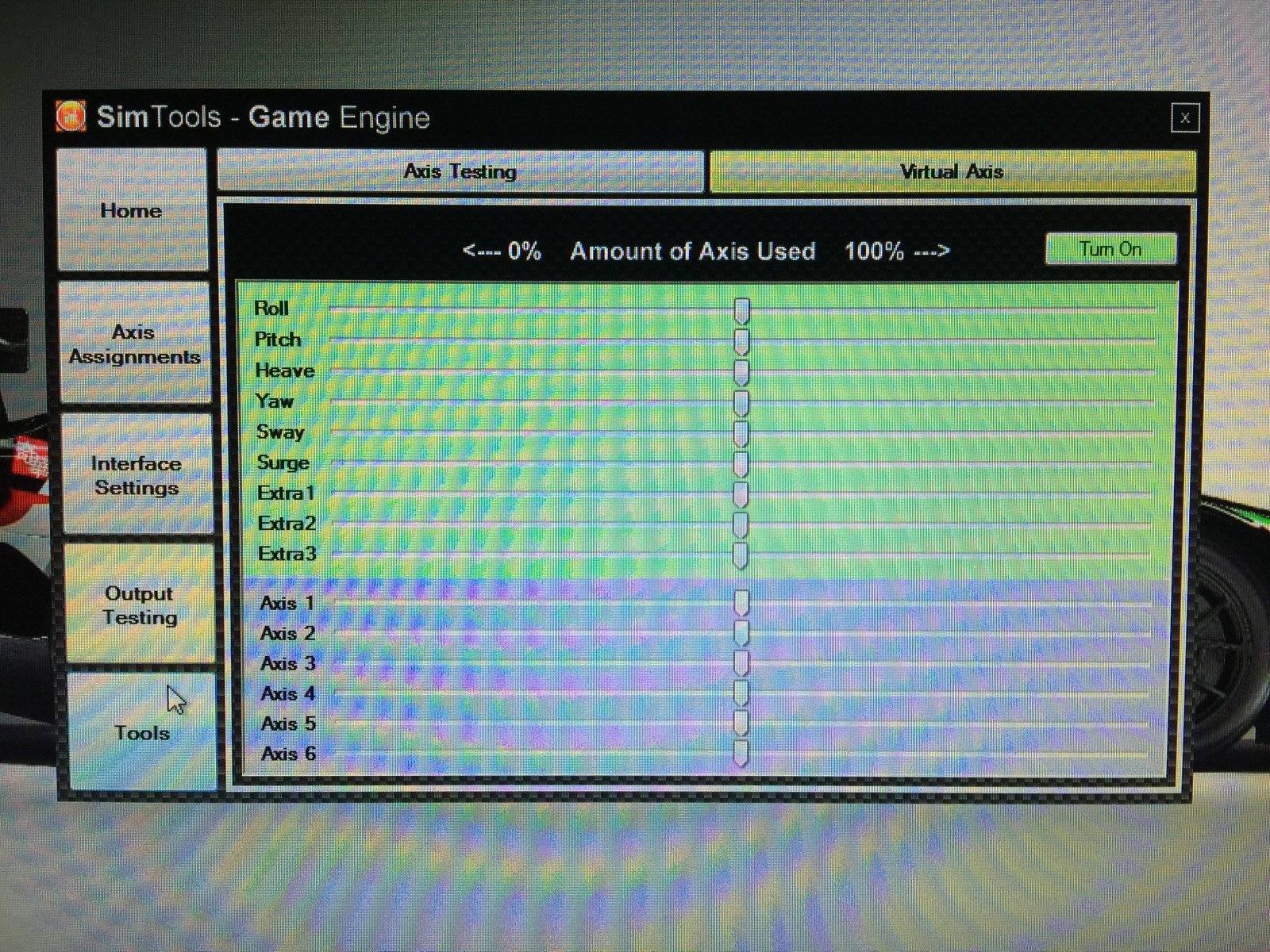

    i don't think so it moves correctly. Coz is not moving straight. And seems only one actuator is moving.
    once connect to game engine it moves one Conner side and to the other Conner side then stop like the first picture that i post it, instead moving forward and backward I think it should be.
  11. Kool7789
    Kool7789 Member
    Jul 4, 2015
    37
    Macau
    258Coins
    SCN5, SCN6
    At the engine the below two columns (last two columns, seems is Yaw and another) slider it moves but just Conner to Conner and one way.
    It means my left back moves to forward right. And when I put it yaw a 100% and the other -100% the chair will be straight in that testing.
  12. noorbeast
    21,518
    150,728Coins
    +11,018 / 55 / -2
    So have I got it correct that only one actuator moves?
    It will likely be easier if you just post a video that shows the rig and screen at the same time, rather than trying to explain it.

    does one actuator only move? Did you check your wiring again or swap actuators not the power supply and the rs485?? Are you using one power supply per actuator?

    Yes I'm using the power supply by actuator.

    I just cut off the line of Simcon Motion and plug it into RS485.
