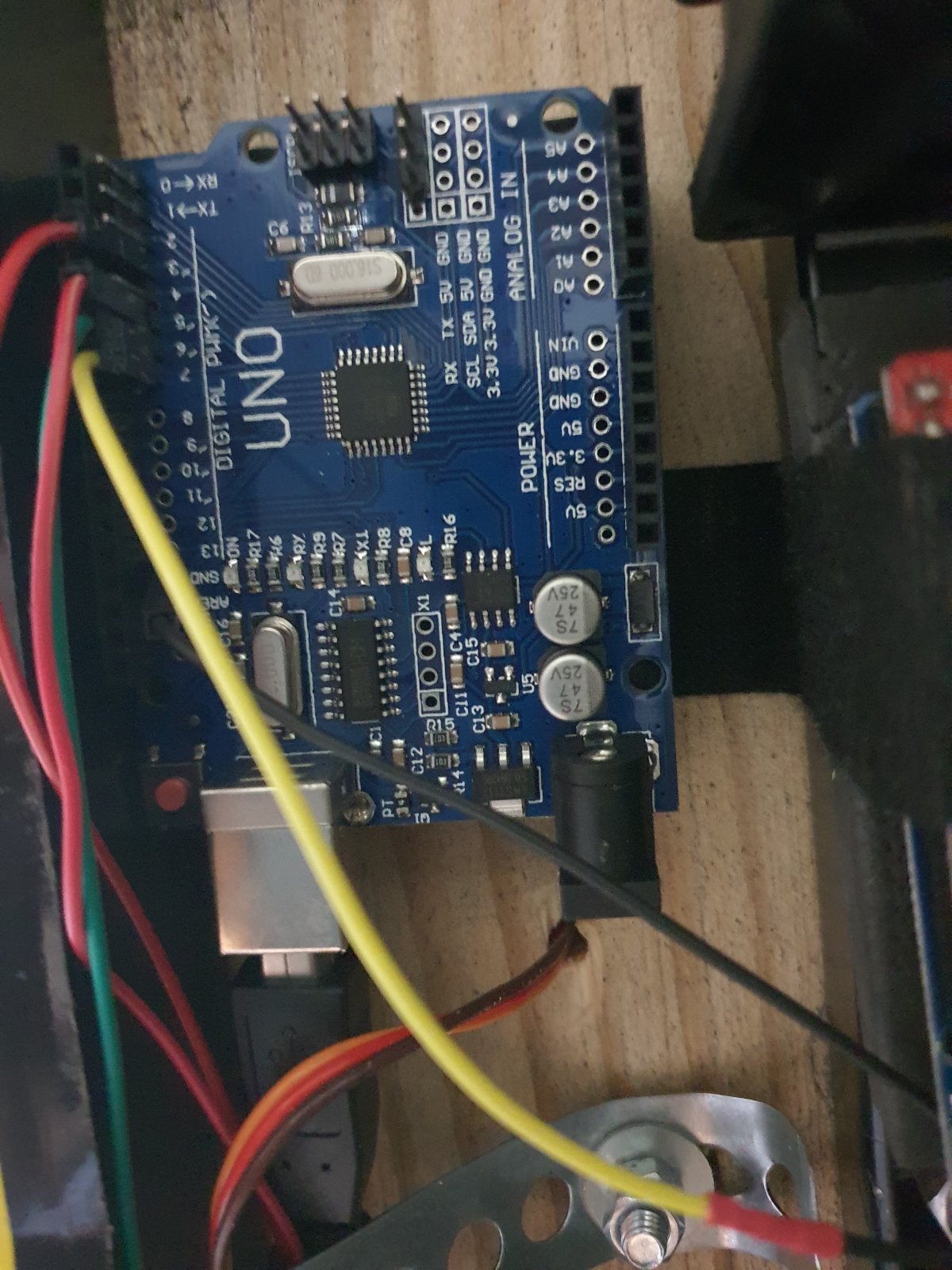

    I have three buttkickers, five arduinos, my DD controller installed on my 4dof platform for almost 2 years and I never had any problems.

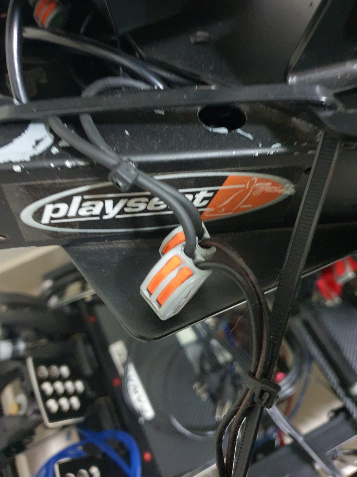

    @EduardoMoreira are you using jumper or did you solder your wires?
    would you mind sharing a picture of your electronic?
  4. EduardoMoreira
    EduardoMoreira Member
    Jul 5, 2016
    31
    113Coins
    +20 / 1 / -0
    I use jumpers on arduinos and connectors on blowers and vibration motors.

    I have placed all my electronic on a foam pad with velcro for additional damping and I always hot glue the pins on the ardunio. I also use clip on connectors in between the pots for easy disassembly
