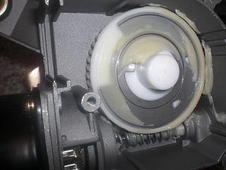

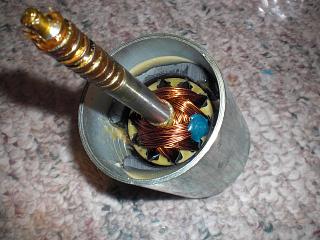

    Thanks, I actually hacked apart a Window motor (Window Lift Motor), and it does have a wormgear! :D
    But will it be enough? I'm not sure, it came off a Ford truck, so it's a big window.
    And here is a shot of the internal wormgear setup
    I'm hoping these will work, any thoughts? :yes:

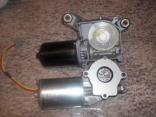

    I have included pics of the Window Lift motor (lower) with the Wiper Motor (upper)
    Both motor are about 19cm long overall.
    And you can see on the inside, it is the same wormgear setup, but the big gear is larger on the wiper motor than it is on the window lift motor. How will that affect performance?
    I will need the motors to move about 150 kg total. I would have no idea where to find the performance specs on them... :(

    The size of the big wheel affect the gear rotation. Big wheel - slower but stronger! My guess is that none of them can lift 150 kg vertical direction, so it depends on how you plan to construct your simulator. If you have a balanced rig like Thanos joyrider, I guess you can move 150 kg around its senter of gravity with this motors! Have a look at the simulators on this forum that uses wipermotors. There are many ways to do this!

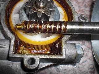

  10. fredspeed
    fredspeed New Member
    Sep 1, 2009
    263
    Northern Norway
    418Coins

    That wormgear looks like plastic. Is it? The only way to tell if it will be fast and strong enough is to try it. We have no idea from the pictures.

    yeah, the wormgears (large round ones) are plastic. They are on all the wiper motors too! Since I am still in the early stages of my project, is there a way to test them before I actually mount them?

    You can test your motors by connecting a 12V battery to them, or technically any DC voltage source. I would use something that you would be using for your simulator. By flipping the connectors you can reverse them and check if they have the same speed/torque in both directions.
    If you put an arm on their shaft and an increasing weight at the end, you can measure their torque in either lb/in, lb/feet, kg/cm, kg/m or whatever is convenient. You can then compare these numbers with other motors.
