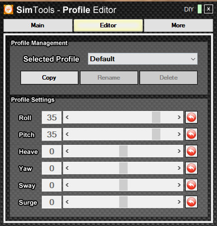

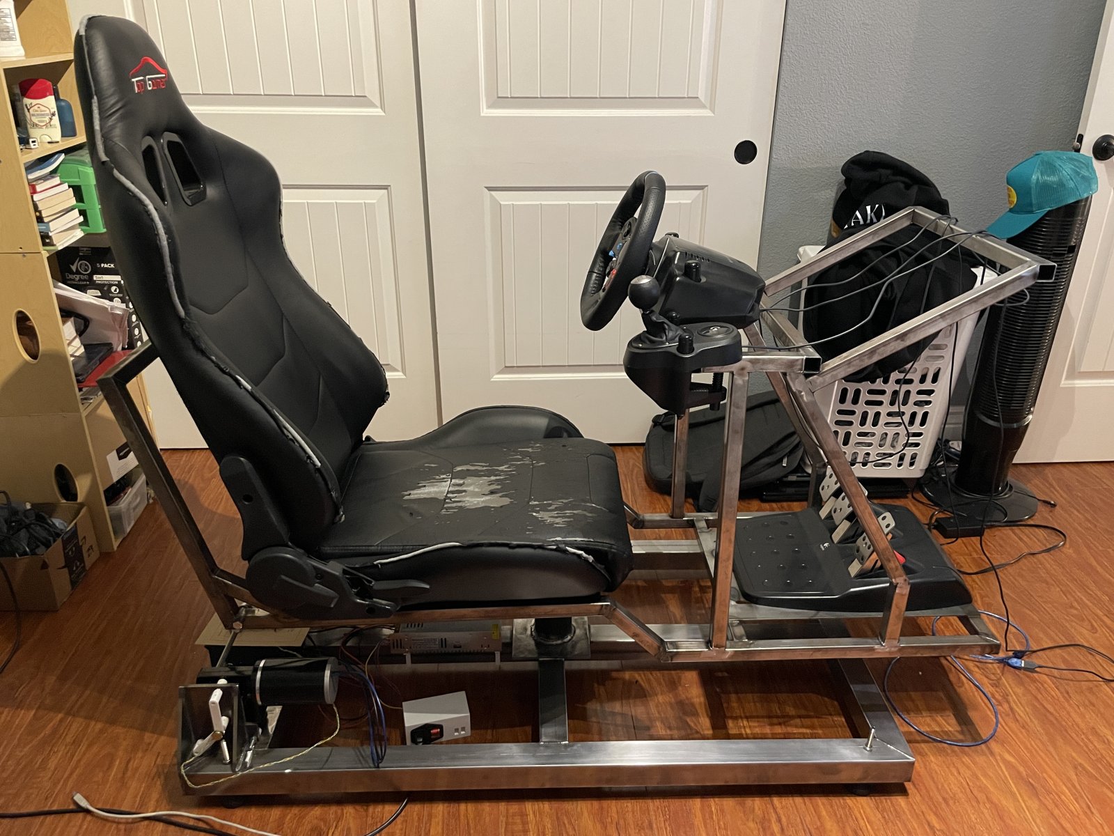

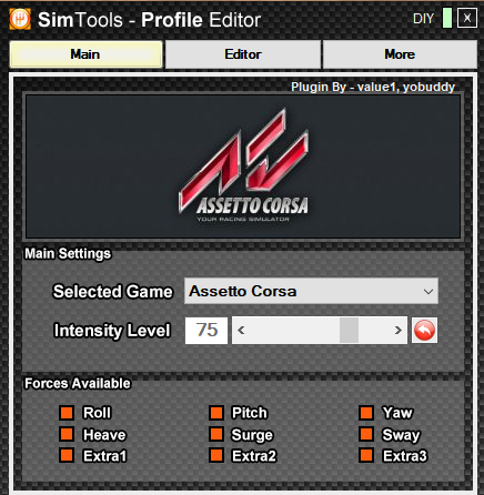

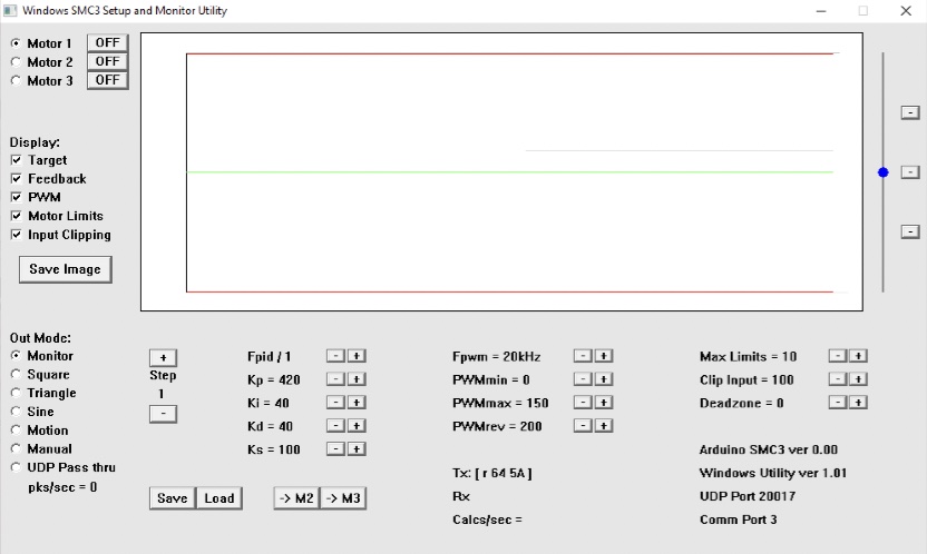

    I am having an issue where when I lean to far in a direction the motors stop working and start to fall due to gravity and they are no longer being held in place. Sometimes it happens right as I start the game, other times it fails a minute into the game. I will attach a video that will show it failing. I have tried changing the kp value, increasing fan speed to cool off the ibt-2 motor controllers thinking it is overheating. Has anyone had this issue and knows what could solve it because I feel like these motors are plenty strong to support the weight. I weigh less than 180lb.
    I built a 2 DOF racing sim using the ibt-2 motor controllers and 12v Crab Pot motors. The motor is 12v, 15amp, 180watts. My psu specification is 24v 600w.
    My Settings
    I tried increasing kp up to 500
    Would like suggestions with other settings that might play a role.

    For a hefty full frame compact design with limited inherent design leverage you need to shorten the lever Center to Center distance to the rod connecting hole, likely to around 50-60mm, as torque in such a design is far more important than speed.

    Your motor drivers are overheating

    I added a larger fan and it helped reduce it a bit. I think its a combination of overheating and arms being to large.

    I might work on making another arm some time later, hope that will resolve the issue but it may take some time for me to make a new one. First I will redesign the case so that it gets better airflow for the motor controllers. I appreciate the quick response.
