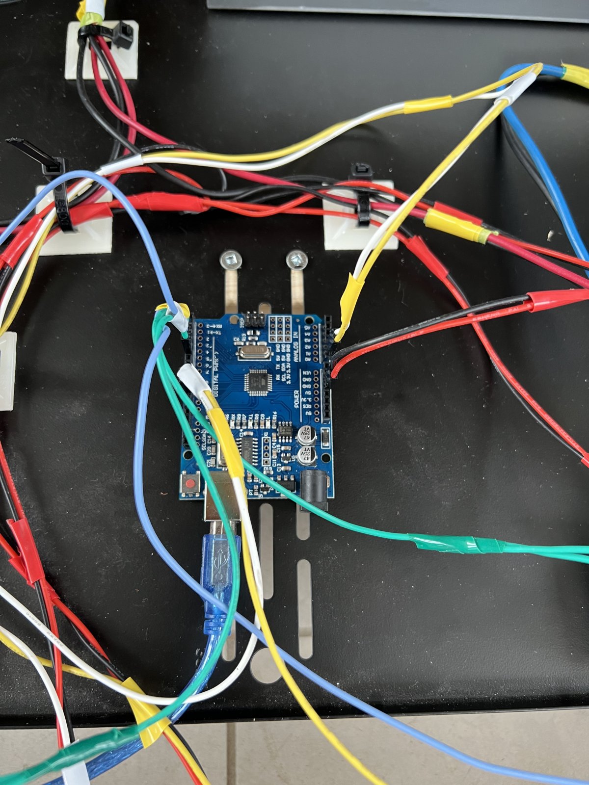

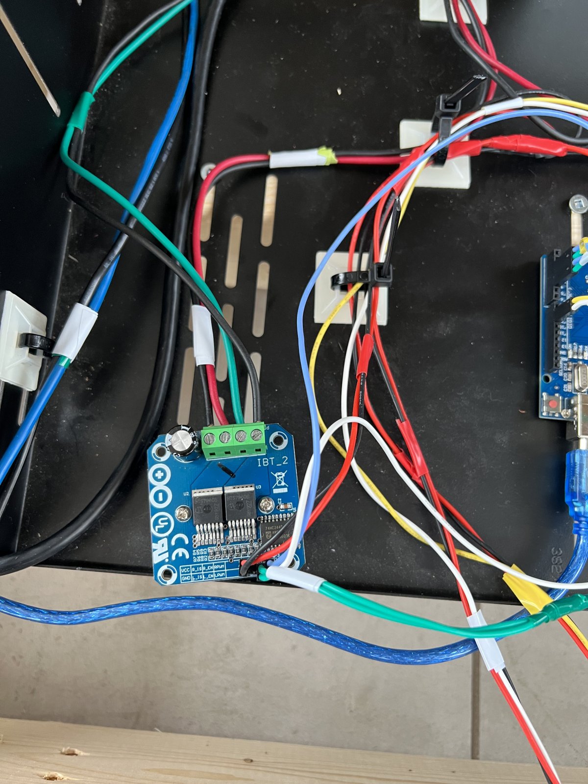

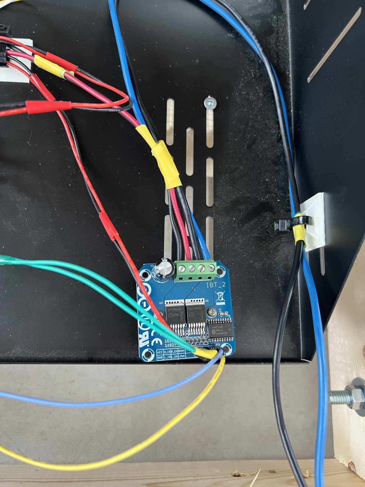

    I’m still in the somewhat early stages of my build. I will start a build thread shortly. I’ve been busy planing, wiring and testing my motors using two IBT-2 43A controllers and SMC.
    Everything seems to be working perfectly. The only issue is that each motor seems to move opposite the other. So when I chose sine, on motor 1, when the green line is at the top of the curve the arm is at the top. Motor 2 is reversed. Green line at the top of curve motor moves the arm down.
    Is this something I can fix in software? Or a wiring issue? I’ve quadruple checked my wiring and it is correct.

    Try swapping the two motor wire connections over.

    So swapping the motor wires on the IBT-2 results in the arm swinging all the way up bringing the green line past my stop lines. bringing the arm back to center and switching the motor “on” again via SMC does the same. As long as it’s on it refuses to stay in the middle and completely ignore the blue line.
    Looking at my problem again I observed that both potentiometers control their respective green lines identically. Seeing as my motors are installed opposite (mirrored), it results in the pots being mirrored as well therefore moving the arms in opposite directions.
    I’m a bit stumped.

    maybe you wired the 2 pots differently? check if your negative and positive wires are on the same side.

    The pots are both wired the same and function identically and correctly. My issue is that my motors are mirrored, therefore motor 1 moves one way but motor 2 moves the opposite way via SMC.
    Everything works great, just opposite one another. Is that a problem?? I have not dived into SimTools yet. Will I be able to configure the motors there?

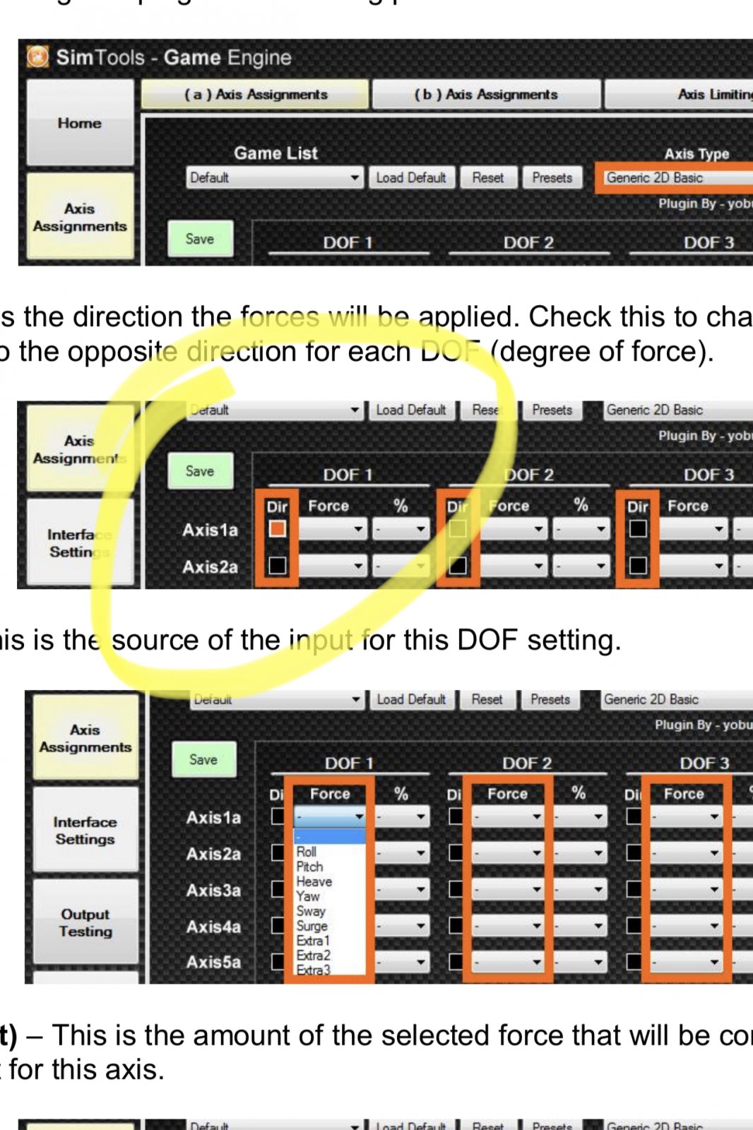

    I was reading through the the sim tools documentation this morning. Will this not reverse my motor arm direction? A135B795-BAE9-49E1-BA47-DCE332320851.jpeg
  13. noorbeast
    22,032
    153,788Coins
    +11,150 / 57 / -2
    Checking the DIR box orange or not will determine which way and axis moves.

    So as long as my green line follows the blue line in SMC it shouldn’t matter if it moves opposite of the other motor because I will be able to sync them up in sim tools. Right?
