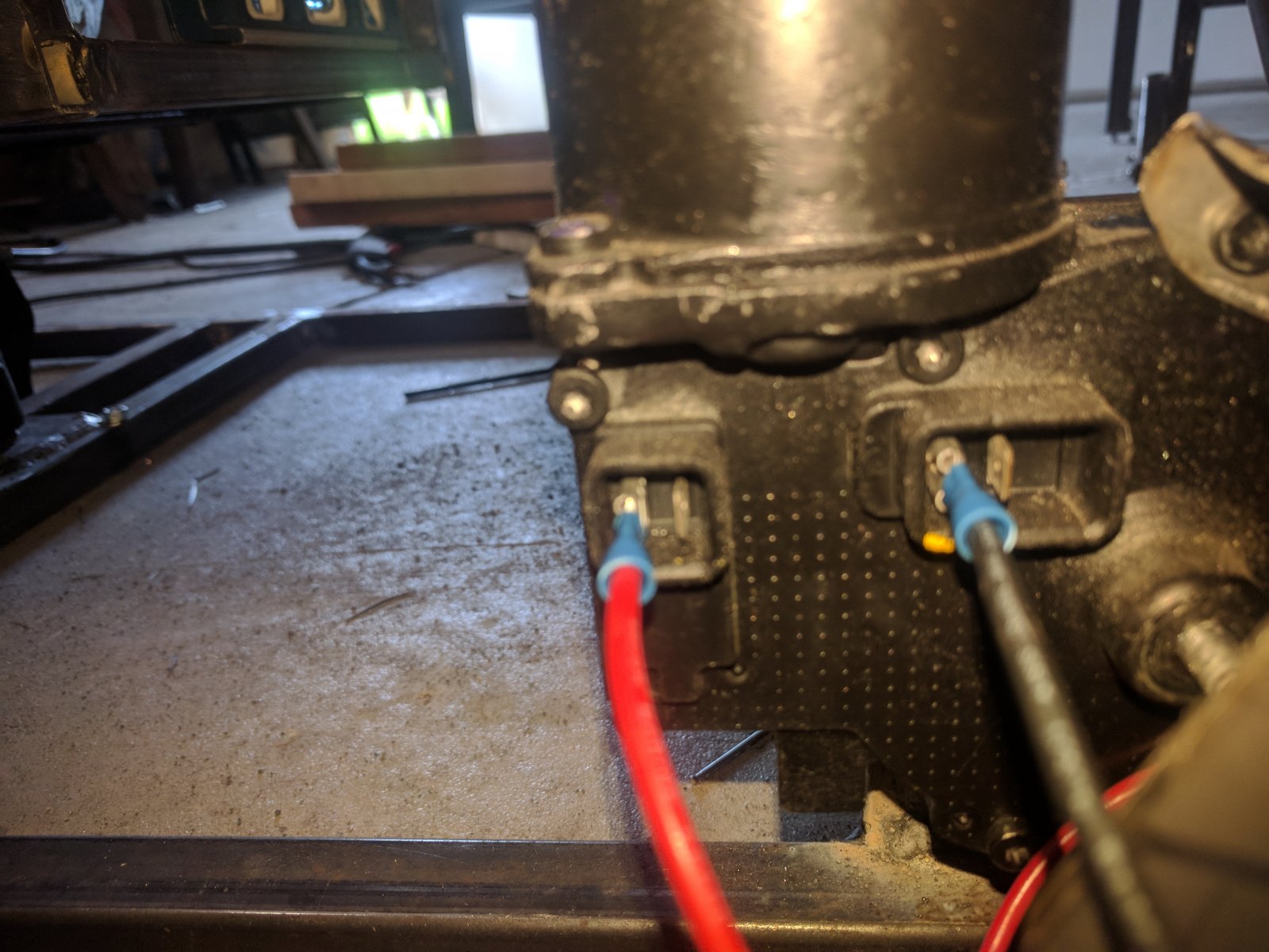

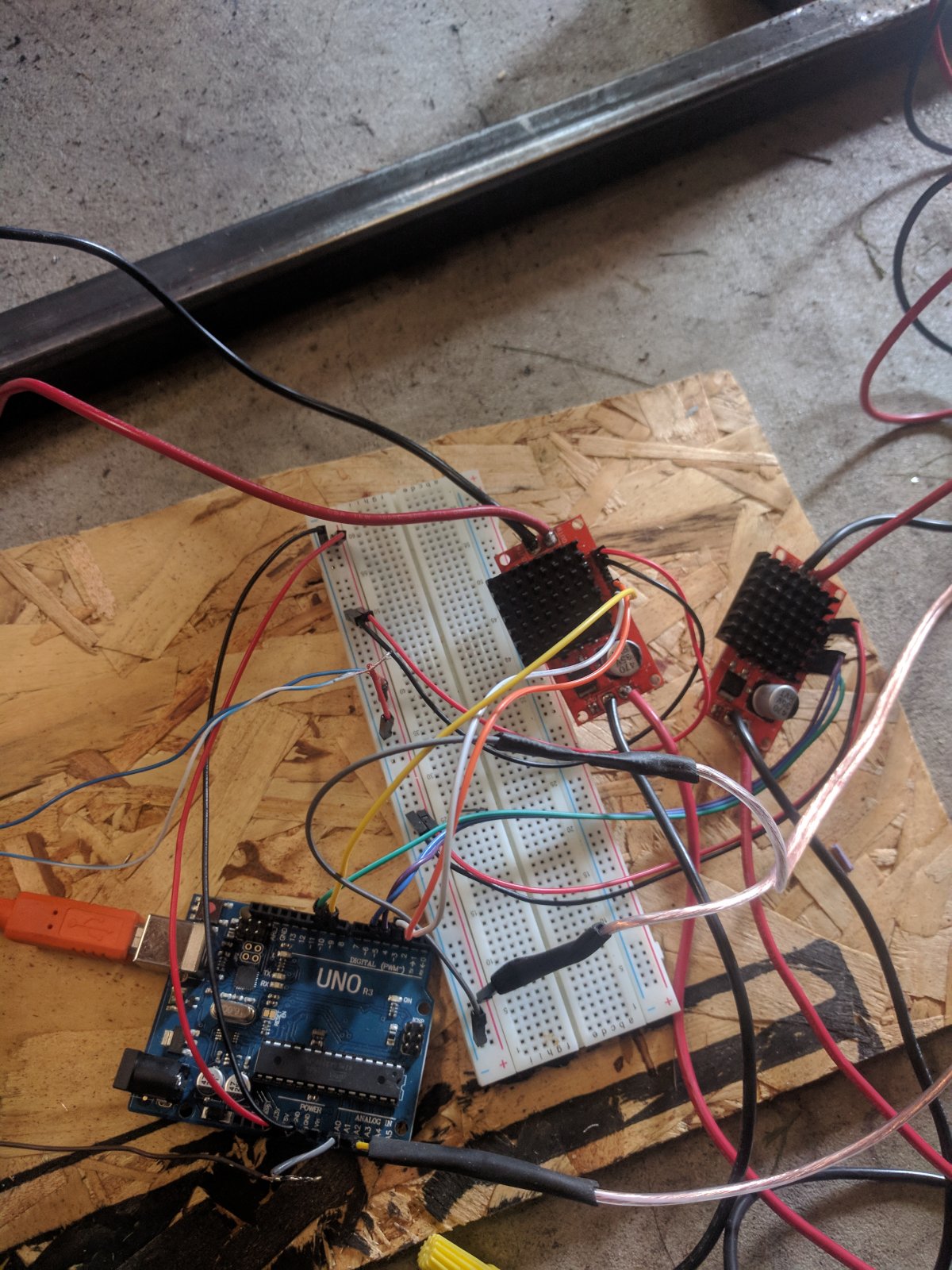

    For some reason I can't get the wiper motors to run in reverse( dow n. I had different motors hooked up that worked perfectly, but there wasn't enough holding torque. I swapped out for a pair of 12v wiper motors, now in smc3 they move forward with the potentiometer but not in reverse. I switched polarity of the wiring, that didn't work either ( the motors will only turn counterclockwise while hooked to the shield). Potentiometers work perfectly in smc3 utilities. I have hooked up the motors directly to the PSU and they work great both forward and reverse. I didn't change any of the code in arduino. And the PSU is more than enough. I am out of ideas on what to do.
    Here's the wiring which is right, it's a mess since I ran out of 18 gauge wire I tried cat5 but it was too noisy for the pots( hence the speaker wire). Testing only.
    Motor:
    I also ran smc3 utilities on my laptop instead of my desktop which the original was on. All the setting are the same.

    The motor is chassis ground, but can't be un grounded due to the fact it is ground in more than one spot. Is there a work around like 2 PSUs. Wiring the grounds to both psus. I don't think isolating the motors are an option.
