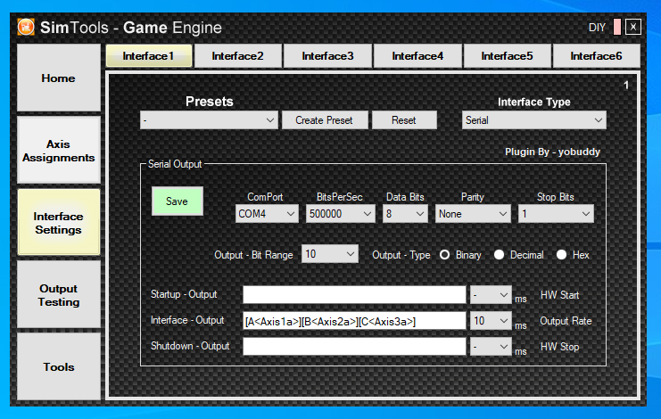

    Hi guys, I need help. I have wired up my DIY setup with two wiper motors, and when I test it in SMC3 it works fine. When I set up simtools, and try the output testing, it doesnt work. upload_2024-2-21_19-37-52.png

    The SMC3 app and SimTools can not run at the same time, if that was the problem?

    This is not the the issue, when I move with the sliders, i hear noise from the motor, but it doesnt move. Could the problem be that the potentiometers are not already mounted directly to the motor?

    The pots provide positional feedback for the motors, so been to be connected.

    Do you have any axis settings for the default profile?
    I suggest testing out SimTools v3, its a free update, and you can use the same license you use with v2.

    I have the exact same settings as Dmax has in his video tutorial. I will try to mount the pots today
