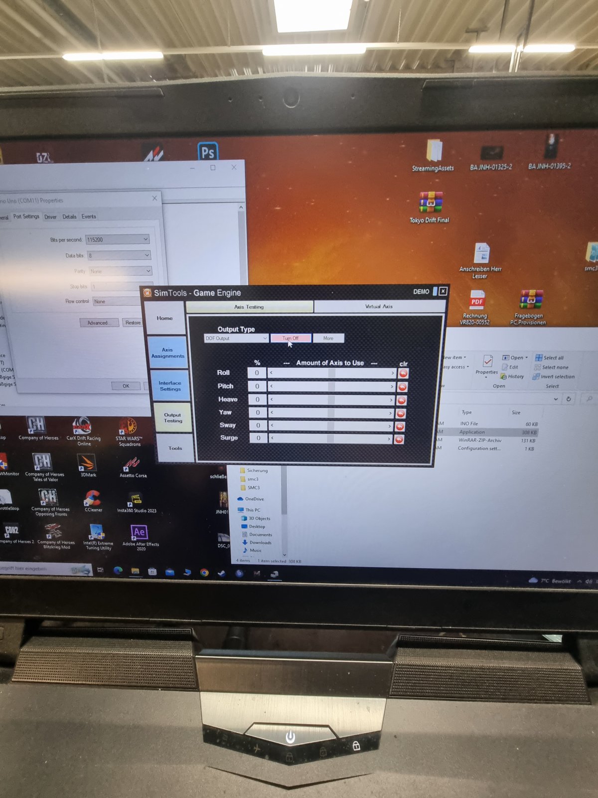

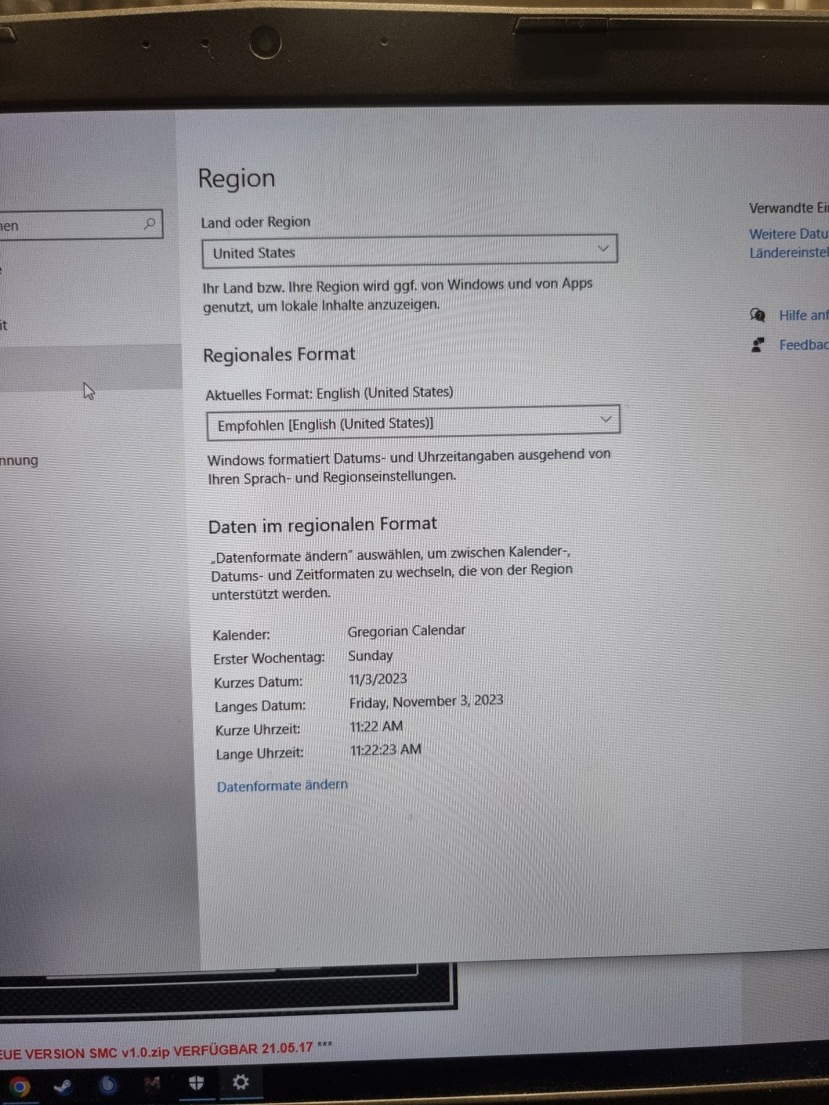

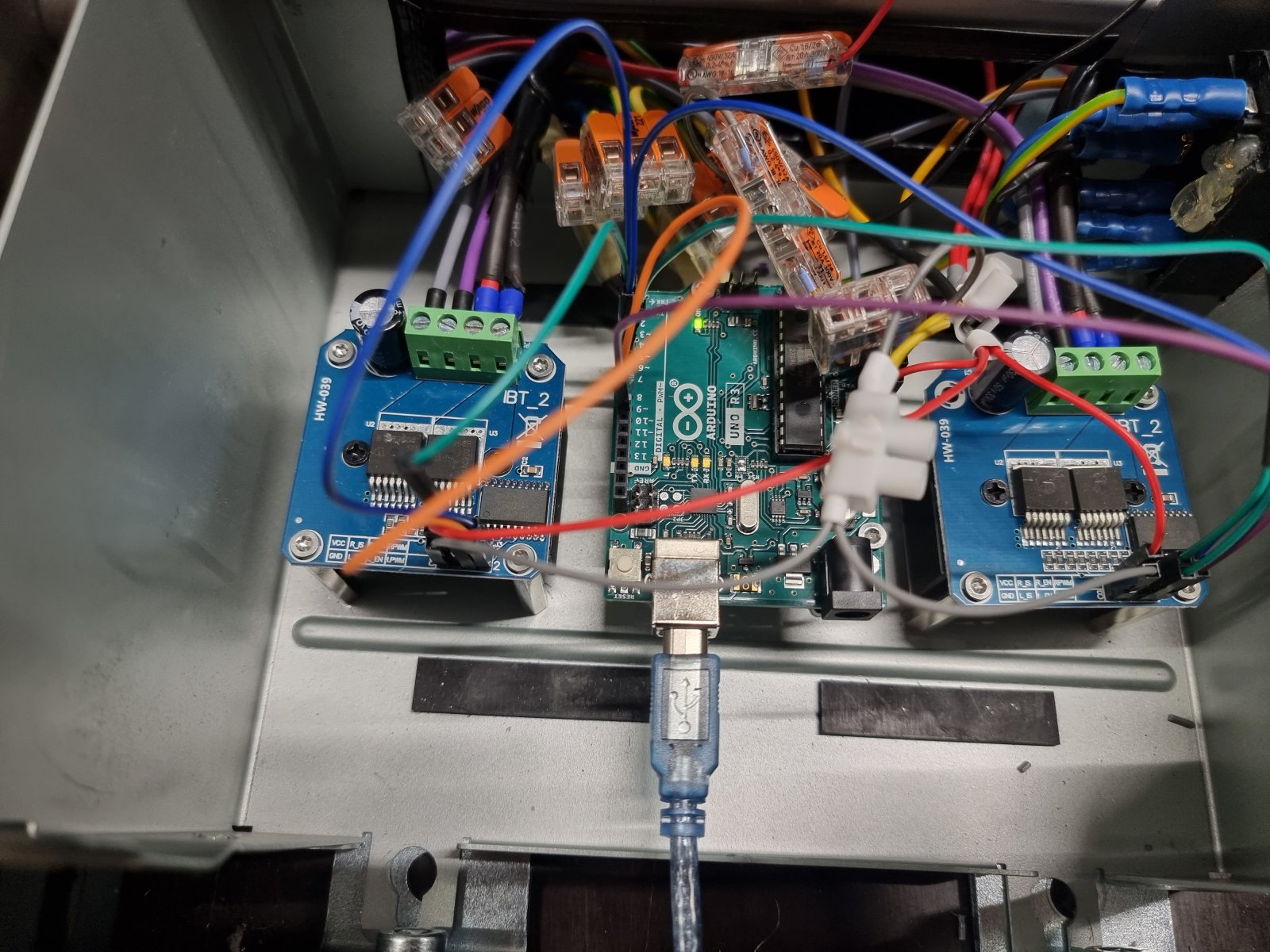

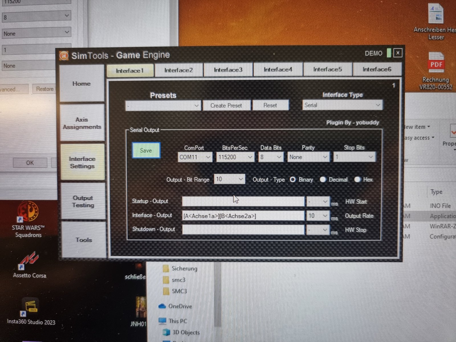

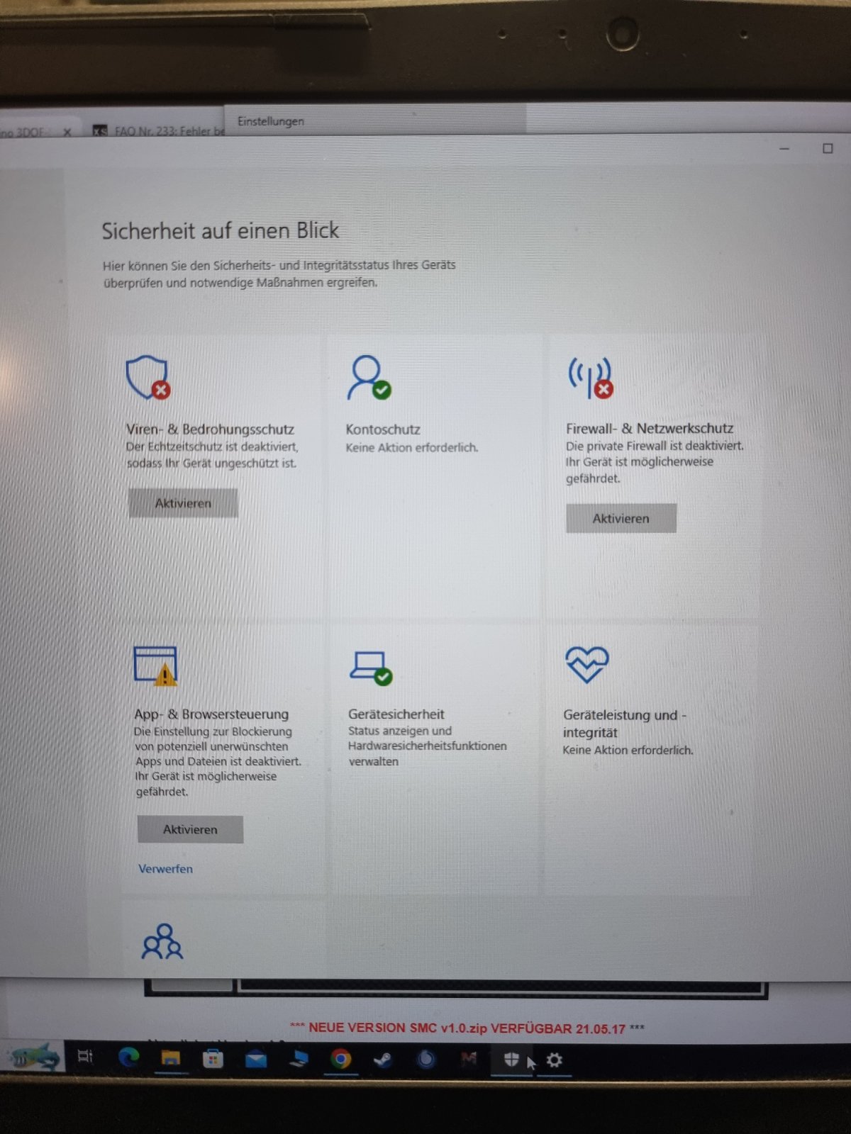

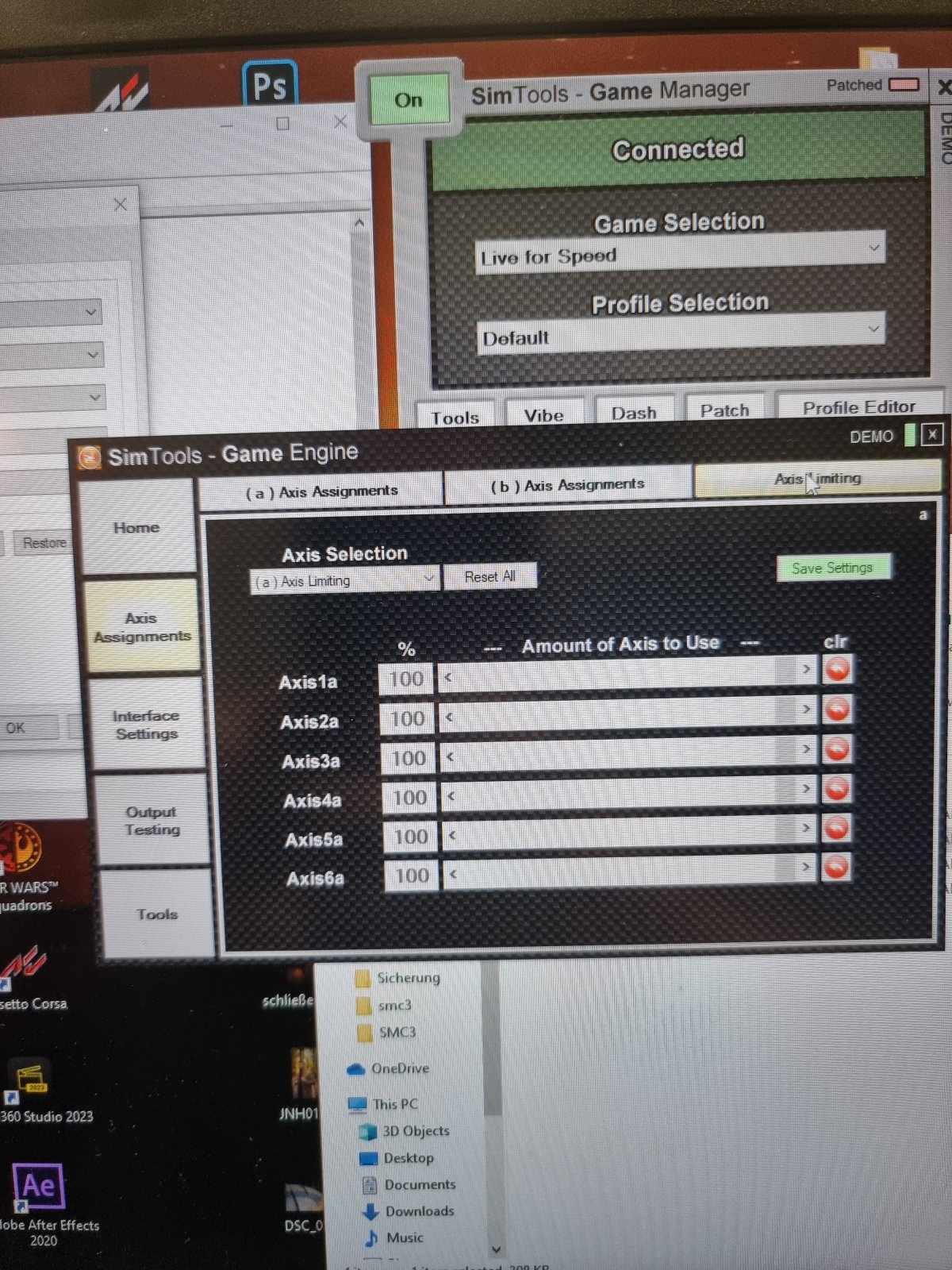

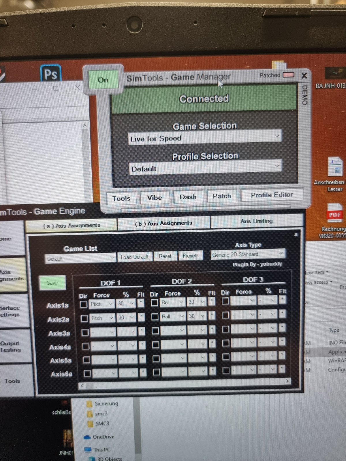

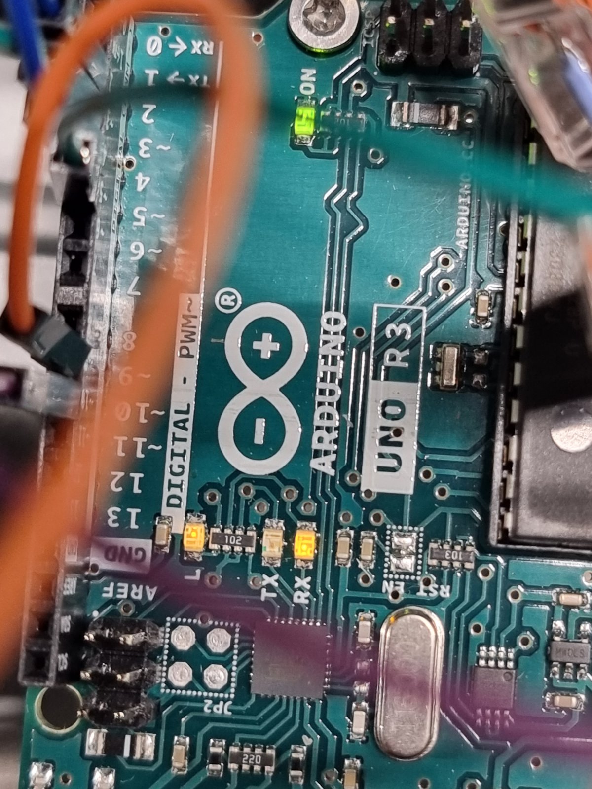

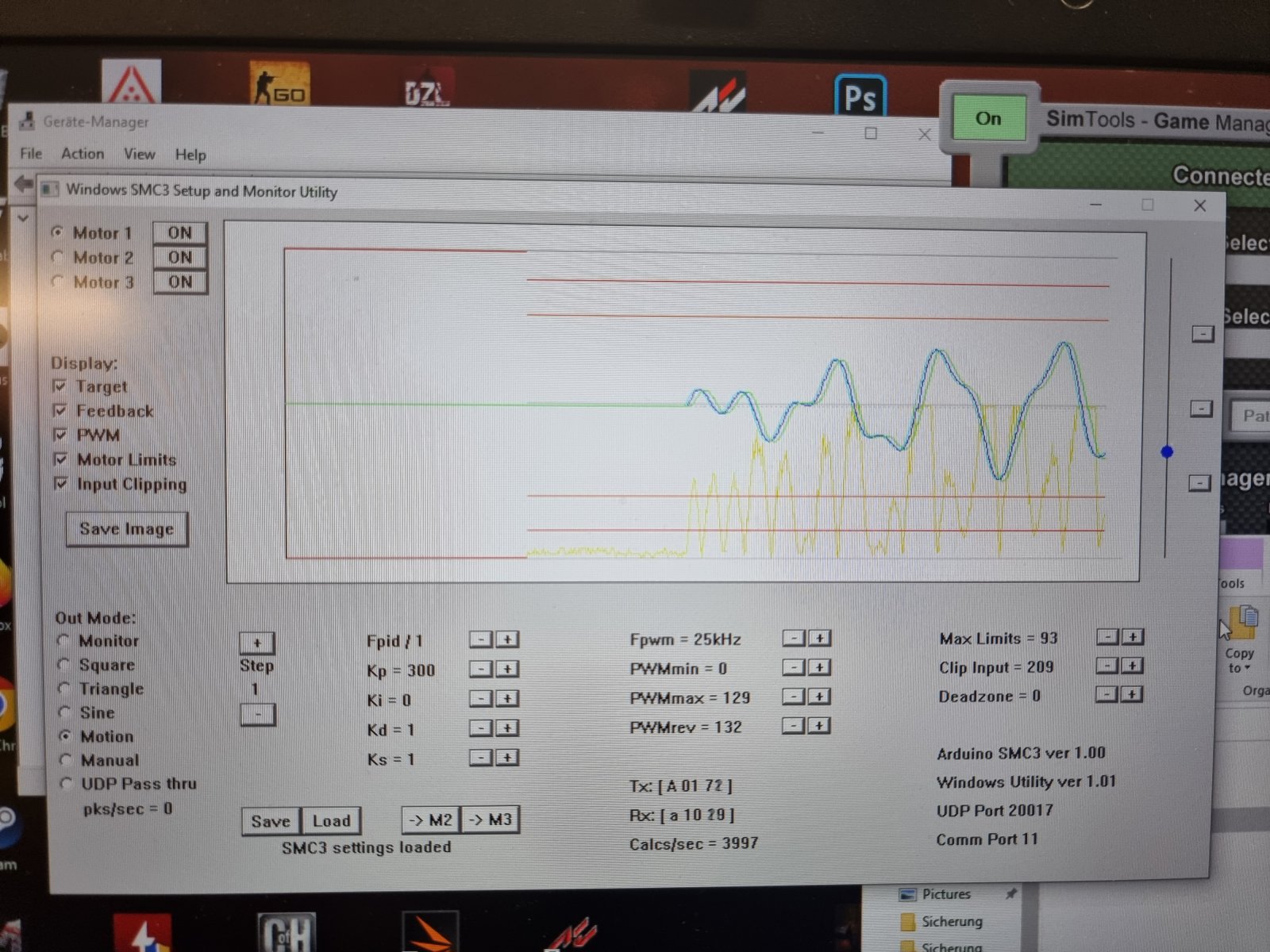

    hey guys, I'm new to motionsim. Where should I start... I have a 2DOF with arduino uno r3 and 2 Hbridges in mode 2 and two wheelchair motors. The rig is completely built and I can start the motors in the SMC3 and they adjust themselves. But as soon as I go into simtools the problems start. I entered all the parameters according to the instructions, the firewall off, smc3 off, PC in English. (I will upload pictures). As soon as I want to test the output and press turn on and move the sliders, nothing happens. On the Arduino, L lights up and the RX but not the TX. In the SMC3, however, L and TX light up and RX only lights up when the motors start up. I've been stuck for 3 days now and can't find a solution to my problem.

    Copy and paste this to the Interface Output - [A<Axis1a>][B<Axis2a>]
    And set BitsPerSec - 500000

    thanks for the quick reply. Is it possible to use 500,000 bitspersec even though my com11 for Arduino says 115,200 bps? I'll test the whole thing on Monday morning and let you know if it worked.

    Yes, BitsPerSec - 500000 is the recommended setting.

    Thanks again for your help. Your solution solved my problem. The mistake was that I translated the page into German and achse and axis looked the same. I noticed that one of the motors lags a little. Can I somehow adjust how directly they record the signals?
    21,493
    150,578Coins
    +11,017 / 55 / -2
    I am glad it worked out.
    Any lag should really be addressed in SMC3, which may end up with slightly different settings for each motor because of small variations in hardware manufacturing.

    Simtools and the SMC3 utils app cannot run at the same time, is that maybe the problem?
