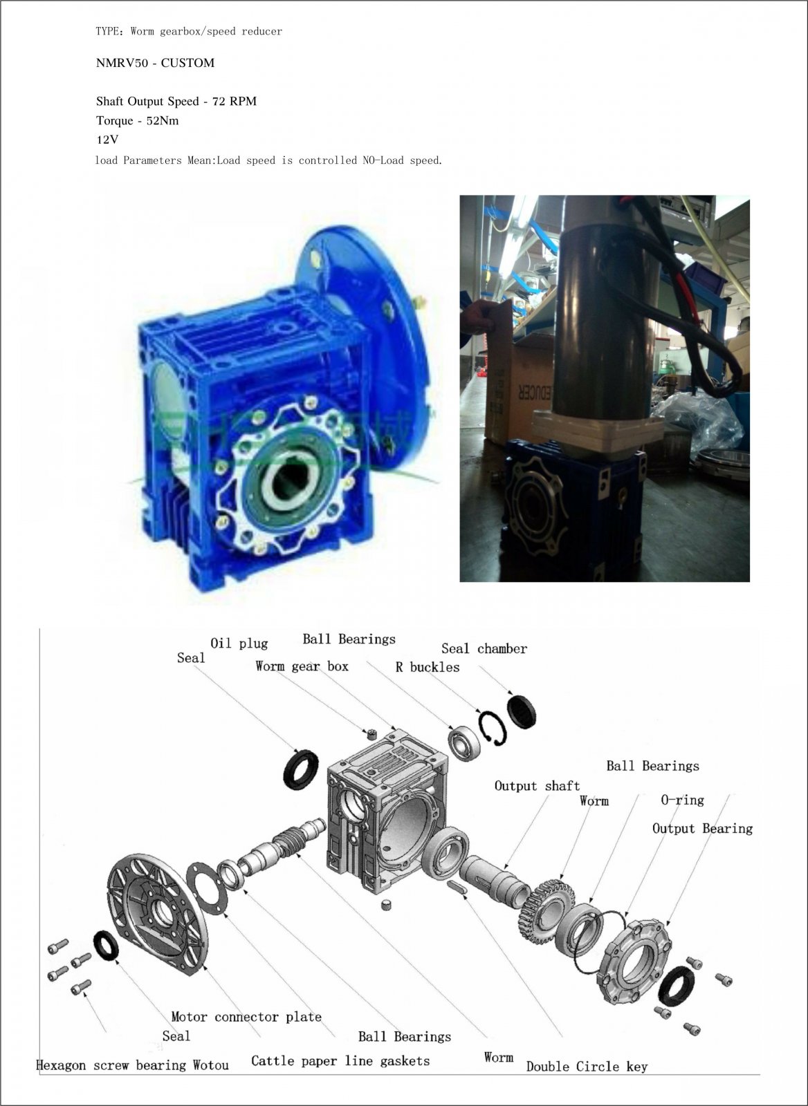

    A little more about the motor.....
  9. Pit
    3,012
    30,476Coins
    +3,097 / 31 / -0
    @kanuk The max. of Watt says nothing about the needed torque. Or in other words: my 700W winches need only 30A current, because the weight of the seat (and driver) is the factor of needed current. On the other hand I bought a 200W motor for traction loss from ebay, this motor burned a 25A fuse while overturning due to a handling mistake. IMO 200W is enough, unless you are very fat ;) . Your motors have a output speed of 72rpm, in this case your lever can be relatively short, so the needed torque should be no problem at all.
