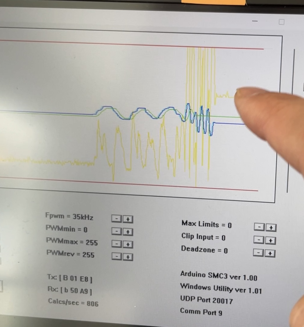

Question Motor stop moving after I slide the SMC3 Utility really fast
Discussion in 'DIY Motion Simulator Building Q&A / FAQ' started by prophet.id, Oct 22, 2024.
  1. prophet.id
    prophet.id BOSeTAMPER's Rotary Servo 6dof Build
    Mar 11, 2024
    54
    215Coins
    +19 / 0 / -0
    Question: Why did the motor stop moving after I slide the dial (on the right side) very quickly?
    The motor is back to normal (able to rotate again) right after the power cycle on the 24v power supply.
    I use IBT-2 motor driver.
    10K pot connected directly to the motor shaft (where the arm is attached).
    Arduino Uno board.
    I tried all the settings on the Utility, and it didn't seem to solve this issue.
    Video that shows the issue I am asking:
    https://tinyurl.com/hx47725v

    AC motor, Arduino, 4DOF
    Hello, this is normal because it seems to me that you have exceeded the limit values (red horizontal lines), the motor goes into safety mode so as not to damage the mechanics...
