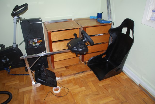

  6. cauehawaii
    cauehawaii New Member
    Apr 16, 2009
    85
    3Coins
    thanks for the answer
    please check my layout attached. I am building it in aluminum to keep it lighter. The base support is based on cska system (update - CHANGED TO MORE OF A FREX KINDA OF SYSTEM).
    I will be glad to hear any thought about it.
    thanks

    thanks man, i saw this post a little while ago but couldnt find again, certainly there are a lot of good information there for me as my setup is similar. .. I was just thinking about substituting some of the gearings for pulleys and steel cables similar to Thanos cockpit... I have got the aluminum bars and they are very light... in the next 2 days the cockpit part should be ready...
    waiting for my pcb boards to get here...I hired someone to do it for me...out of my league to build them... just hope there are no problems when they arrive... they said they would test it, and it should be almost 'plug and play'.. lets hope so...I will post some pics when they arrive..
    ahh btw.. we have to import all the components so it should take a couple of extra weeks...in the meantime I am working on the structure and motor to use.
    Aloha

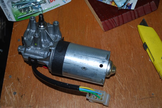

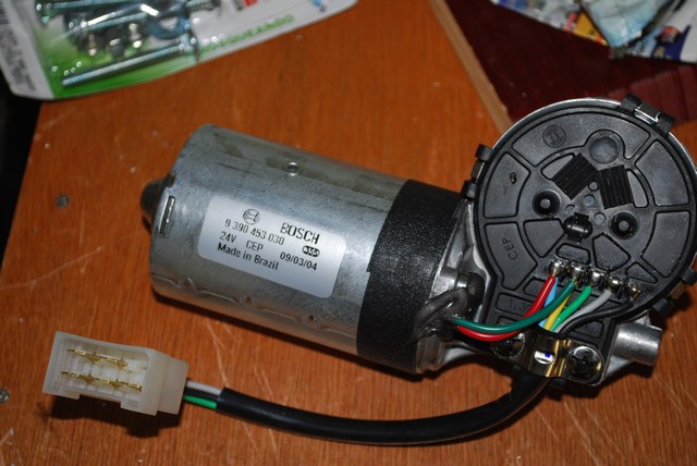

    Below a few pics from my Motor that just arrived
    I would like to make a newbee question... the plug in the motor is for power, correct? What are the cables that go to the H-bridge?

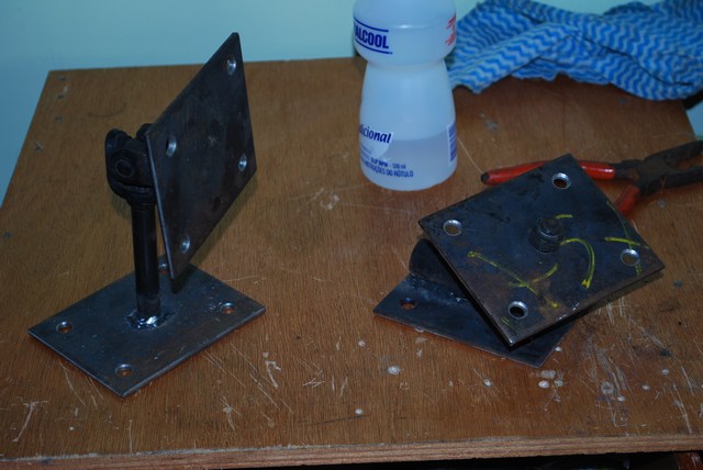

    some pics of my aluminum layout...it is very easy to work with aluminum... and it is very strong...on monday I will work on some improvements and I will install the universal joint on the seat...
    I am still waiting for my boards...we had to import some coomponents..so it should take some extra week to get it done..

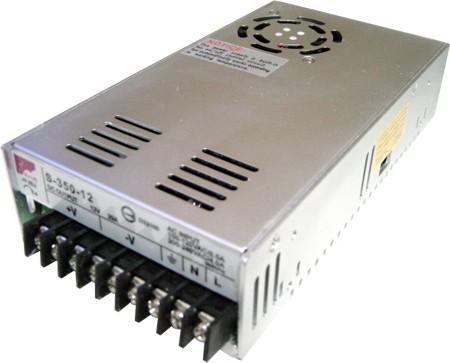

    I am thinking now about buying the power supply below
    switched-mode power supply:
    * Manual Selection (127/220VAC)
    * Manual selection 350W 24V
    * Maximum current de 8A
    * 3 conectos for distribution
    https://www.mercadodopovo.com.br/loja/p ... 01W_24V_8A
    I know my motor is a 24Vdc and max 9A. Can I use switched-mode power supply ?? like the one above? Any recommendation for power supply???
    I am also done with my universal joint below
    Regards

    Just purchased the following Power Supply. I hope it works :)
    Switched Power Supply Stabilized 201W 24V 8A
