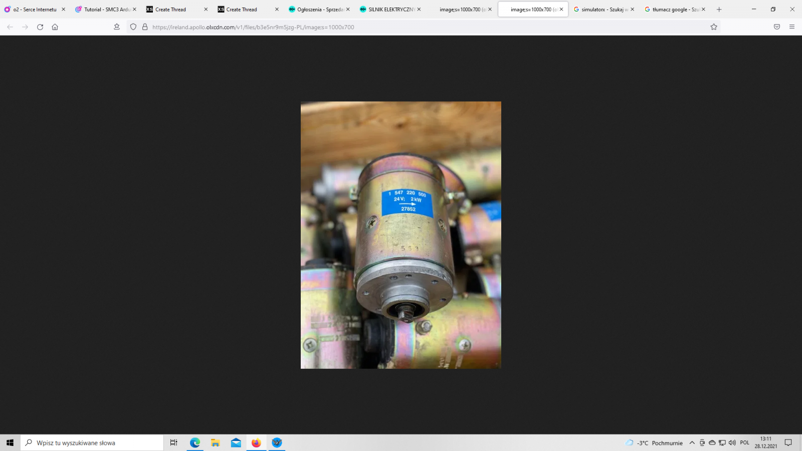

    Hi
    Is this motor suitable for linear actuators?
    Maybe someone knows the parameters of these engines?
    greetings
    Tadek
  2. Gadget999
    1,897
    11,610Coins
    +458 / 9 / -0
    2kw is a lot of power !
    are they a engine starter motor ? what are they used for ?

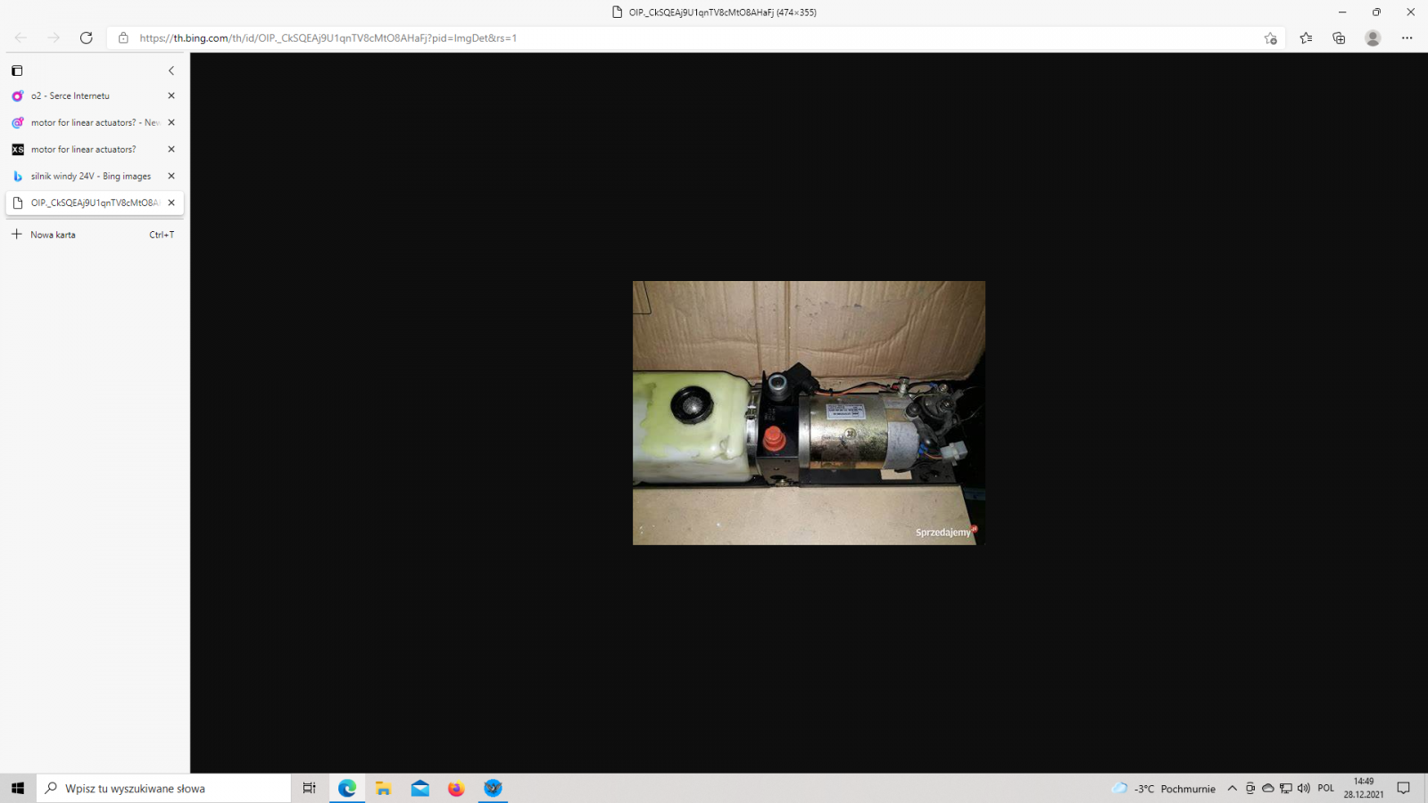

  3. tadek
    tadek Active Member
    Aug 17, 2020
    184
    480Coins
    +33 / 2 / -0
    hi
    This is the engine from the car elevator. Drives the hydraulic pump.
    • Disagree Disagree x 1

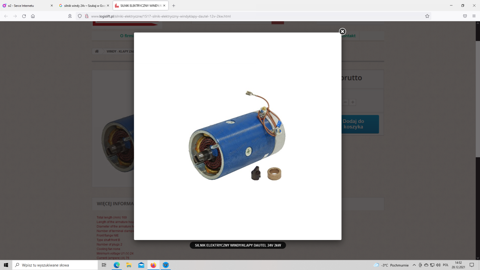

    the price is good about 25 EUR
  7. tadek
    tadek Active Member
    Aug 17, 2020
    184
    480Coins
    +33 / 2 / -0
    parameters :
    Total length (mm) 169
    Length of the armature housing (mm) 115
    Diameter of the armature housing (mm) 80
    Number of terminal clamps 2
    Front flange NIE
    Type shaft front B
    Number of plugs 2
    Cooling fan none
    Minimum voltage U1 (V) 24
    Current (ampere) (A) 76
    Power (kW) 1.2
    Motor type pump motor
    Insulation grade (IP) 44
    Insulation class F
    Direction of rotation CCW
  8. Gadget999
    1,897
    11,610Coins
    +458 / 9 / -0
    Thats a very good price
    Buy one and try it out

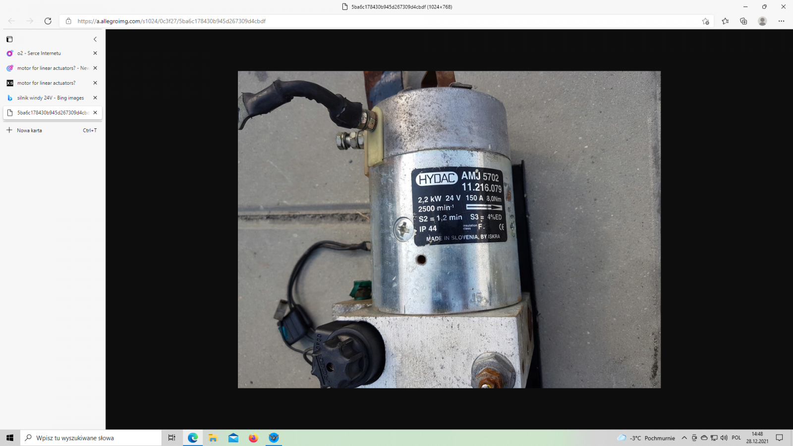

    Hi
    I think Turnover per minute 3500 !!! is too high?
    Whether there is a change of direction of rotation in these motors
    when the power supply polarity changes?

    hi
    Direction of rotation is CW
    Is it problem?

    2DOF, 3DOF, DC motor, AC motor, Arduino, Motion platform, 4DOF, 6DOF
    i think that ist dificult to run these motor because they have a lot amps necesity.
    its posible but you have to look for one h bridge that run with 2kw.
    Best regards
  13. OzzyO
    OzzyO New Member
    Mar 7, 2022
    14
    ARGENTINA
    - 25Coins
    Other problem that i can see its that you will need a very big power source to run 100A even at 24V
