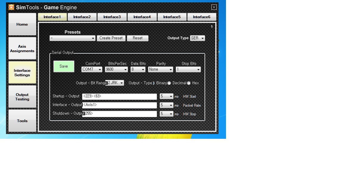

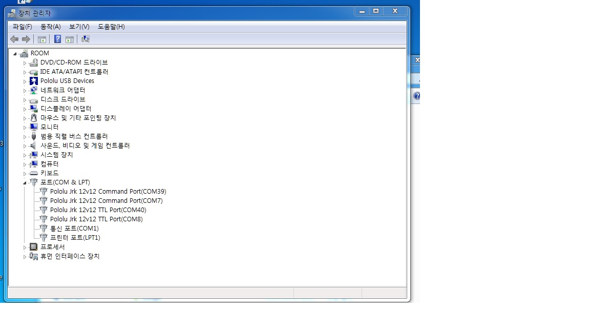

    hi
    I used jrk12v12.
    The motor does not react axis test.
    but, xsim is OK
    I do not know what the problem is?

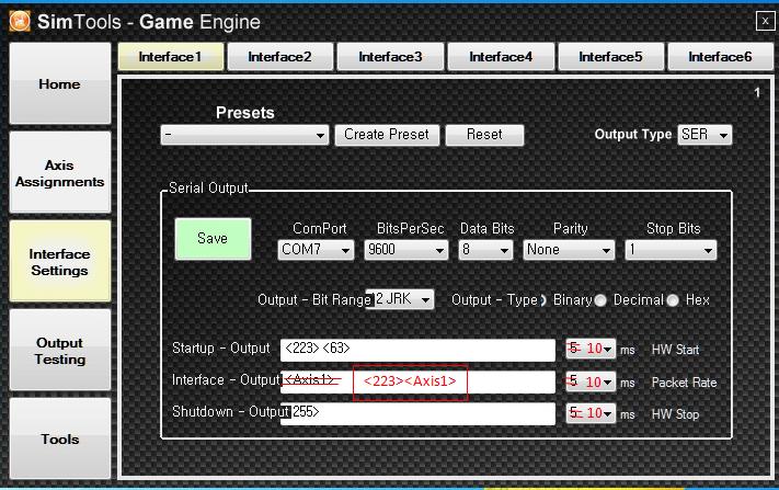

  2. eaorobbie
    20,463Coins
    +1,686 / 23 / -2
    You have missed one part of the Interface Output, should read <223><Axis1>, plus have you setup your default axis in the axis assignment, what happens when you install a new game plugin it transfers the default axis to the axis for the game , same as for output testing it uses the default axis to move the sim, beware too running the Jrks at 5ms can cause motion errors, there is really no need to use less than 10ms as you will not feel a difference in the motion. Xsim you do because of the slowness of Xsim software, its resource hungry. SimTools is not.
    In new version we have been using the 12bit command to move of <221> instead of <223> resulting in a lot more resolution of movement(motion).
    Btw love the setup, details would be cool.
  3. jungsw
    jungsw New Member
    Oct 23, 2013
    737Coins
    thanks,eaorobbie
  4. eaorobbie
    20,463Coins
    +1,686 / 23 / -2
    Yes this should work now, but beware if you change the ms in the Game Engine you will need to change the PID Period in the Jrk Utility to the same value too.

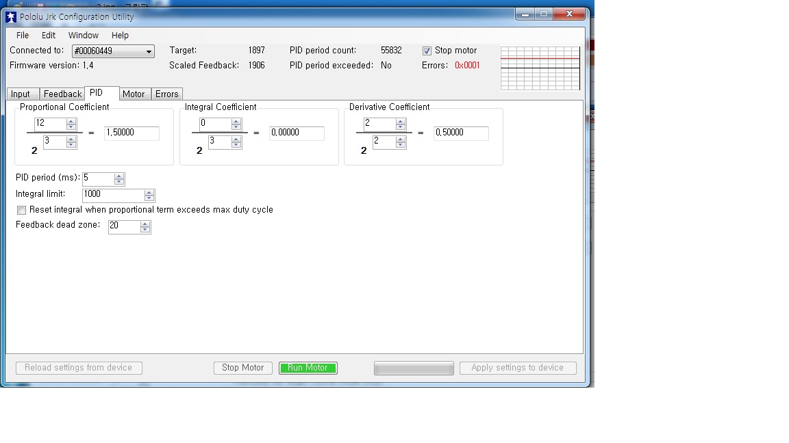

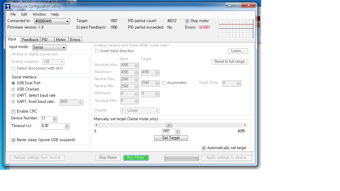

  6. eaorobbie
    20,463Coins
    +1,686 / 23 / -2
    Please can you confirm that you can control them with the Jrk Utility.
    As in Start Jrk Utility and test with slider to make sure they do run.
    These are the setting I and few close friend use with the Jrks.
    Your Comports will be the command ports 7 and 39.
    Please don't forget to push save after changing any setting too.
    You will see I use 20ms in timings for mine as I don't feel any difference with the speed the big worm gears produce for me.
    If SimTools doesn't beep at you when a game starts or when you use the Output setting then the Jrks are setup properly and the non motion either due to the default axis in the Axis Assignment not being setup properly or in game the min and max settings could be too large.
    Could you please provide a picture of the Default Axis settings in the Axis Assignments.Thanks.
  7. jungsw
    jungsw New Member
    Oct 23, 2013
    737Coins
    Very grateful for your help!!!!!
    I want to just use simtool
    test with slider was ok.
    I will test 20ms in timings tonight.^^

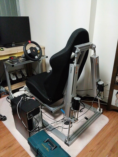

  10. RaceRay
    Nov 8, 2006
    4,657
    Hamburg, Germany
    23,875Coins
    +2,035 / 13 / -0
    @jungsw I am curious for details about your linear actuators. Would you publish more details?
    • Useful Useful x 2

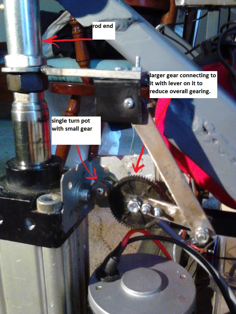

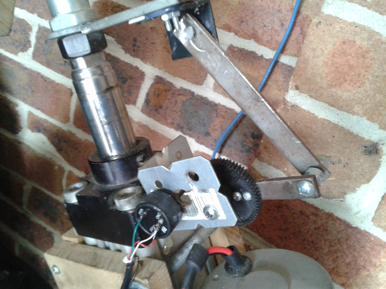

  14. bsft
    Something just occurred to me @jungsw , what sort of feedback system are you using for these? I cannot see anything in the photos.
    I converted some actuators to 12v with JRKS as well, and I had to develop a feedback system for the JRK to read position so the motors could move properly.
    If you do not have a feedback reading off the actuators, they will not move and the JRK will not have a feedback setting in place.

  16. jamesdio
    jamesdio Member
    Feb 4, 2009
    66
    Seoul, Korea
    765Coins
    +59 / 0 / -0
    2DOF, 3DOF, DC motor, AC motor, SCN5, SimforceGT, Motion platform, 4DOF
    I'm writing this reply instead of my friend, @jungsw.
    He has been helping some people including me who want to build their own motion simulator.
    His actuator spec is 40kgf, 200mm/sec. almost like scn6,
    and uses 12V 150W DC motor with potentiometer for feedback.
    He got the cylinders from an FA(Factory Automation) secondhand market.
    I also love his actuators, It's gorgeous!
    @jungsw is a senior mechanical engineer.:thumbs
