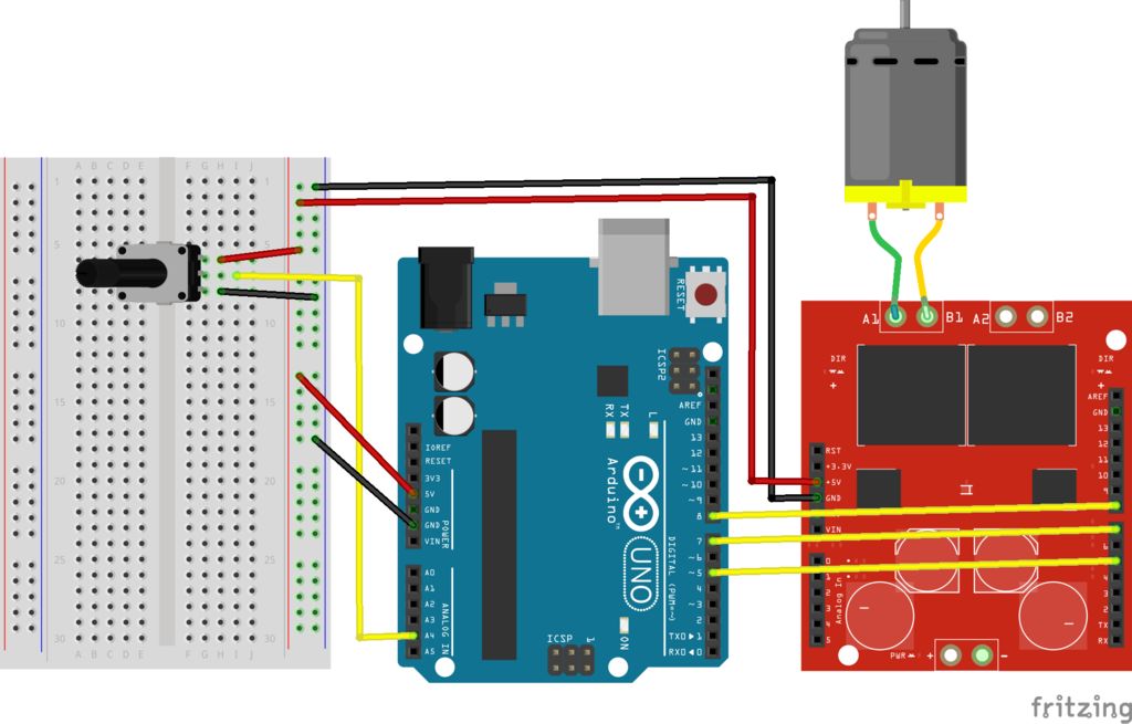

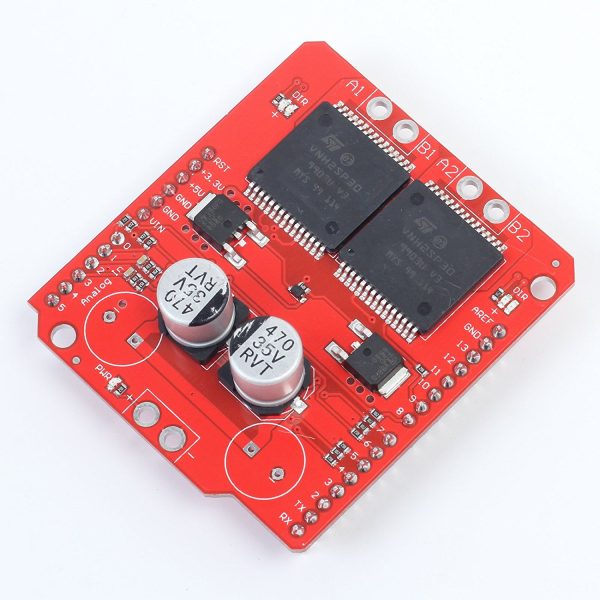

    I want to buil a 2DOF simulator but first I am trying to make at least one motor run.
    The problem that I am having is trat the Sparkfun Moto Monster Shield is getting immediatly hot.
    The shield is rated for 12V 30A (at least it is supposed to) and that is the output of the power supplyer
    What am I doing wrong? Is the shield that is not intended for these purpose (too weak)? or the power supply is too powerfull? or the code is wrong?
    Pls I need help before I fry the circuit

    The problem was caused by my connections. But now I have another problem :
    It sets the initial position , as setup() says, then takes just the first command then stops, just keeps printing "?" on the consols.
    I suppose that happends because of the potentiometer that moves slightly and loses track of the position.
    PS: I tried to take a look at SMC3 guide but it looks a little complicated to me ( I am a web developer but I am a beginner at electronics)

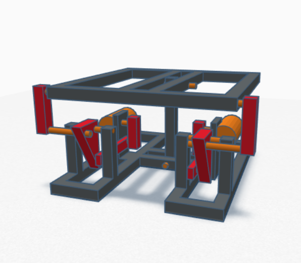

    I was thinking of building something like this to have a better leverage and sacrifice angle for torque in order to keep compact the simulator platform.jpg , I am making a 3d model of it to let you better understand what I am thinking to do

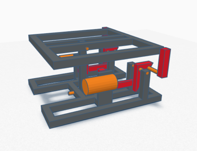

    This might be the final shape of the simulator/platform

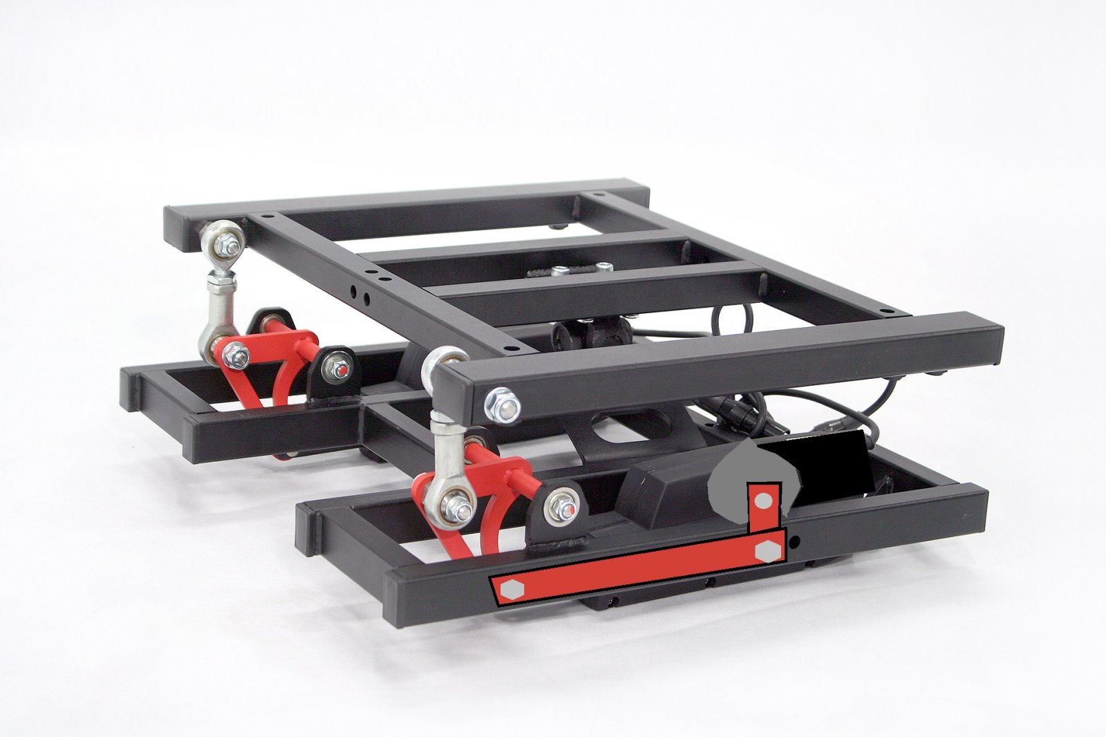

    I don't think you gain anything from this design if you are not using linear actuators, which are more efficient than wormdrive gear boxes. In fact I suspect you add a bit of additional mechanical loss to the torque it can produce, when compared to a direct rod design approach as I used on my compact rig: https://www.xsimulator.net/community/threads/dx-compact-simulator.5866/
