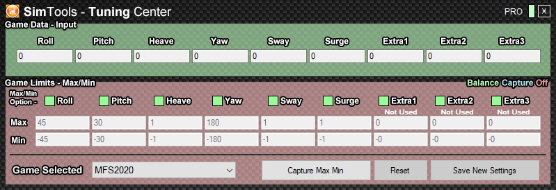

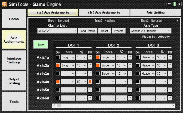

    Hi, first of all my actual settings:
    The video was made with less heave but more sway and surge. I'm still not fully happy, but it works more or less OK.
    Please check tuning center settings too.

    Thanks Michael for your share, indeed, i think i have a problem on my tuning center, which I do not really know how to set :(, currently i have a value Max 10 and Min -10 !!

    4DOF
    Hi, it's not that hard. Start the simulator, write down your actual settings, click on "Capture Max Min", then "Reset". Fly smooth and easy, take off, land. After, you see the new values, mostly like 1,234567. After I recommend change this value manual to a slighly higer, easier value. i.e. 1,5. This value you can then adopt in small numbers, i.e. from 1,5 to 1,3. Never 0,0!!!
    Or you try my settings as a start.
    Michael

    Hi Michael,
    I tried with your "Max+1 and Min -1" settings on the Heave and indeed it works, but only during takeoff and landing.
    During all the rest of the flight the value in the tuning center does not move practically, do you have the same thing on your side ?

    4DOF
    did you try to fly in severe weather? Or doing a step decent out of vertical flying? The next step would be, reduce the heave value in tuning center by +/-0,1. But be carefull. From 1 to 0,9 it increases output by ~11%, from 0,5 to 0,4 by 20%, from 0,2 to 0,1 ~100%. I would not go below 0,5. But try it out.

    Yes I tried in these conditions, I also reduced the heave value by steps of 0.1 and the takeoff and landing phases are much more reactive, but the flight phase remains without movement, the variations of the heave in the tuning center are very weak and have no effect. I have the impression that the Heave telemetry is not taken into account.
