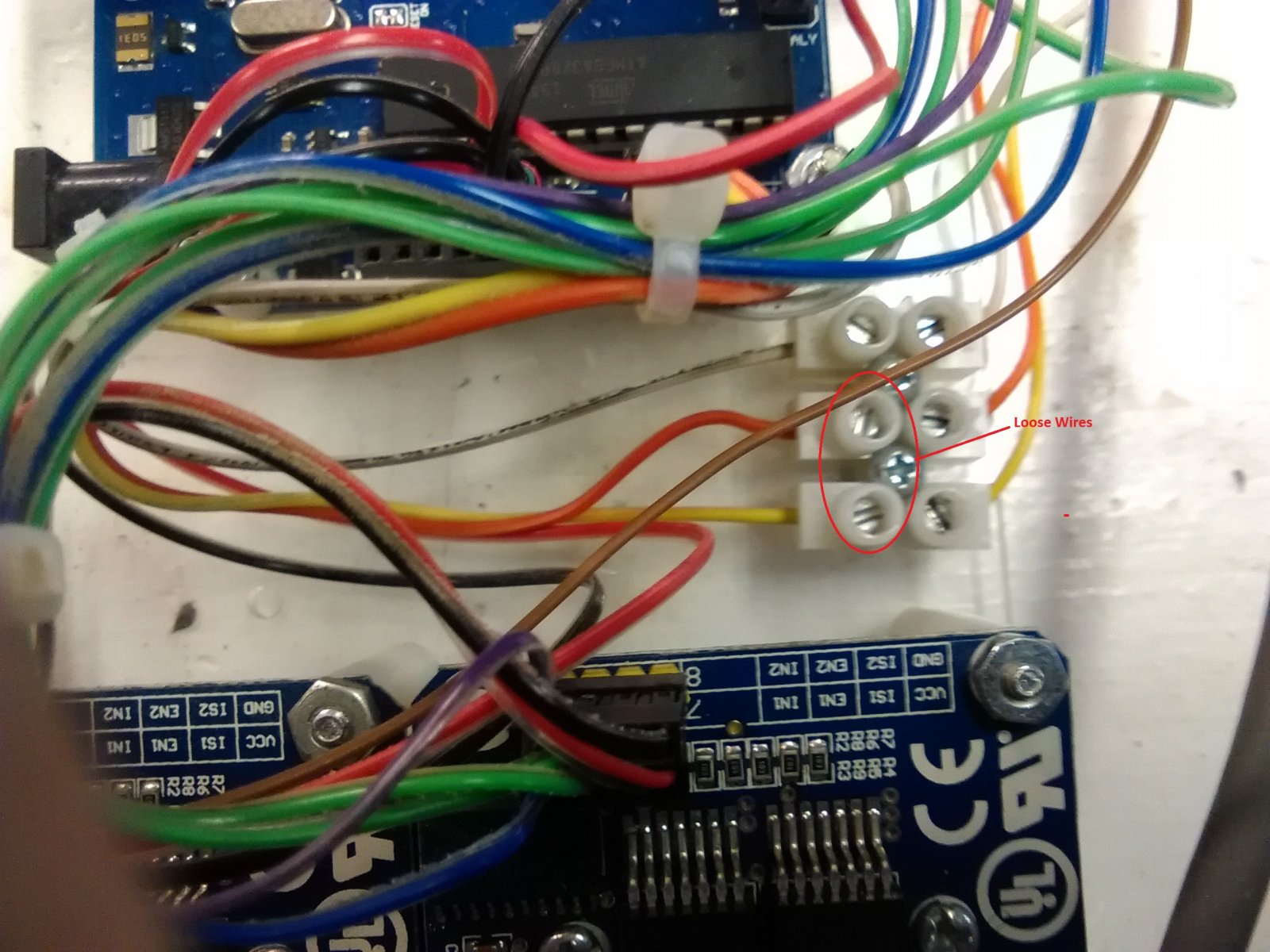

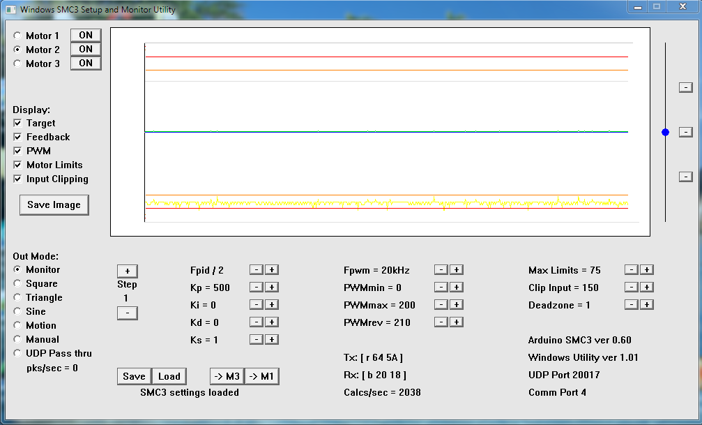

    Hello again. I have been using Sims Tools for quite some time now and up to about 2 weeks ago I have had no problems. I am using it with FSX (Flight Sim). The problem I have now is when I plug it into my computer (Arduino Board) the system fires up and it is always tiped to the left (Roll). The SMC3 Utility shows it to be centered but it is not. Is their a way to center this axis?? Thank You

    Please post pictures of all of your SMC3 and SimTools settings.

    I also thought the same thing and yes I did try adjusting the pot to center many,many times. Still have the same problem, however I did notice that when I was setting on the platform, it seemed to keep moving/tilting to the right. I am using 12vdc wench motor assy's along with 0- 360, continuous pot's. all worked well early. Thank you for you info

    Problem solved. Found two loose wires on my Arduino board hook-up (see Pictures) these wires feed the pot's. Now when I apply power the motion platform goes to center as it should. Thanks again for the help and suggestions from all.
