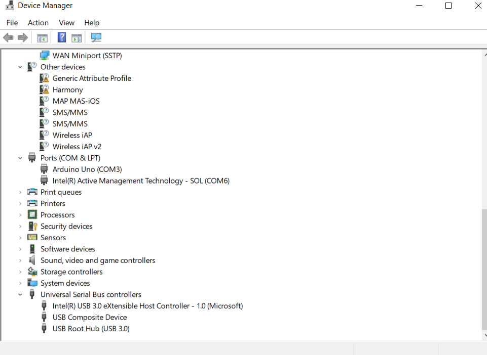

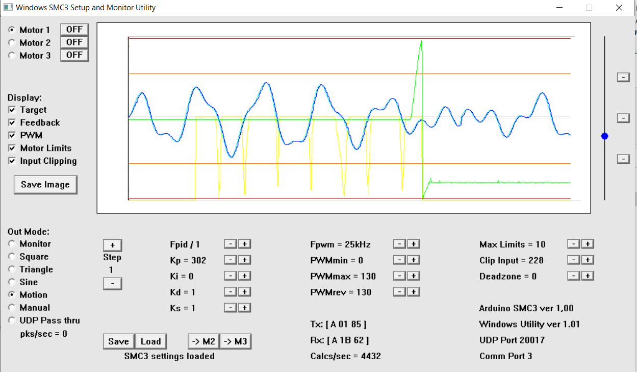

    Hello, I have a problem with simtools, the engines do not move when I do the output testing. With the SMC3 it works well. I appreciate the help.
    I have checked the following:
    1. Simtools version 2.5.1 with activated DIY License
    2. SMC3 version 1.0
    3. USB port check in device manager Com 3
    4. Antivirus and firewall disabled
    5. I run Simtools as administrator
    6. Connections to the arduino verified
    7. I am not running SMC3 and simtools simultaneously
    8. I have reinstalled the USB port
    9. There are no beeps when I turn on the output testing
    10. I turn on the motors first, then the arduino and lastly simtools
    11. Windows 10

    What I can see first off is you need todisconnect your pots from motor then put your motor shaft arm where you want it to be in the neutral position awaiting input from you or a game. Then turn your pots without being attached to your motors with smc3 open until the green line is matched to the blue line in the center of the graph. then reattach to motors and you will be able to turn on the motors.

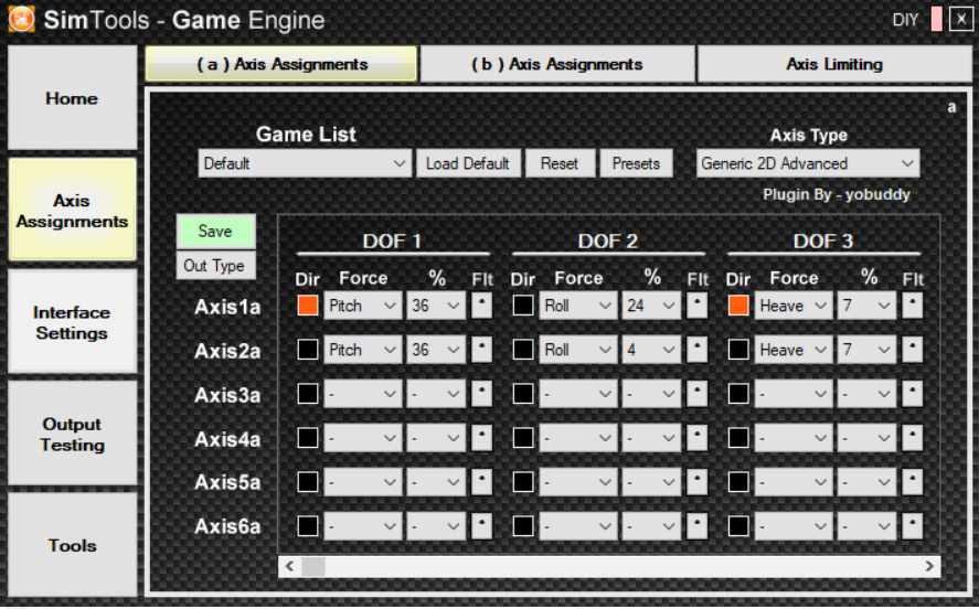

  5. Slybynight
    Slybynight New Member Gold Contributor
    Jun 25, 2020
    19
    128Coins

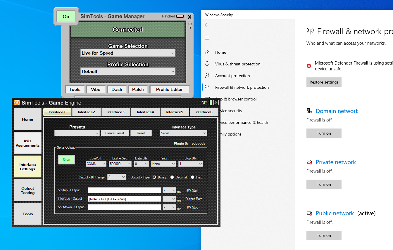

    I am running as admin. I am not trying to run at the same time as SMC3. Firewall is off. I have tried a re-install. Dble checked correct com port. Everything works fine in SMC3. I even bought license in desparation!
    just cant get the motors to move in output testing

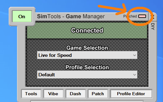

    You have not patched the game yet. (red = not patched)

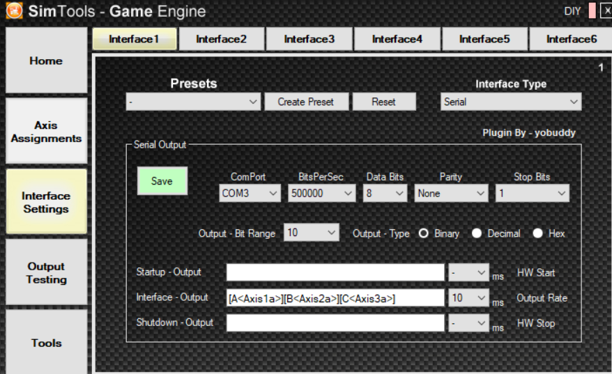

    Output Bit Range should be - 10.
    In Interface Settings the DIR being checked orange or not determines which way each axis moves: https://www.xsimulator.net/community/faq/which-way-to-set-simtool-axis-movements.230/

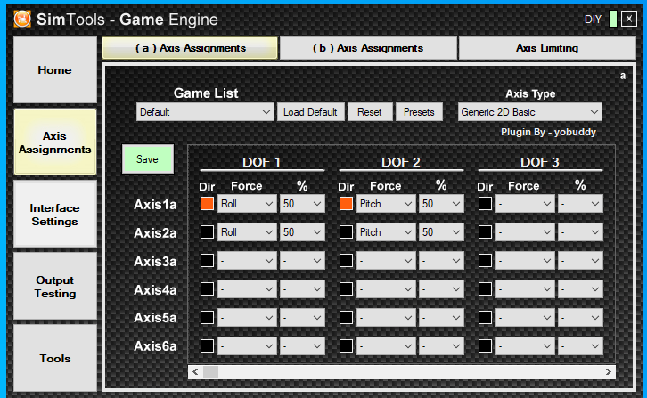

    I was really hopeful for the orange tick-box - I hadn't seen these thank you, presumably you just tick one in each column?
    Still no joy, despite working with manual and tips.
    20,551
    145,124Coins
    +10,778 / 52 / -2
    No you do not need LFS for Output Testing.
    What you do need is a Default profile configured in Axis Assignments, as that is what Output Testing uses.
    You will find the SimTools manual and SimTools FAQs helpful in understanding configuration, including DIR settings: https://www.xsimulator.net/community/faq/which-way-to-set-simtool-axis-movements.230/

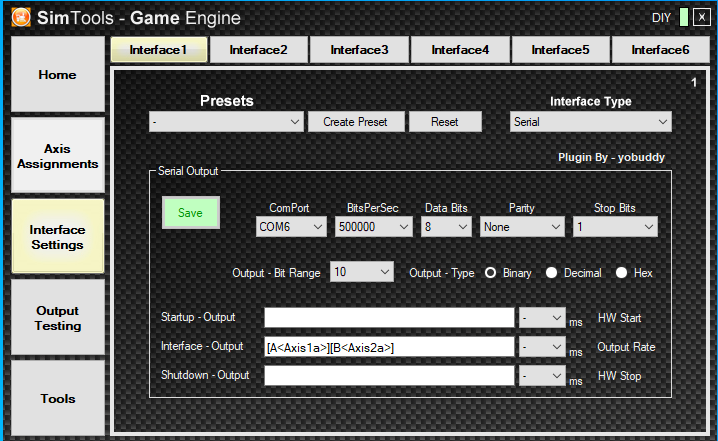

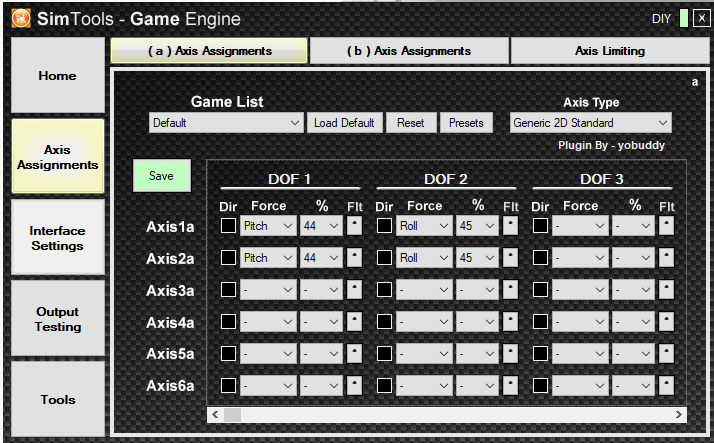

    I have this -
    I think I get DIR assiingments - (direction right?) , I am pretty comfortable with YAW, SWAY Heave etc. I greatly look forward to fettling all of them, but before I can do that, I just need to get the motors to move. at all, in any direction. Even a twitch would be encouraging at this point!
    Just to re-iterate - everything fine in SMC3 - motors track blue line very well.

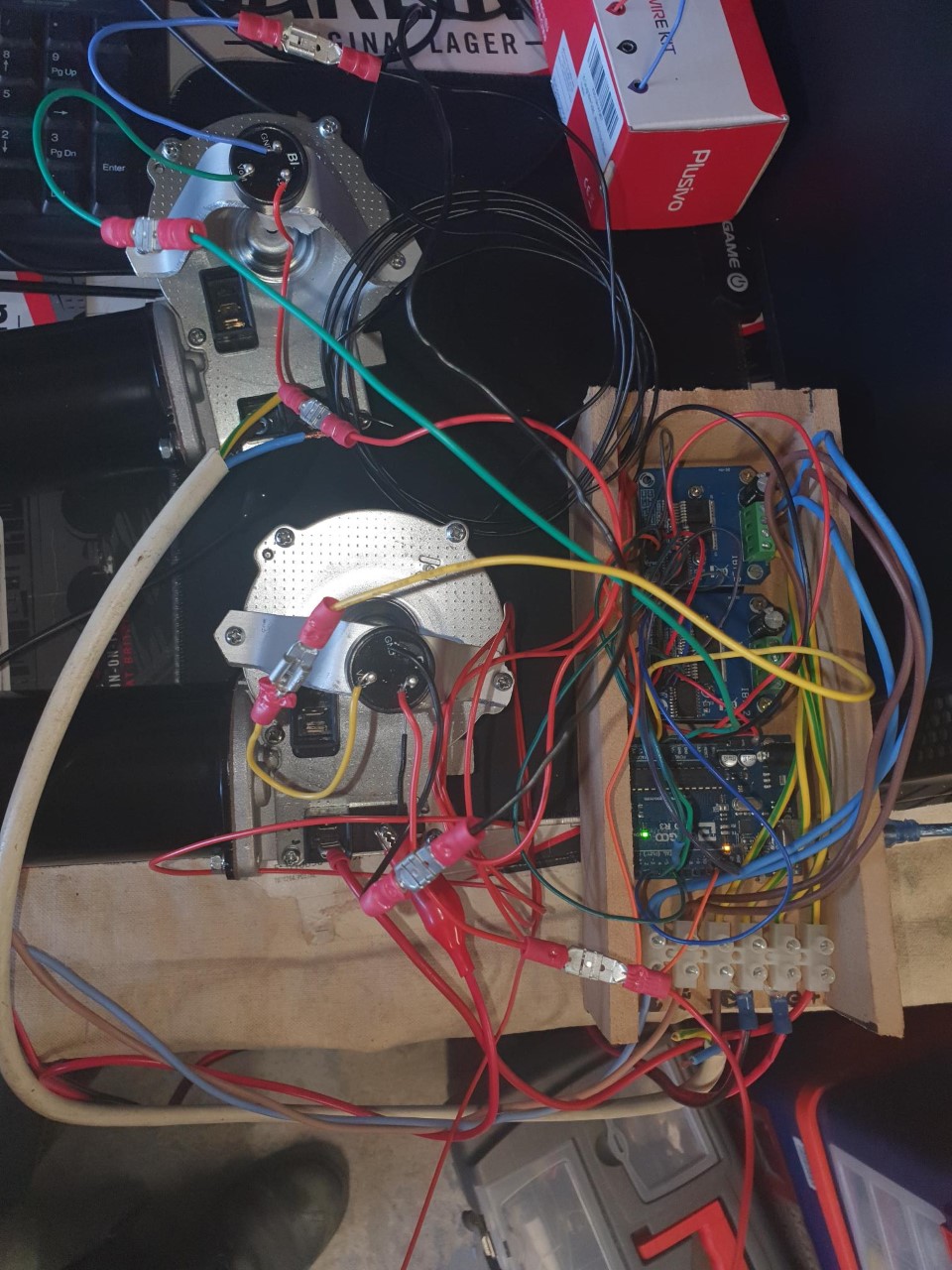

    If it's any help, the motors are "chattering" a little bit when the IBT power is on - to there is a drive signal from the arduino of sorts?

  12. noorbeast
    20,551
    145,124Coins
    +10,778 / 52 / -2
    Normally Pitch would be either both unchecked, or both checked, depending on how the motors are wired.

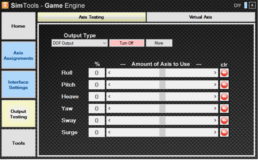

    What happens in Output Testing?

    I have tried every combination of checked and unchecked for everything!
    What happens in output testing is...... nothing at all! I click on "turn on" and fiddle with all the sliders and study my motors for any sign of movement.
    There is none
    Then a small tear starts to form in the corner of my eye and my bottom lip starts quivering again.
    I'm really starting to wonder if it is something in here...
    is that Interface output line OK? I got it from D Max on youtube - he must be on here! He's been spot on on everything else so far.

    Check every thing step by step.
    If SMC3 is working as expected, make sure it is shut down.
    Make sure your computer is set to English Local: https://www.xsimulator.net/community/faq/simtools-language-setting-bug-change-to-english-local.233/
    Temporarily shutdown your Anti-virus and Firewall.
    Reinstall SimTools and reconfigure making sure all settings are correct.
    Check Output Testing
  15. Slybynight
    Jun 25, 2020
    19
    128Coins
    SMC3 Not started.
    Language changed to English US EVERYWHERE.
    AV disabled
    Malware disabled
    Firewall disabled
    Uninstalled Simtools
    Reinstalled simtools - full install, agreed to everything
    Changed USB port - Now com 1 (worth a try)
    Re-entered interface settings (serial now on COM1)
    Re-entered Axis Assignment
    Retried Output testing
    Still no motor movement
    retried with "[A<Axis1a>][B<Axis2a>]" in interface output
    Nothing

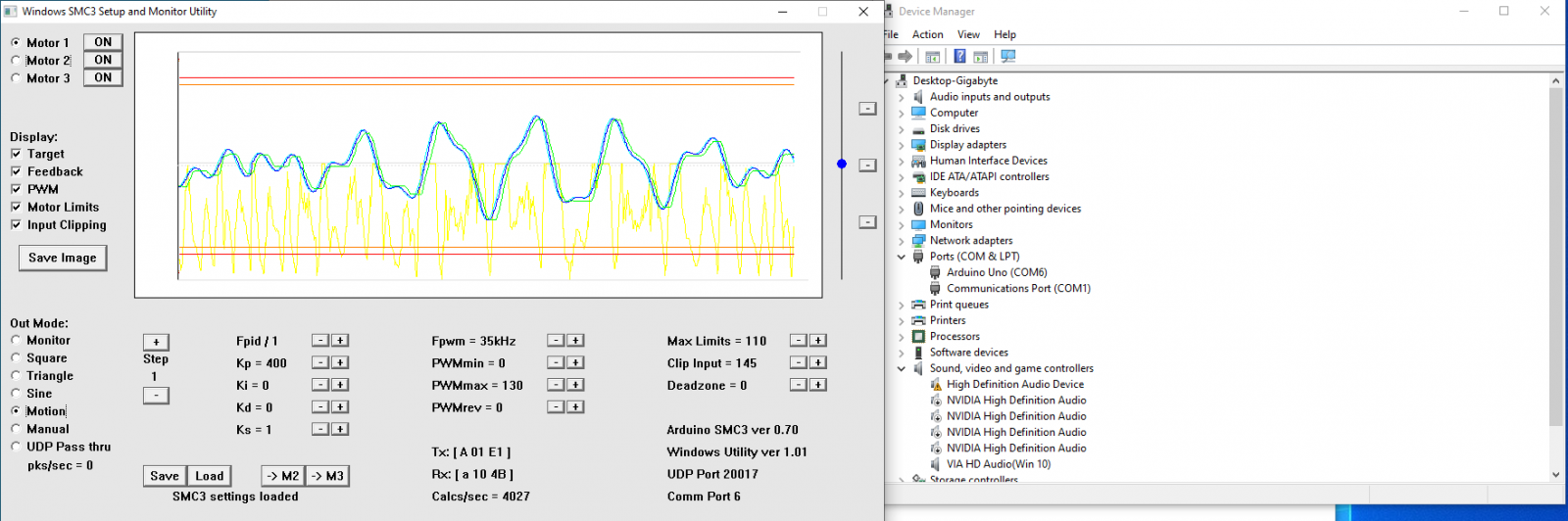

  18. noorbeast
    20,551
    145,124Coins
    +10,778 / 52 / -2
    Please post pictures of SMC3 and Device manager.
  19. Slybynight
    Jun 25, 2020
    19
    128Coins
    Com port now set back to 6 - Motors moving and tracking fine in SMC
    Motors do fight against manual change in hall-effect pot postition in simtools if that helps.
    Also, after reading around here, I have also tried, deleting the com port and re plugging in, changing USB ports and updating drivers.
    Still no joy

    OMG It started working!! All I did was start fiddling with interface output string (stuck an "e" on the end and got rid of the square brackets) and ms values (set to 10). Oddly and annoyingly, its still working now I have set them back to what I had! Which is a bit concerning!! Because I have no idea what fixed it! if it happens again I'm back to square 1!!! I'm off to do some config while I can!!
    Thank you for your help anyway, but I have a horrid feeling I'll be back.!!
