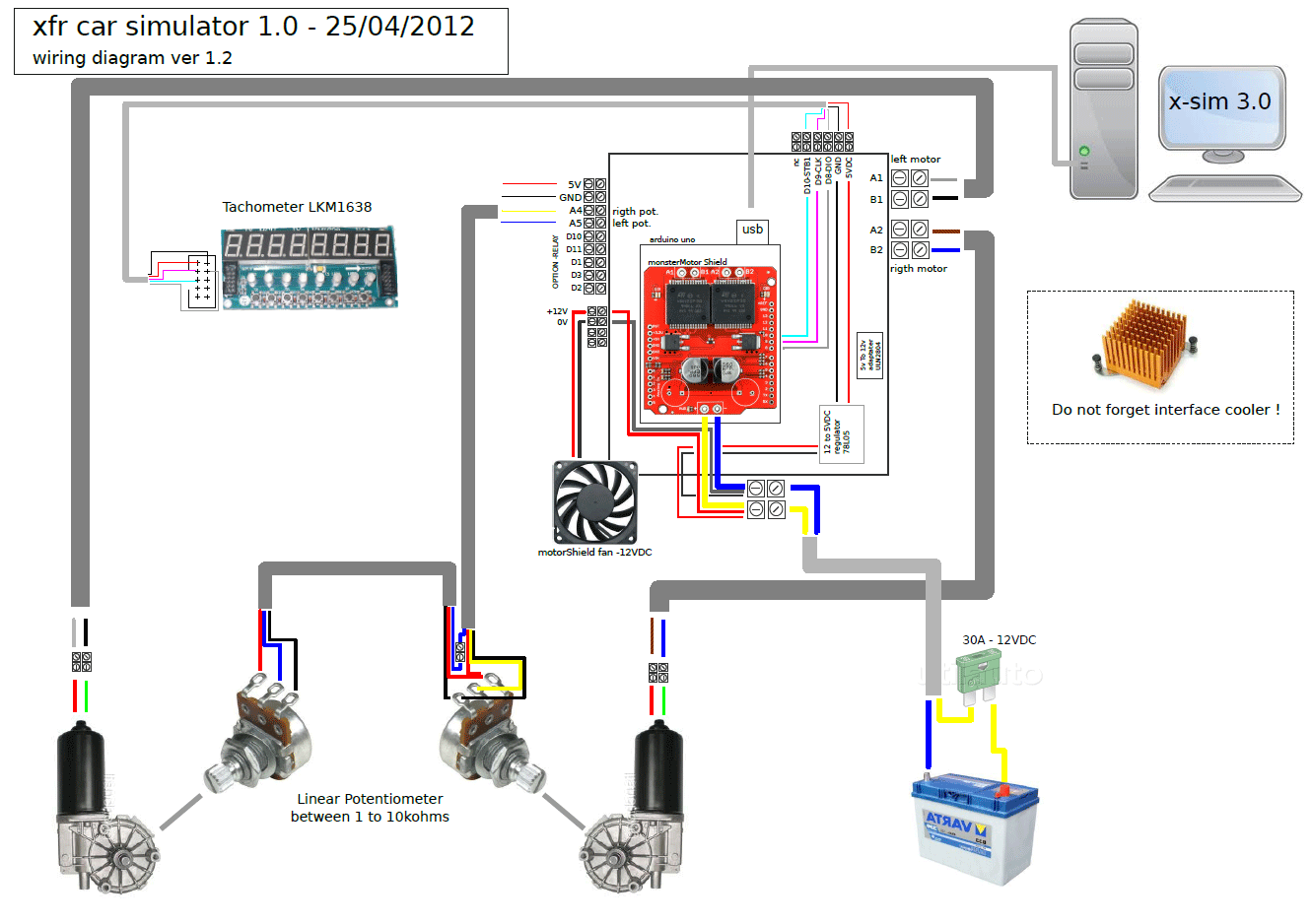

    I just try to finish wiper motor simulator. Im using typical arduino code. I have a little problem with potentiometers i think. In simulation and in AXIS , DOF move test arm mounted on wiper move sometimes like in feaver up and down and stops on right position. What i heve to do to fix it? Or where i should looking? And i thing right axis works faster than left...
    I have to modify the Arduino code? Both engines settings are the same. This is probably the last issue of the platform I have left. I'm using a 10k ohm potentiometer without move limiter.

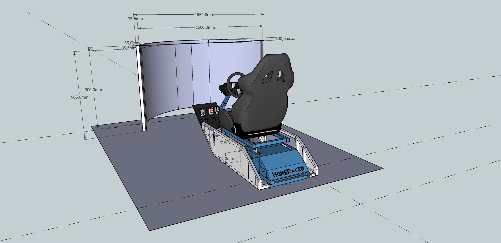

    [​IMG] my sim visualisation.

    Hi bartez81!
    - This code is used successfully by 10 people nowadays... so you will have to investigate further!
    Here some hints for you:
    - Did you try to switch left and right motor ?
    - Did you try to switch left and right potentiometer ?
    - Is your power supply strong enough ?

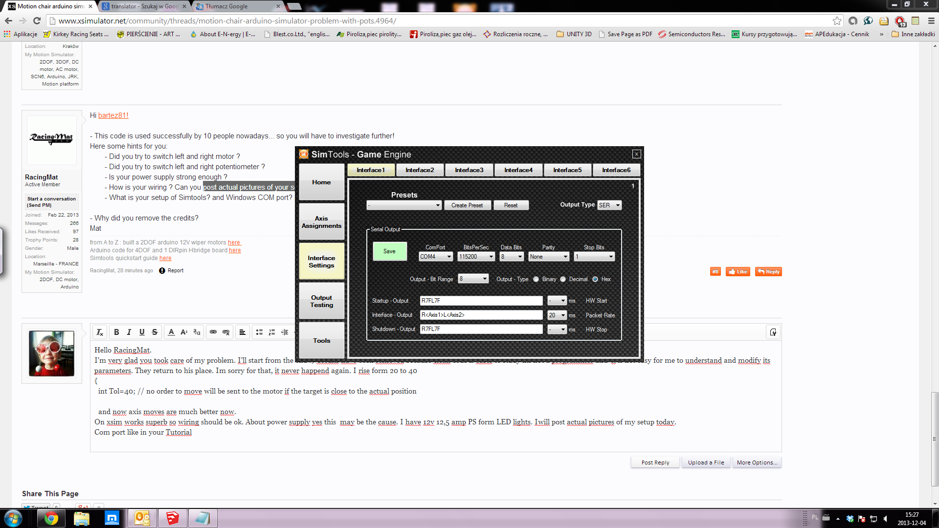

    - How is your wiring ? Can you post actual pictures of your setup and wiring?

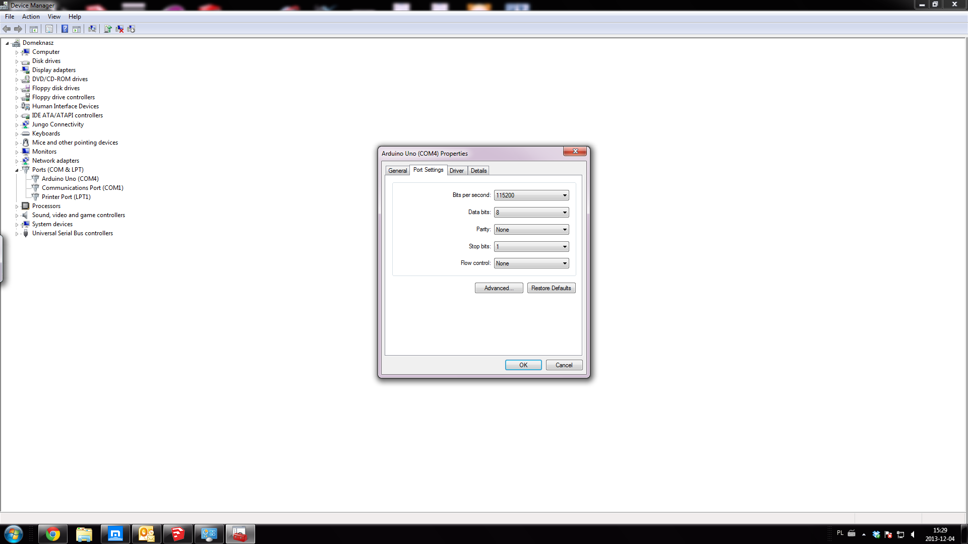

    - What is your setup of Simtools? and Windows COM port? and Arduino IDE? Can you post screenshots?​

    I'm very glad you took care of my problem, you are my hero. I'll start from the end :) Credits have been removed because clean code is easer to study im not a programmer and it is not easy for me to understand and modify its parameters. They return to his place. Im sorry for that, it never happend again. I rise form 20 to 40
    int Tol=40; // no order to move will be sent to the motor if the target is close to the actual position
    and now axis moves are much better now.
    On xsim works superb so wiring should be ok. About power supply yes this may be the cause. I have 12v 12,5 amp PS form LED lights.
    Bartez
