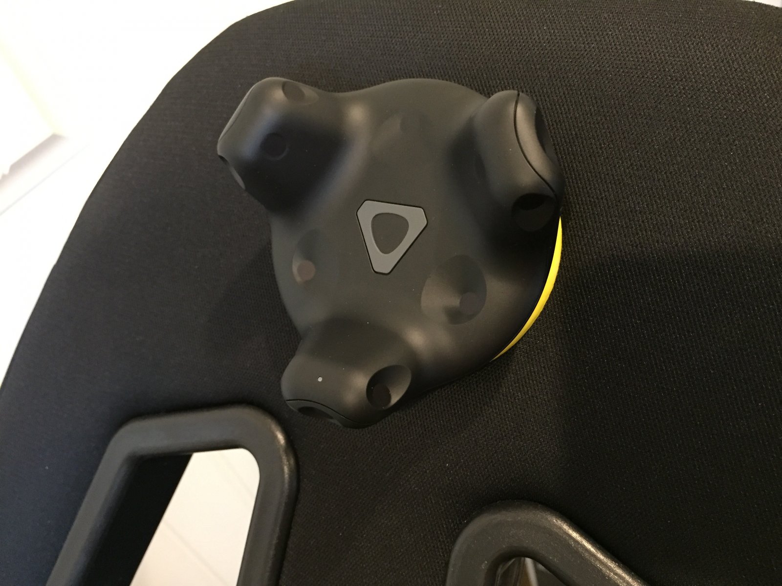

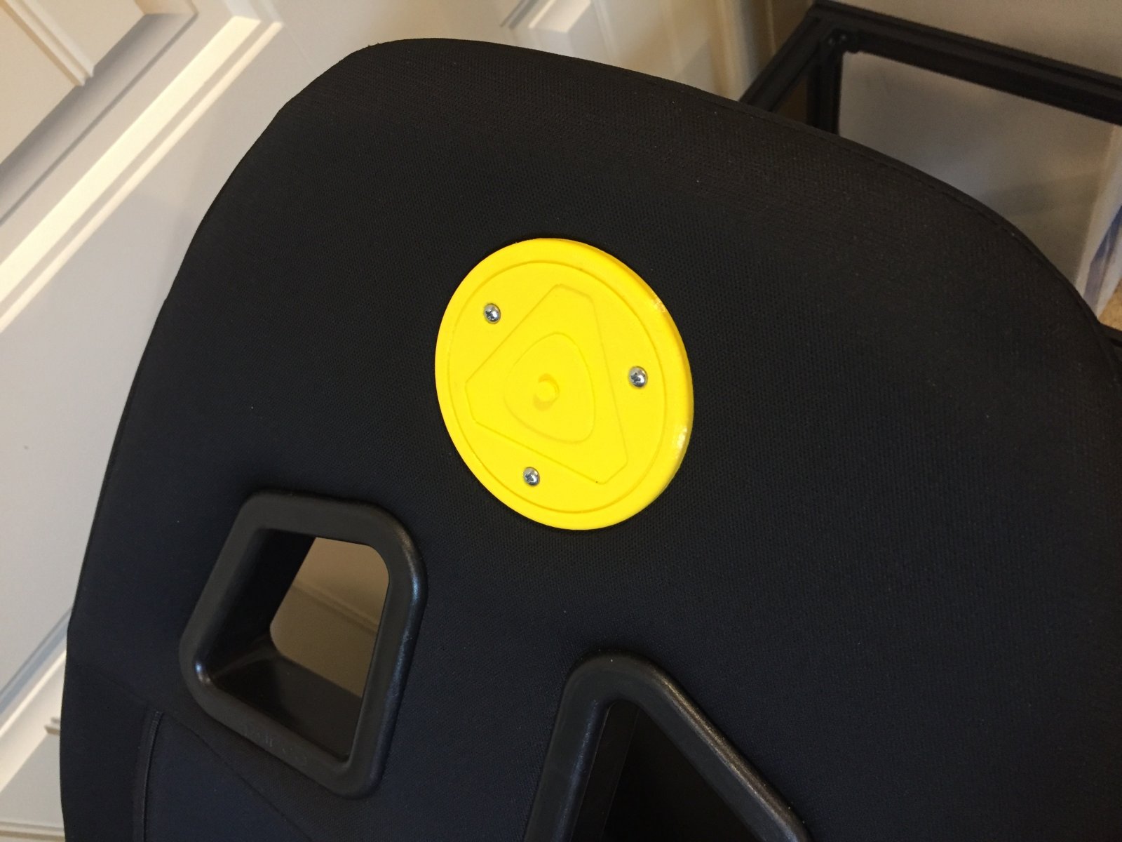

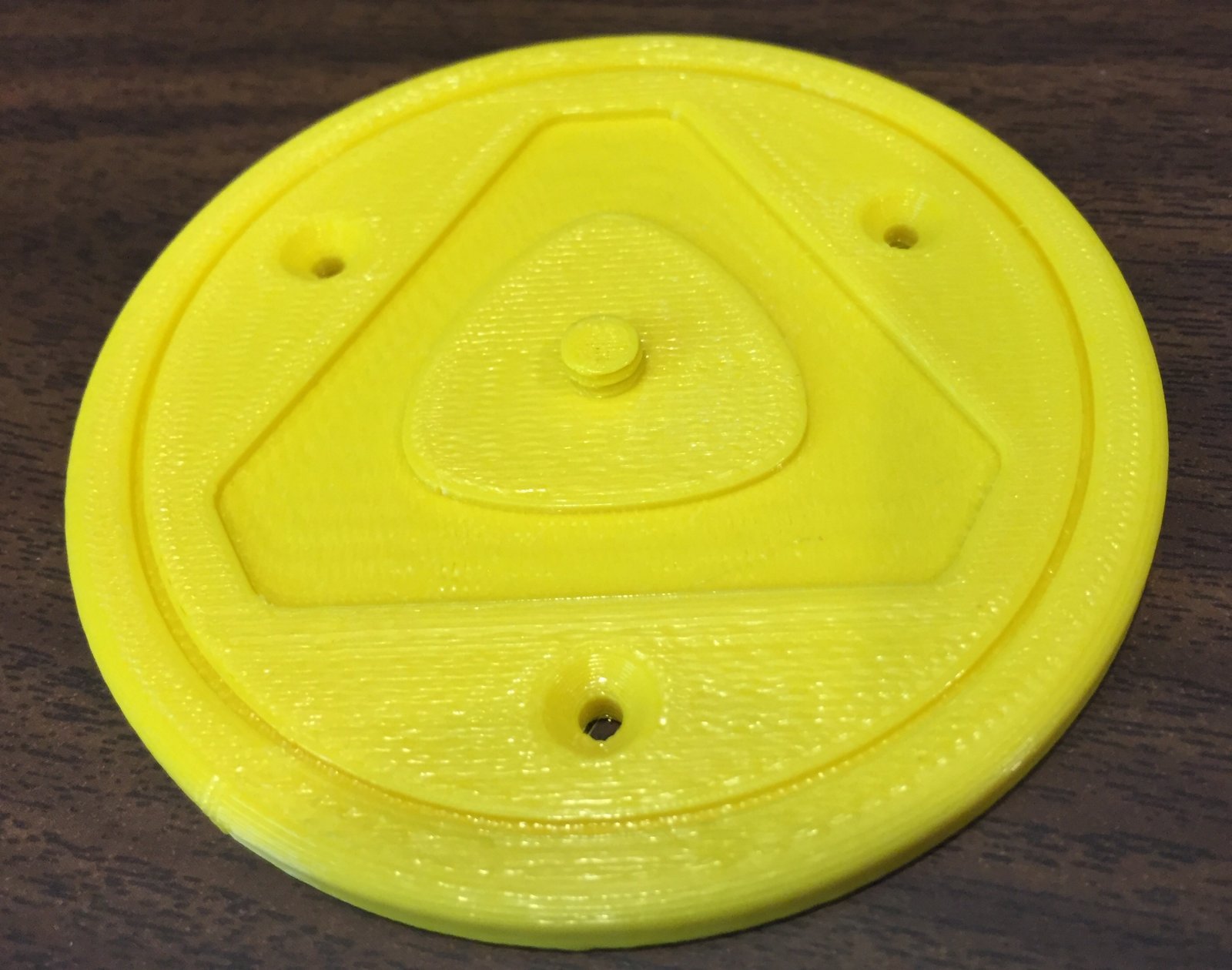

    Just putting this out there if anyone is interested. It's a mount for the Vive Tracker to affix it to a seat back or whatever.
    There are two .stl versions in the zip file - one for countersunk screws and the other with pockets for pan head screws (v.2). The way the tracker screws on, you want the screw heads to be flush or else they will mess up the foam grip.
    I didn't provide a locator pin since the tracker has to screw on instead of a screw being able to turn in from the back. The Tracker blocks access to the screws. There might be a more elegant way but this works and the gasket on the back of the Tracker provides friction to keep it from turning.
    To mount, screw the Tracker onto the mount and see where it ends up. Mark the top, take the tracker back off, and mount the plate to your chair with the mark in proper orientation. Screw the Tracker back on and you're done.

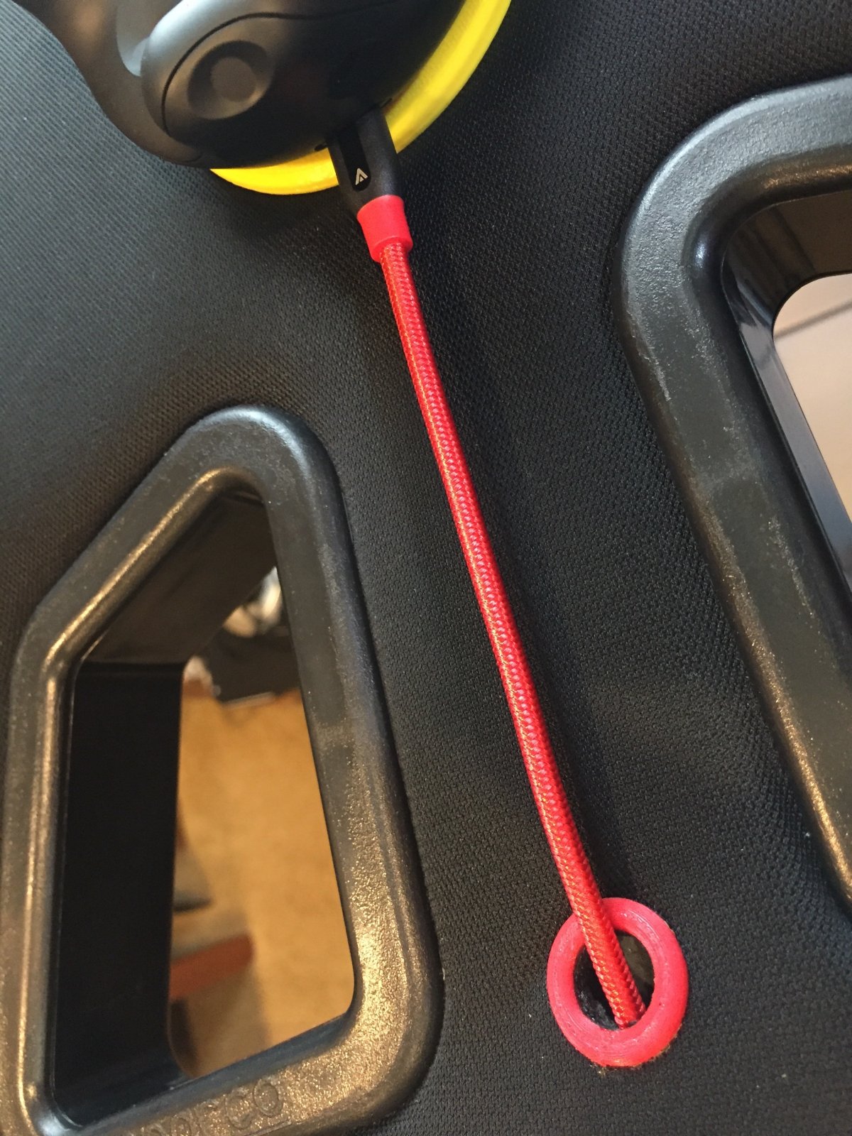

    It's wiring weekend and getting closer to motion. As I clear up all the loose ends, and related to the Tracker, I ran a micro-USB cable to it and routed the cable inside the seat. What I did was contact cement a 3D-printed, rounded-edge ring to the seat fabric where I wanted the cable to come out, cut the fabric out with a new Xacto blade for the cleanest cut, and then ran a hot soldering iron tip around the inside of the ring to seal up the fibers and melt the ring a little to the fabric. Ran the cable and here's the result. :thumbs

    I still have the bottle - DAP Weldwood Contact Cement. Amber bottle, black cap, mostly red label. Product code 70798 00105.
    For the ring I would bet any plastic ring the proper size would work. You can gently sand the profile to where it's a half-circle so you get good bonding area. And a soldering iron or similar would melt most plastics just fine. It has worked perfectly to keep any threads from coming loose and dresses the hole nicely.
    But I used contact cement only on the ring where the USB cable exits the seat fabric. The Tracker mount itself screws onto the back of the chair or any convenient place. It needs to be rigidly mounted to the chair to track properly. It's also just a 1/4-20 stud. You can do this many ways without a 3D printer.
    Lots of communities have continuing education classes at community colleges and such where you can print things. Some libraries also have printers available.

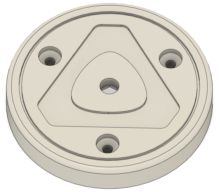

    If you can specify, it's small enough I would have them print it solid just to get maximum strength in the stud if you stay with 3D printing this. What would have been better is to allow a short 1/4-20 bolt to come in from the back side that would be trapped between the plate and the chair back. That way the stud would be metal instead of breakable plastic.
    I'll mod it real quick and put that up too...
  15. Zed
    Apr 4, 2017
    1,040
    USA
    5,847Coins
    +1,043 / 4 / -0
    @wazooda - this may be a better mount but it comes with the caveat I've not printed or tested it to fit with 1/4-20 bolts. I used a drawing for reference and added in some slop. The socket for the hex head is 7mm deep and 13.5mm from flat to flat. There is 5mm of depth used in the 7.5mm dia. cylindrical part to make it work with 1/4-20 x 0.5 long bolts. That may be a mm too thin so you may need to use a thin plastic or rubber washer or similar, or just file down your bolt a little.. I provide the dimensions I used in the drawing so you can verify bolts will fit before you print if you decide to go with a metal bolt.
    The thing is I've broken the stud on mine and had to print a replacement but it was easy for me. I was going to do this mod next time mine broke so I wouldn't have to print it again but it is untested now so it may just complicate your decision.
