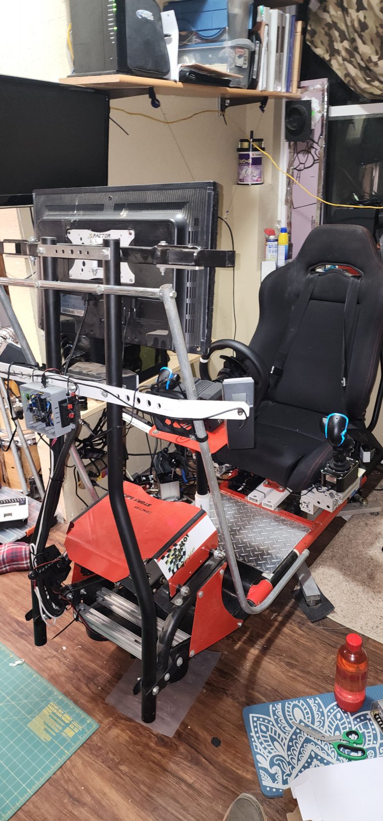

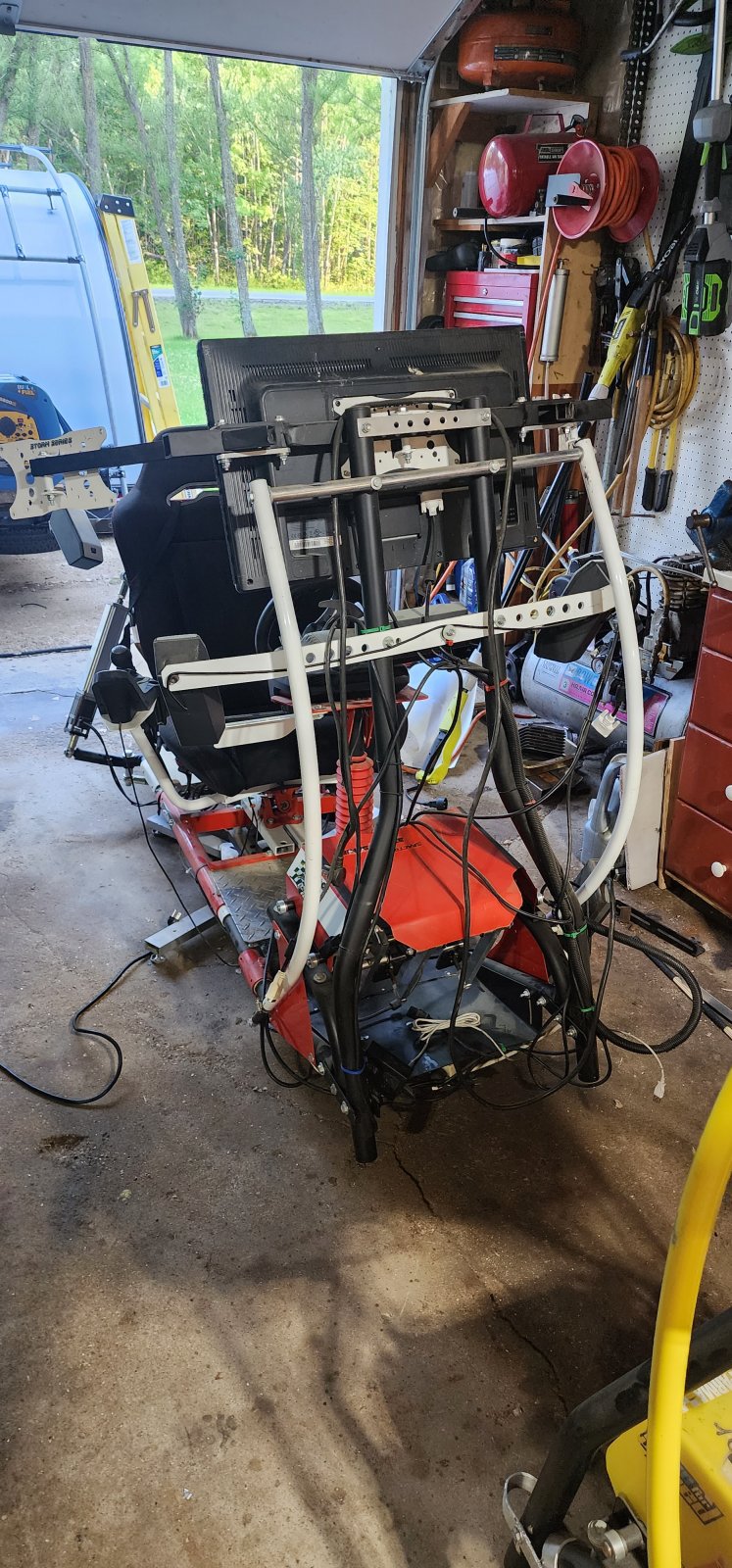

    Hello! So I purchased 2 prototype motion simulators that had been mounted in an enclosed trailed and part of a startup attemp at becoming a commercial builder. It looks like they were built around late 2011 early 2012. The computers ran windows 7, and X-sim was the software.
    My plan is to get both updated and working, and sell one to help cover the investment expense.

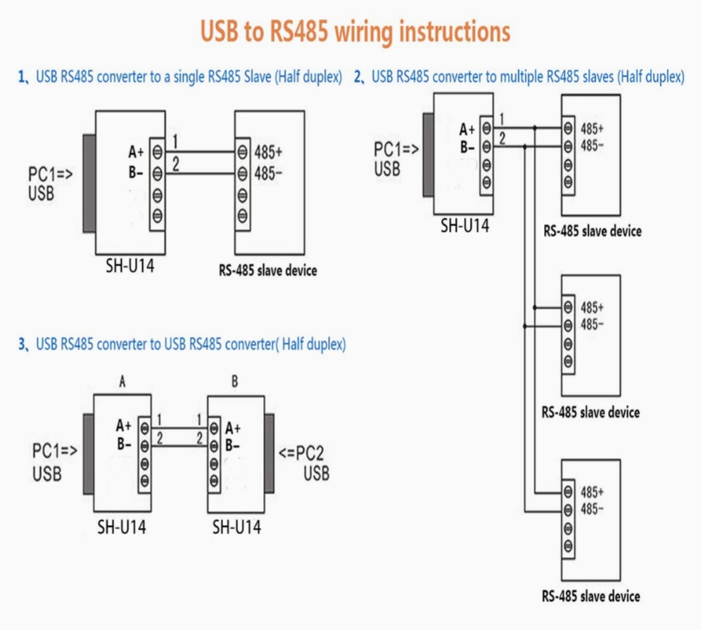

    Okay so according to the scn5 tutorial, a usb to rs485 converter gets wired up to each scn5 and this will show up as individual virtual comports in simtools which will then be configured into axis which then translated into DOF.
    The original builder wired all three scn5 into a single rs485 converter which is able to be read and configured by X-sim. Now according to the data sheets for some RS485 converters this makes sense, as you can wire up to 3 slave devices running 1/2 duplex.
    So can you run 1/2 duplex slave wiring in simtools? If so how to turn that on so it will see all three scn5. Or do I have to run 3 individual rs485 adapters on for each scn5?

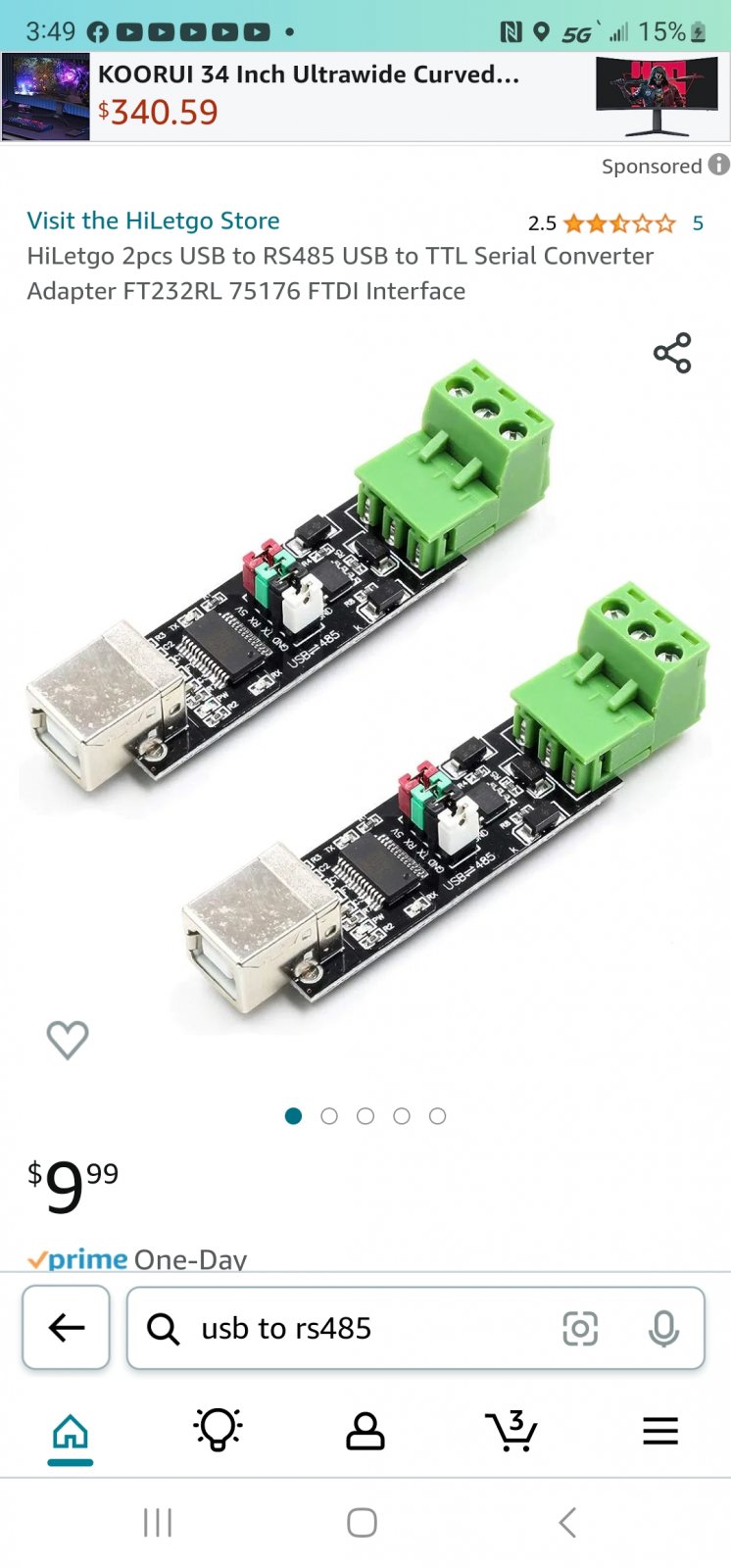

    Okay so got part of the confusion sorted. On x-sim the plug in reads the hardware ID built into each scn5, and "can be" wired together but they recommend using separate rs485 and wire them individually and separate comport for each.
    So I ordered rs485 to usb adapters and will separate them and see if that solves my problem.

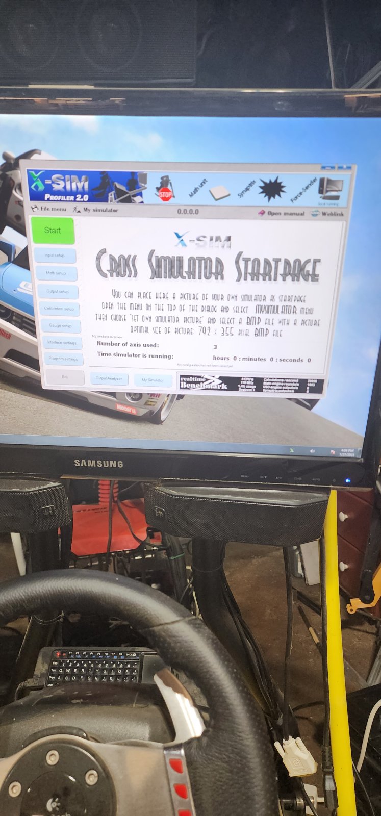

    Okay so I received the 2 additional rs485 boards and got everything reconnected. Happy to note the 2 new comports were visible, and I used the scn plugin in x-sim to change the ID# to 0 for both. When running in x-sim and wired serial each was labeled 0,1,2 so when separating them into individual comports I had to reset 1 & 2 back to both ID'S to 0
    Now when I started up simtools it properly ran each actuator through its range of motion. Yay!

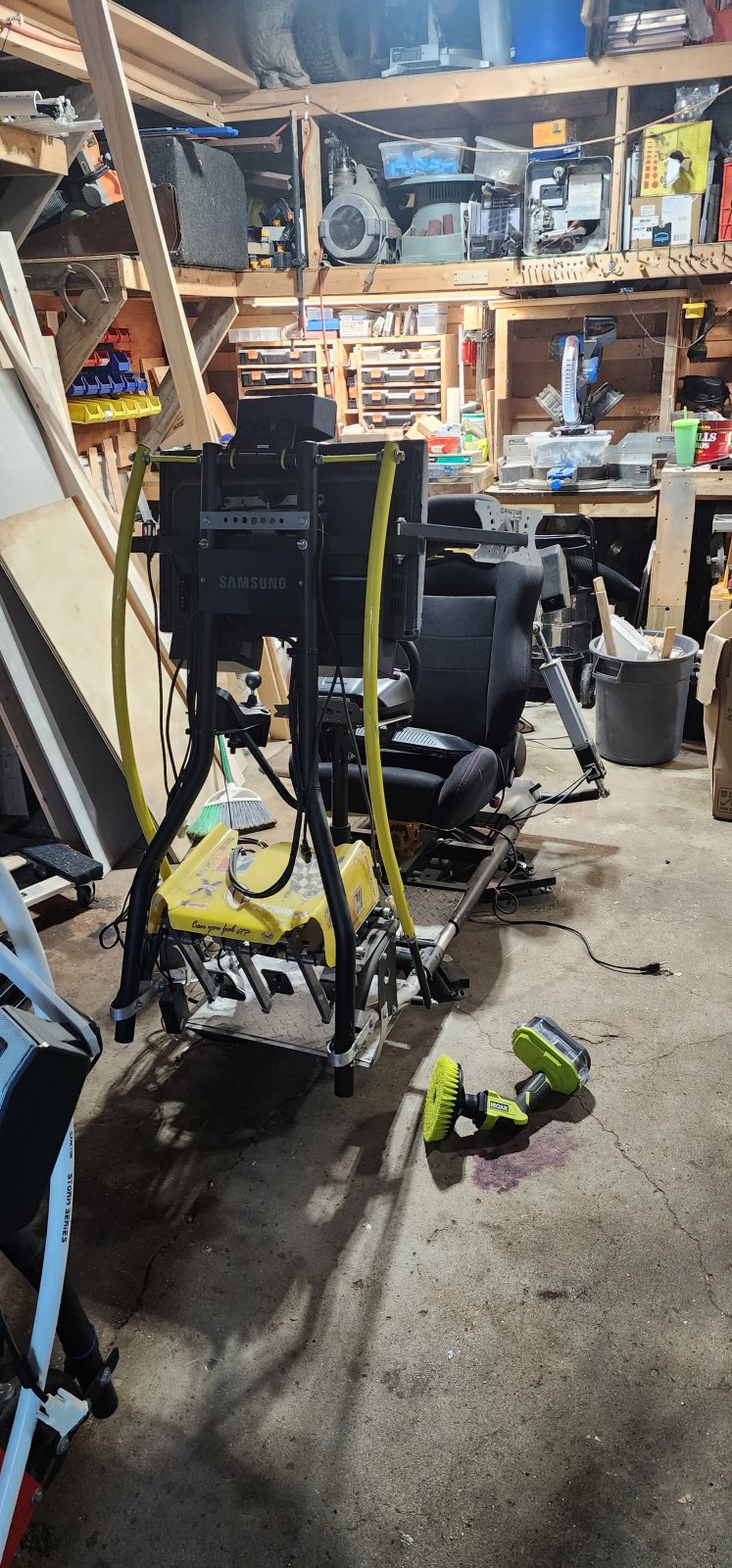

    The original names for each rig are Old Yeller (yellow accents I guess) and Big Red, for convenience I will keep that for now in reference to updates and mods.

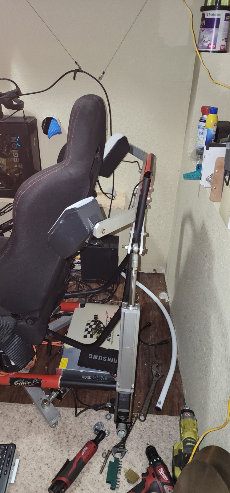

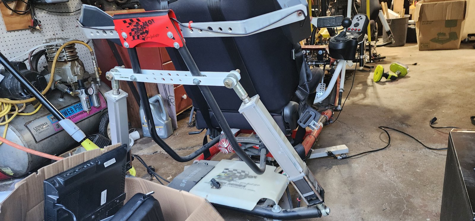

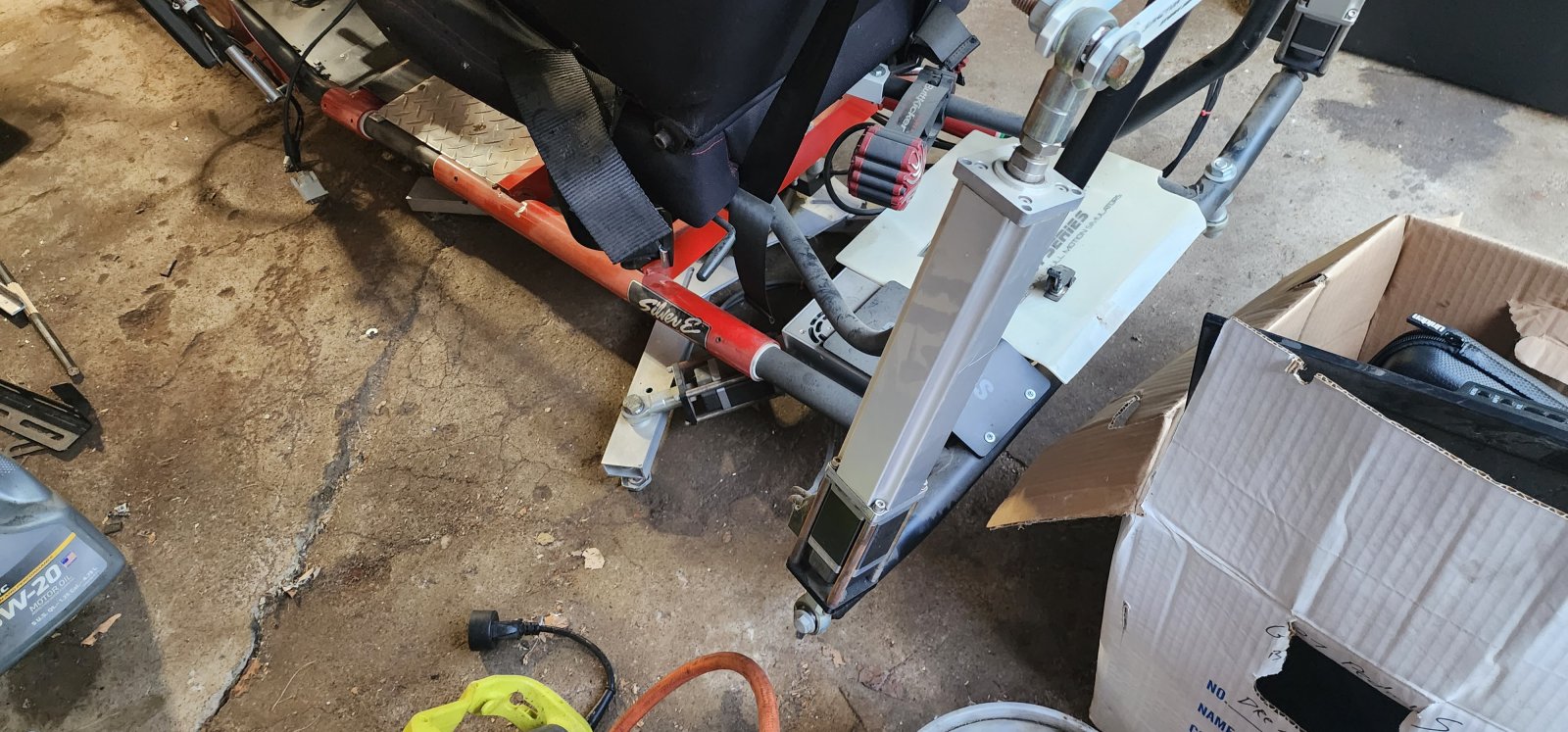

    So just wanted to post some updates and mods to my rig.
    I added rubber isolation mounts for a motorcycle gas tank on the actuators to absorb vibrations from the scn6
    Also have added wind and transducers for vibe, both run through simhub.
