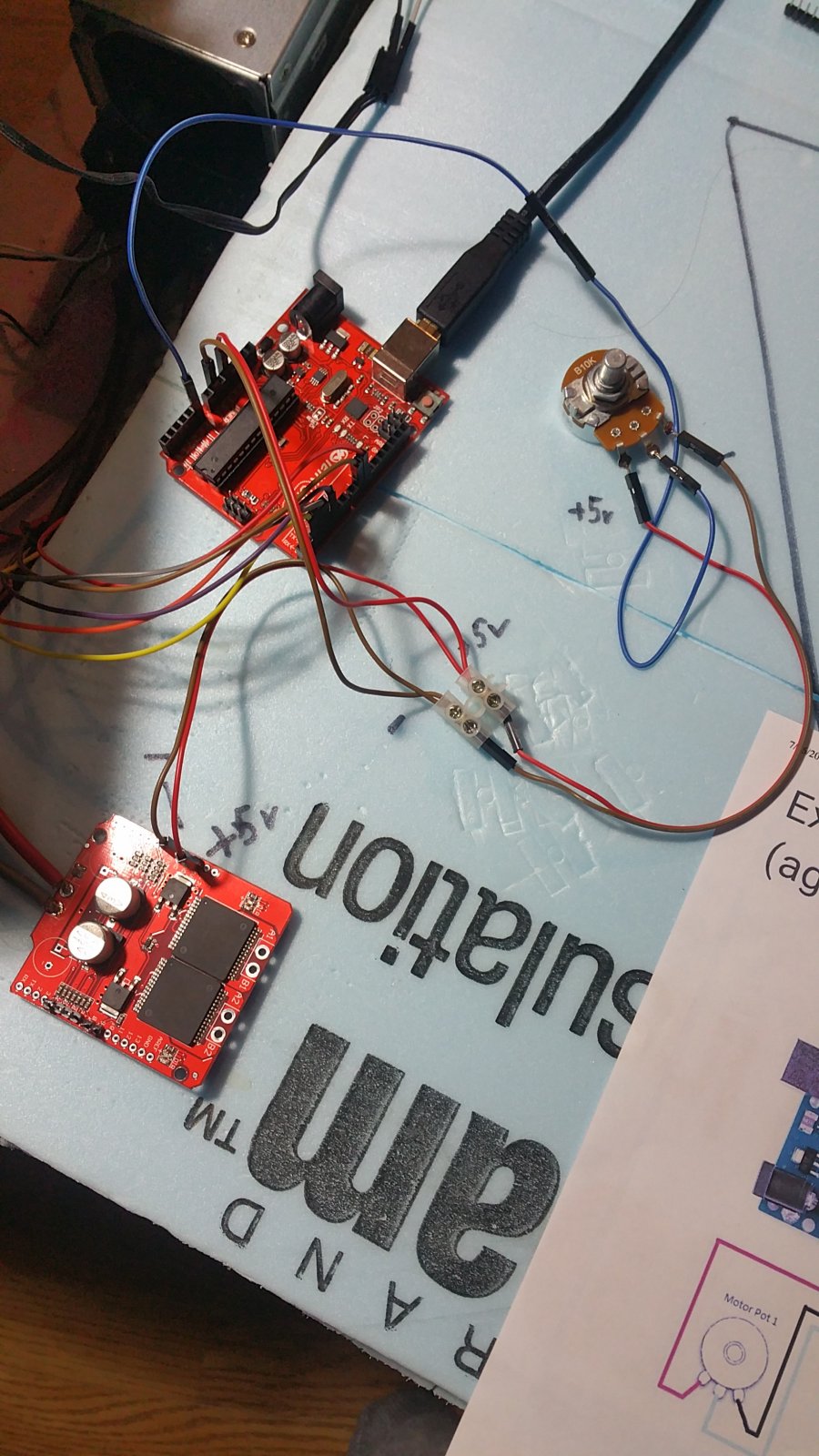

    This is my first time using arduin and mm I'm using smc3 to control as of now I've killed 2 mm just by turning the 10k pot I must be doing something wrong I did get one to read 11v on A1 to B1 but as soon as i twist pot the mm dirction light lights up and then mm dies any help would be geatly appreciated

    It is hard to say what you may have done wrong without pictures of all settings and wiring.

    Ok here's a pic of how my 10k pot is wired +5v from ard and mm to pot I'll post some more pics after we determine this is right it's kinda of hard to see with all wired thanks for help

    Hi, I don't think that the poti causes the issue. You didn't wire the control pins so the poti does nothing. There could be more reasons, first the MMs were DOA or the PSU is defective or the polarity was changed by accident.

    The other 2 mm I had them wired fully that quit
    I just wanted to show the pot wiring by itself then I will connect rest of wires befor I try it I will use another psu and snap another pic

    ok, but honestly you cannot burn the MMs on the 5V line. So the issue is somewhere else.

    I swapped psu and mm are running the only problem now is trying to find some that are not faulty out of the 2 I tried are both out putting less than 12v
    The first one was 4v on both sides and the other was 5v I have more on the way today so maybe I'll have better luck with those thanks for the help

    Obviously DOA. If you ordered from a serious vendor/dealer money is back guaranteed.
