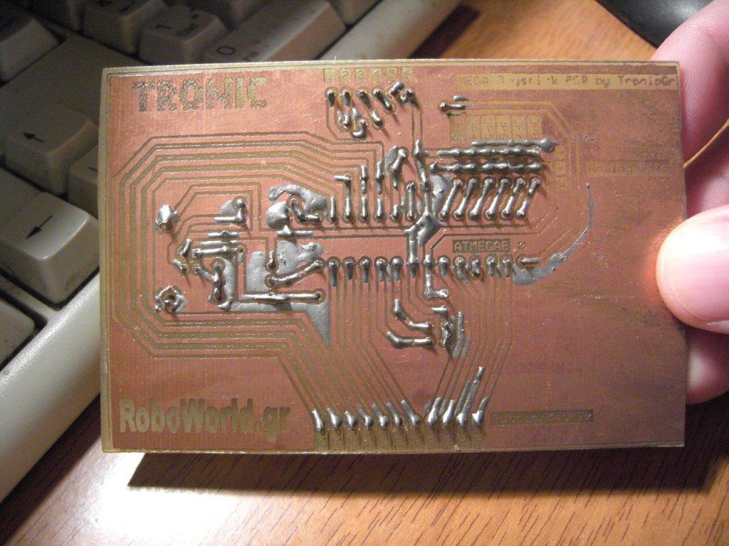

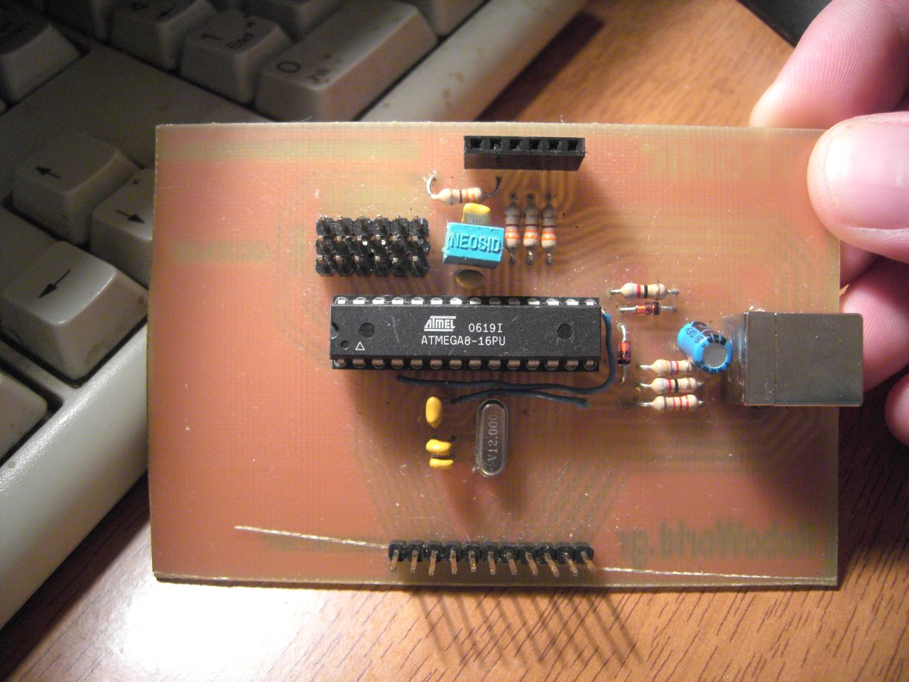

    Hi everyone,
    I wanted to present you an older project I was playing with.

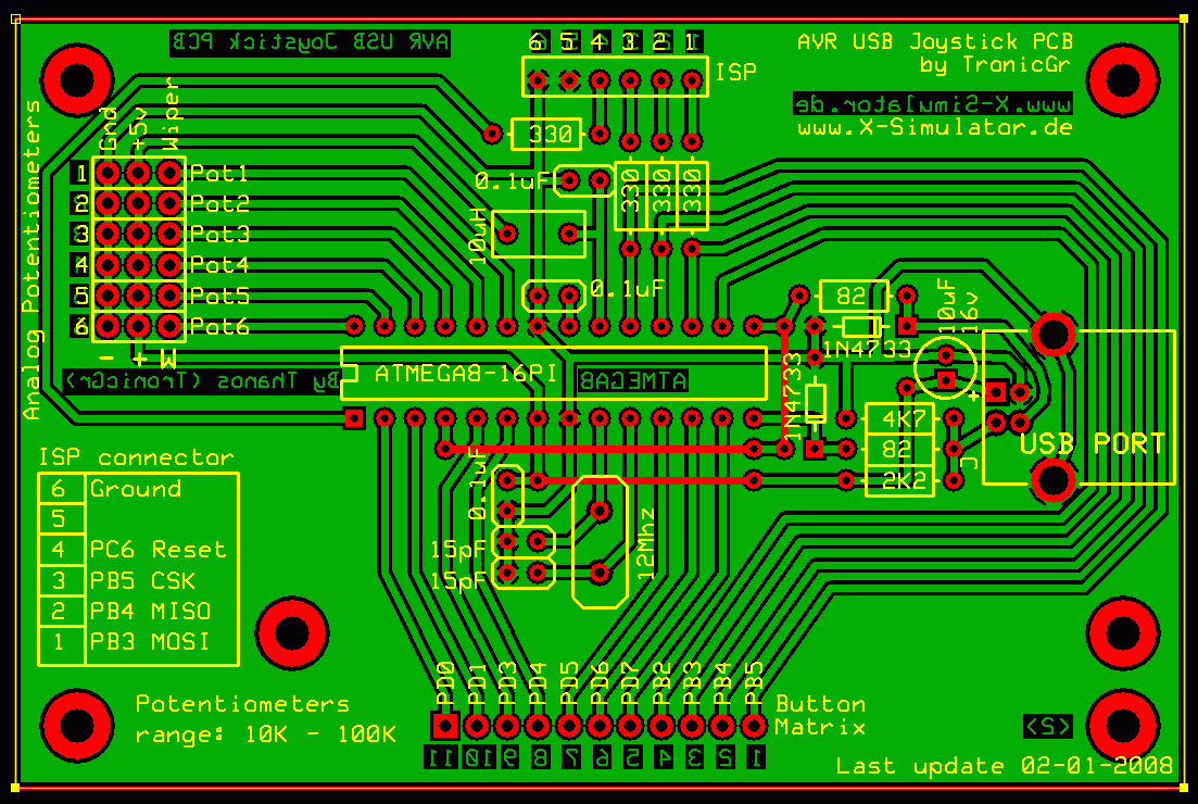

    An AVR USB Joystick! It has 6 axis that you can add potetiometers and 24 buttons, enouph to create a small aircraft panel. Its axis assignments are as follow: X, Y, Rudder, Throttle, Z, Rx
    Mjoy_AVR_USB_Joystick.pdf
    Although its designed to work with flight sim vehicles, you can attach those axis to a car sim controls to have a complete set: Wheel, full set of pedals, including clutch, even an analog handbrake if you like! And if you already have a force feedback wheel you can just make the rest of the controls custom.

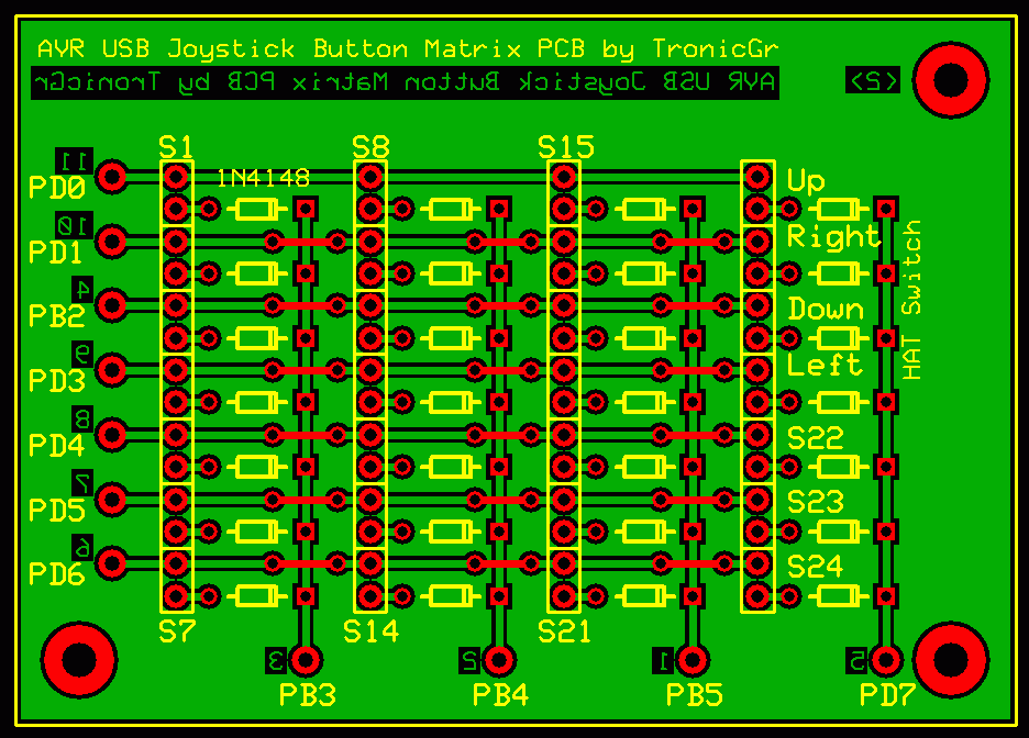

    I designed the PCB layout for this joystick along with a second smaller PCB that has the button matrix connections for the 24 buttons. The button matrix PCB can be mounted on top of the main PCB for saving space. You can use simple wires to connect the two boards as their ports are numbered!
    I was made prototype PCB based on it last year that I was intended to use to add custom flight simulator controls to my Joyrider but lack of time let me add it only on the rudders.
    I didin't programmed it, its programmed by Mindaugas Milasauskas, before some years now but he seems to be dissappeared along with his site.
    Another variation of this (SMT compoments) exists here:
    http://www.mictronics.de/?page=avr_usb_joystick

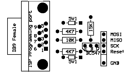

    Here is the Firmware for the ATMega8 chip that you can program it with PonyProg using the ISP serial port of my AVR Motion controller! To power it while programming, just plug it on a USB port!
    mjoy1_2.zip
    If you like to have the source code in assembly to see how it works or modify it, contact me PM.
    Regards, Thanos

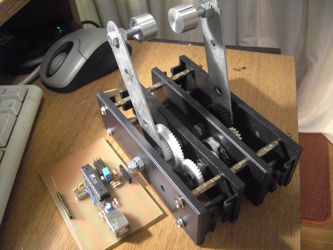

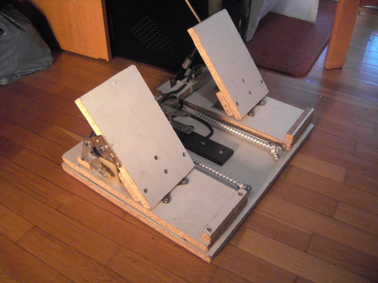

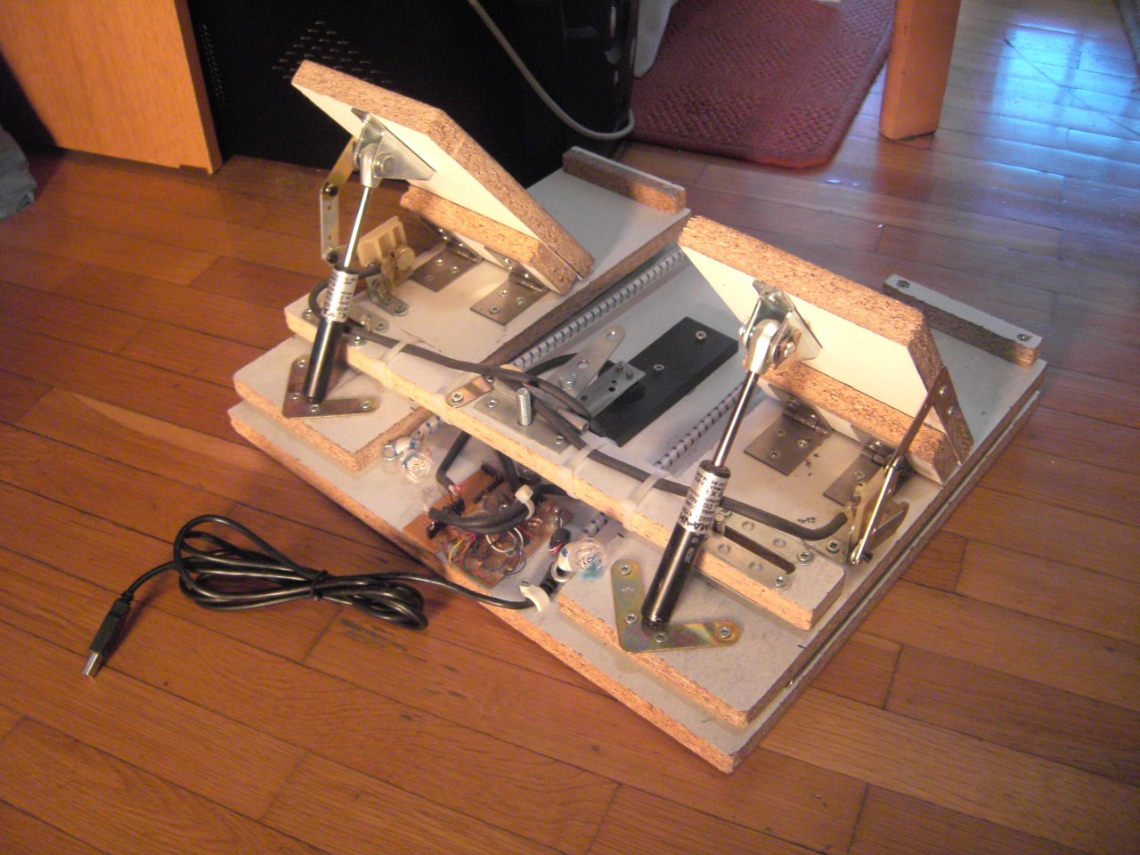

    Yes, I still use this Mjoy16 controller! Its awesome device to have analog an digital inputs from it and you can use it to create your own custom made joystick controller device! I used it on my pedals (shown above) but it can be used also to make wheel and stick yoke and any other kind of controller yourself! Or to make a cockpit panel with buttons and radio controls!
    Anyway, imagination is the limit to the uses of it. I'd recommend you, to use this, as it's more that enough for most applications!

    I build two pieces of yours Mjoy but i cant program them :( . I use guide from here http://www.powernet.pl/~krzysiek/elektr ... mjoy16.htm (i try setup Atmega8 and 16) but i get same message if i try read flash : device missing or not found (-24) (on both). I check all routes to atmega and lpt cable.LPT port working (i have 7seg. and speedometer on it and they react). I not sure only with crystal i used http://www.gme.cz/cz/index.php?page=pro ... il=131-074 . Have you any idea what could be wrong ?
  11. tronicgr
    tronicgr
    Hi Mambo,
    LPT cable is not very reliable way. Never worked for me!
    You have to plug the device in a USB port to feed it with +5v power before using the onboard ISP port!!! Then you can use a simple serial programmer circuit from ponyprog or something like this:
    http://cgi.ebay.co.uk/Mini-ATMEL-AVR-AV ... .m14.l1318
    It can be also programmed by using the onboard ISP programmer circuit from my AMC1.5!!!! ;)
    Regards, Thanos

    Well now i know why it dont work with LPT :yes: , you have switch MOSI and MISO on page 8. Now i program it but after i plugin to USB it found unknown device :( Shout be potenciometrs connect ?
  15. tronicgr
    tronicgr

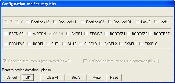

    No potentiometers are needed for the first connection... But it seems to me that you haven't programmed the Fusebits in order to work with the 12Mhz clock that is needed for the USB communication.
    Thanos

    So some progress, i found that on my old pc it works, on new one unknown device
    old pc: xp SP2 without updates, never connect another USB device, USB 1
    new pc: xp sp2 with updates, before mjoy there was conncet DFP and log. force 3D, USB 2
    Fusebits are programed well.
    EDIT: looks like that i use zen. diodes 1N4733A witch are 5,1V
    one friend notice that diode on D- line shout be before resistor 88R

    On the keyboard matrix, the HAT connectors are on the opposite end of the row that is marked at the hat connectors.
