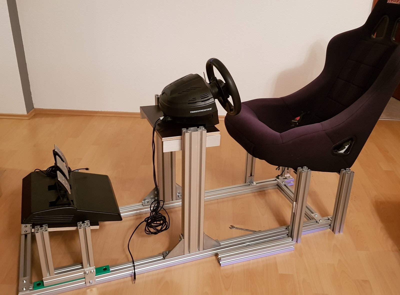

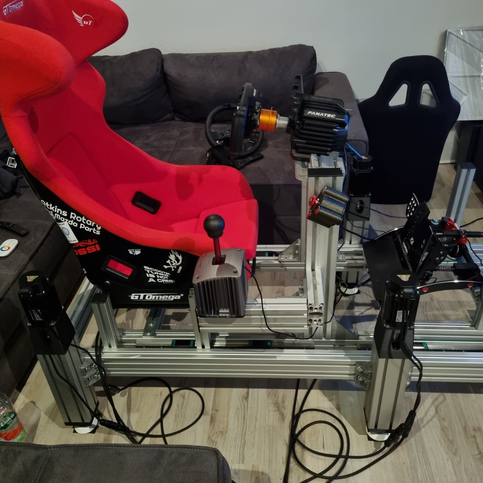

    I decided to build a fullmotion setup about two weeks ago. So far exclusively for racing like ACC, GT7 or iRacing in the future.
    Almost 10 years ago I welded a simrig out of steel tubes for two friends. I only fulfilled my wish at the end of 2018. As I worked a lot with Bosch profiles in my job and I attach great importance to flexibility, the decision was quickly made.
    At that time with Thrustmaster T300 and after few weeks with many mods, later with Loadcell pedals and Shifter.

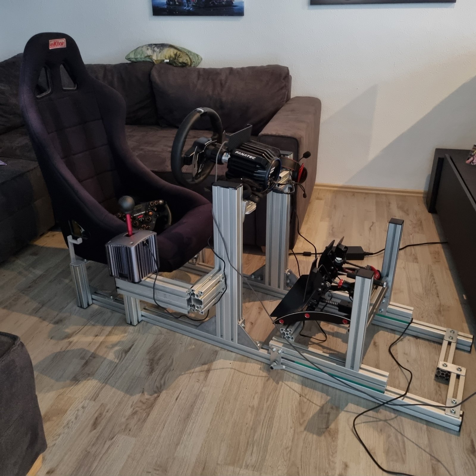

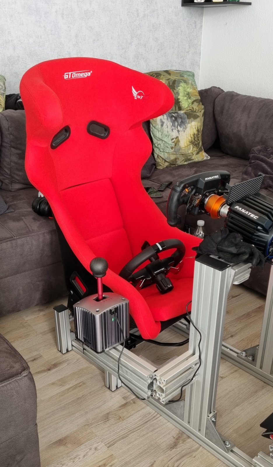

    Switched few years later to Fanatec and have designed extra holders for the base 20240213_173818.jpg

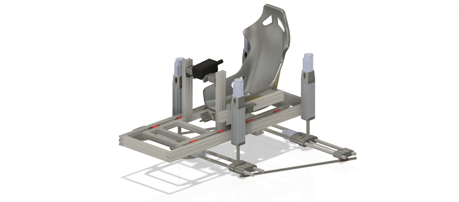

    After all the research, I liked designs that didn't sit too high and didn't take up too much space. I also think that most rigs are completely overengineered. Since I already have a rig made from Bosch profiles and I still absolutely love it, I wanted to continue using it and create everything based on it.
    That's how I came across the SFX100 components, which are also very good value for money. When searching for all the components, however, I realized that there is no 100x100 ITEM profile in Germany. So I looked for the 90x90, checked it out, found out that nothing would fit and then redesigned everything last Saturday.

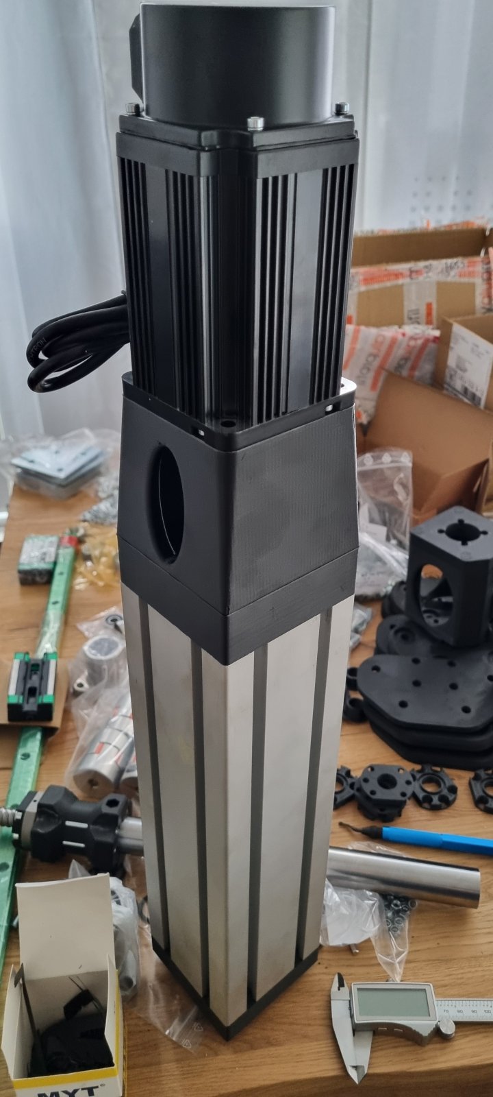

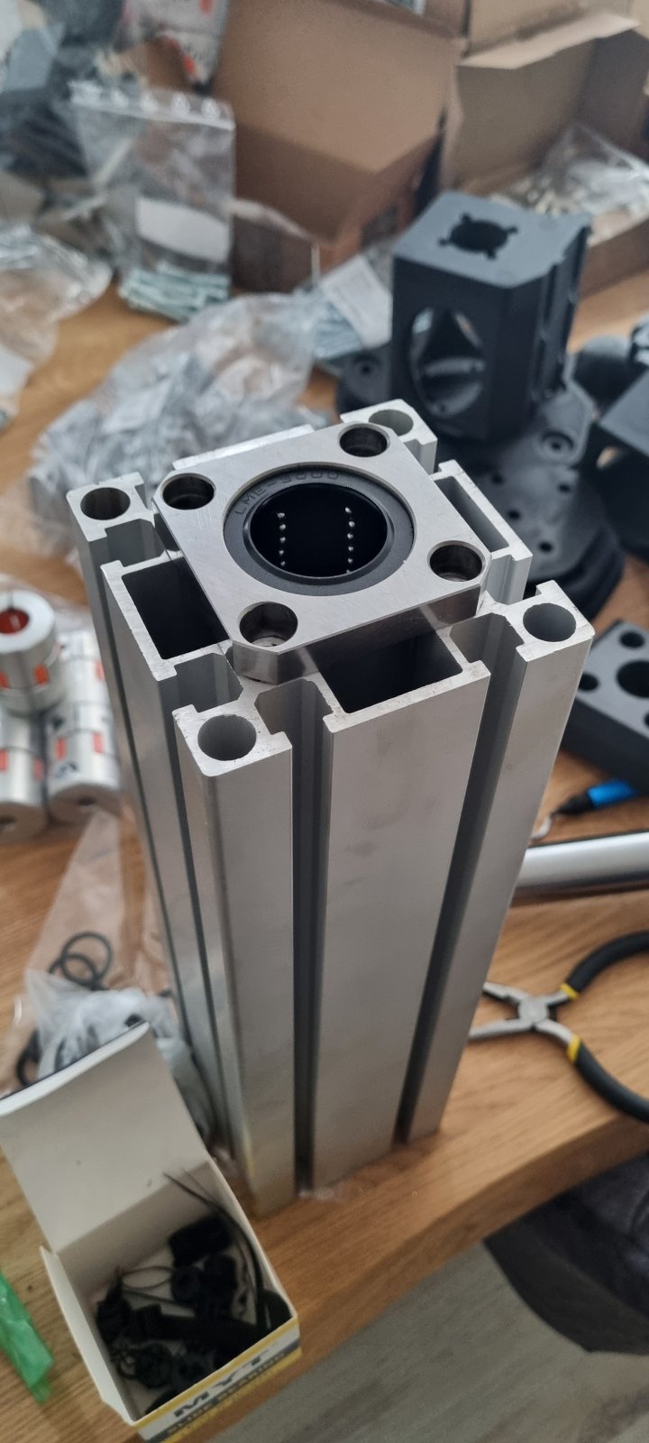

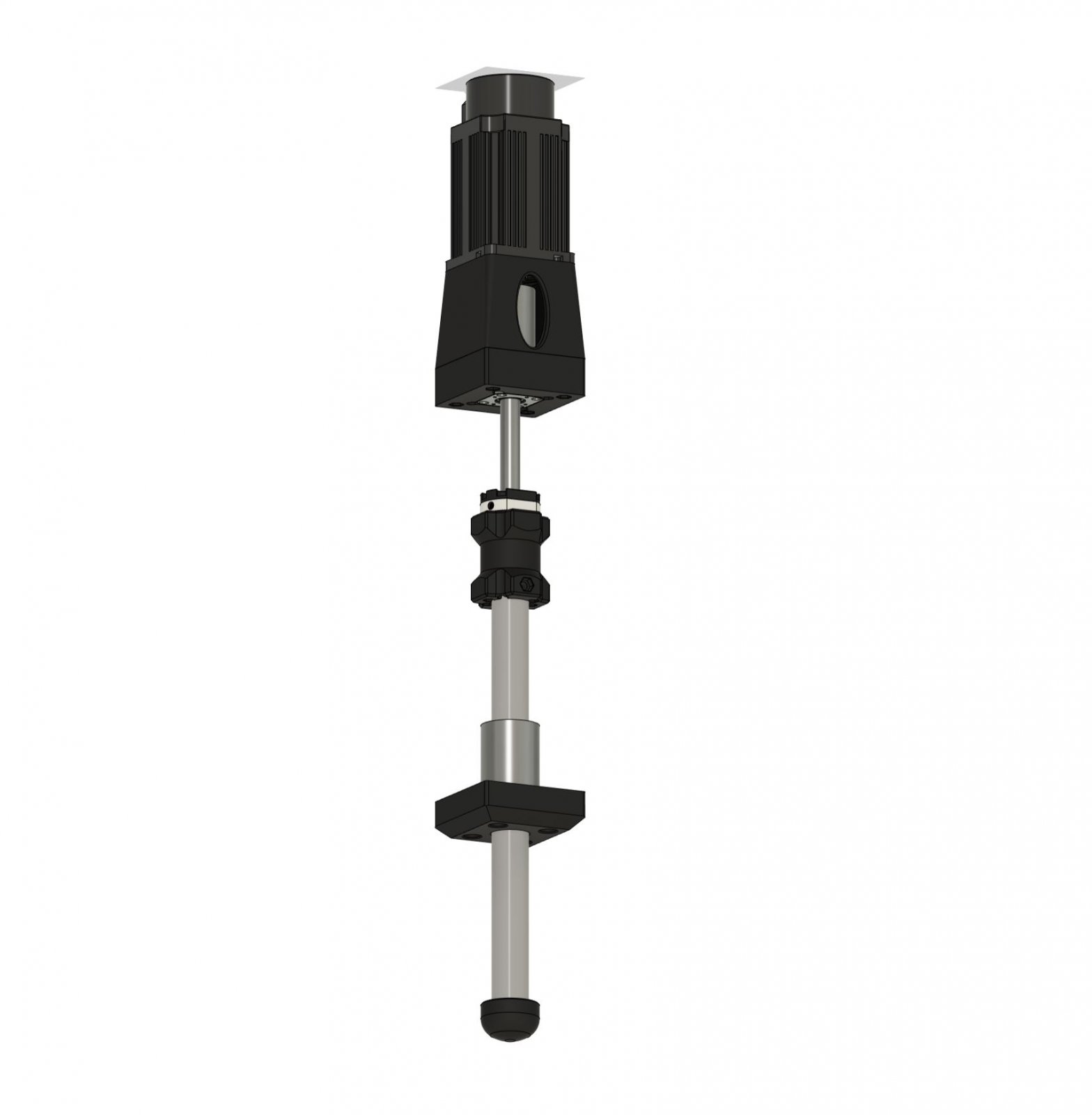

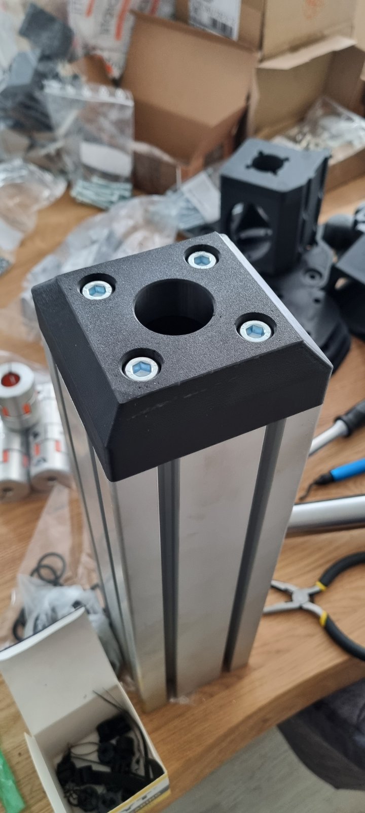

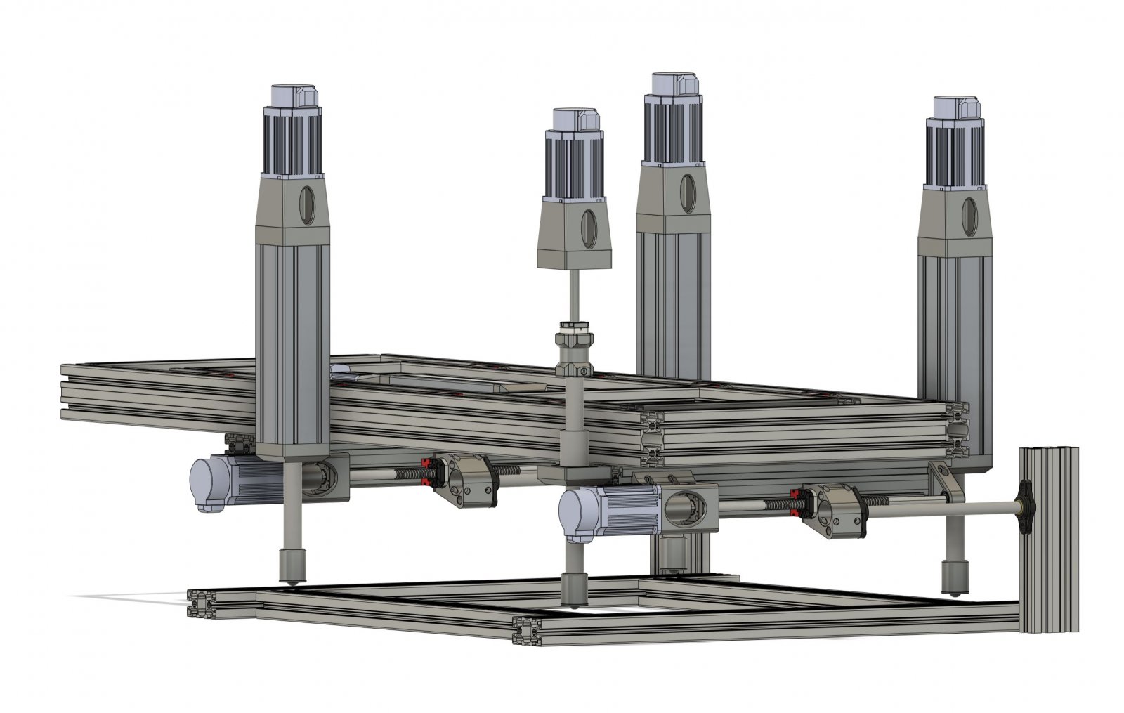

    The actuator is based on a 90x90 ITEM profile with an 80ST motor, other components are almost the same, but the design is different to the SFX100 system. The actuator has 175mm stroke.

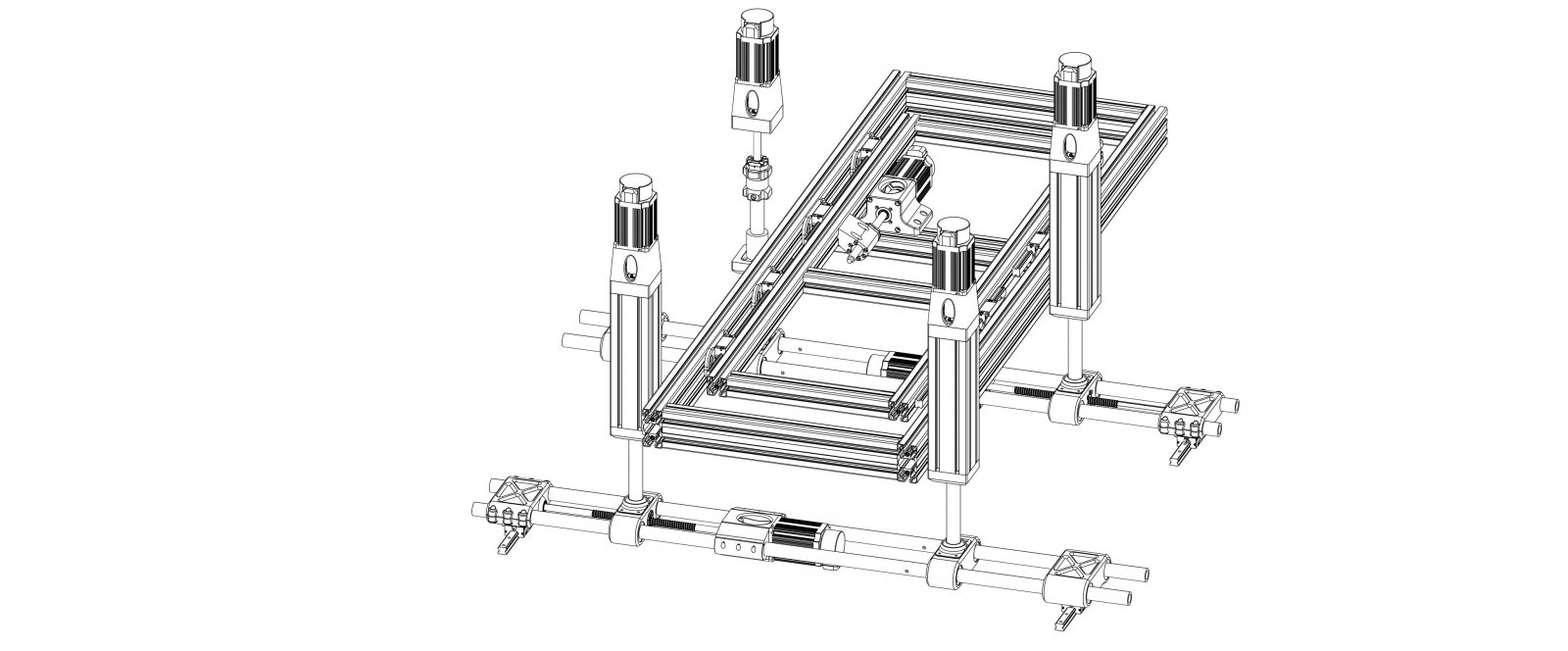

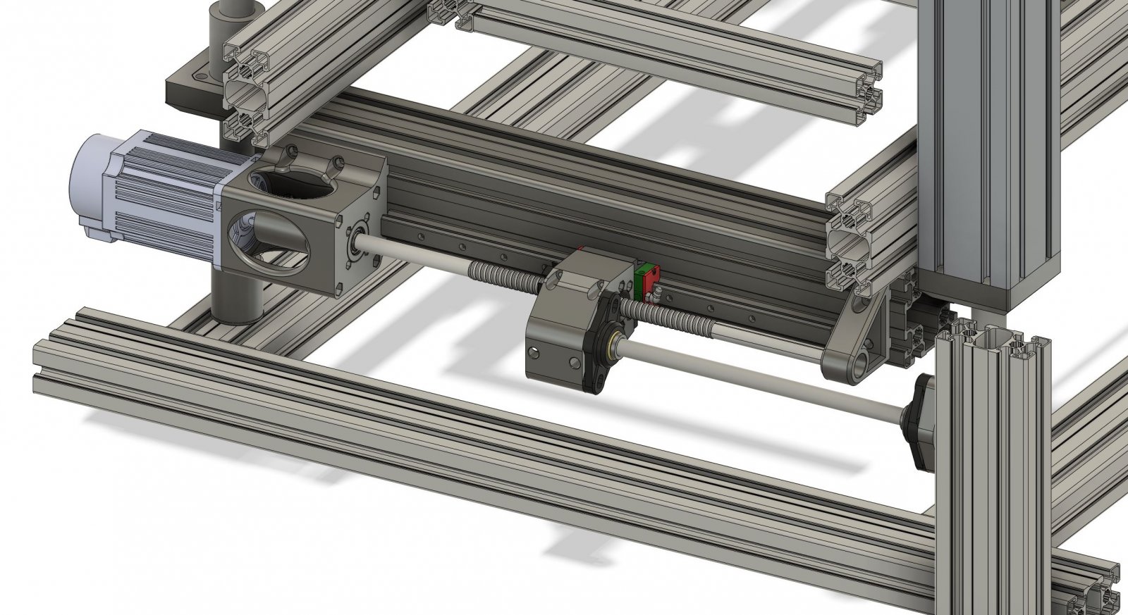

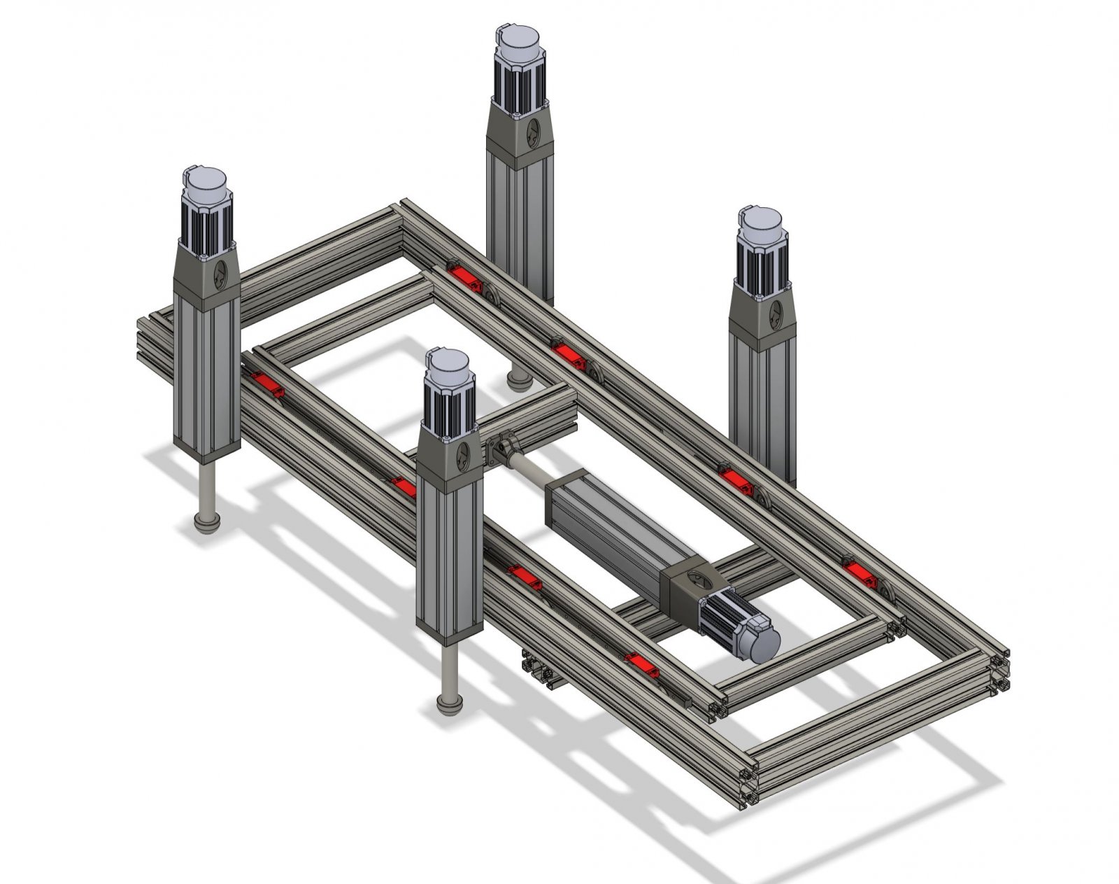

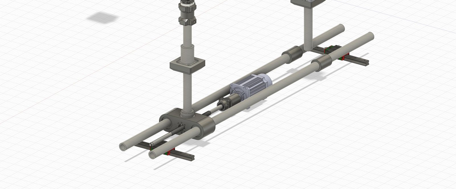

    I also want to integrate a surge system right away, which I designed yesterday. Simrig+Surge.JPG
    I have intentionally left out all brackets and fastening elements in the design that I do not design myself.
    Current dimensions 1.8m x 0.9m
    At the moment I am trying out double traction loss, but I don't have a finished design yet and am currently testing which one I like visually, isn't too high and at the same time is simple and easy to implement. I will submit pictures in the next few days.

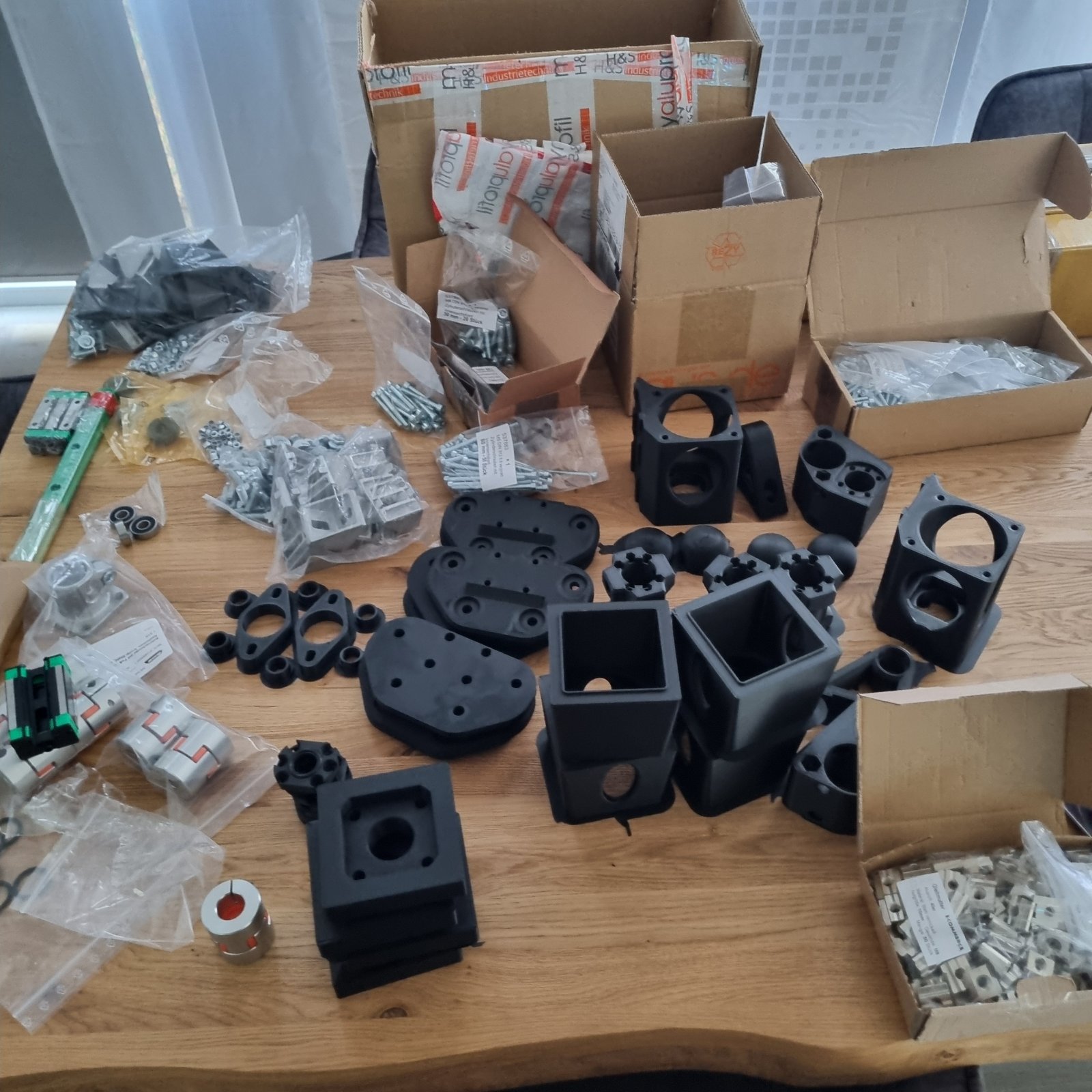

    Most of the parts have been ordered in the meantime and are arriving daily. The parts that have already been designed are already being 3D printed. Depending on the intended use, initially in PLA or PETG.

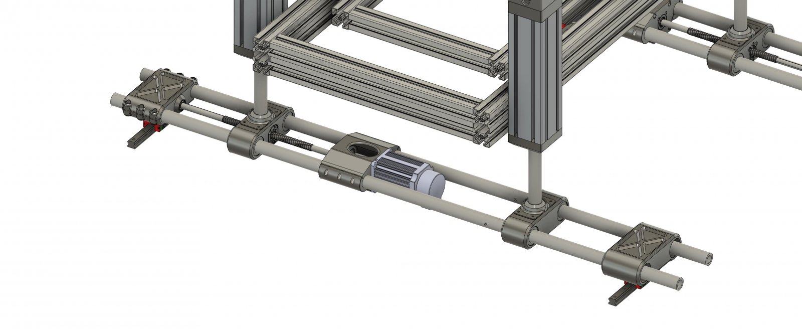

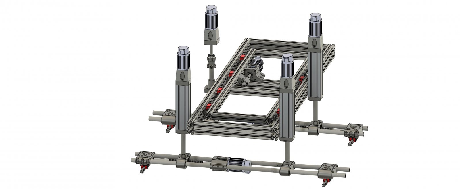

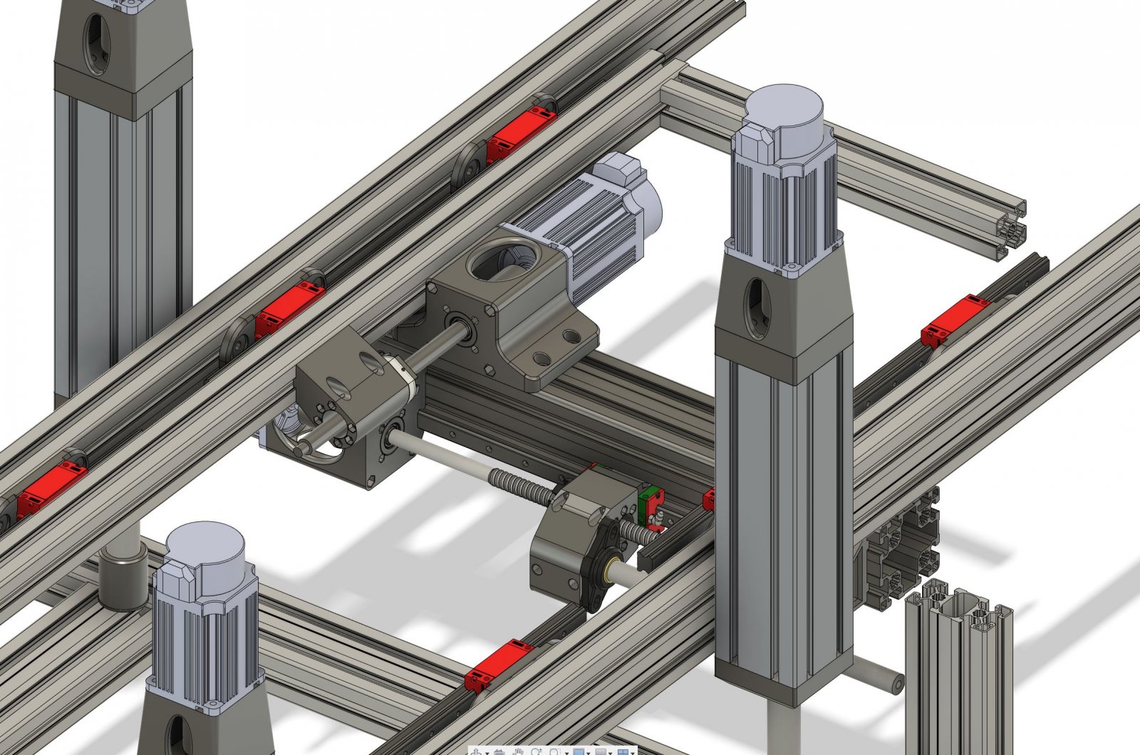

    Spent a lot of time over the last few days building tractionloss front and rear, unfortunately never with a result I was really happy with.
    The vertical actuators will have SP22 ball rollers. They will be placed on 3mm steel plates (currently not on pictures of the construction)
    The front shaft of the tractionloss will have a hinge on the outside to hold the frame in position. Two flange bearings at the rear.
    The stroke of the Tractionloss is 180 mm in both directions. Not yet completely finished, but the basic concept is ready. I am always open to ideas and suggestions.

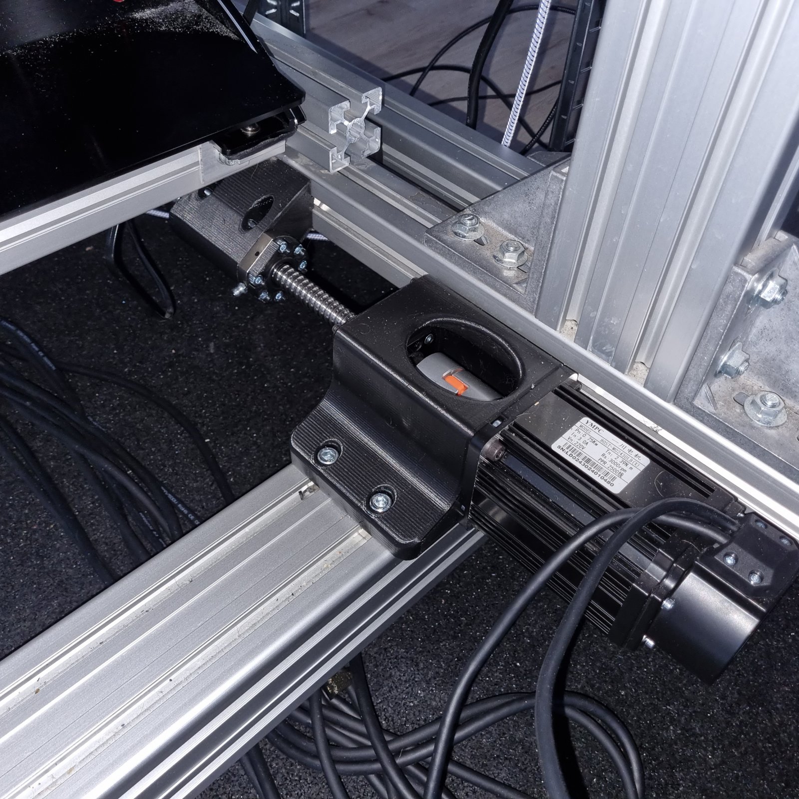

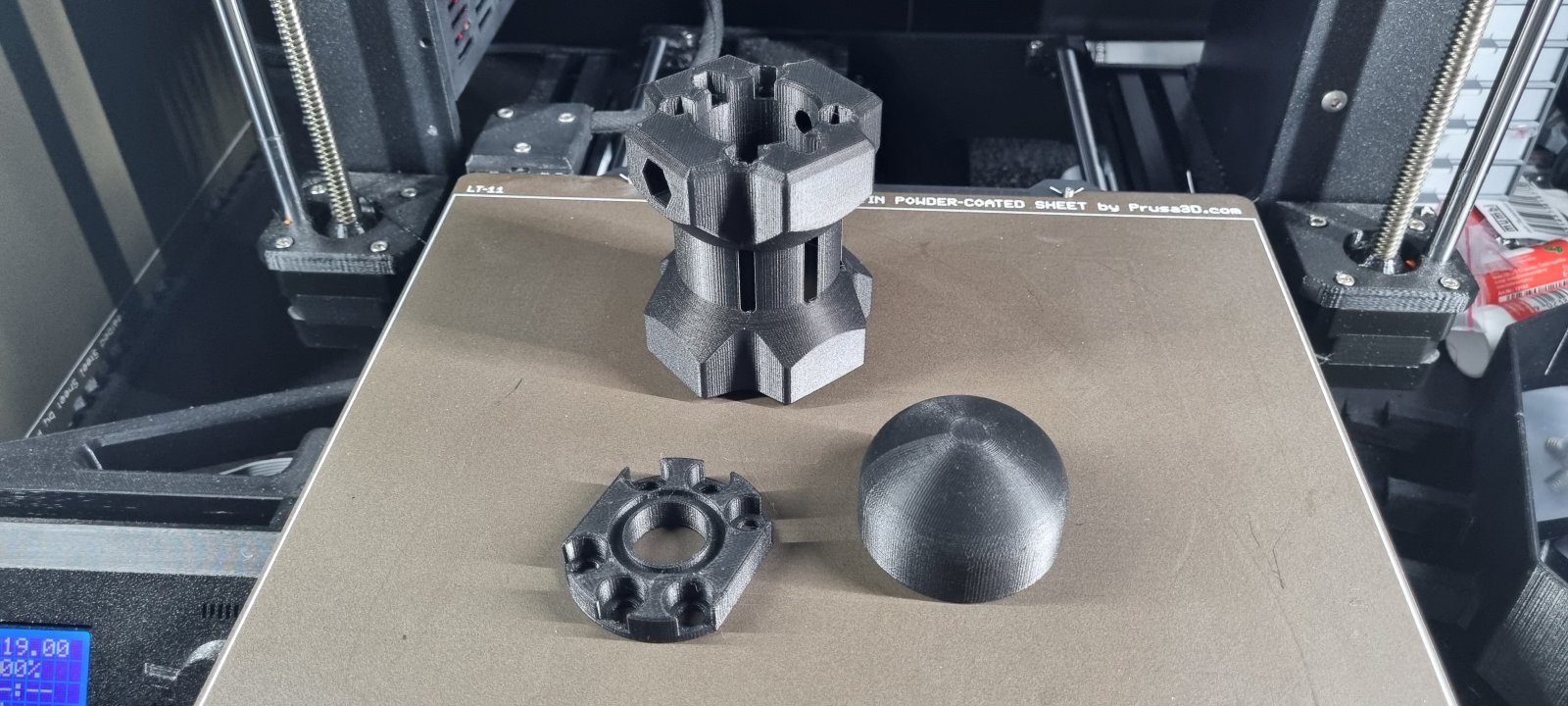

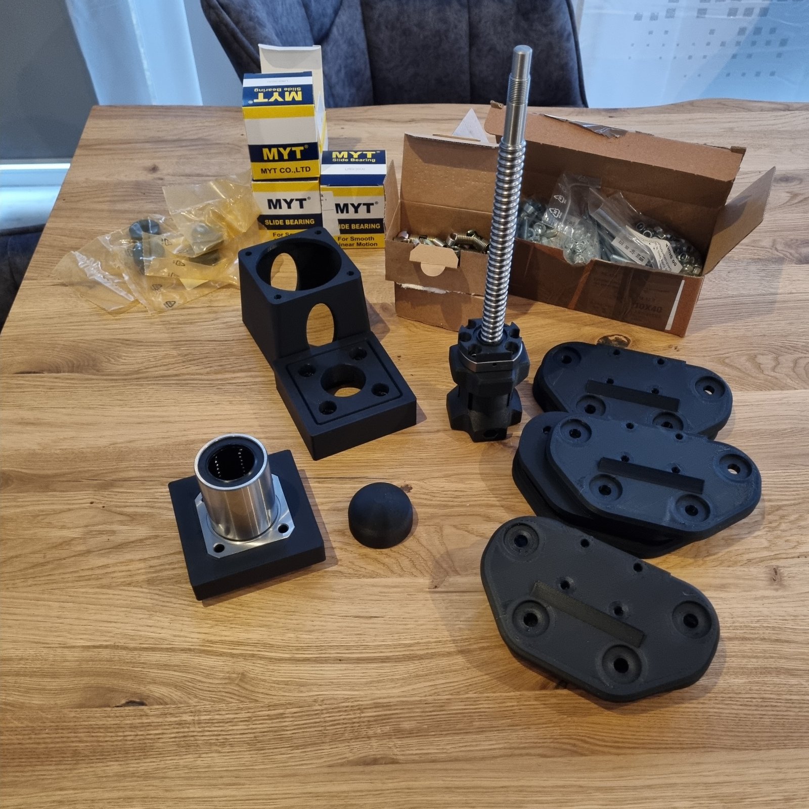

    More and more parts arrived and almost all print parts are done.
    Since I want to have the complete load on the aluminum profile and not on the 3D-printed parts, I drilled out the linear bearings with an 11mm hole to be able to screw them directly to the profile or to transfer all forces directly to the profile. This also gives a much cleaner look. This also gives a much cleaner look. 20240302_103310.jpg 20240302_103424.jpg
    As the existing bucket seat was already very old, I decided to go for something new
    Surge and Tractionloss are now also fully constructed. The last parts for this are currently being printed Unbenannt.JPG Tractionloss Fusion.JPG
    I'm currently waiting for the FK12 fixed bearings and the DOF MagicBox before I can start the final assembly. But that's not so bad as I'm currently very busy at work and I'm also moving my workshop.

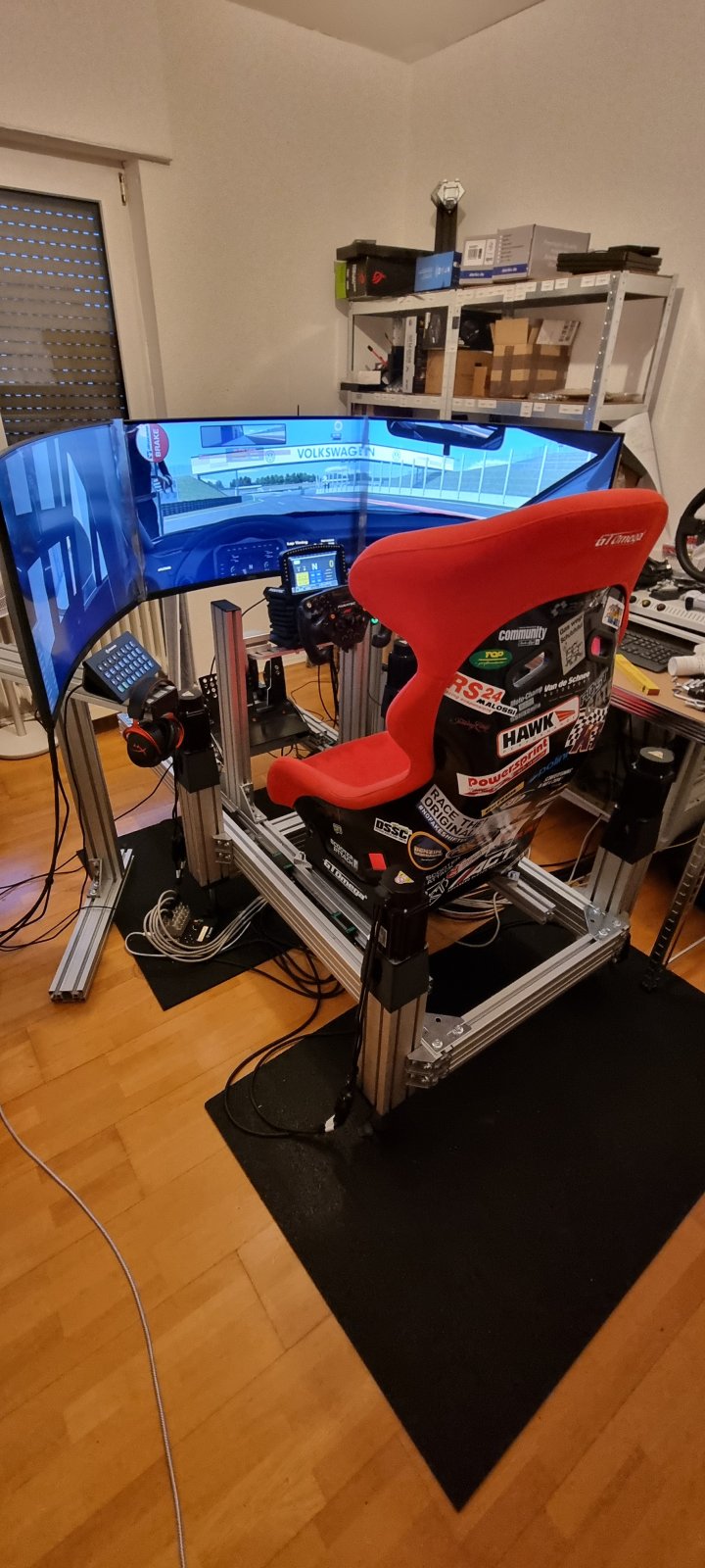

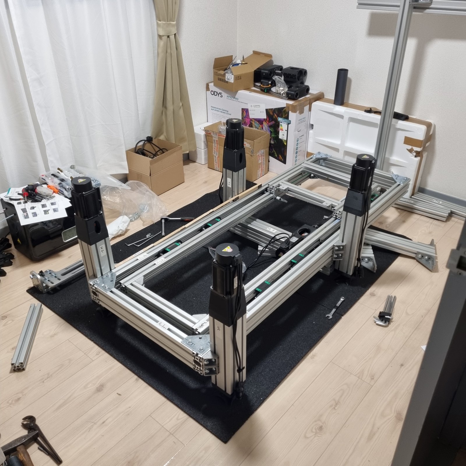

    The last parts arrived and had spent some time the last days to put the puzzle together.

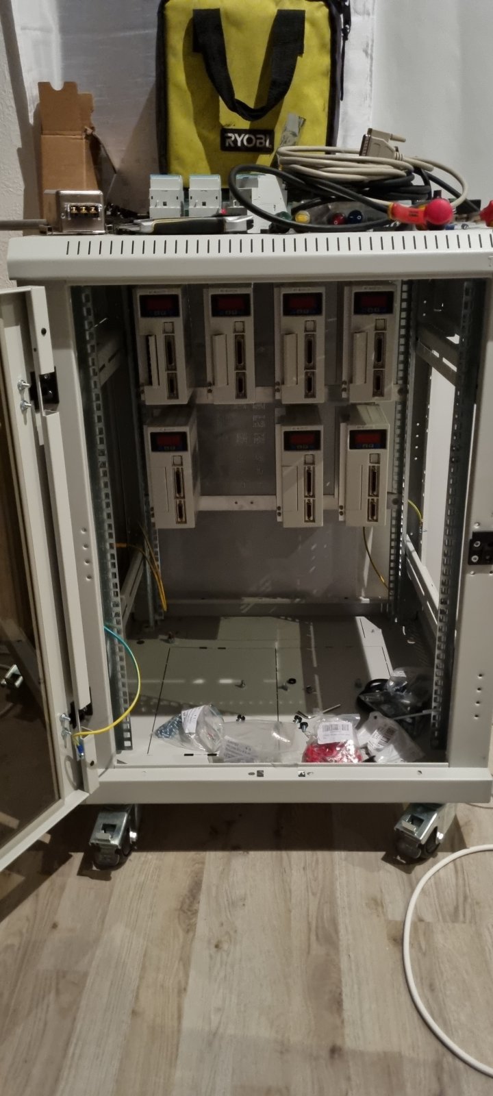

    Bought an server rig
    And finally yesterday i got the software running with ps5 and gt7
    At first now only with 4 servos for testing and it works very good.

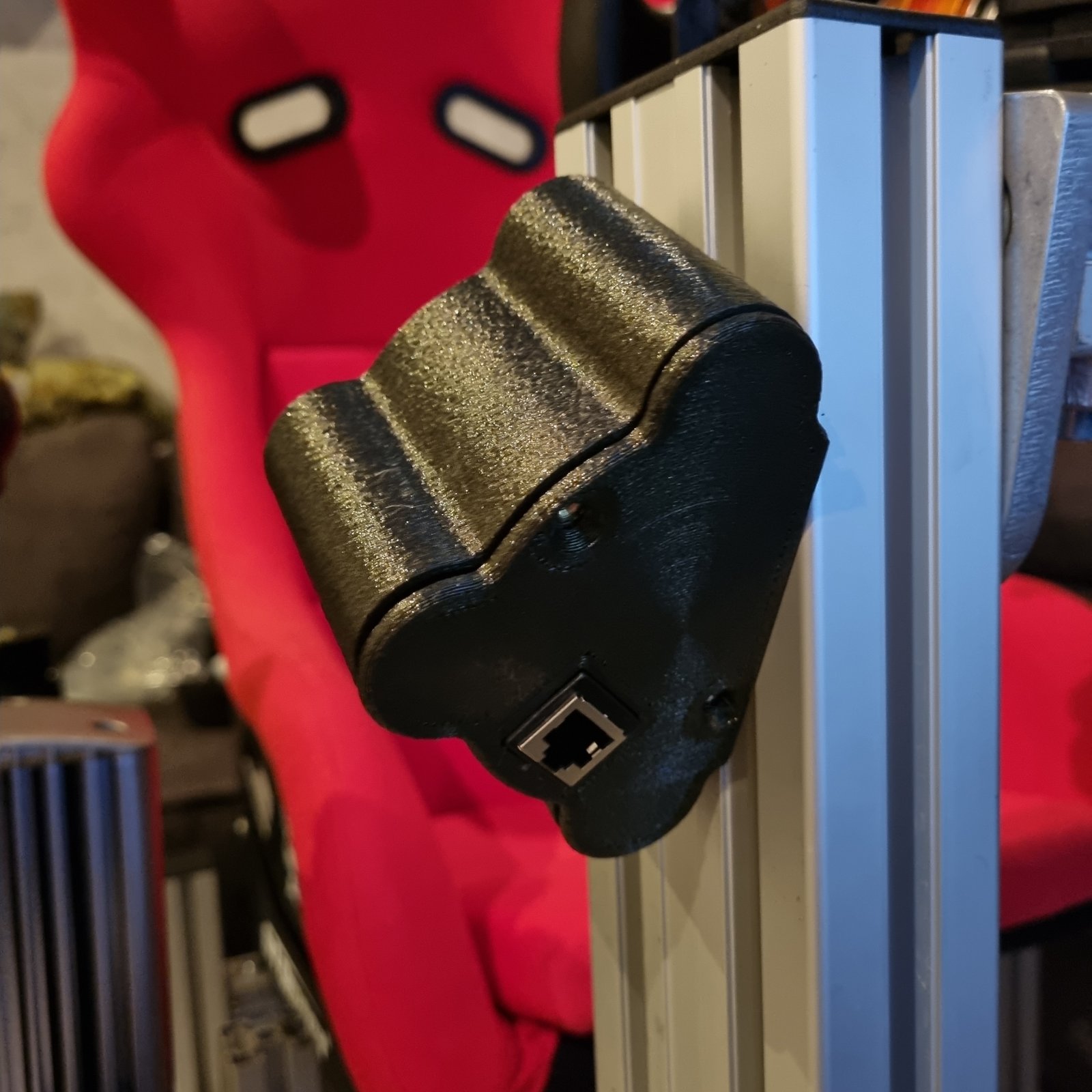

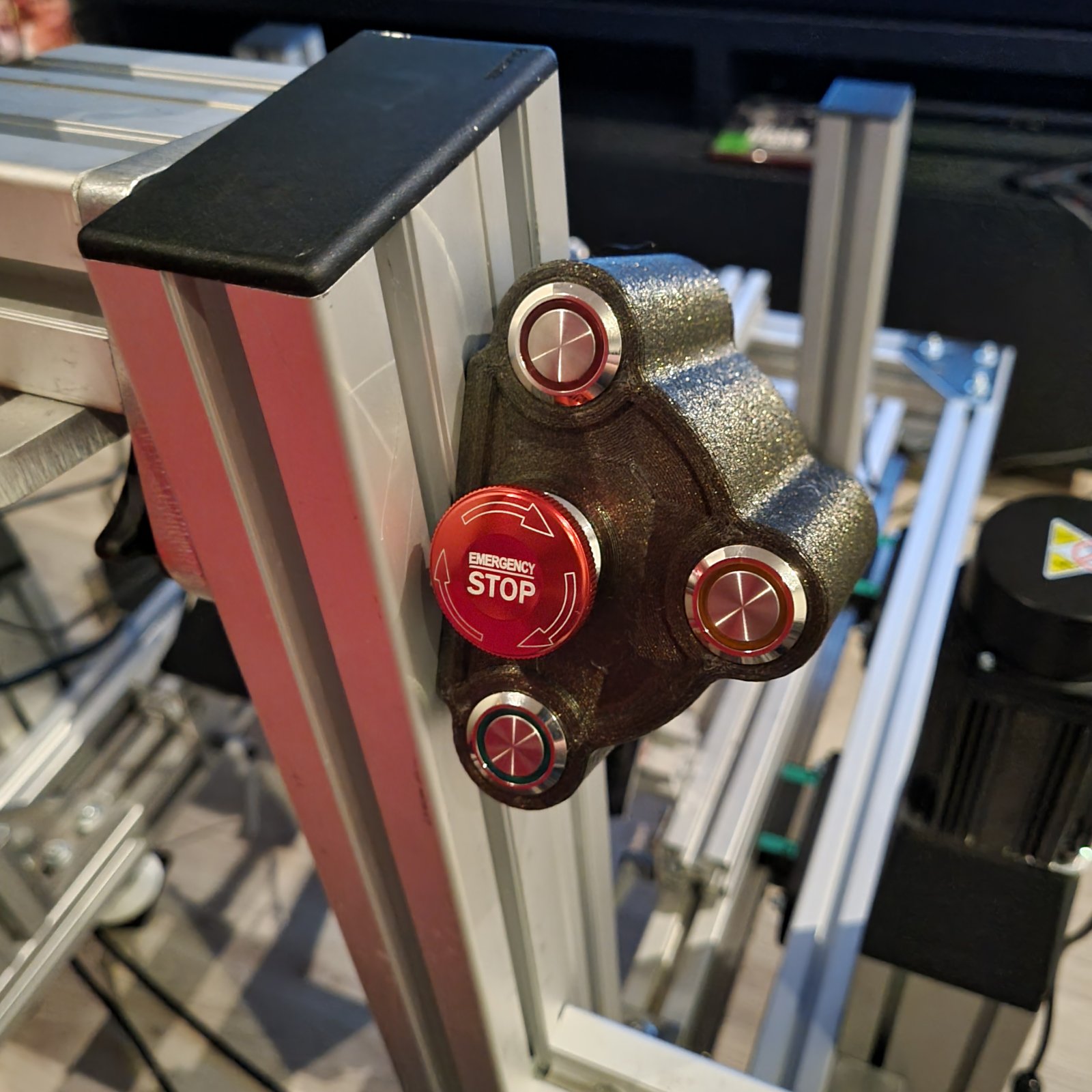

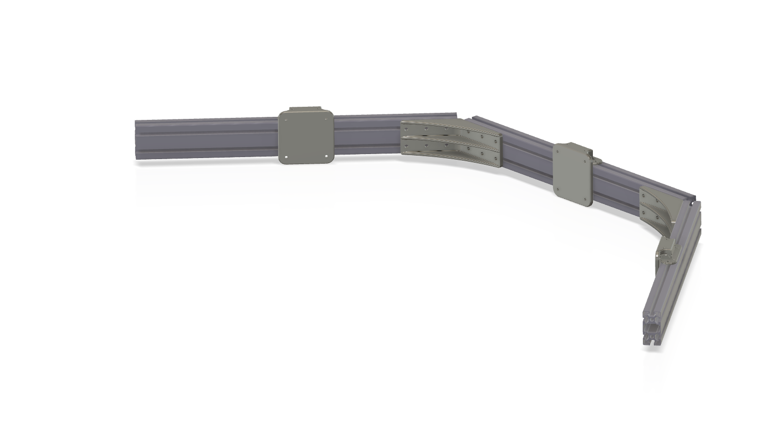

    Spent also half an hour to draw an Housing for an estop, printed it yesterday and i am happy with the result

    -Wire the server rig properly, 4 main servos, surge and TL should be able to be switched on and off separately
    -Install components for surge
    -Proper non-slip base
    -Fine tuning
    -Draw and order the final parts for TL front and rear

    Great build. Do you have any further information on what pieces you used for the sliding mechanism?
  12. Misanthrop
    Misanthrop Active Member
    Feb 5, 2024
    152
    910Coins
    +58 / 1 / -0
    You mean surge? SFU1605 with HGR20 linear rails with 190mm stroke and 80st motor. Everything else i designed and printed myself 20240426_202050.jpg

    So, the parts for TL are all designed and ready to get ordered or printed. Ordered already the 30mm precision shafts(not easy to get in Japan), they should be delivered end of October. My 3D-printer is still on the way to Japan. So i think everything will be ready in November.
    I am really happy with the outcome. Some Measurements:
    Tractionloss:
    - 350mm stroke(175mm in each direction)
    - Only 80mm additional Height
    Overall:
    - Vertical Actuator 170mm stroke
    - Surge 190mm stroke
    - Overall only 400mm Height to the Seat connection when Actuators are in waiting position(it´s possible to get it even lower, maybe in future)
    - everything with super lightweight Profiles from Bosch
    - most 3D-printed Parts are made of PETG, some out of ASA
    - everything designed by myself
