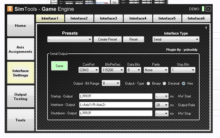

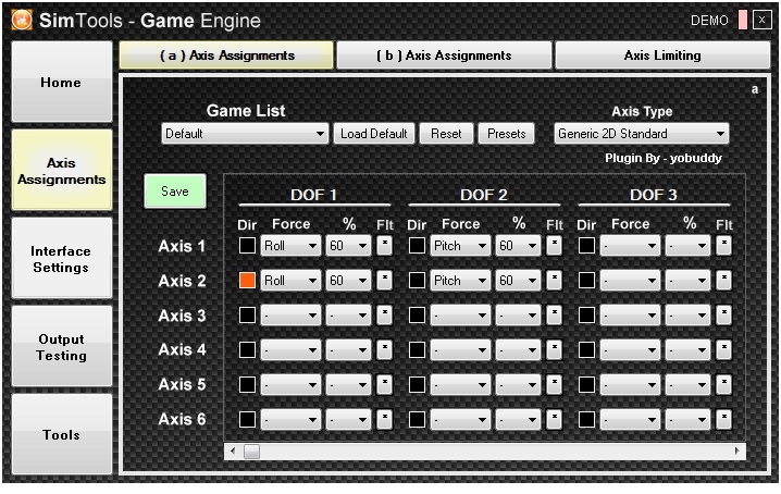

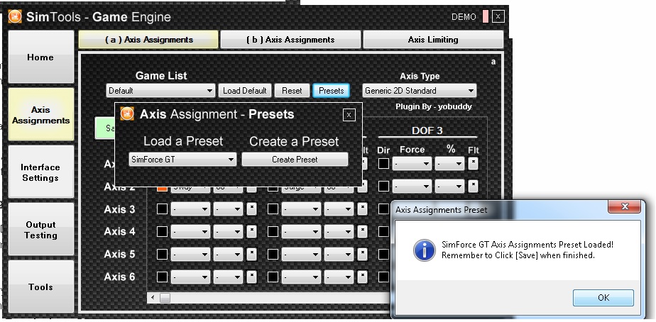

    Friends, help me find a mistake in the 2dof.
    I do as directed by the instructions, but when I run SimTools signal to the motor does not go.
    My print settings screens SimTools:

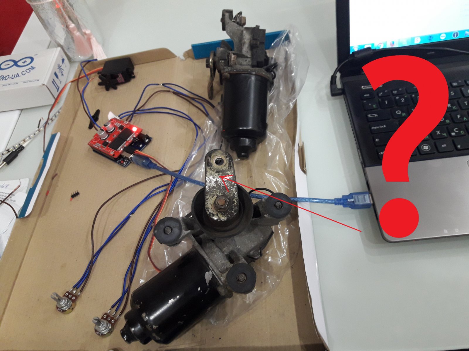

    I start the engine test - the engine is not running.
    include tests -Engine does not rotate (
    I used this code to Arduino:
    2DOF_Racingmat_Arduino_Code_and_Presets.zip
    So I connected:
    Arduino /..Motomonster
    ....GND <-> GND pin
    .........5V <-> 5V
    .....pin 4 <-> pin 4 inA motor1
    .....pin 5 <-> pin 5 pwm1
    .....pin 6 <-> pin 6 pwm2
    .....pin 7 <-> pin 7 inA motor2
    .....pin 8 <-> pin 8 inB motor1
    .....pin 9 <-> pin 9 inB motor2
    .....pinA0 <-> center pin of pot 1
    .....pinA1 <-> center pin of pot 2
    .....pinGND <-> 0 ohm's pin potentiometer 1 & 2
    .....pin 5V <-> 10k ohm's pin potentiometer 1 & 2
    Please tell me what I'm doing wrong?

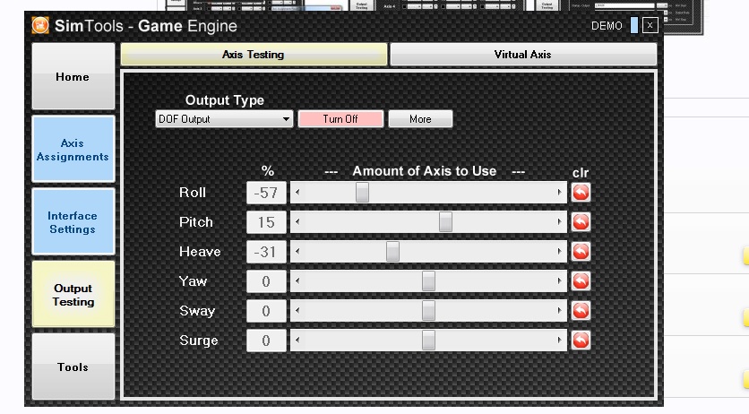

    Hi.
    Test in Interface - Output L<Axis1a>R<Axis2a>
  4. Vitalik
    Vitalik New Member
    Feb 16, 2017
    18
    Ukraine
    253Coins
    +8 / 0 / -0
    2DOF, 3DOF, Arduino, 4DOF, 6DOF
    thanks) test run - the motor is running!

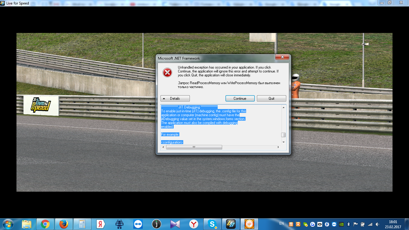

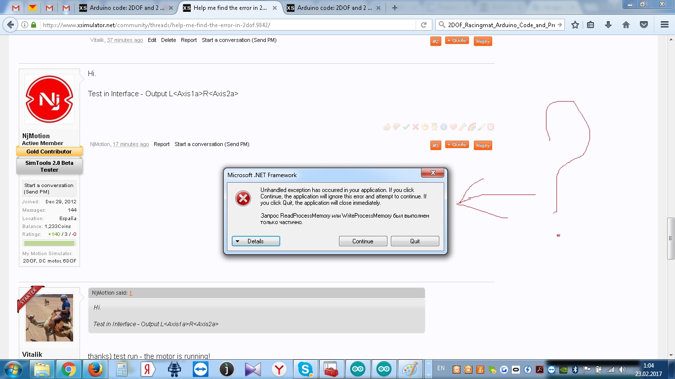

    I launch the game (LFS), I see the error (
  6. Pit
    3,013
    30,409Coins
    +3,088 / 31 / -0
    Thread title edited and moved.
  7. yobuddy
    5,133
    47,907Coins
    +5,027 / 16 / -0
    LFS does not read or write from a process memory thou?
    Can you please click details so we can see a bit more?
