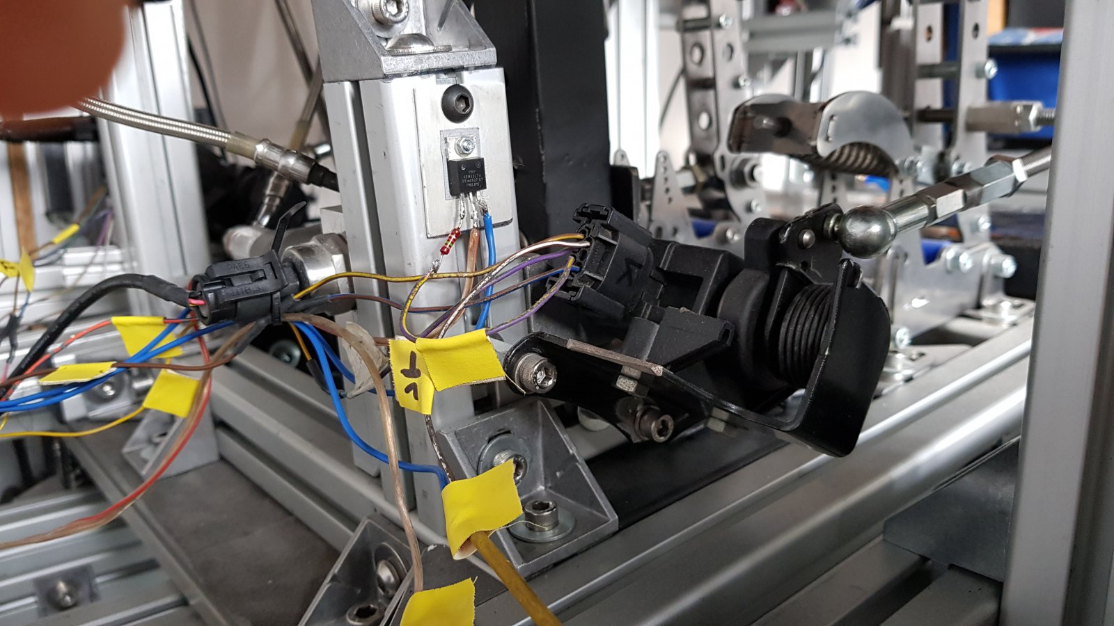

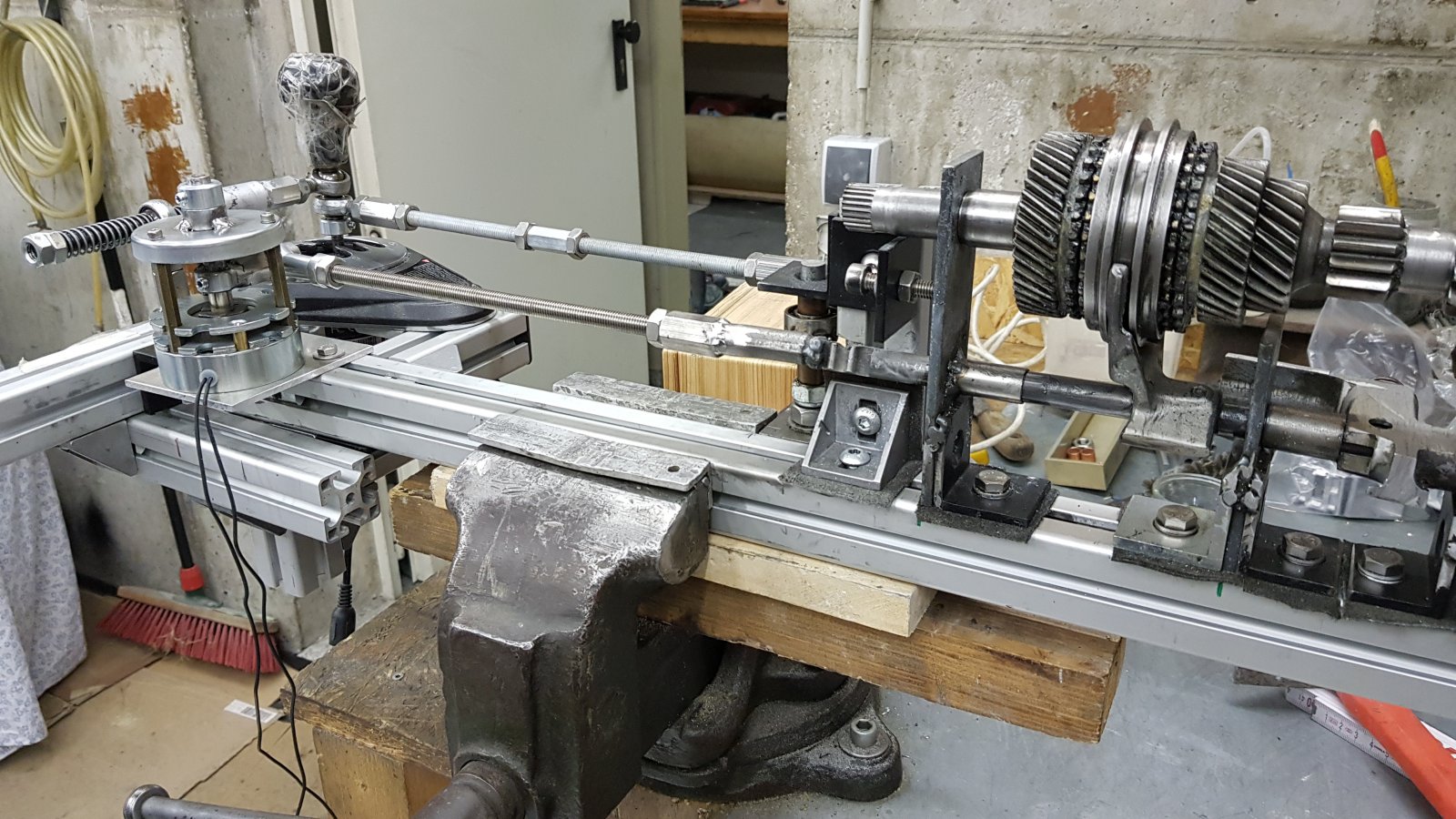

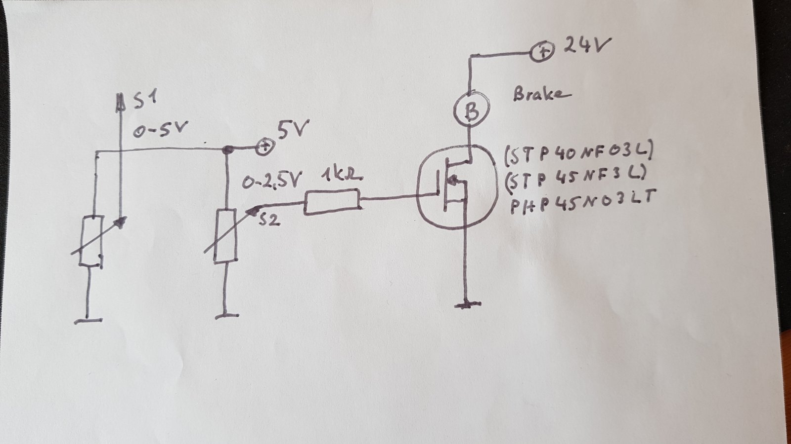

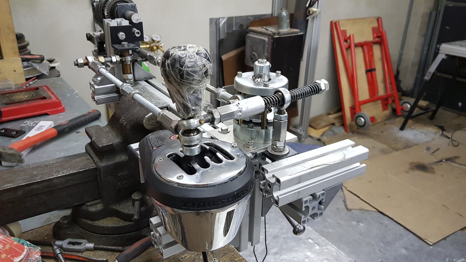

    First prototype of a mechanical locked H-Shifter based on Thrustmaster TH8A. The mechanism is a motor brake (swb-05 Nema 34 stepper) the signal is deviated from a automotive double hall sensor of the clutch pedals.
