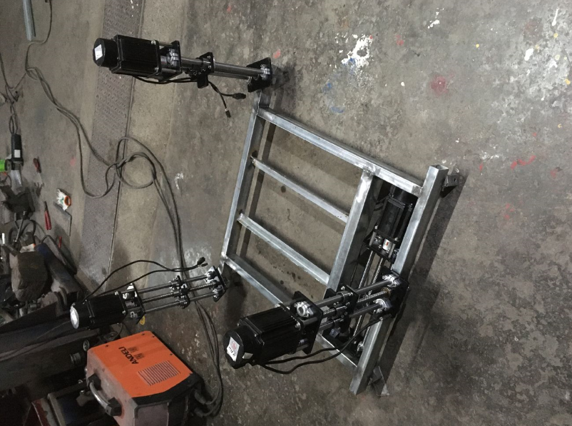

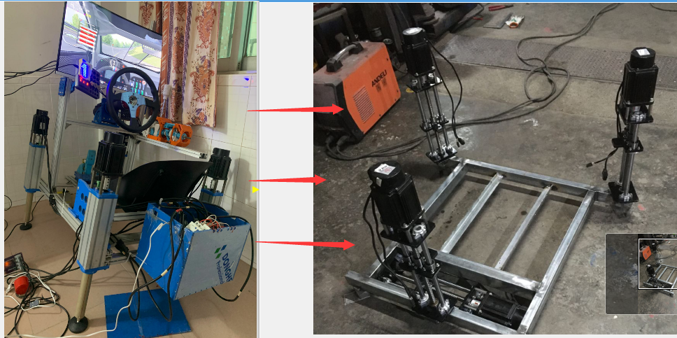

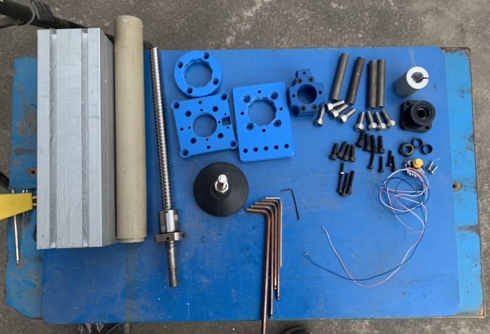

    Starting to create my own sport, I want to show the results and encourage anyone who wants to make up their mind and invest in it!
    Servo motor: riding 90st electric cylinder: 80-80-380 ball screw: 1605

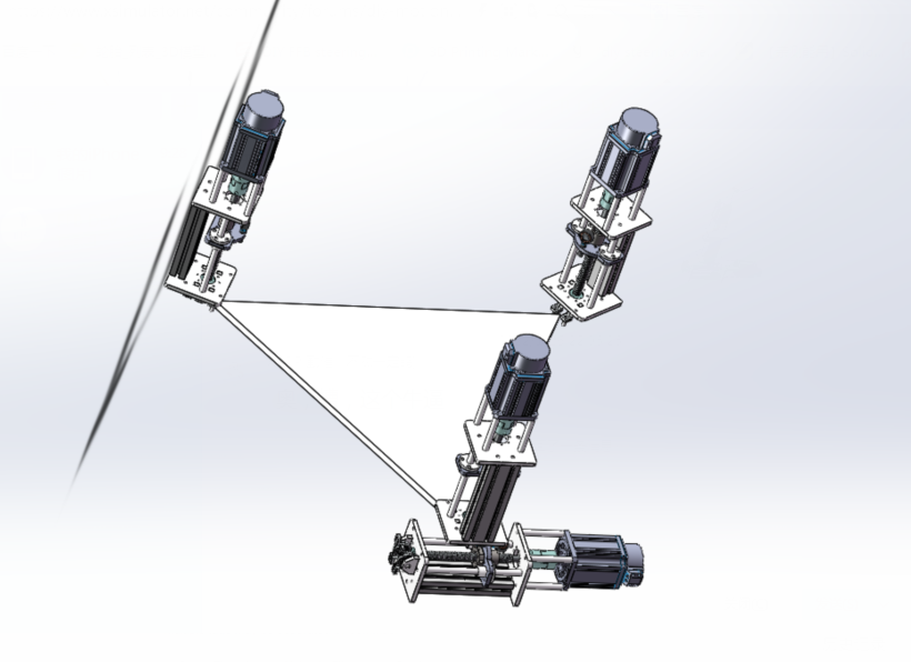

    This is my DIY 4-cylinder 3DOF. Now I want to add a TL,

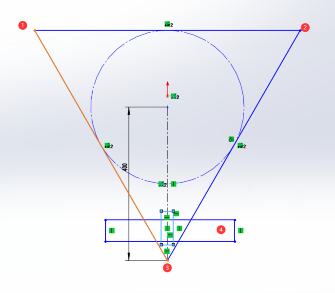

    Nice work on the actuator and rig :thumbs
    So with the planned addition of traction loss, is that with the 4 peg leg designed rig, or as per the drawings do you plan a traditional 3 actuator 3DOF and use the 4th actuator for traction loss?

    2DOF, 3DOF, AC motor
    According to the drawing plan, the traditional 3-actuator 3DOF and the 4th actuator are used to make a yaw. Because I saw that my friend made it and the effect is good, I want to change my 3dof-4 actuator to the drawing,
  5. zhai1987
    zhai1987 Member
    Sep 7, 2021
    96
    320Coins
    +11 / 0 / -0

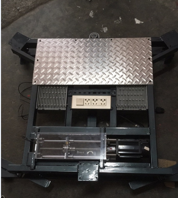

    , \ I need to transform my into 4DOF made by my friend! upload_2022-1-27_10-56-42.png

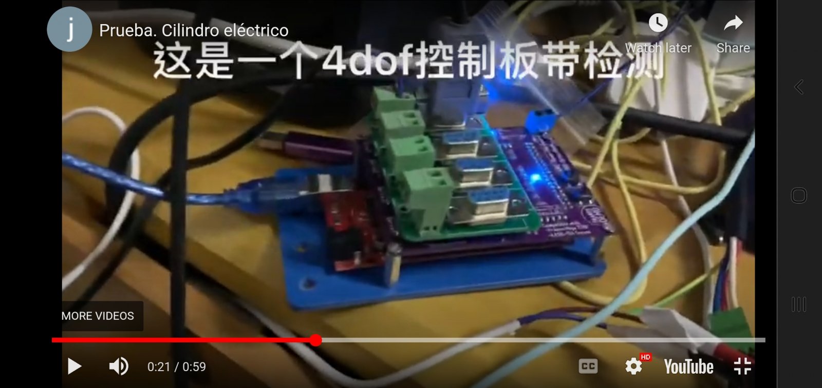

  9. Thanos
    Jul 6, 2017
    1,367
    Electronics Engineer
    United States
    2,830Coins
    +1,069 / 9 / -0

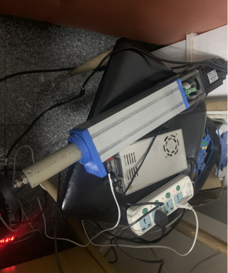

    Is that the Thanos Demo board? I see you added custom headers though, for stepper motors?
  10. zhai1987
    zhai1987 Member
    Sep 7, 2021
    96
    320Coins
    +11 / 0 / -0
    Yes, he's from tanos's demo board, because I don't use aads15a servo. So I need to add some functions! thank you!

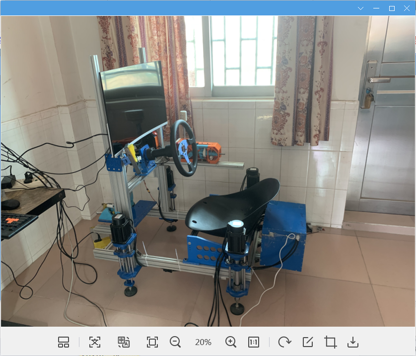

    Explosive force test. Thank you for your help.

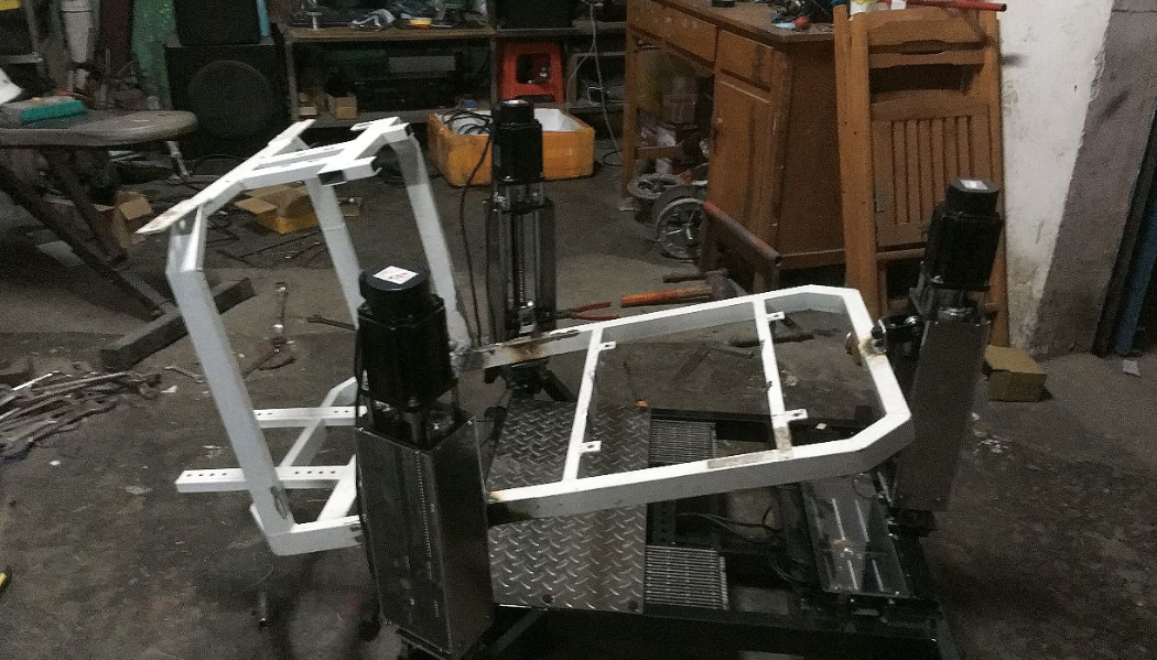

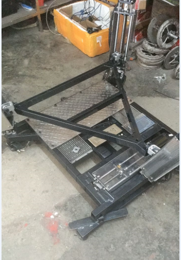

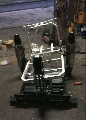

    Share 3DOF + 1tl seen in China. very nice!
    upload_2022-2-7_10-12-14.png upload_2022-2-7_10-12-43.png upload_2022-2-7_10-13-0.png
  14. zhai1987
    zhai1987 Member
    Sep 7, 2021
    96
    320Coins
    +11 / 0 / -0
    His idea is very good. I'm ready to transform like him!
