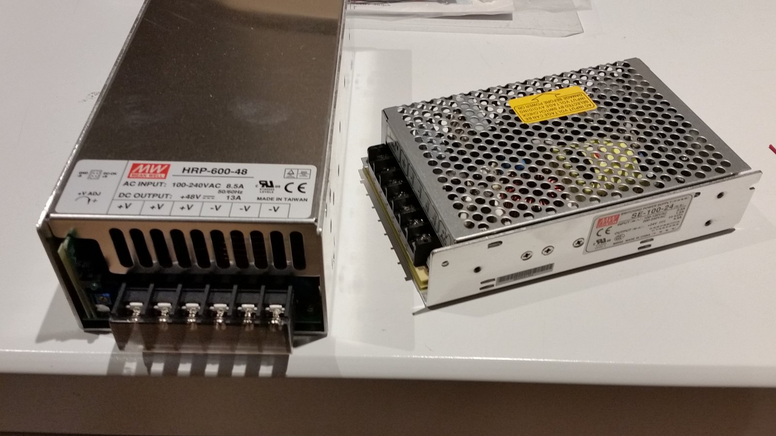

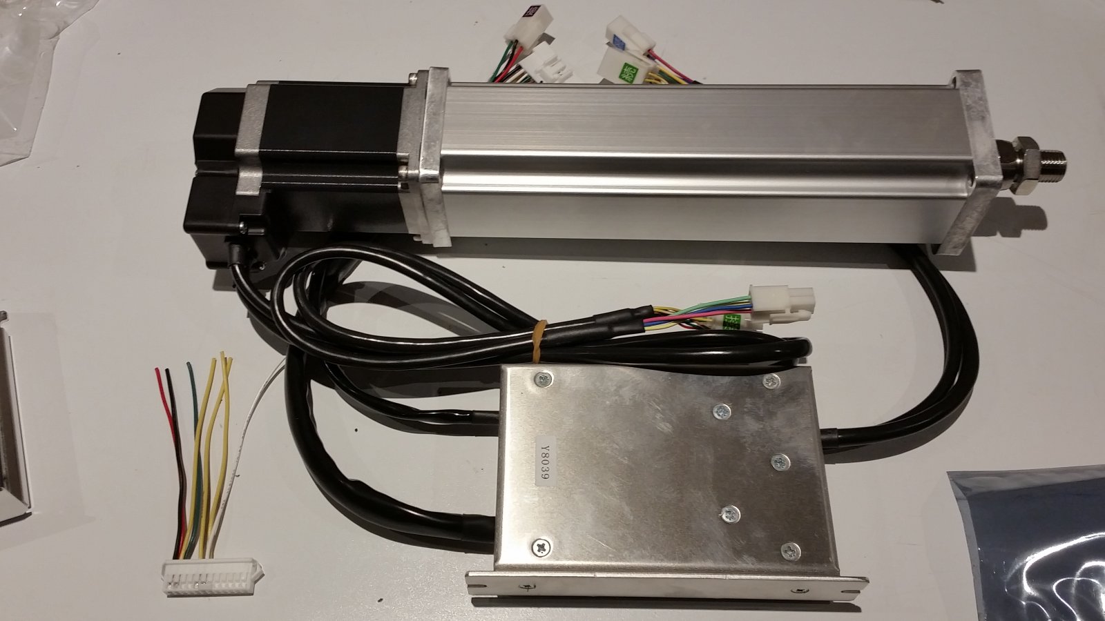

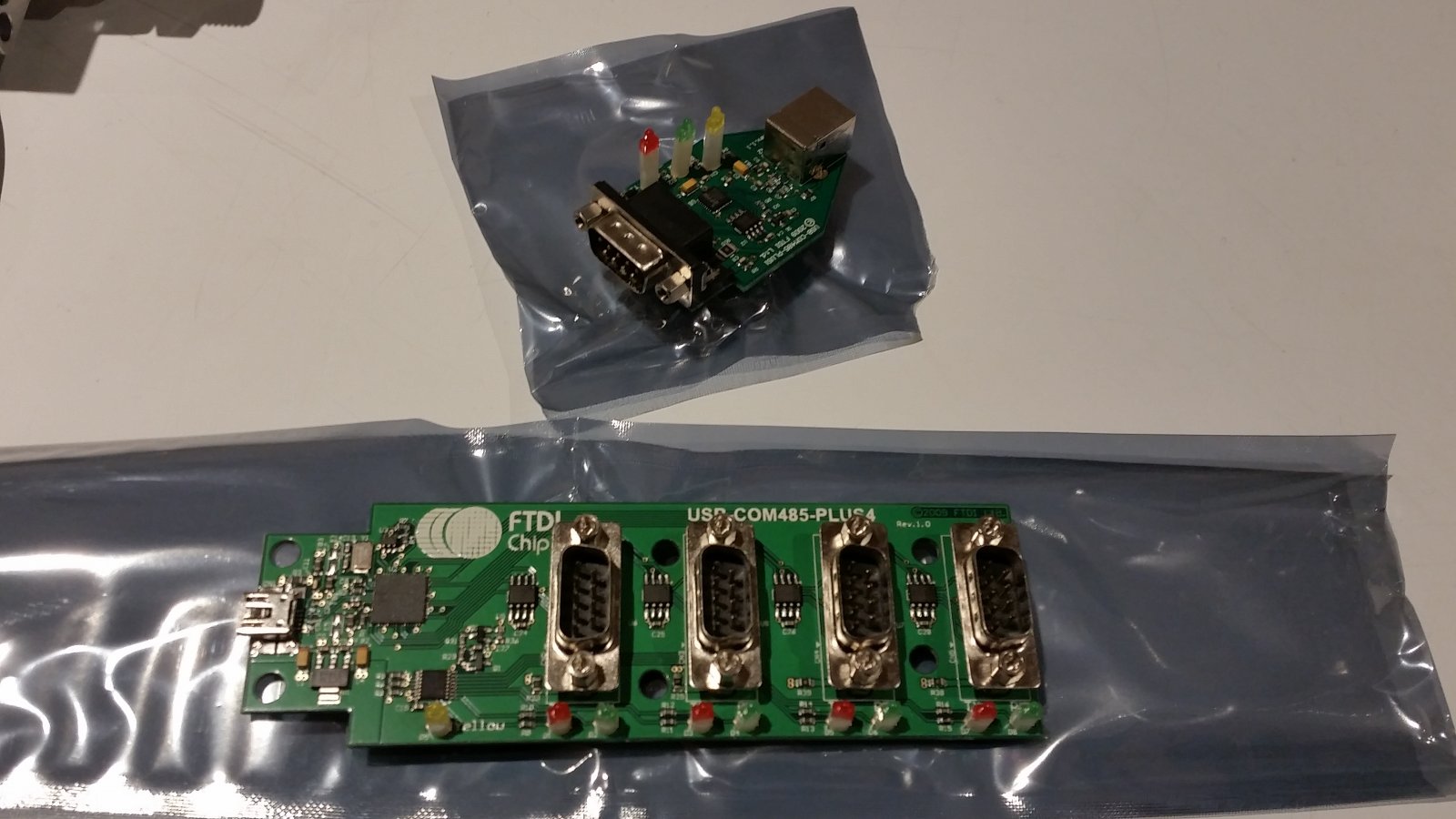

    hi guys. as you may or may not know im a newbie and started my own project.
    bits have been arriving and i thought it would be pretty easy. Oh how wrong was I, but you live and learn.
    I generally have no idea how to connect the bits up what i have and what else i need to buy. any help appreciated.
    ive attached some pics of what i have, so if you could help with wiring diagrams and what else i need to purchase that would be fantastic.
    4x frex hyperaxiss 100
    1x scn6 40x150
    5x connectors
    1x48v power supply
    1x24v power supply
    2x usb com 485 boards
    sorry to be a pain but i am clueless and dont know where to start

    hi all. I've been scouting the forum looking at the SCN6 threads and figured out how to connect them via other peoples descriptions and diagrams. the trouble i am having is the 2 x boards. the type other people have used are different, so have i got the completely wrong item or are there adaptors that go into the com ports that i am missing. I can see absolutley no way of connecting to them.

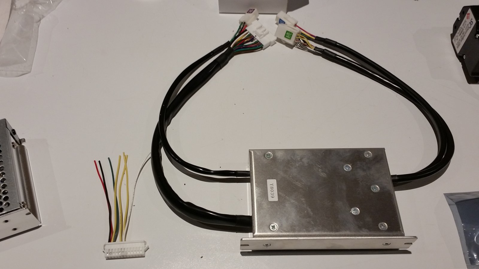

    thanks @SeatTime. Yhis was the topic that got me into my Set-up. I have bean dealing with @Roadster2 and he is trying to get the last bit of information. I know how to connect it up all except for 4 wires. These are the wires that go into the 485 board. I have ordered 5 female ended DB9 cables that i am going to cut one end off and connect to the actuator. i just want to make sure i connect the right wires as one of the scn6 diagrams uses an RS232-RS 485 converter so just want to check.

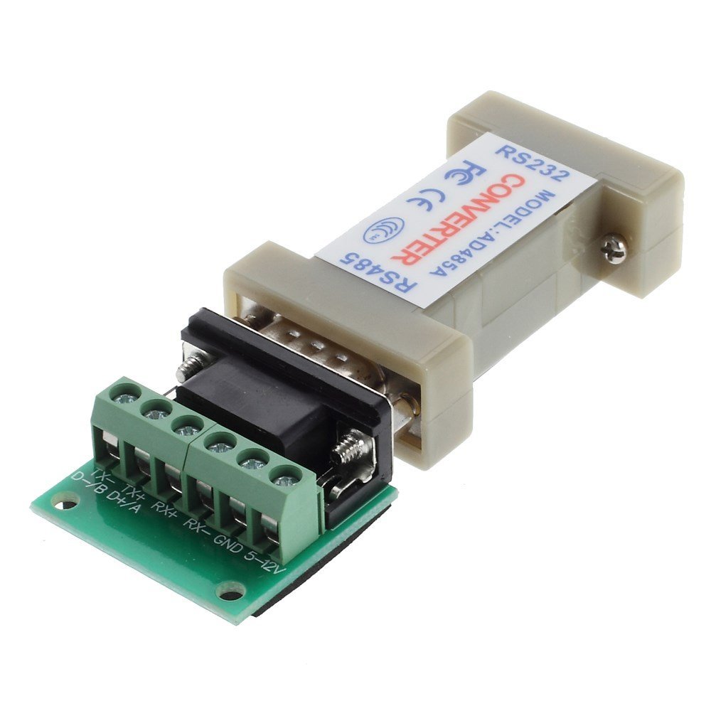

    I think i have cracked it. Lots of searching and i have ordered 5 of these. now to go and buy a couple of miles of cable. hoping to be ready to test and set up with sim tools at the weekend. will be after a lot of help then guys converter.jpg

    Avoid multiple port usb-rs485 converter, trust me.

    Sorry @nclabs. did you mean the multi ports on the rs232-485 pictured above or were you referring to the main 485 board in the thumbnail in first post. Any reason why to avoid as i have the board and the converters will be here today or tomorrow.

    The last one you posted it's good I think, I was referring to the first one you posted. Anyway, if you need to drive 5 actuators, you will need 5 of those converters.
    That kind of converter is about RS232 to RS485, but you will need another 5 converters from RS232 to USB. I would prefear a converter from USB to RS485 directly

    I Have got 5 of those converters so all good there. From speaking with @mrt on his post he has used the same board with no issues so will see how it goes for now before ordering more parts. I didnt so much as want the converter itself, i just wanted the plug board but couldnt find them on there own. Ill keep you posted.

    @mrt. Im 100% up and running now mate. The power wasnt the problem, it was the com-usb-RS485 board being a 4 way kind
