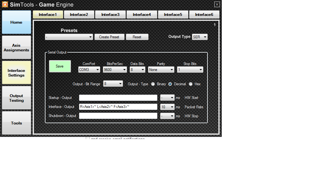

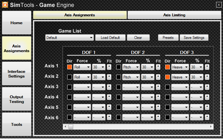

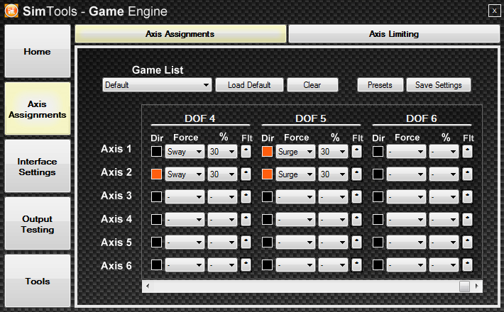

    Decided to practice with live for speed, have game installed and patched it is communicating with sim tools, my model however is not, during axis testing i can get one servo to move one way and get stuck maxed out, i did not find the simtools settings in @eaorobbie build any help would be much appreciated

  13. insanegr
    insanegr !N$@n€
    Jan 14, 2014
    504
    Athens
    16,721Coins
    +499 / 1 / -0
    this is how your settings should look like
    hope i helped and didn't confuse you more

    I am proud to announce i have a working model 2dof sim. I am using old steering servos from an old traxxas i had laying around. Performance is ok but sensistivity issues, i only had 2dof selected in the axis assingmnets pitch and roll, do i need all of them with 2 motors?

    +12 / 1 / -0
    Also i only have a L and R axis in the interface output under "Interface Settings" also i had to adjust the packet rate to over 10ms servos were very glitchy at or below ten ms

  18. insanegr
    insanegr !N$@n€
    Jan 14, 2014
    504
    Athens
    16,721Coins
    +499 / 1 / -0
    good to here that you got it working:)
    hope FAQ's will be up soon:sos
    here is something to understand each dof
    depends on the plugin of the game you are running first (dofs of motion that the game can provide and export) and second what will you like feeling in motion when setting game manager, you can use as many dof you like
