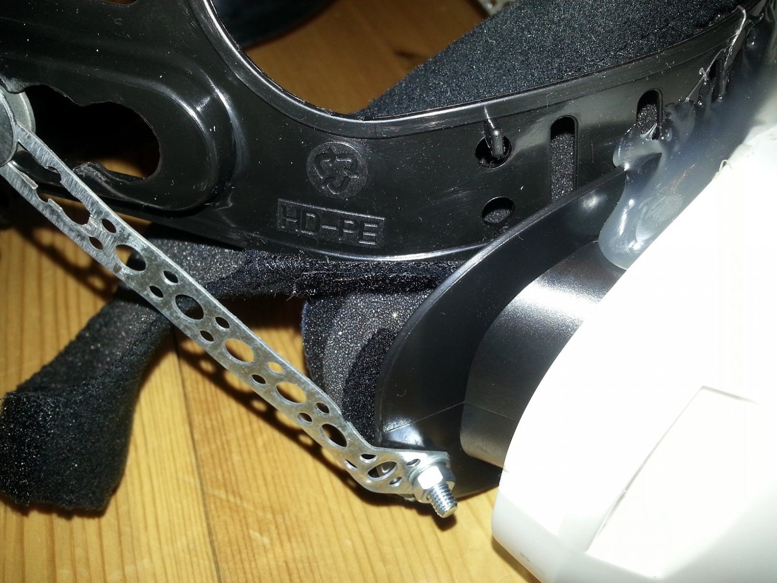

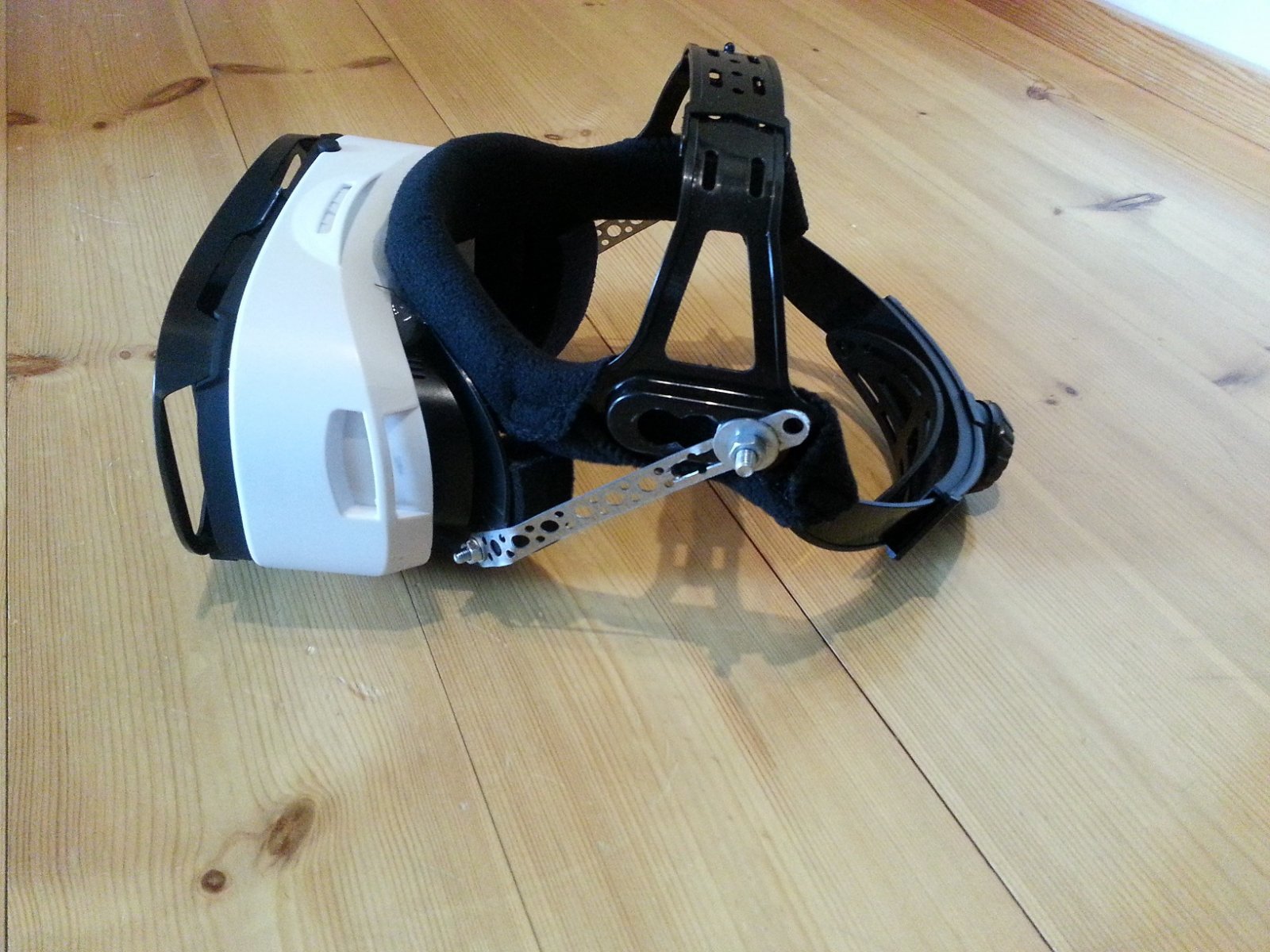

    Hi!
    2 mods: hotglued headband and removed material from lens tubes. Also made foams a bit thinner, which also improves FOV. Side supports are not necessary, but helps to keep glasses pressed more firmly in my face.
    View size is now restricted by my phone size, which is 5.1" -> view could be wider if the screen were bigger.

    thanks for the pics, i will work with mine today :D:D:D
    i saw how you cut the internal "tube" of glases... what is what cut for? (does it gives you more fov?)

    Yes, tubes did restrict FOV -> bad design.
