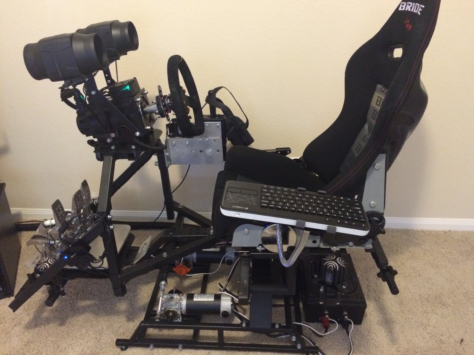

    image.jpeg Cut a dumbbell in half, and welded the pieces to the end of some tubing. Also had two angle brackets welded on tubing so I can mount it to my seat. This way I can add or remove weights from back of seat for proper balance when needed.

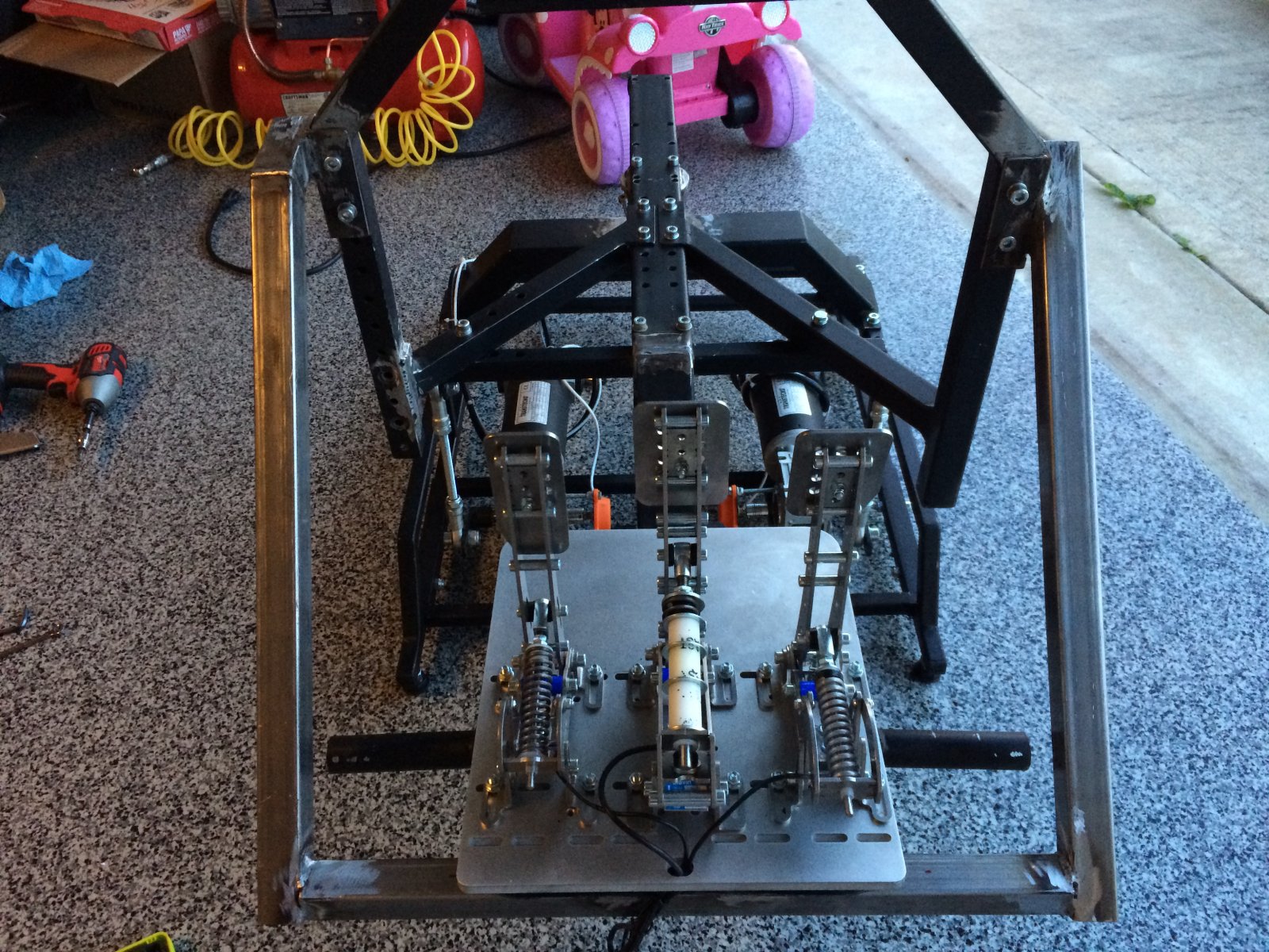

    Here is some more pics of the mods so far.

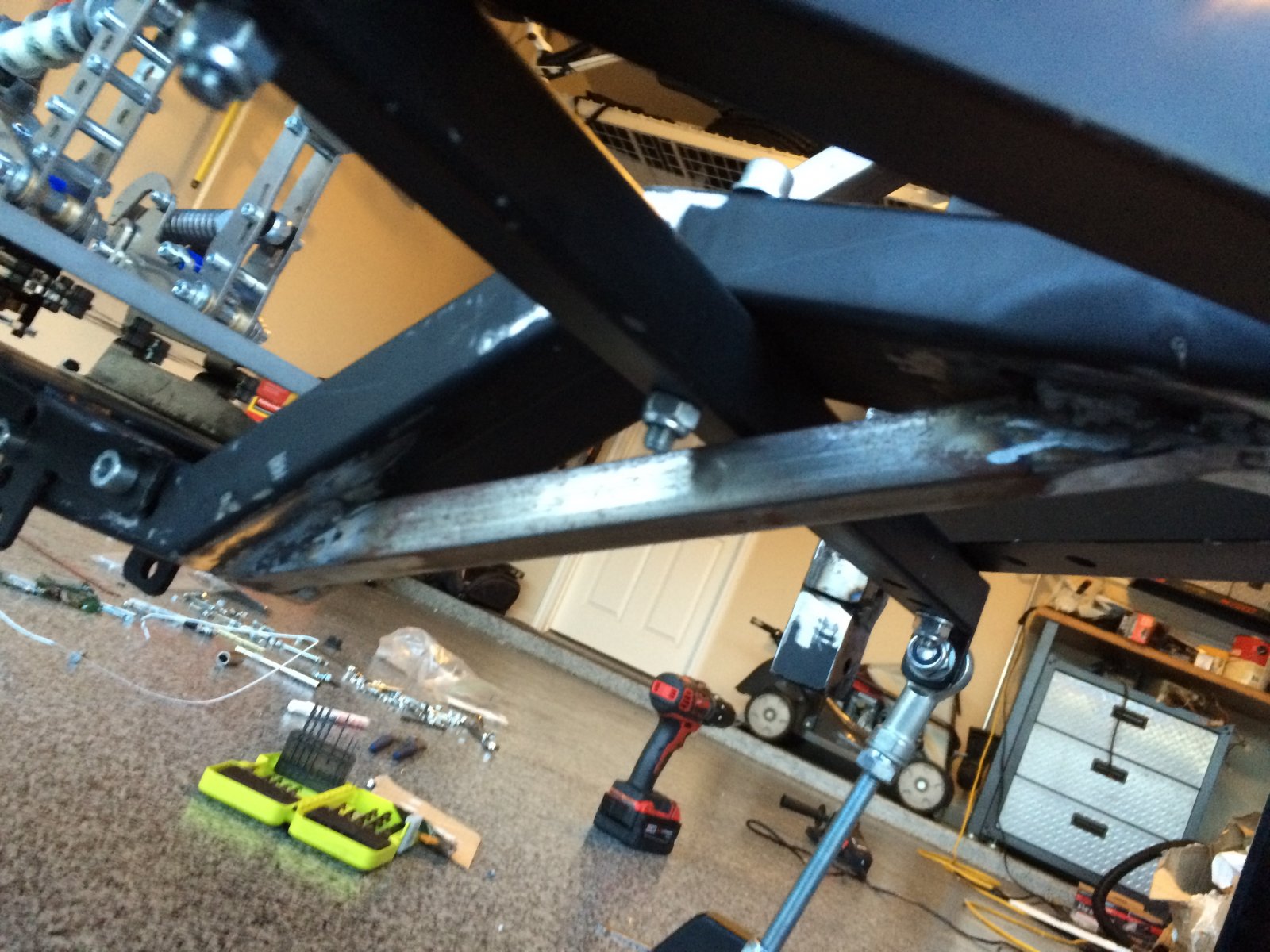

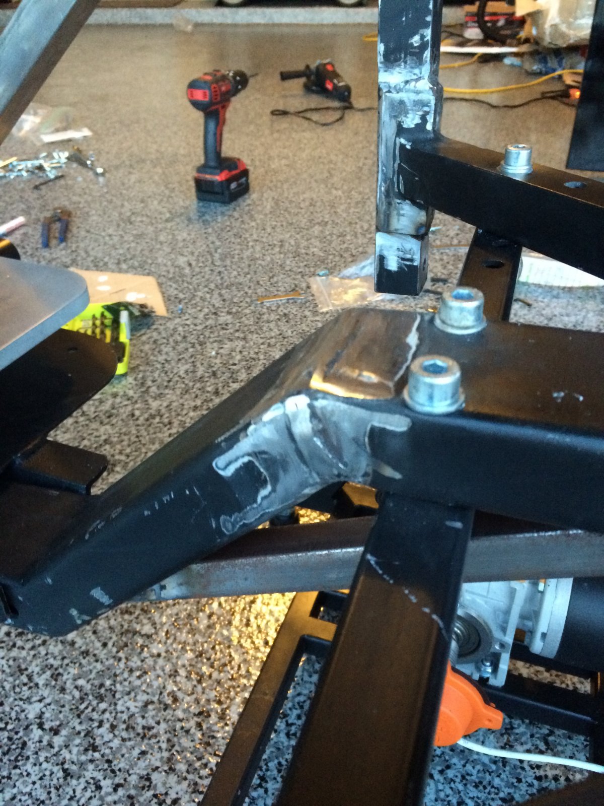

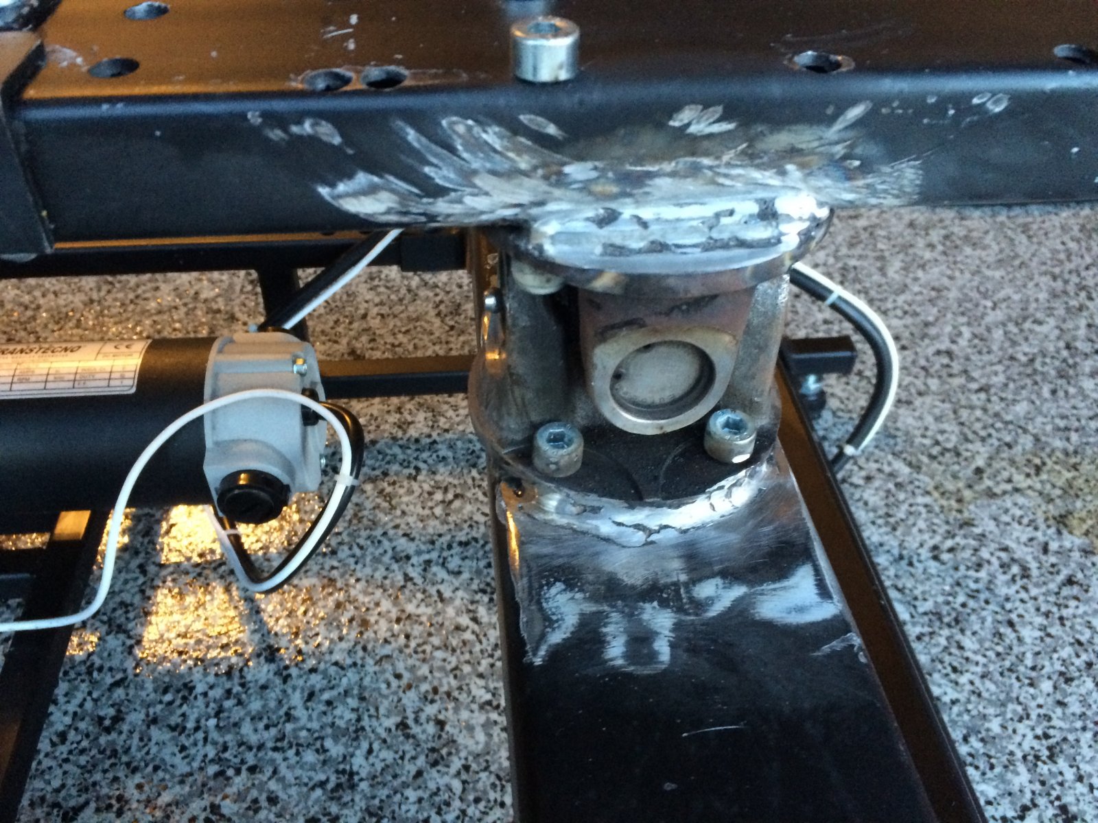

    image.jpeg The bolt on the joint were stretching and coming loose so I welded that also

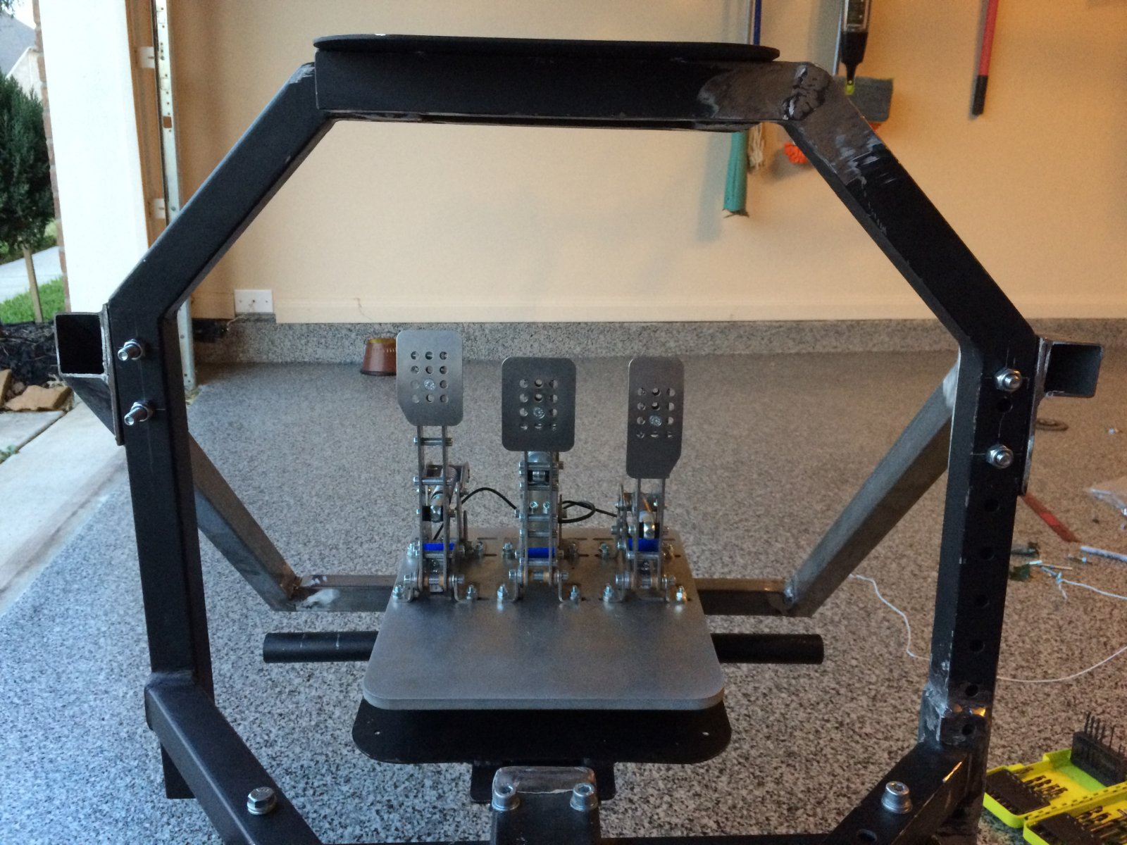

    And this the the front could probably buy the he ultimates now lol. The sterring mount is also rock solid now image.jpeg image.jpeg

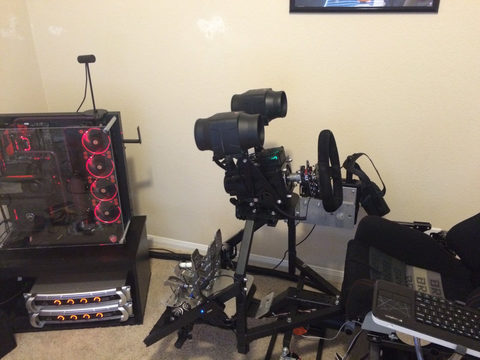

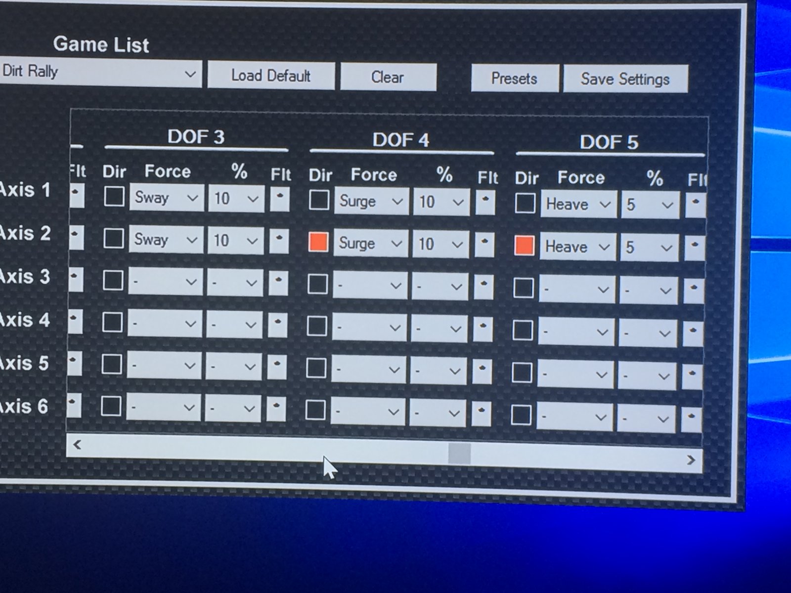

    Question for dynkit owners. I just installed Dirt Rally with the patching perfectly for x64 installed but no having any data from the game. The game manager recognize the game but no data collected. I have Asseto Corsa and Project Cars working fine.
    Also simvibe is working with dirt rally. Any ideas?
    Thank you
  18. aceinthesky
    aceinthesky Member Gold Contributor
    Sep 3, 2016
    46
    Pearland, TX
    266Coins
    +21 / 1 / -0

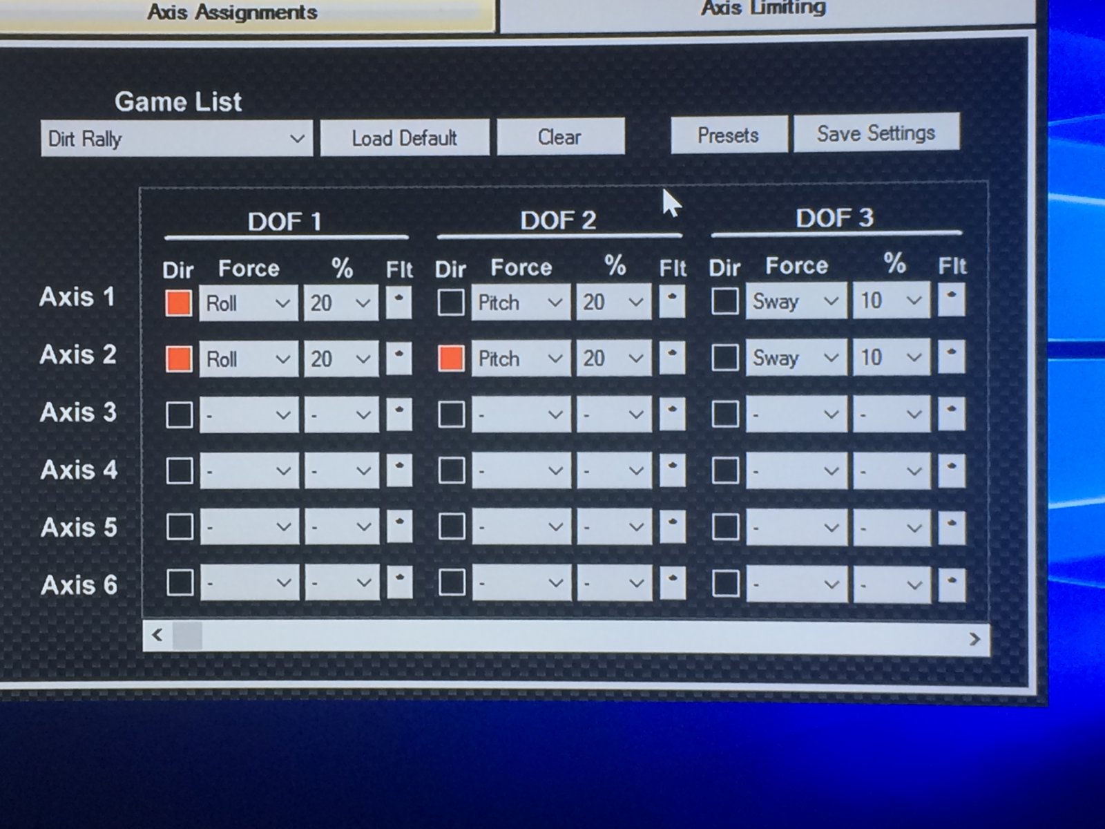

    image.jpeg image.jpeg It took me a few hours but I finally got dirt rally simtools motion and simcommander working together. Did you patch the game under c:/user/documents/my games/ dirt rally. If you did that then remove patch and then repatch game in same location. When you start game make sure that in the game options-video settings, it's set to full screen and the highest resolution, and ultra or high settings. See if motion works. Also the only way to get motion and simvibe working together is to a add a line in the config files for an extra port.
    There is a bug in the game concerning the window mode and resolution settings.
    Also setup min and max values with the sim tools game engine tuning center.
