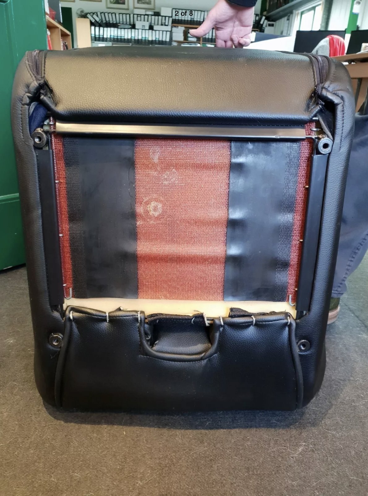

    I’ve just ordered the H2 and need a compatible seat. Can anyone point me in the direction of a cheapish model please?
    Also how long does it normally take to ship to the U.K.?

    My seat has 4 bolt holes.
