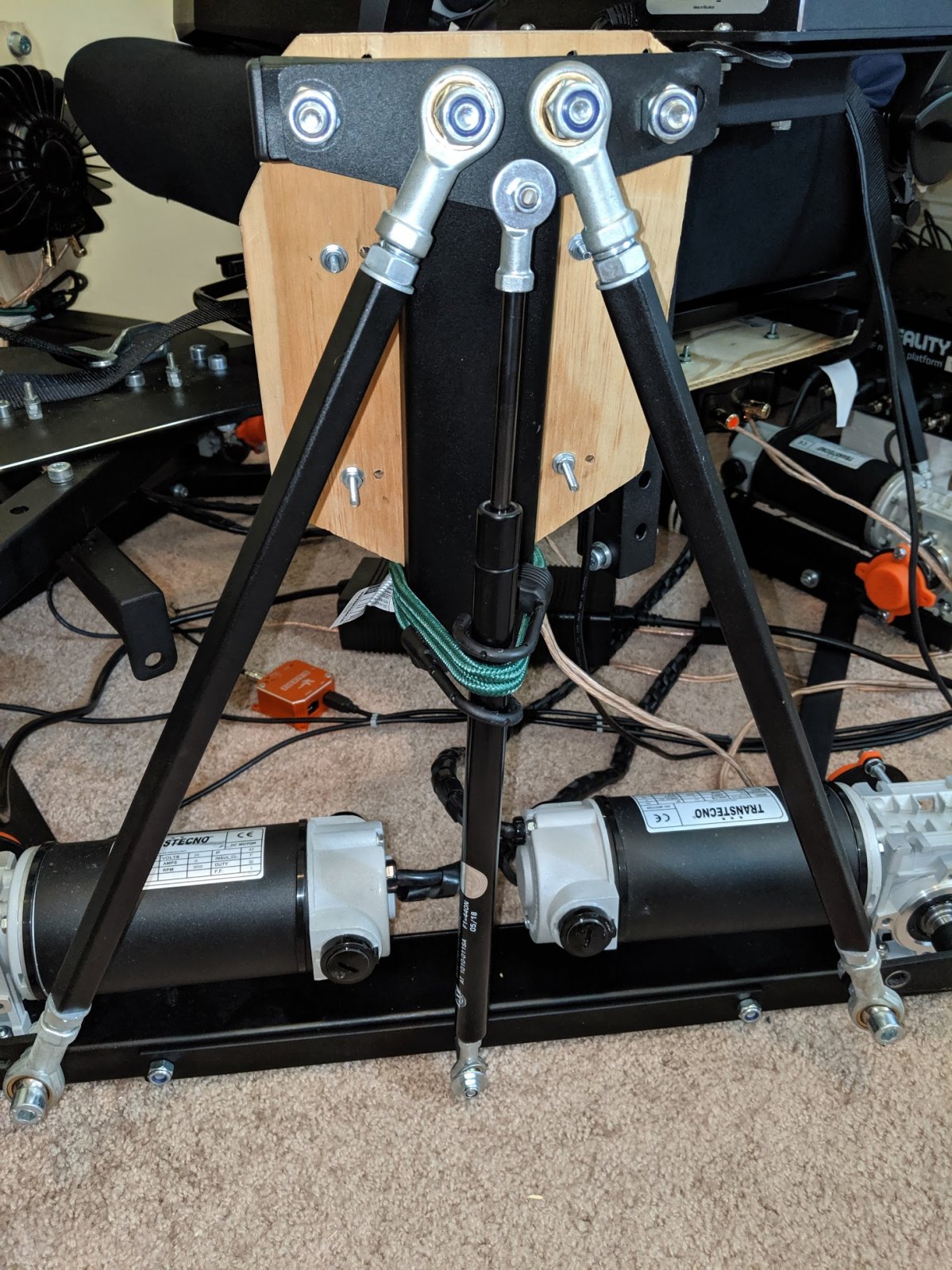

    Damper finally arrived. But how disappointing! Almost zero effect (at least not for me). Still a lot of gearbox lash, causing complete setup to shake up as hell once system moves down (with and wihtout load on it).
    Not really as expected. I now even fear, that this extra damper friction will cause increasing wear out effect on motors, too. On each damper is an adjustment wheel to set up damping force (in total 24 clicks possibleb in rotation).
    I tried almost every position, but it does not change much. There is also no describtion (expect this amateur installation video on their homepage). So - not really clear how much extra effort is given on that damper by the adjustment wheel.
    If anyone from DOF reality team does see this thread - any optimization suggestion is highly welcome.
    Ah - and additionally of course their protection cover also does now not fit any longer, at least the extended damper rod will now poke into it while every movement. And this damper rod is now exactly in the sim seat entrance area, which might be a critical lifetime topic in respect to rod misuse in case of hitting / kicking it to hard.

    Yes, and I installed it by following the installation video on their damper product page without any problem. Just need to make sure movements for both directions on damper (I left equal length of exposed silver bar out of top and bottom from the damper outer casing) while locking the mounting clamp down.
  5. Tororo
    Tororo New Member
    Jul 11, 2019
    127Coins
    The gearbox lash is still there, but the damper slowed it down with the hydraulic damping effect to the point it just blends in with the ending of real gear movement, so I don't really feel the jerky movement that bounce me around once the gearbox stop rotating. I need to leave the rotation knob setting to 3 clicks from maximum with my body weight and the setup, mind you I don't have the heaviest setup though (Thrustmaster T300s + Clubsport v3 pedals and shifters + analog seq shifter/handbreaks). Did you leave both top and bottom silver bar equal length when locking the clamp onto the outer casing to allow the damping effect on both directions? Did you have your setup balanced properly on the pivot point? I did find the motors heat up faster since now it uses extra effort to move the damper friction too, I'm wondering if setting up a cooling device would help prolonging the motor lifespan.

    I ordered the dampers for my P6 which really just consist of 3 gas struts and some mounting hardware but I can report to any others with a H6 or P6 that these work really well. The shake has been eliminated and having 3 dampers spread around the cradle gets rid of the asymmetric movement I was getting with my DIY version that I posted a video of. (I had dampers on the front only).
    There is a very slight delay/speed reduction in the rig's movement as the dampers stop the rig from moving quite as fast in a full DOF movement (0-100%) but this would be a particularly violent movement in normal usage and I haven't noticed any difference when using it in VR other than no longer having the shake/wobble at certain times.
    I always used to get a bit of a wobble at Brands Hatch after the first tight bend, coming down towards the left hander but now all movements are equally smooth and overall more immersive.
    Overall, a highly recommended upgrade for any H6/P6 users, just a shame it sounds like the H3/P3 still has wobble problems.

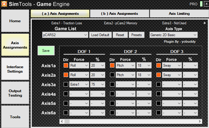

    For anyone who plays project cars 2, traction loss for my P3 stopped working. I don't think I changed any settings, but I could be wrong. I can get it to move left and right output testing Extra 1, but it does not move in the game. Are these the right settings?

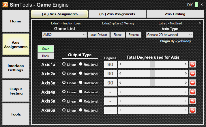

    I am using Simtools 2.4 with P3. I am unable to save the OUT Type in the 2D Advanced mode to Rotational and I have to assign it every time I start Simtools. Any advice will be appreciated.

    You mean you have the same issue?
  18. Javo5
    Javo5 Active Member
    Oct 10, 2014
    178
    Buenos Aires, Argentina
    300Coins
    +52 / 3 / -0
    Yes:
